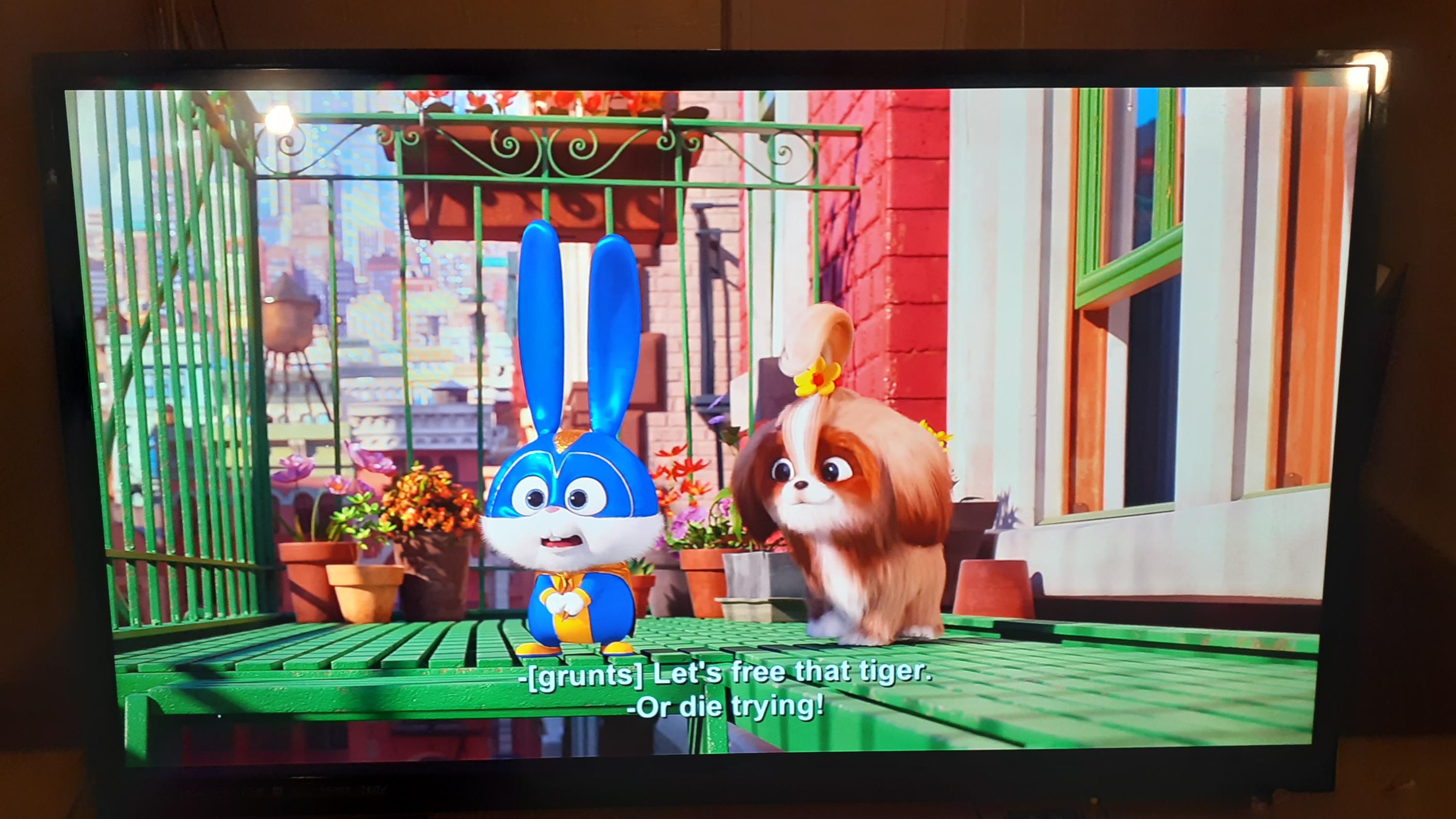

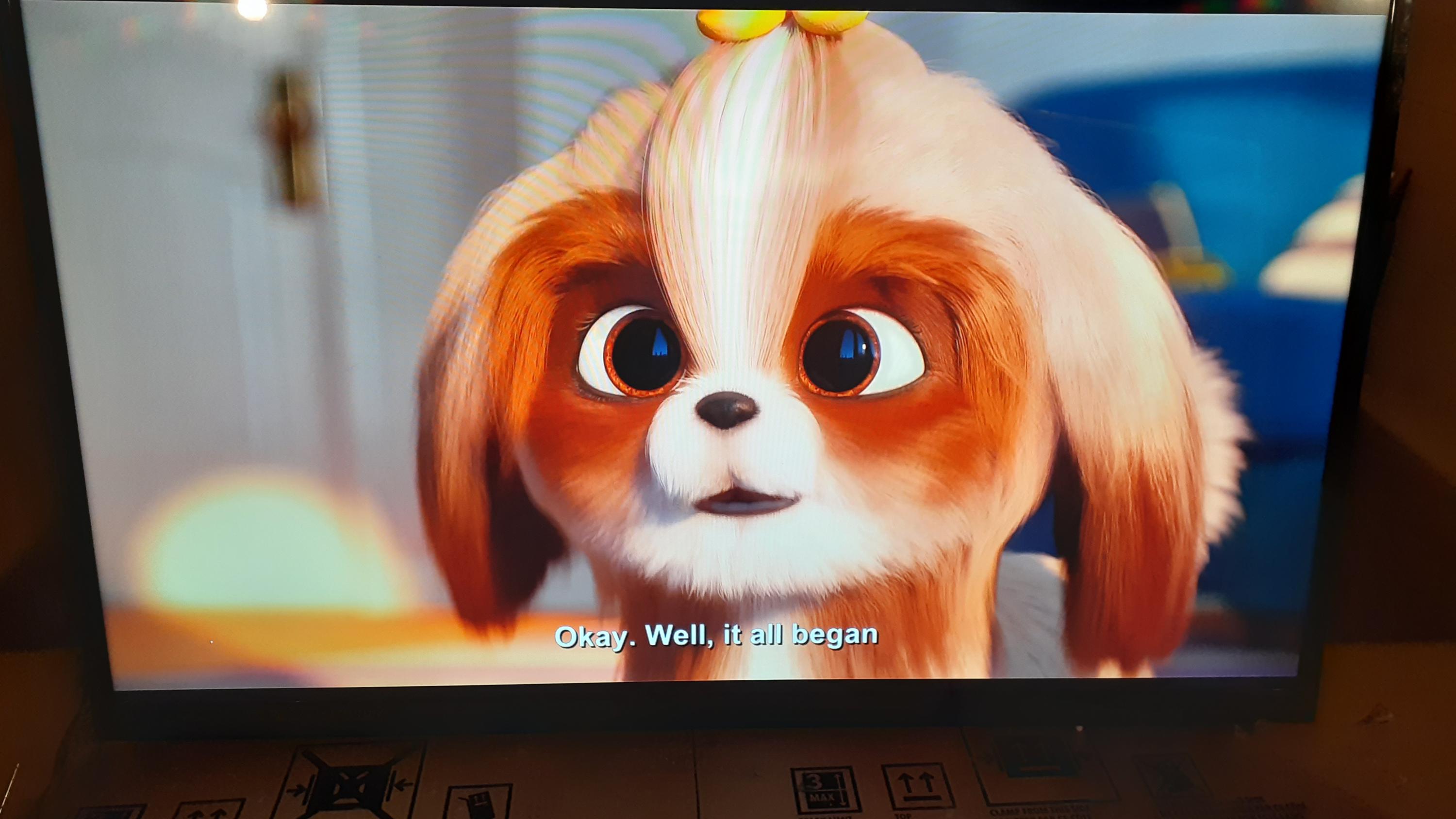

Vizio E470i-A0 Dark Areas After Replacing Backlights

        It looks like the power supply on this model supplies two seperate strings (4 wires to the panel) So there are two seperate series strings, The panel uses 12 strips, 2 across the panel, for 6 rows. It is not possible to have ONE row darker, the power supply has no control over 1 row of 9 led's. It can control the top 3 rows or the bottom 3 rows.
        The best way to confirm it would be to switch the darker row with another row. Your eyes can't tell the brightness when lighting them with the batteries. they all looked bright, but once you put on the diffusers and the lcd panel you can now see the difference.

          RJ, I figured that.. but what are the chances of a complete row of brand new LEDs being dim? Furthermore, out of 12 individual sections, the chances of connecting two of them together which both are dim?

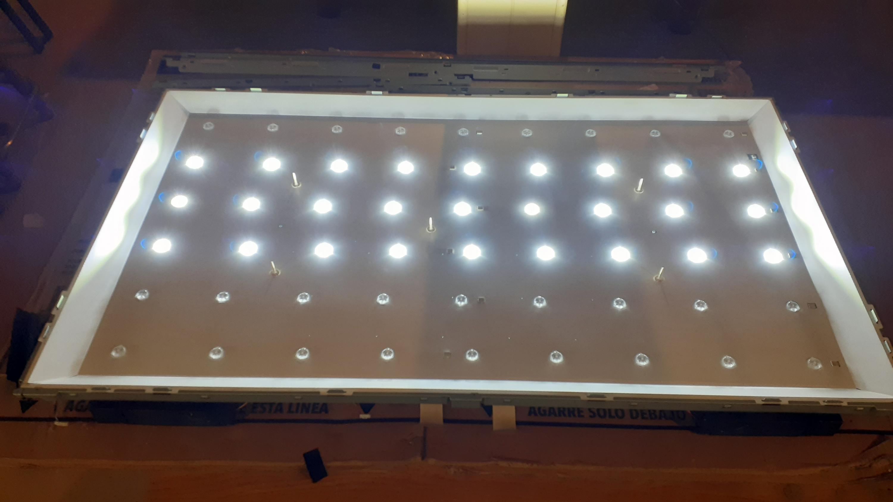

                            I just tried all of those different settings, and also plugging into outlet. No change. I suppose the only option I have is to take the panel apart again and try to get the Backlights on with diffusers in place without the screen.
                            The only way I could see it being an led strip issue is if the voltage is governed by the preceding led. That would mean the very first led in that strip coming from the plug would have to be "weak", limiting the rest of the row to that same voltage. I'm sure this isn't how it works though, because a burnt out LED in the middle of a strip doesn't prohibit the following LEDs from working. I find it unlikely that the entire row (L1/L2 AND R1/R2), randomly connected together out of dozens of possible configurations, would be subpar in comparison to the rest. IF it IS possible that the first LED is undervolted and limiting the rest after it, that would make sense.

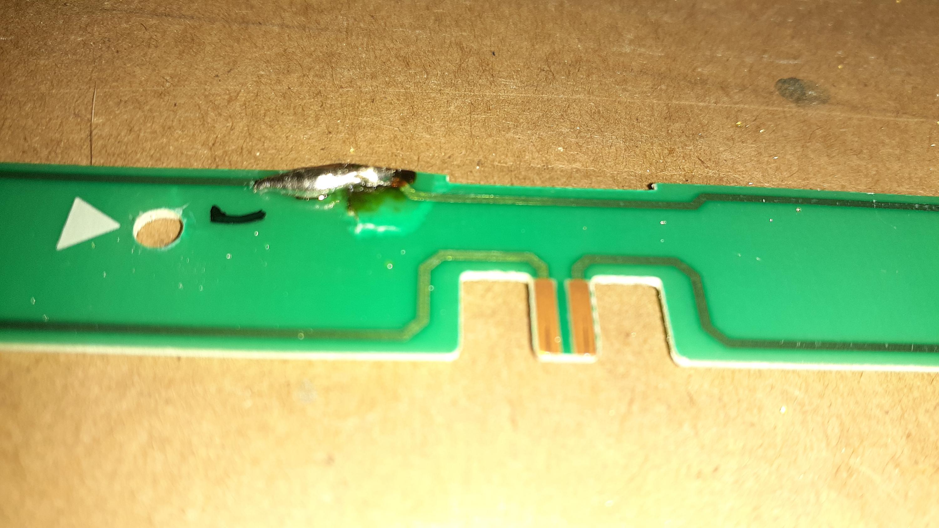

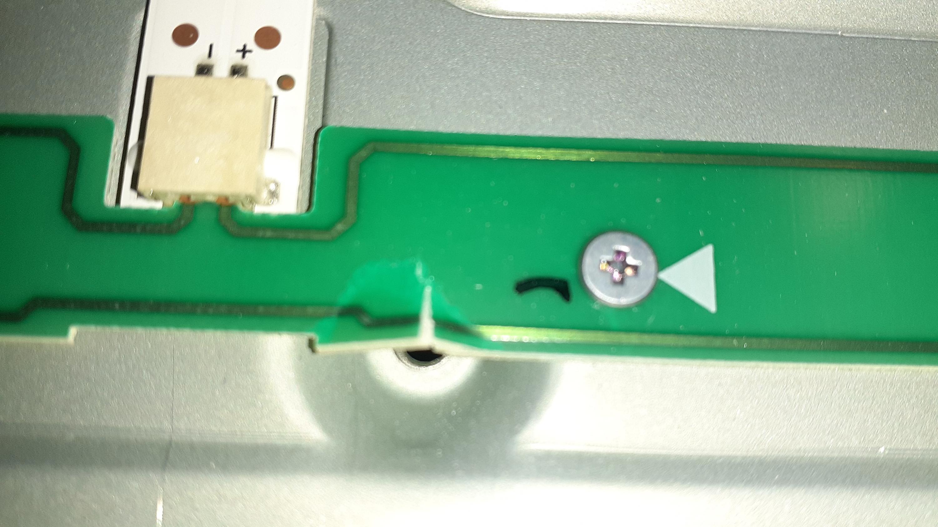

                                      Will I finally fixed it! The picture are attached and they pretty much say it all... The broken trace was unexpected, but nonetheless fixed.

                                        That would do it. Good to here it is Finally fixed. Looks like a screw was installed in the wrong place.

                                          Damn, I thought there was strips that were not lighting up in post #16, 3 of them looks like, so who put that screw there??
