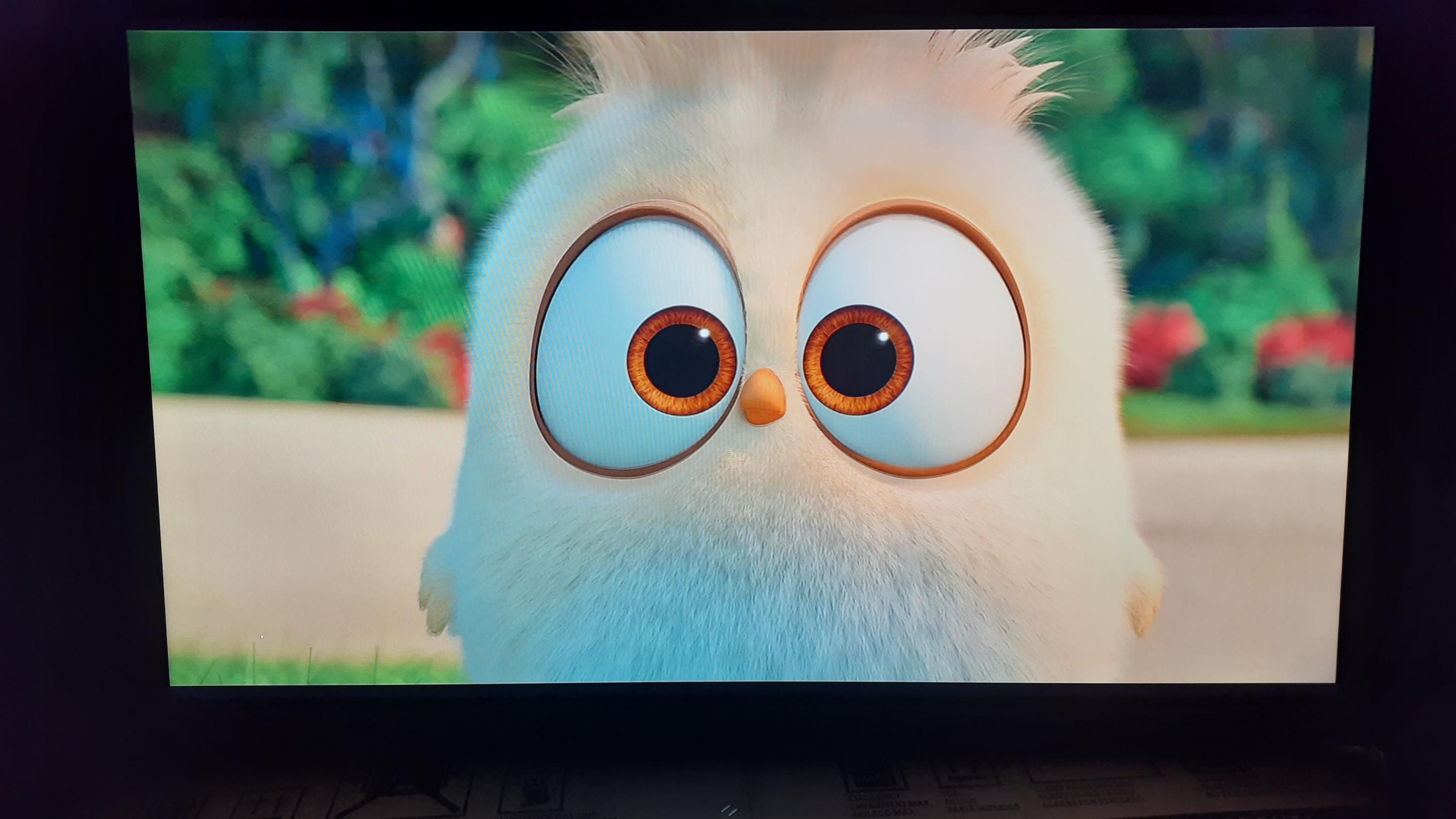

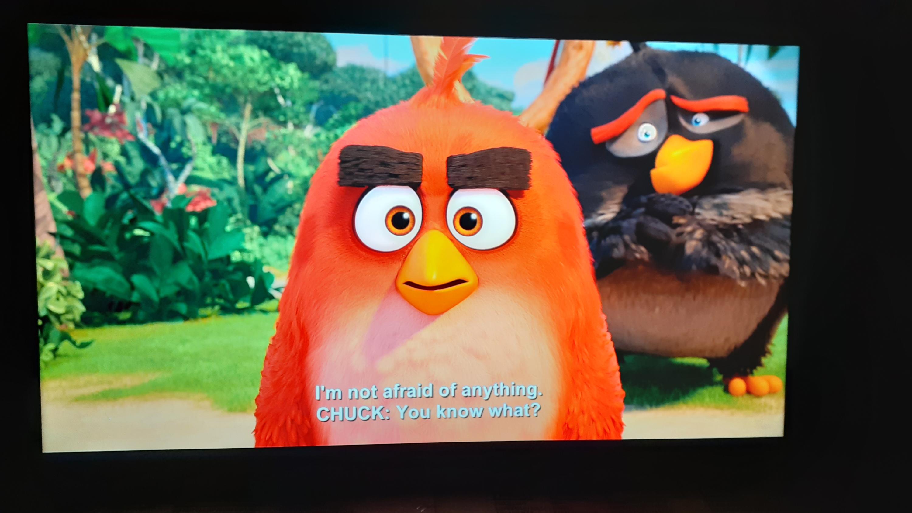

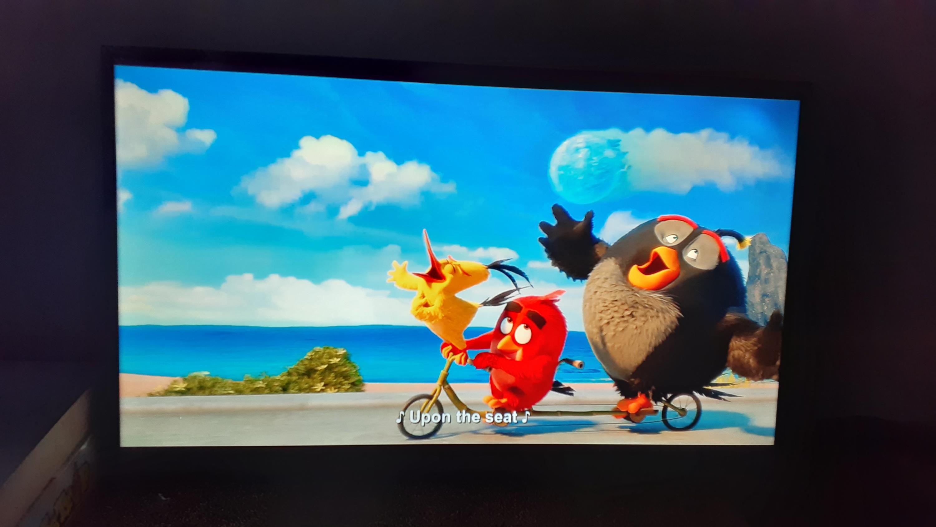

          BREAKING NEWS!!!
          I took it apart again lol.. everything was great except the top part of the screen had shadowing and I just couldn't settle with it. I took it apart again and religiously taped down the reflector, somehow STILL missing one corner, however I'm satisfied enough that I do not feel the need to open it again before and after pictures are attached.
          And this is at 55% backlight! This TV actually has a gorgeous picture for what it is!
