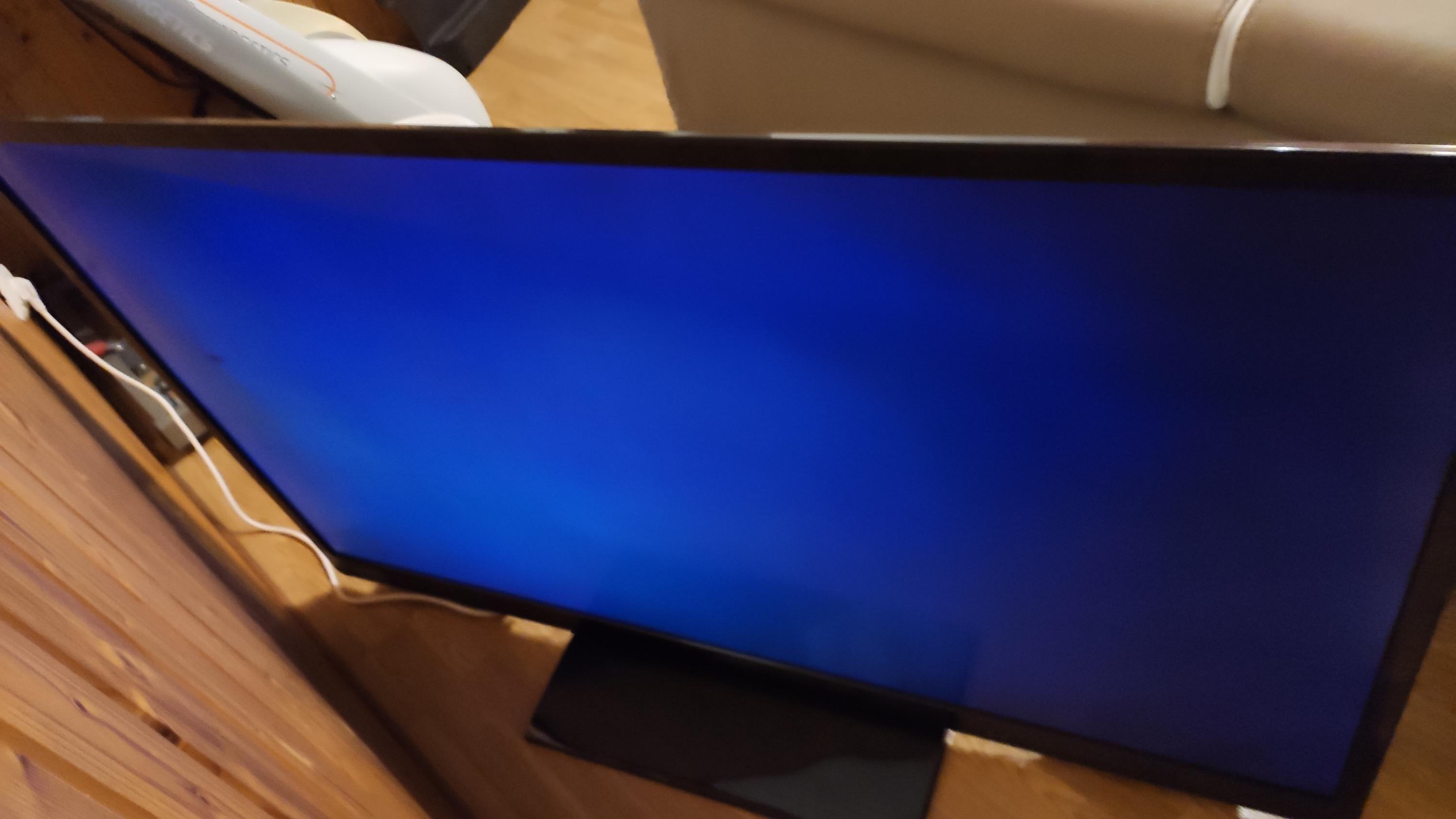

      Re: TV Sharp AQUOS LC-60LE635E TV not power ON
      Nope not power ON look the video
      https://youtu.be/v4qdOZoc09E
        #43
        Originally posted by markolino View Post
        here's a try on your theory a little earlier.
        first disconnected one flat cable.
        error equals black screen light flashing. 2 slow 5x short
        then i plugged the flat cable back in and unplugged the next, same error black screen light flashes....
        so the led panel is ok?
        is this "observation" correct.... note "light flahses..."

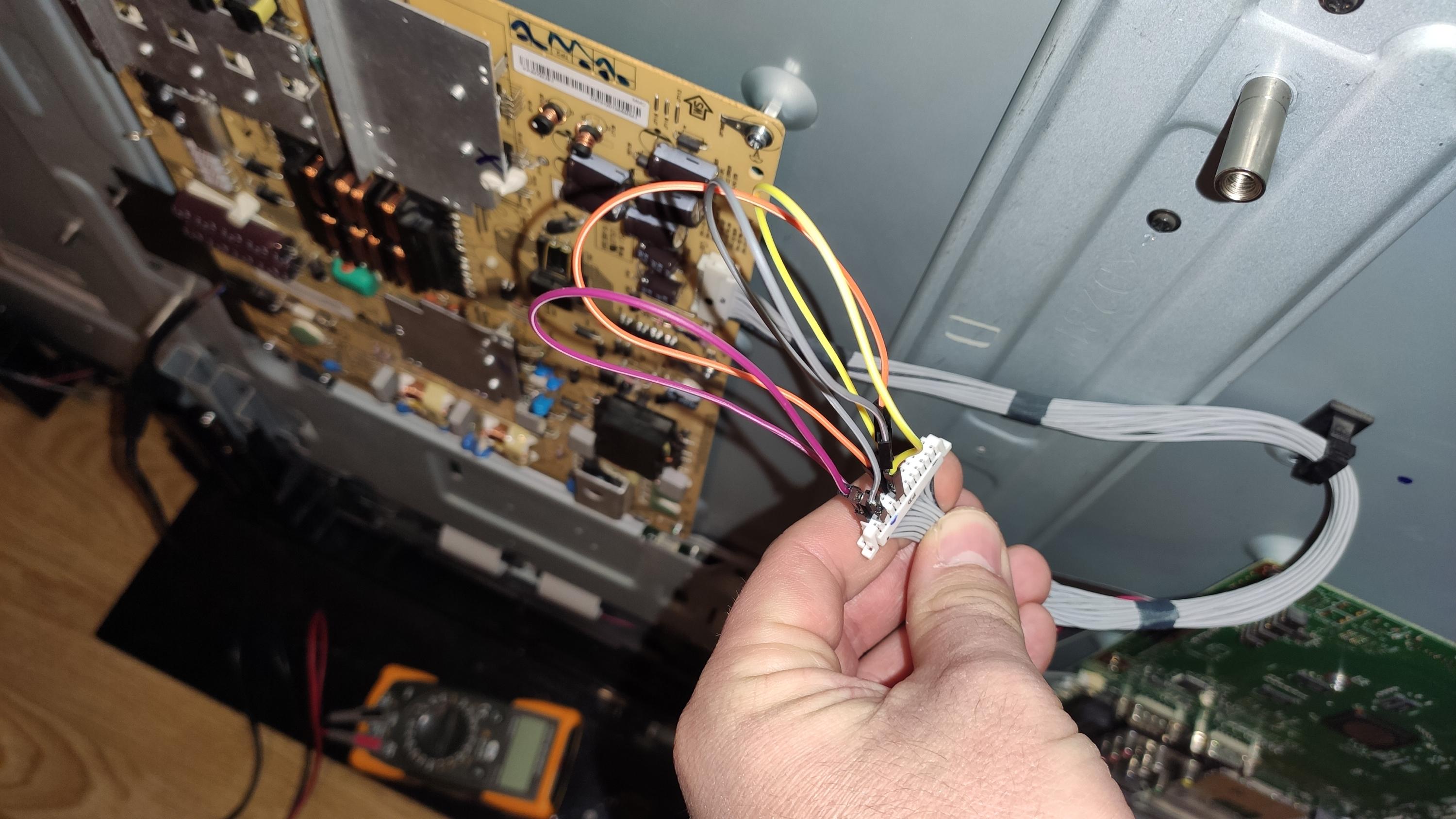

                anyone know how to force the LCD panel to turn on the LED lights on TV only whit PowerBoard ??
                  #48
                  here i managed to force the powerboard to turn on the led lights
                  i think they all work.
                  the voltage gives 178V on each line
                      This is, of course, not the reason for the TV not to turn on
                      I forced the lights LED only with the power board.
                      What do you think about the lights? do you think they are burned out?
                      on the upper right
                        #51
                        When you forced the power supply ON, what is the voltage on EACH pin of L1
                        Pin1 LED1+
                        Pin2 LED1-
                        Pin4 LED2-
                        Pin6 LED3-
                        Pin8 LED4-
                        And Yes, I think you have burnt out led's on the right side of the panel.

                          #52
                          Look at the pictures. So I forced him to turn on the LED power
                          I have 180V power on each + wire
                          hence 4x 180V
                          Pin1 LED1+ =180V
                          Pin2 LED1-
                          Pin3 LED2+ =180V
                          Pin4 LED3-
                          Pin5 LED4+ =180V
                          Pin6 LED2-
                          Pin7 LED3+ =180V
                          Pin8 LED4-
                          Do you think I turned on the lights?
                          I got that kind of thing that lightning damaged him
                          storm.

                                      #58
                                      in post 52 you have measured the + voltages and missed the - voltages can you test these
                                        #59
                                        hence 4x 180V
                                        Pin1 LED1+ =180V
                                        Pin2 LED1-
                                        Pin3 LED2+ =180V
                                        Pin4 LED3-
                                        Pin5 LED4+ =180V
                                        Pin6 LED2-
                                        Pin7 LED3+ =180V
                                        Pin8 LED4-
                                        storm.
                                        You must have:
                                        Pin1 LED1+ =80-90V
                                        Pin2 LED1-
                                        Pin3 LED2+ =80-90V
                                        Pin4 LED3-
                                        Pin5 LED4+ =80-90V
                                        Pin6 LED2-
                                        Pin7 LED3+ =80-90V
                                        Pin8 LED4-
                                        each led backlight strip is formed from two lines of 17 leds in paralel .....
                                        leds have Vf=5.4-5.6V ..... this is a leds backlight stripe https://www.aliexpress.com/item/3302...3ff94c4duF6nD3
                                          #60
