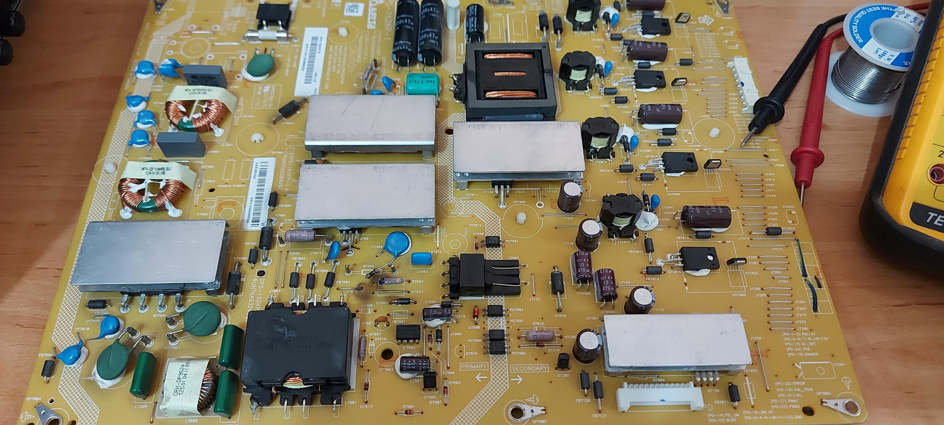

                can you post a good clear picture of the area?
                  #88
                  Re: TV Sharp AQUOS LC-60LE635E TV not power ON
                  Please find attached a pictures of the power supply board.
                  Thanks again for all your help.
                    #89
                    did you mean D7905 instead of D7908? D7905 looks a little beat up, did you test it or change it out?
                      #90
                      D7905 when tested with a multimeter looks fine. The black stain visible on the picture is due the spark done by R7900.

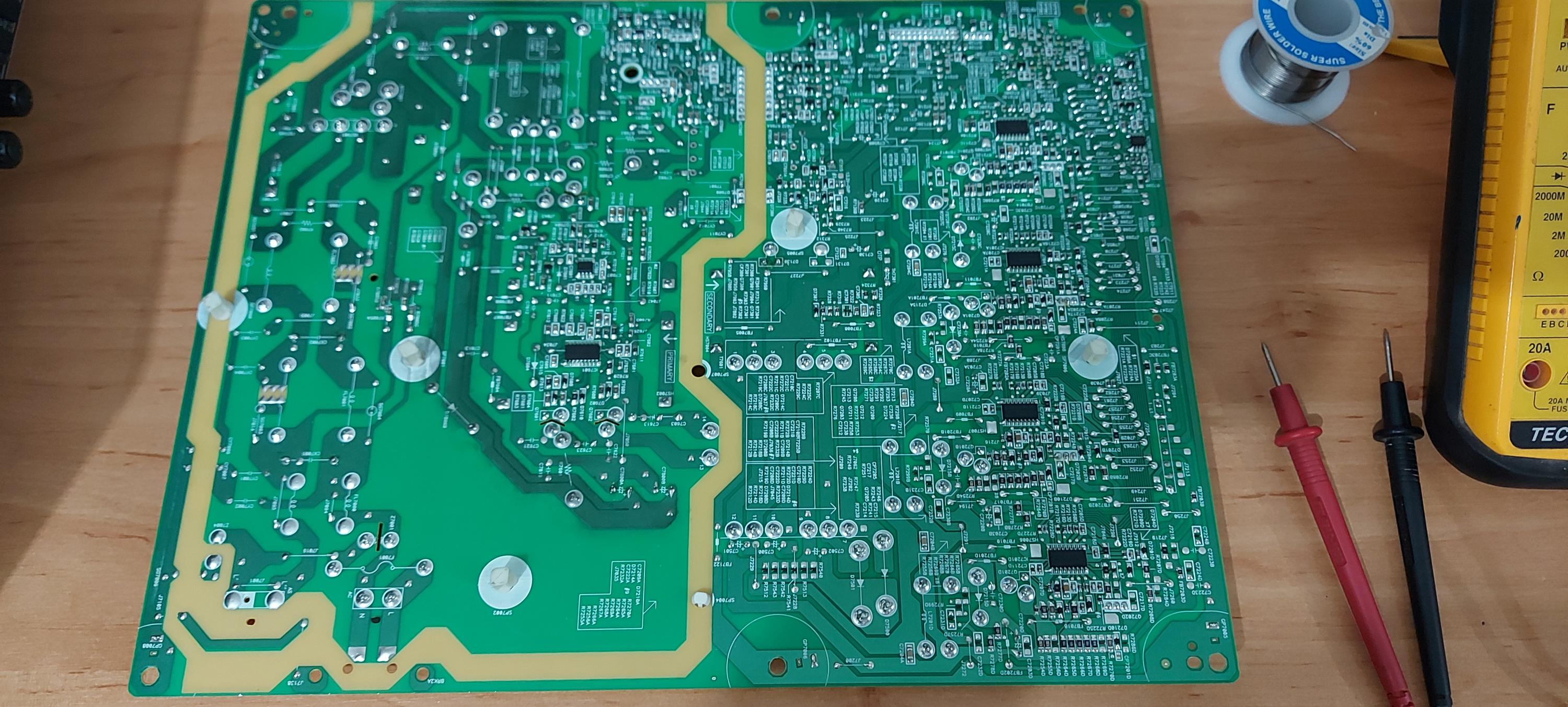

                            Can I see a photo of the other side of the board. Check the component with three legs under the heatsink.

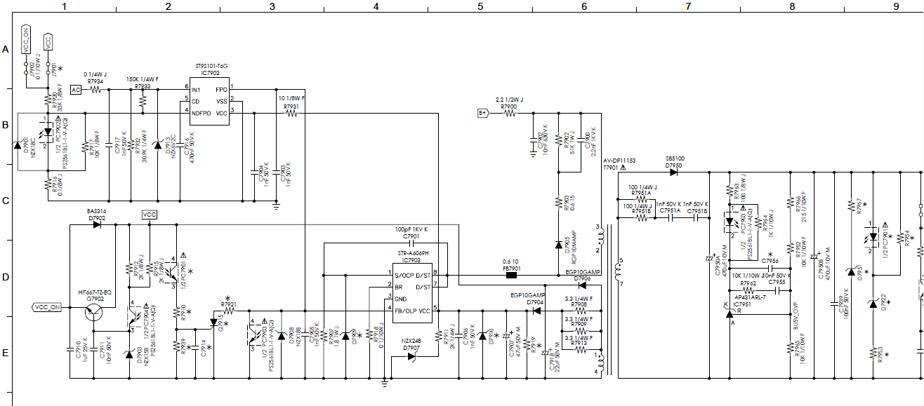

                                  Please find attached a picture of the other side of the PCB. Attached please also find the circuit of the area where I am having issues maybe it helps you in helping me identify where the problem is.

                                    I have just found low resistance on capacitor c7901 and instead of 100pf it's capacitance is 30pf. Could it be this js the main problem shorting IC 7903 and R7900?
                                      #98
                                      could very well be, change it out and see what you get, also measure it out of circuit if you didnt, to be sure.
