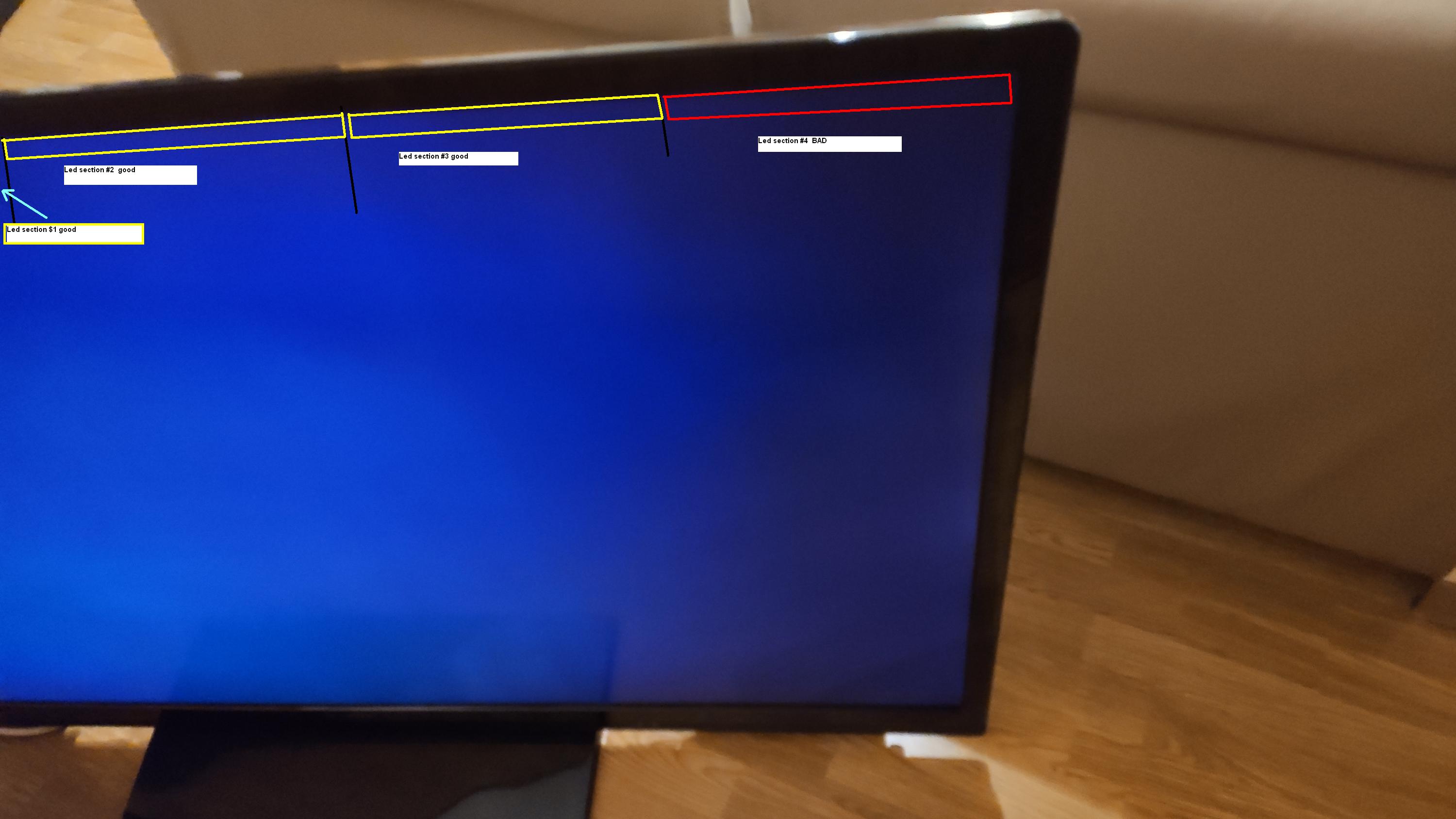

                          Don't start ripping off tabs, If you look at the screen pictures you provided, when you forced the led's ON, you only have 3 of the 4 sections that lit up. This panel has 4 edge lit sections. Section number 4 is not lit

                            First of all, I can manage to turn on the Tv, when I manage to do that I will go into the purchase of new led strips.
                            I ordered another T-com plate. When I get it, I'll report it to you
