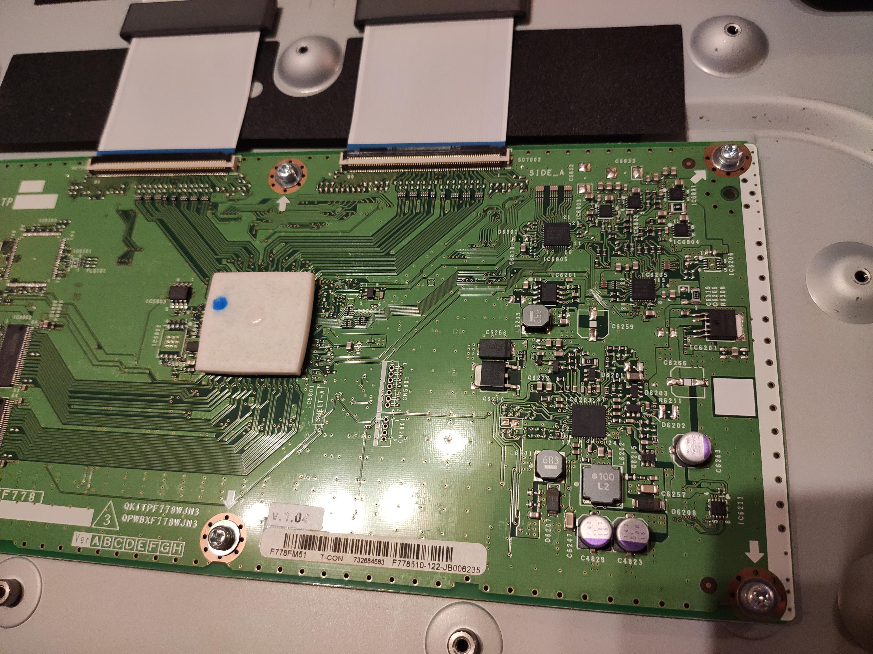

        Don't heaton main CPU....from SM- high-speed blinking-Flashes 5 times mean -Panel power supply error....check LCD Power Controller....
          Re: TV Sharp AQUOS LC-60LE635E TV not power ON
          what can i measure on a T-com controller?
          thanks

            Just look attachment file....
              It is not possibile to repear this board !
              Too demanding. I'll try to find a new one.
              I look on the internet but I can't find anything .. it's crazy!

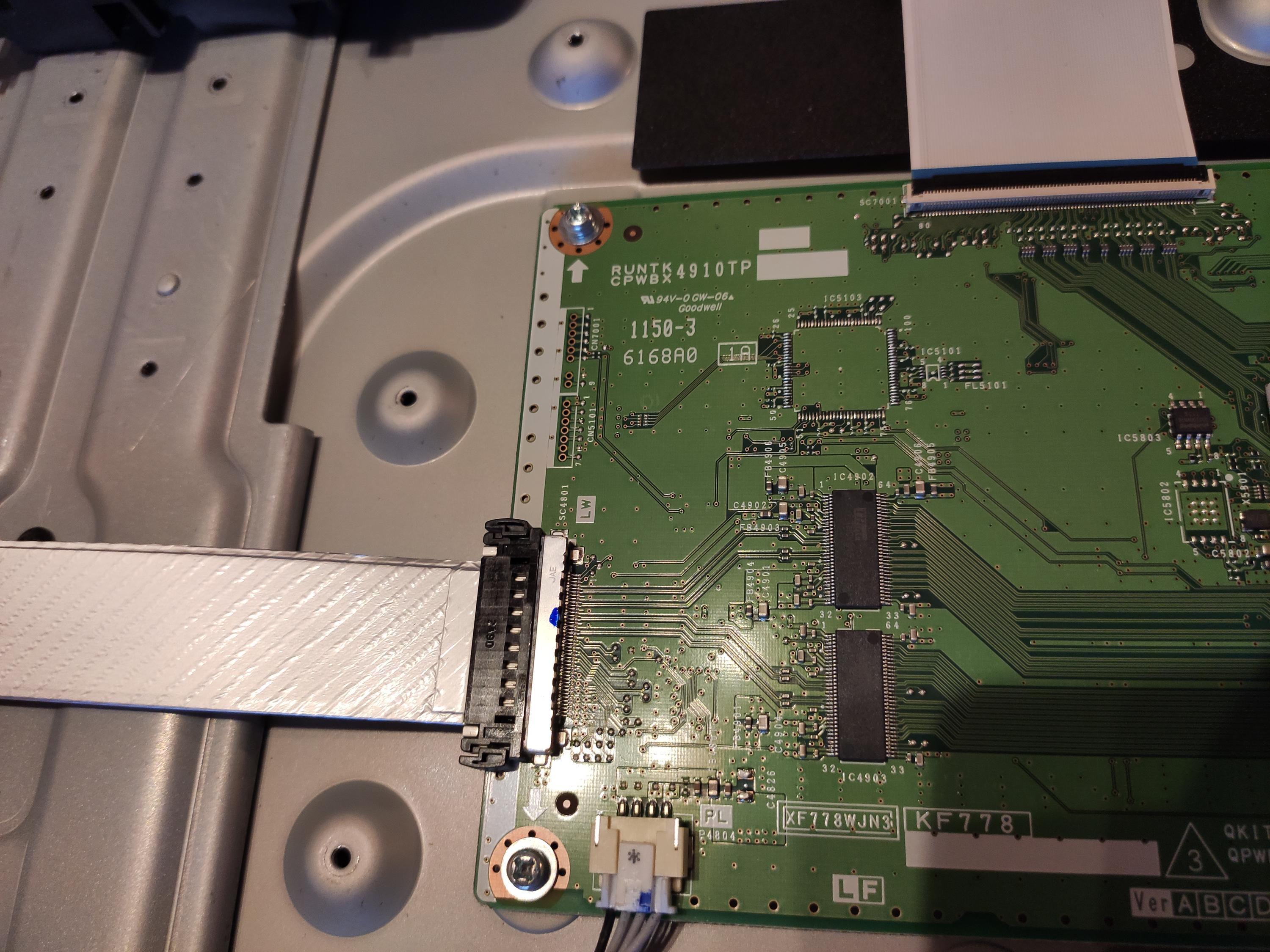

                  Excuse me I do not understand well represented what you wanted to say with the right side of the T-Com board?

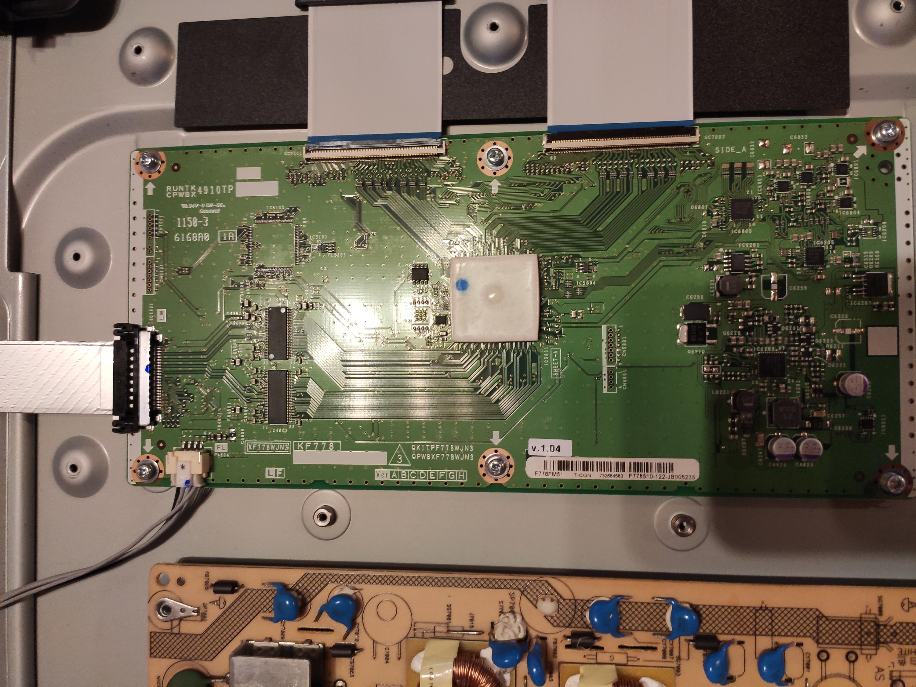

                      redo the test of removing one cable from the tcon to panel. Your observations don't appear good. Post a picture of the display that you get. Further, IF the set is in "error mode", you might have to follow a "force sequence" to get the set to start up correctly.

                        So, if I understand you correctly, did you say that I should disconnect the flat cable from T-Com again first and then the other, and that I should watch the light blink?
                        If I disconnect the T-Com kit from the Tv main board, it flashes the same 2 x long 5x short regardless of whether or not the T-com board is connected.

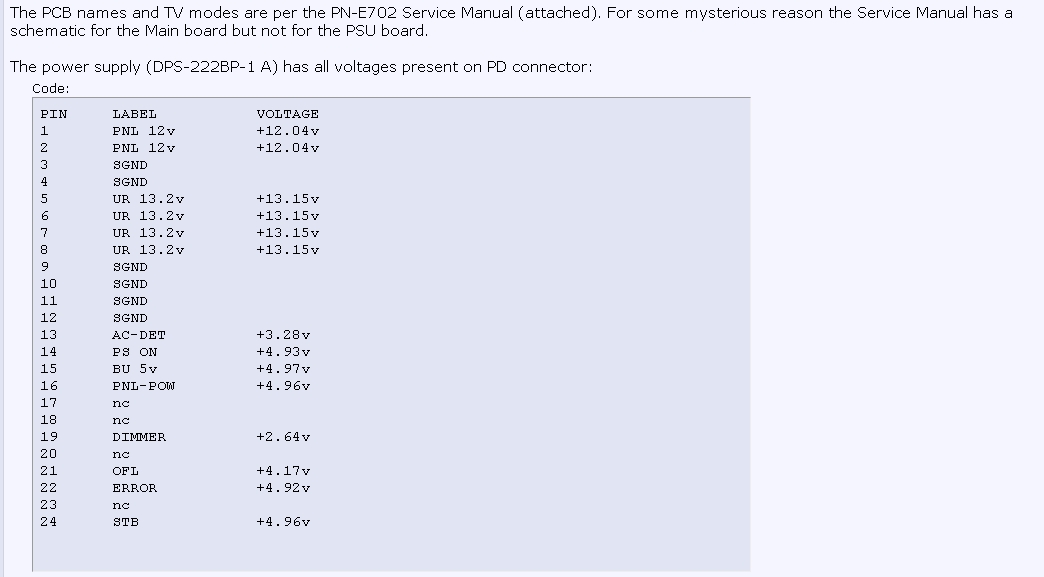

                            Are you saying after 5 seconds you do not even have Voltage at AC-DET pin? Are you 100% sure of that?
                            Also you do not have BL-ON, DIM, ERROR.. Voltages.
                            See typical Voltages on PD pin.
                            Are you still getting the same blink code?
                            Are you 1005 sure about your Voltage measurement?
                            Do you notice if the backlights even come on for seconds? You may want to monitor the STB pin and the Error pin when TV is first turned on each time.
                            Also already try resting using the remote, I do not remember the exact key combination.
