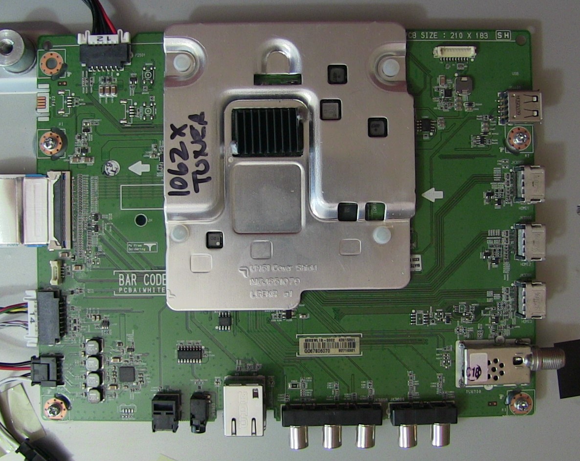

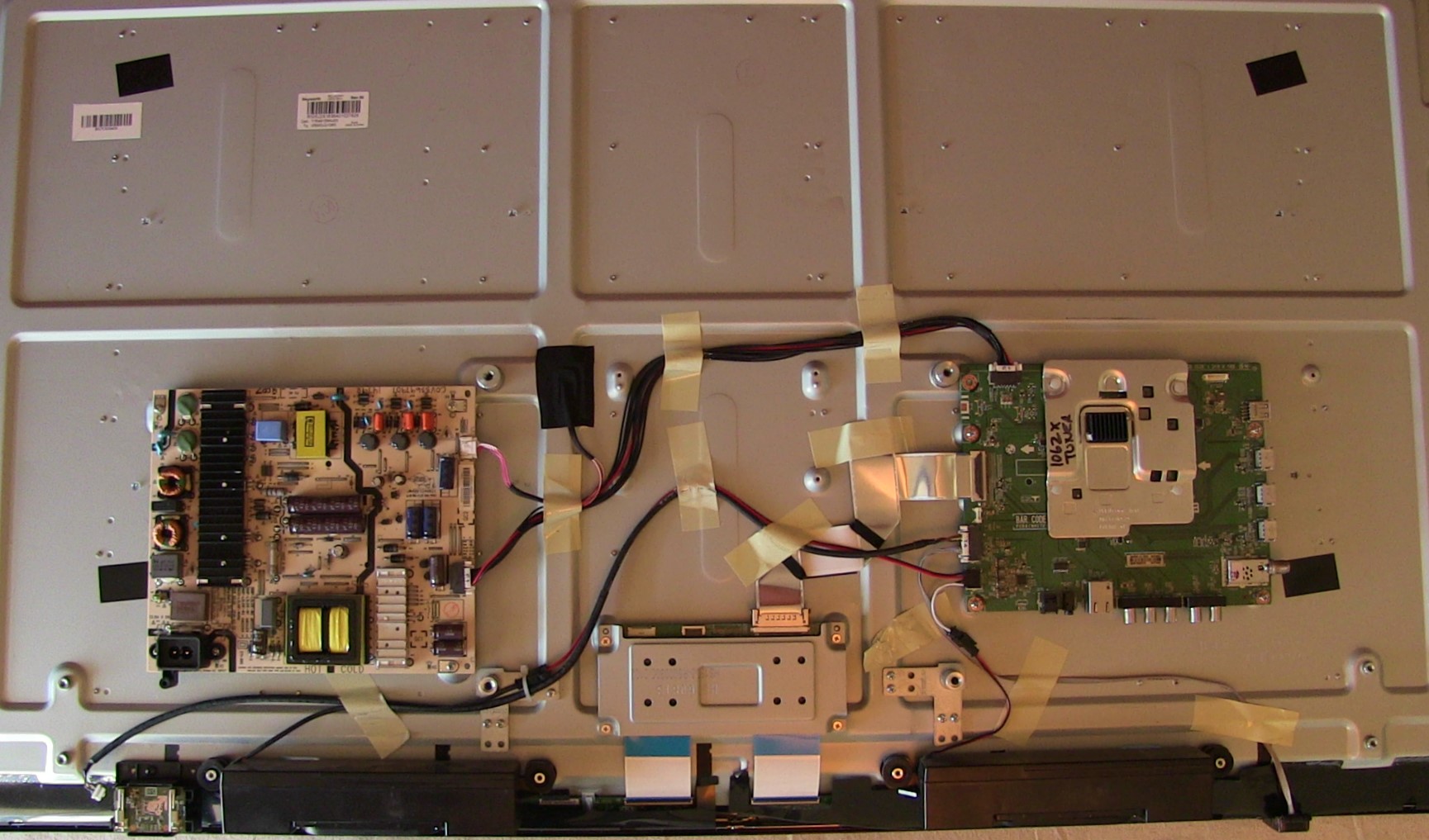

    Hello everyone!
    Here's the run-down on this TV. Pictures posted below.
    * LG TV model# 50UH5530
    * Symptoms: Turned off by itself and appeared to be unresponsive.
    * After power reset TV tries to turn on with backlight flash
    * Occasionally will turn on, boot and show picture/sound.
    * TV only turns on when 13V pin reads 10.2V stable in stand-by, with main board connector attached or detached
    * When power button is pressed and stable 10.2V is present 13V pin comes up to 13.2V stable
    * When it shuts off by itself 13V pin shows unstable voltage from 8-12V
    * The problem occurs on 3 separate power supplies and 2 separate main boards
    * Backlights are less than a year old, ShopJimmy.com replacements
    * Backlight settings have been at 66 (on a scale of 100) since new backlights installed.
    Ordinarily I see a backlight flash on these and expect the backlights to be bad....but they're not even a year old. The TV actually worked for a day-and-a-half for me, came on, picture, sound, but eventually faulted and went back to the symptoms above.
    So the band is stumped here.....does anyone have any suggestions or ideas?

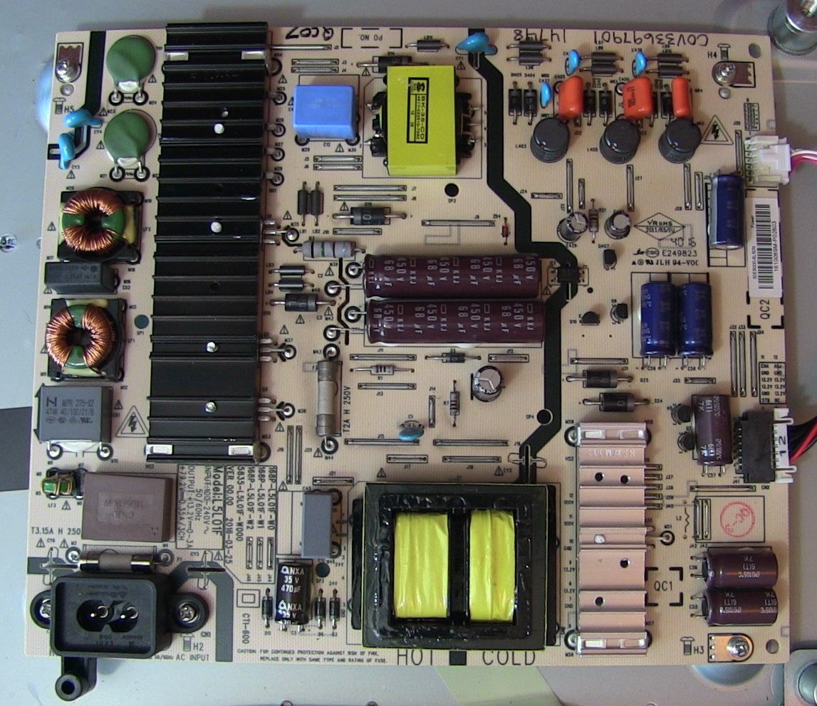

    Re: LG 50UH5530 intermittent unstable 13V on 3 separate power supplies, band stumped
    Further observation:
    With the original Power Supply installed voltage at the 13v pin in stand-by is a stable 10.2v. When the TV is powered on voltage raises to a stable 13.2v until after the backlight flash, then voltage at 13V pin drops to 7v stable briefly then becomes unstable from 8-12v.
    I have to be missing something here. I'm now wondering if what I'm seeing is this TV's way of going in to failsafe mode with a backlight fault?
    I'll be surprised, real surprised if those SJ backlights failed. If they have it's a first for me with SJ LED strips!
                You might have a bad, C5 or C14, these caps filter the vcc supply to the primary ic's, if they are weak, the VCC voltage can drop and the ic goes into standby/burst mode. This vcc voltage is also supplied to the optocoupler (photo cell side) so it can make the power supply think it was turned off
                    There likely is a change in the vcc voltage, check it across C5, it is the easiest to get at from the top. I was looking at a simlar schematic [168P-L5L01F-00] plus the trace side of this board, the vcc voltage may not connect directly to the optocoupler, It is hard to trace past R65 on the board.
                              If you tried 3 different power supplies with the same result, then it is very likely that an led on the strips is bad. and just because the came from shopjimmy does'nt mean they can't fail. Bet SJ gets them from ..... China
                                  Ok so here's how it turned out:
                                  The backlights arrived today....exactly 48 hours after ordering. ShopJimmy is awesome!!!
                                  I stripped this TV down to its skivvies and powered the TV on with the LCD/diffusers removed....the TV turned on....and remained on for 3 hours until it faulted. I tried to fire it back up and the bottom 2 rows of backlights did not flash. I confirmed it 5 times.
                                  After that I detached the electrical connectors from the bottom 2 rows of LEDs, tested them with the backlight tester on low and high current....and they all lit up. It's like deja vu.....I had a different TV of this model that did the exact same thing. I had to ask myself...."what am I, a sucker?" lol
                                  Since the bottom 2 rows failed to light I replaced them first with the new strips. The TV fired right up 5 times in a row. I installed the remaining new strips and it's now in testing.
                                  So I guess the 13v rail falls all to hell when the backlights fail. Lesson learned!
