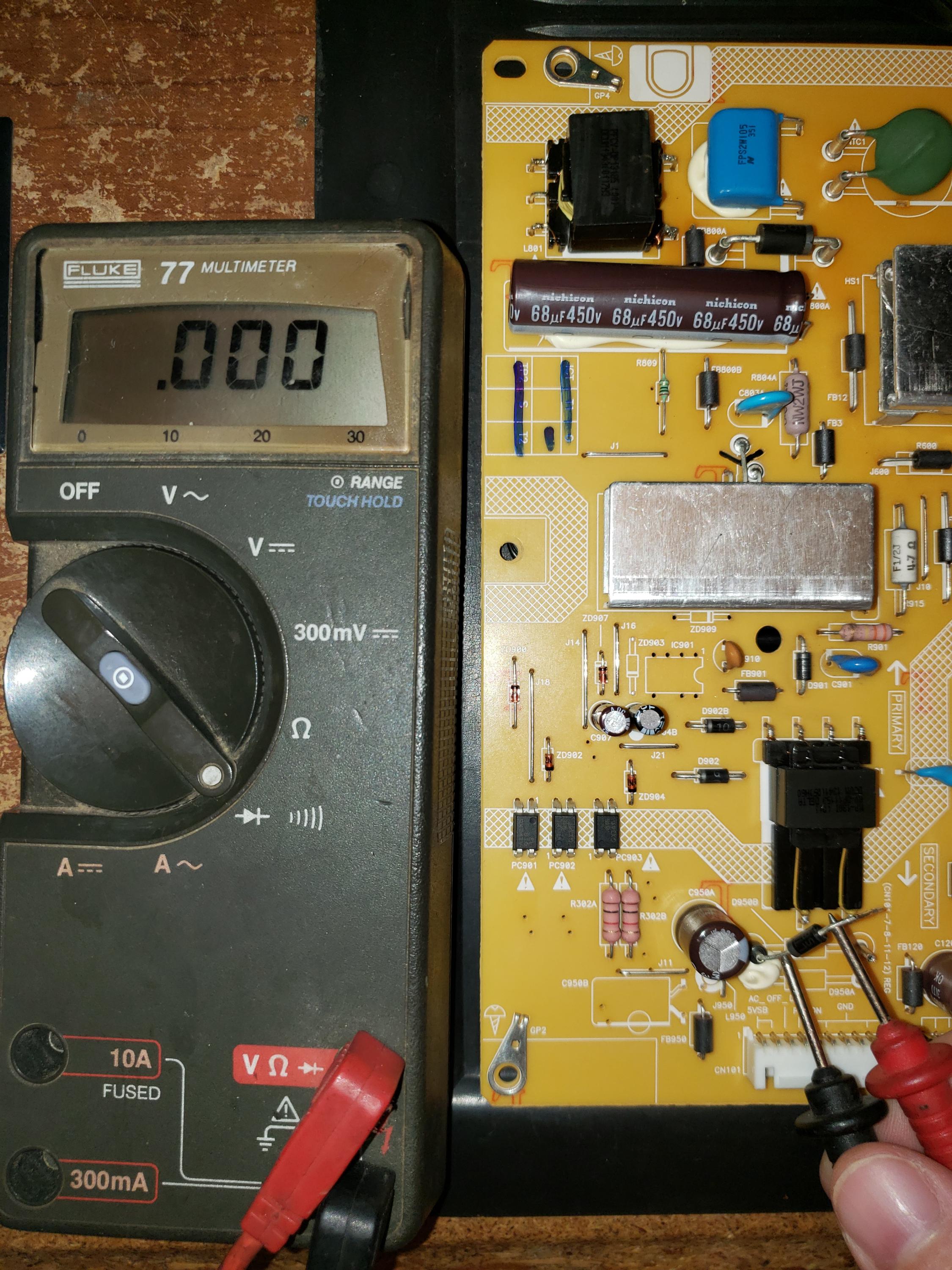

    How about the report in your post #1?
    "D950b read 00.5 Ohms & .000".
    Did you lift one leg and re-test it?

          After post #5 I wasn't going to but since I am in the middle of all my gear, any tips on desoldering that type of riser style mount?

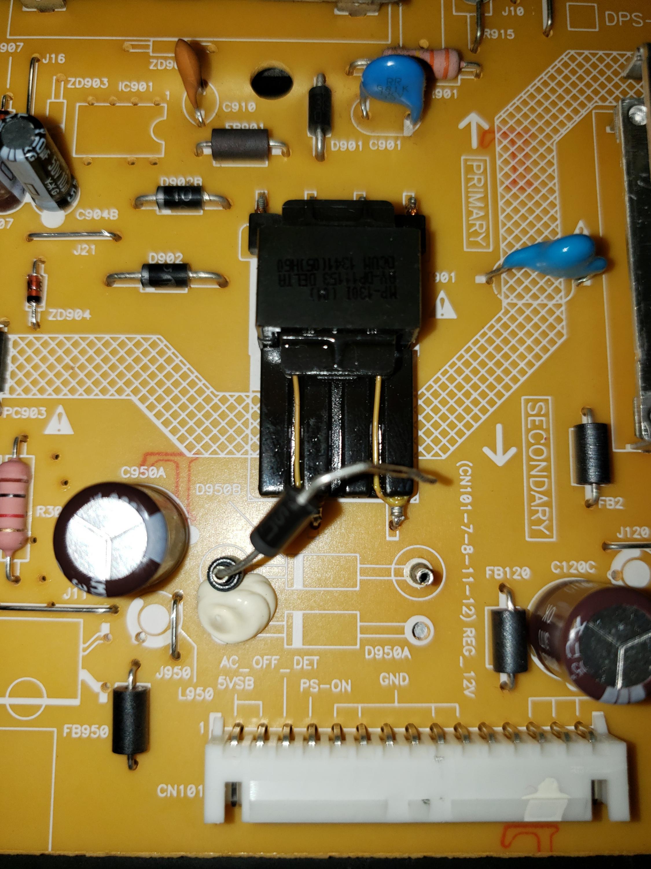

          Edit: It was not easy but I was able to free the leg of the diode on the riser.
          D950B = .000
          Where is a good place to source parts?

            Re: Vizio E480i-B2 Won't Turn On DPS-167DP IC901
            So D950b is shorted also. You can get most parts from Digikey, but for the ic you might need to get it from eeeebay/China
              Any chance of getting it from Digikey or another place. I'm not a big fan of ebay. By chance does anyone have another part # for LD7913JGM6?
              Also there are some variations of the diodes I really don't understand, like SB2100 vs SB3100, SR3100, SB3H100 E3 for that 3A 100V SCHOTTKY DIODE?
              And I don't know the wattage of the zener diode, I know it's 4.7v and I believe it is made by Vishay?

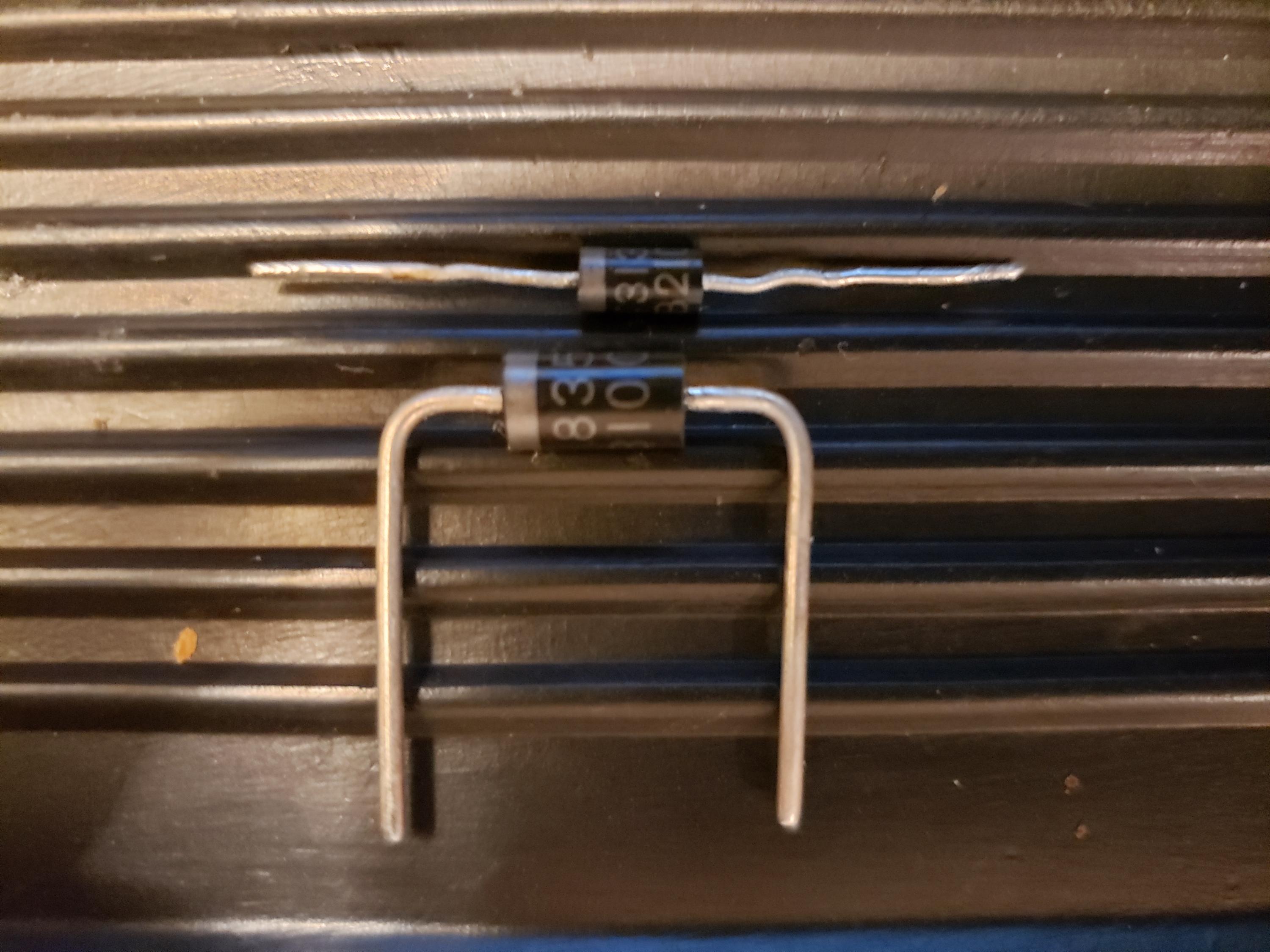

                                  #36
                                  Just got off the phone with the parts house, they couldn't find the part numbers on the original D950B schottky diode - lt3134 sb2100.
                                  And the data sheets for the 3A 100v SB3100 Diodes were all the thicker wire leads?
                                  So I found a SB2100E 2A 100v that matches a lot closer to the size specs of what I currently have to replace. I was so concerned with getting the right amperage and voltage the actual size I thought would all be the same.
                                  Nope, the new Zener is perfect though it tests .678 on the meter set to diode test. And so are the IC chips. Remember anyone who needs one message me.
                                  So for anyone else out there ordering a D950B for this board check the specs, you may have to get a SB2100 too.

                                    #37
                                    Zener diodes will usually check around .6xx, BUT remember, they zener (or clamp) at different voltages
                                    As for the sb2100 rectifier diode, there is no problem increasing the current and voltage, but as you found out the size can also increase. I would have just used the other holes without the standoffs.

                                      #38
                                      I was going to use the other holes and cancel my order but apparently I was 3 minutes too slow. The representative said there was nothing they could do once the order had shipped. I had only placed the order only 45 mins before that. It cost me another $8.79.
                                      So is the correct Schottky diode for this board really a 2A? and not a 3A. Because the size difference sure seems to point in that direction.
