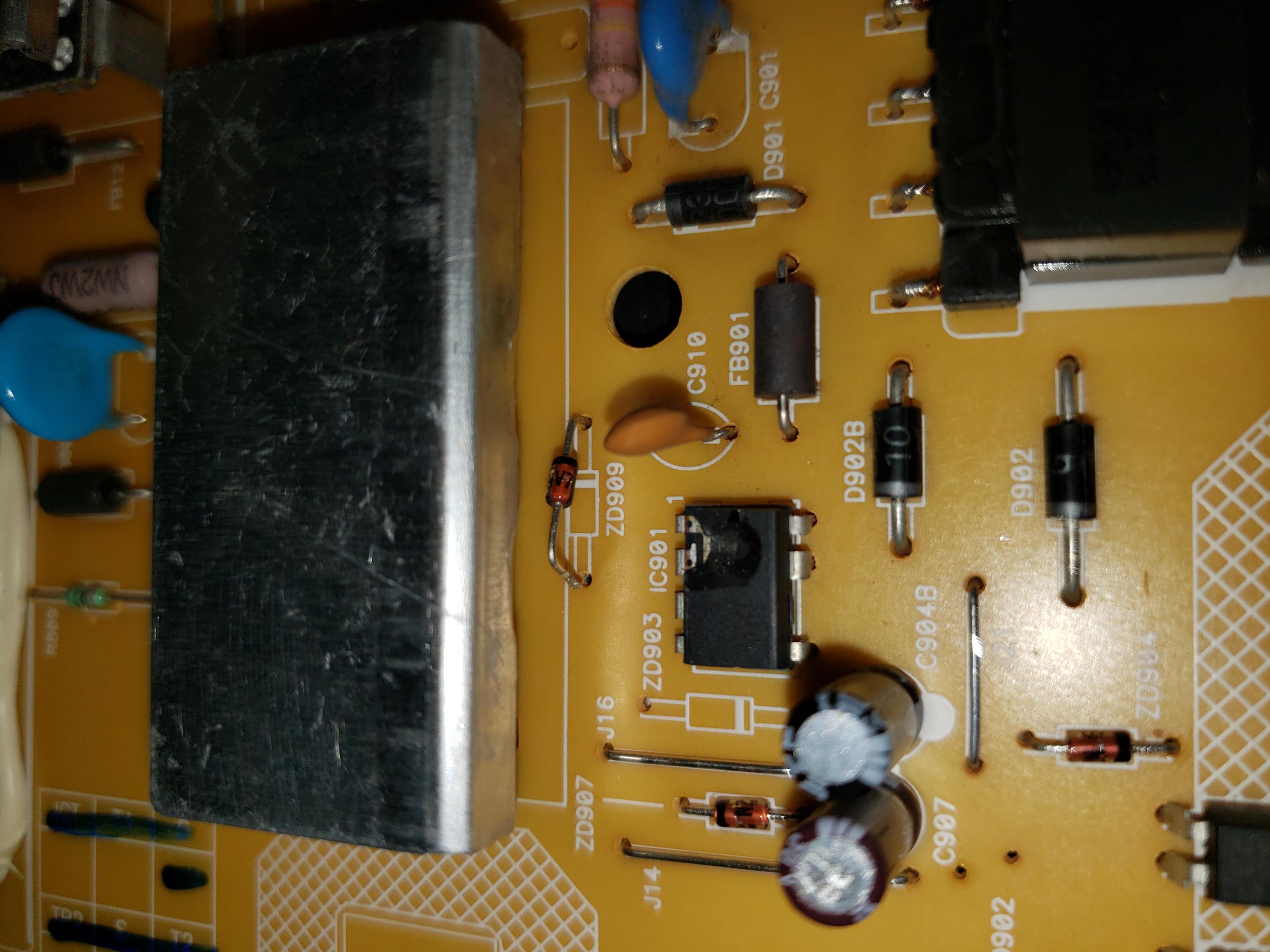

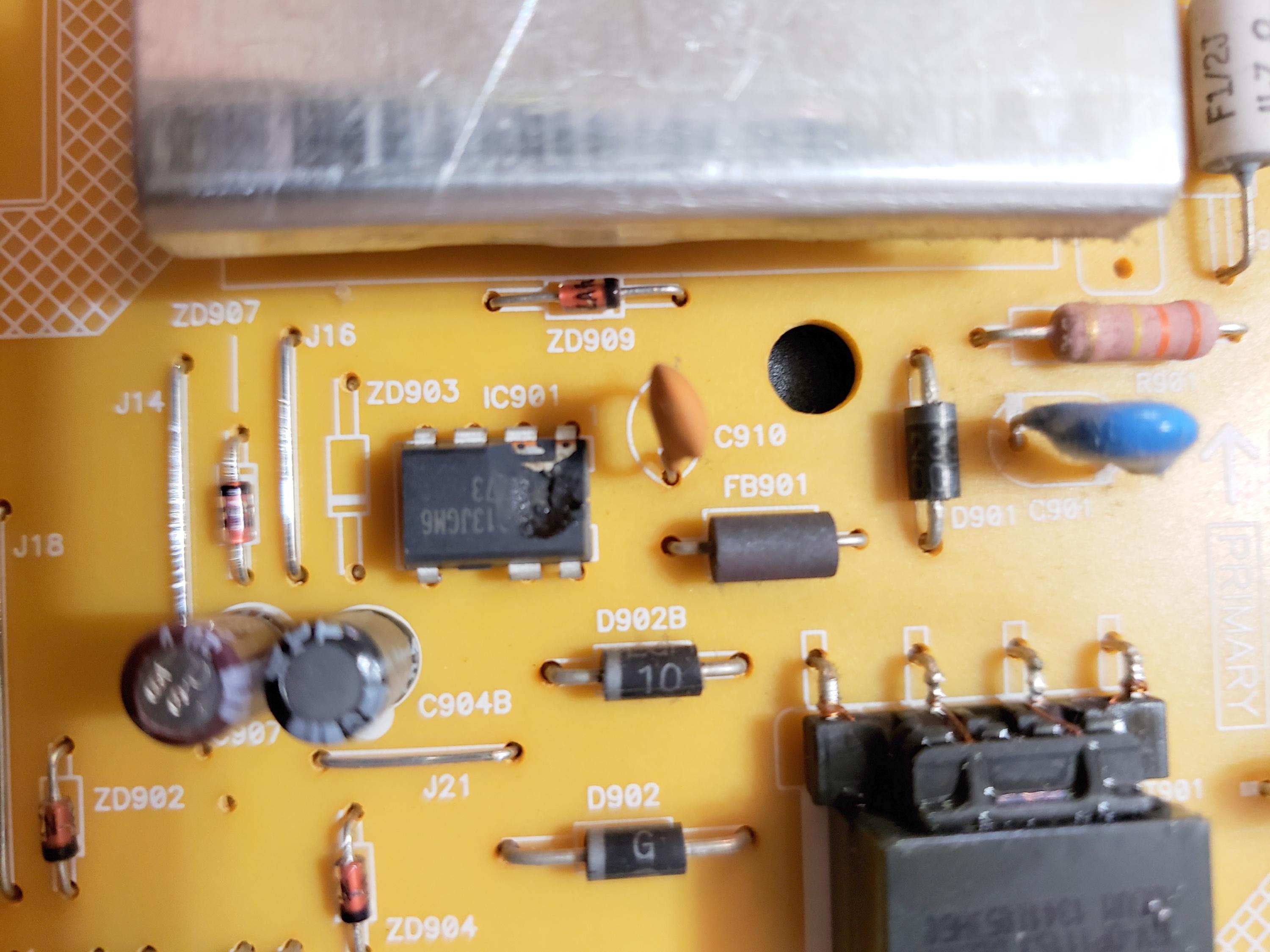

    Working on a Vizio E480i-B2 that won't turn on, no lights, nothing. I took the back cover off and found a broken component on the power supply board.
    (I did create a new thread, to help others with this exact TV & issue)

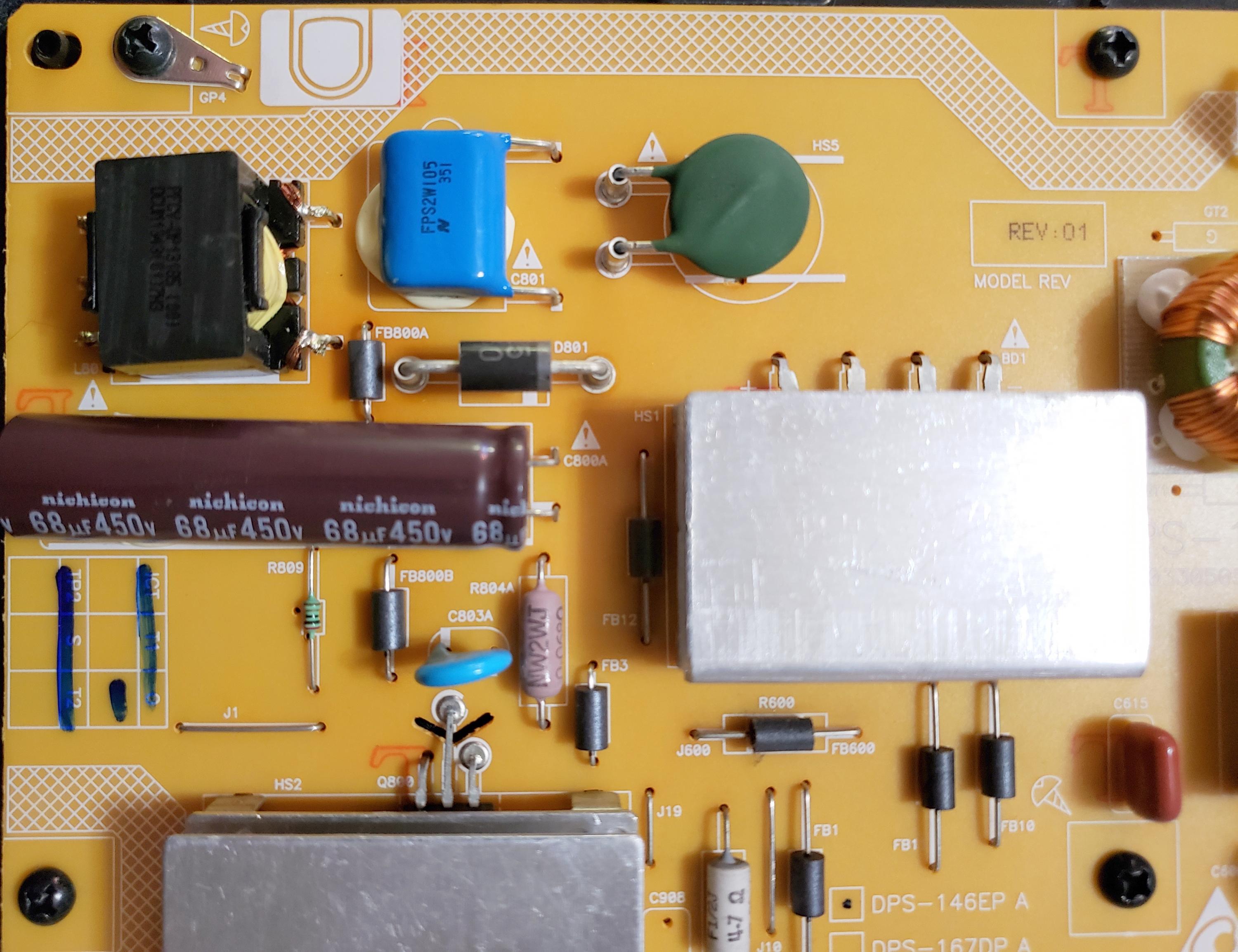

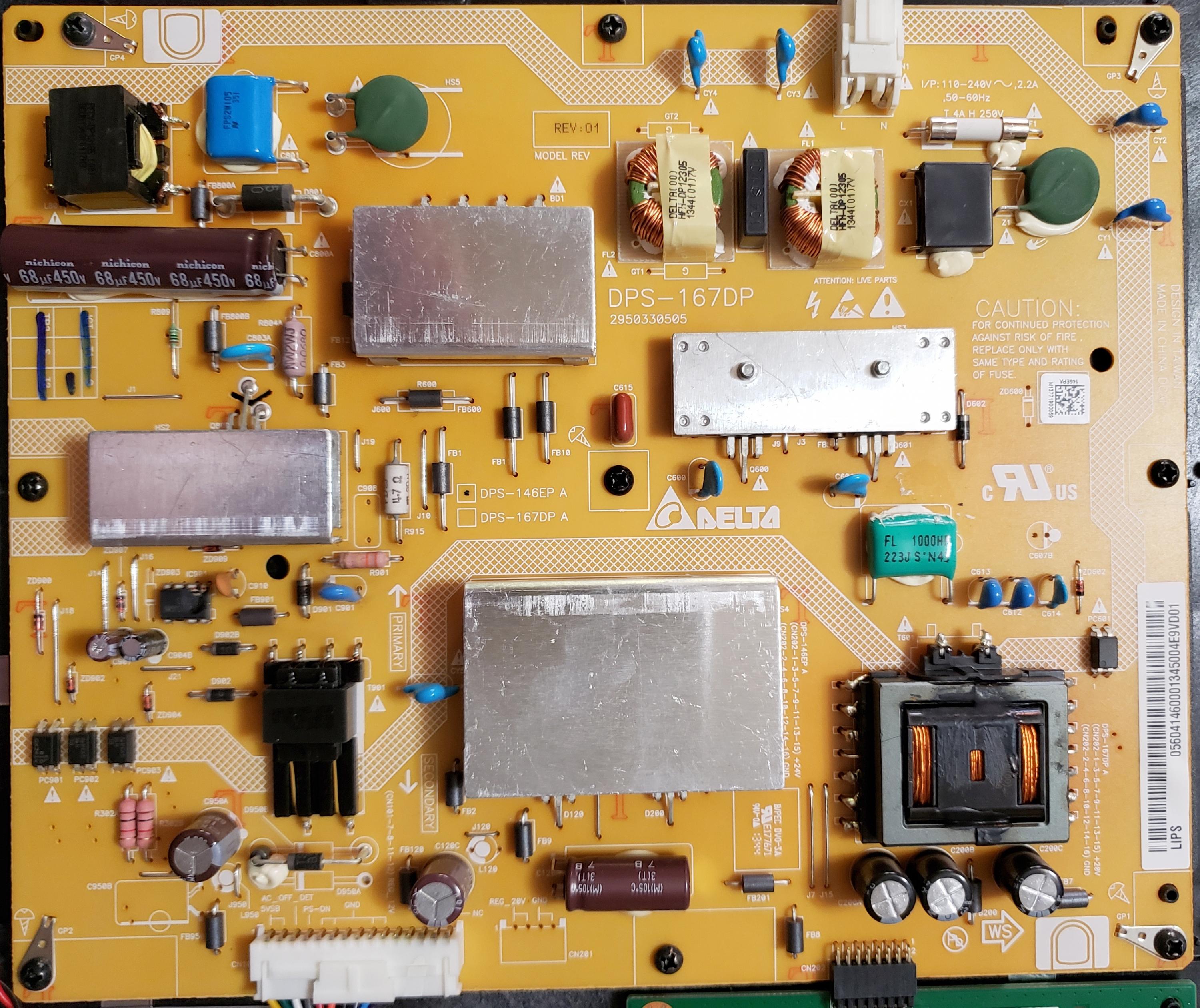

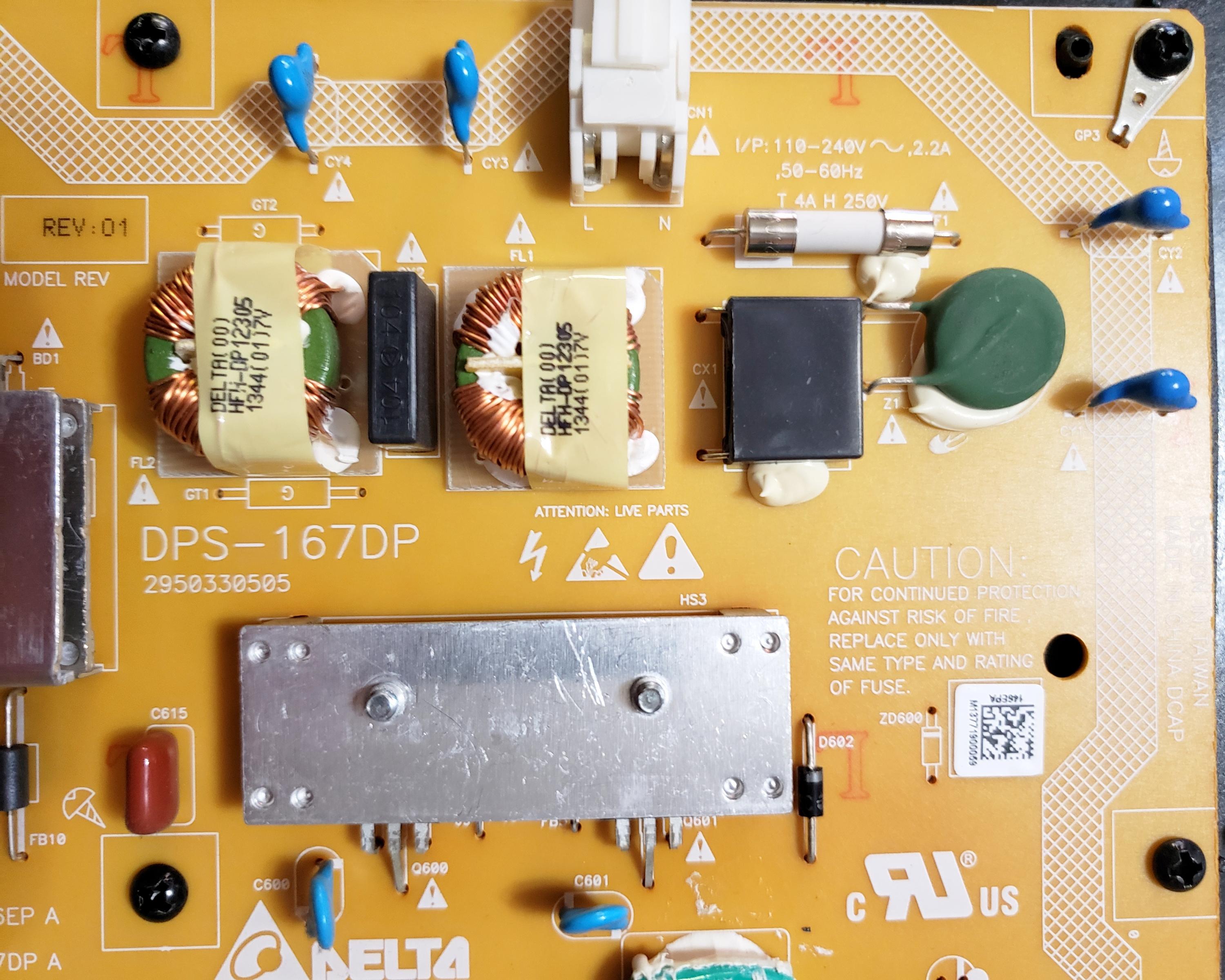

    The board is a Delta DPS-167DP 056.04146.000 and IC901 on the board has a large chunk of it missing. I believe IC901 = part #LD7913JGM6. I read the other two threads on here that had information about this issue to try and begin looking for other possible bad components.
    It seems I have three options:
    1. Buy a replacement board for $45+/-. I have not found any 056.04146.000 boards for sale, but I have found 056.04146.001's for sale. The two look identical, is there any reason I couldn't use the 001?
    2. Send the board in to be repaired $52+/-.
    3. Repair the board myself $12+/- plus whatever other parts someone could help me locate.

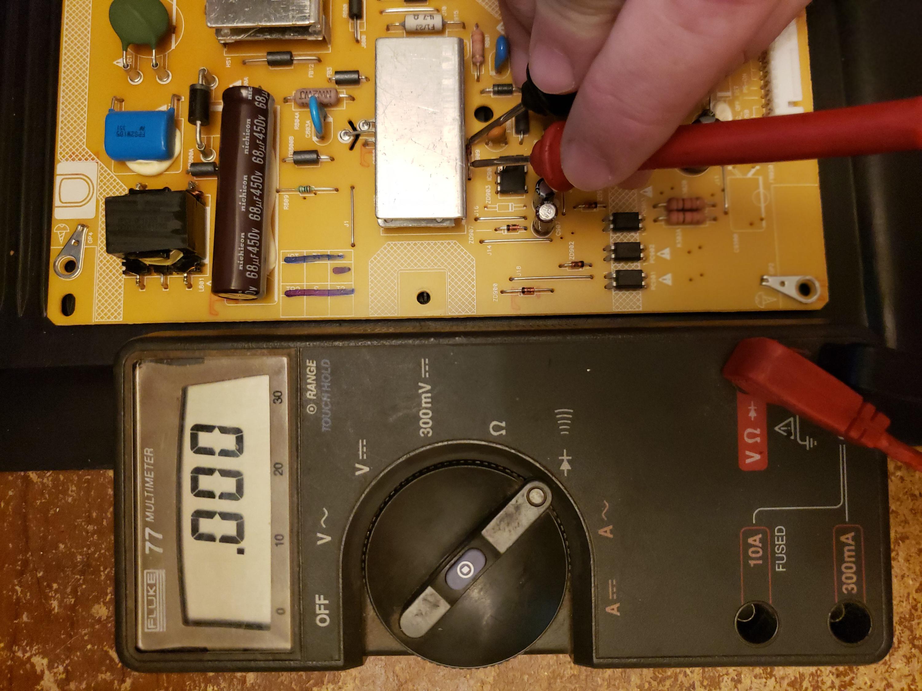

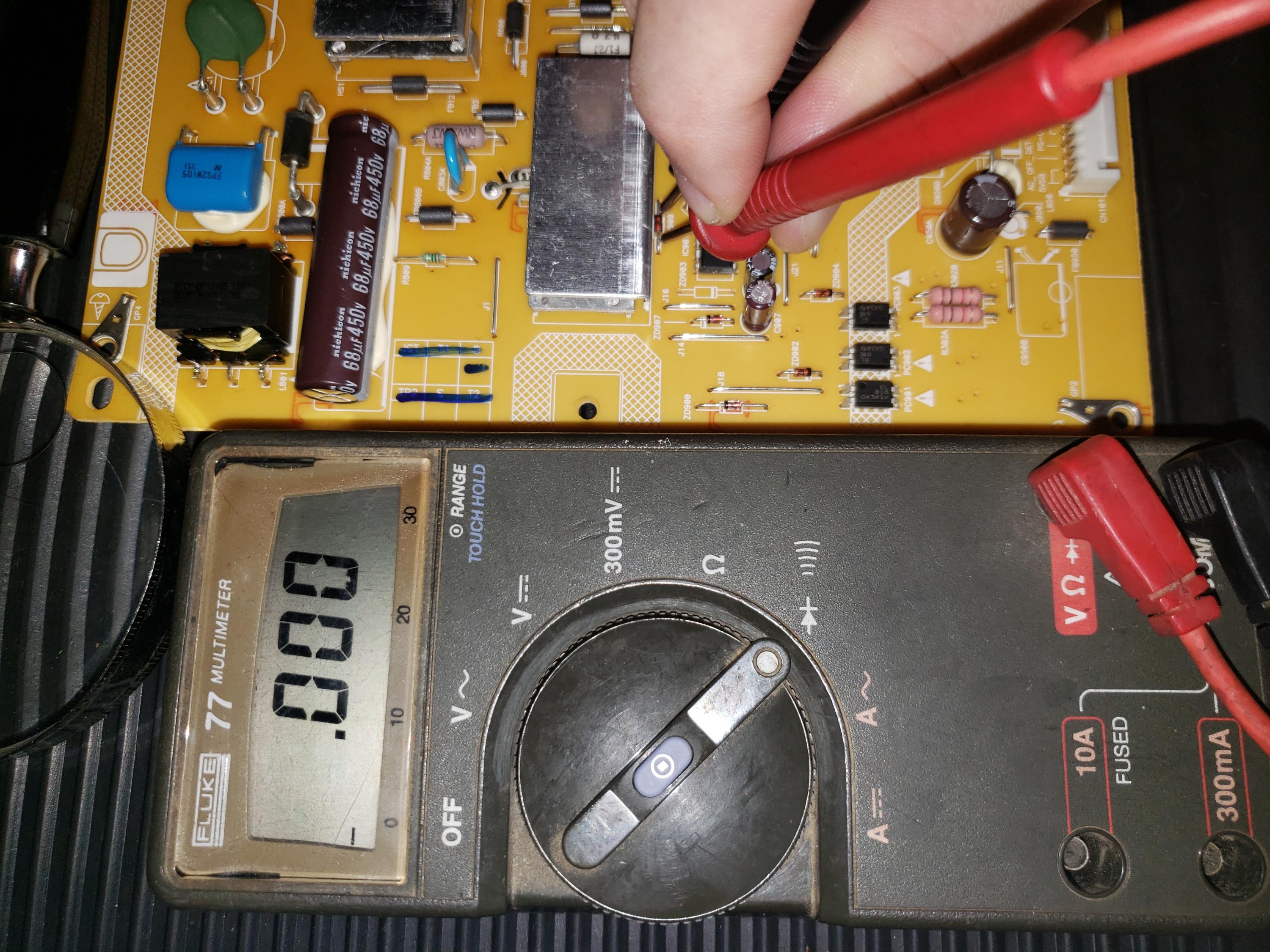

    So far I have tested R915 and it read 4.7 Ohms, R907A & B read 00.5 Ohms. D950b read 00.5 Ohms & .000 and beeped on Diode test setting when tested in either direction.
    I would like to know where else to look and what else to test.

    Diodes don't beep, lift a leg and see if it still beeps and .5 ohms is way too low, it's no good.

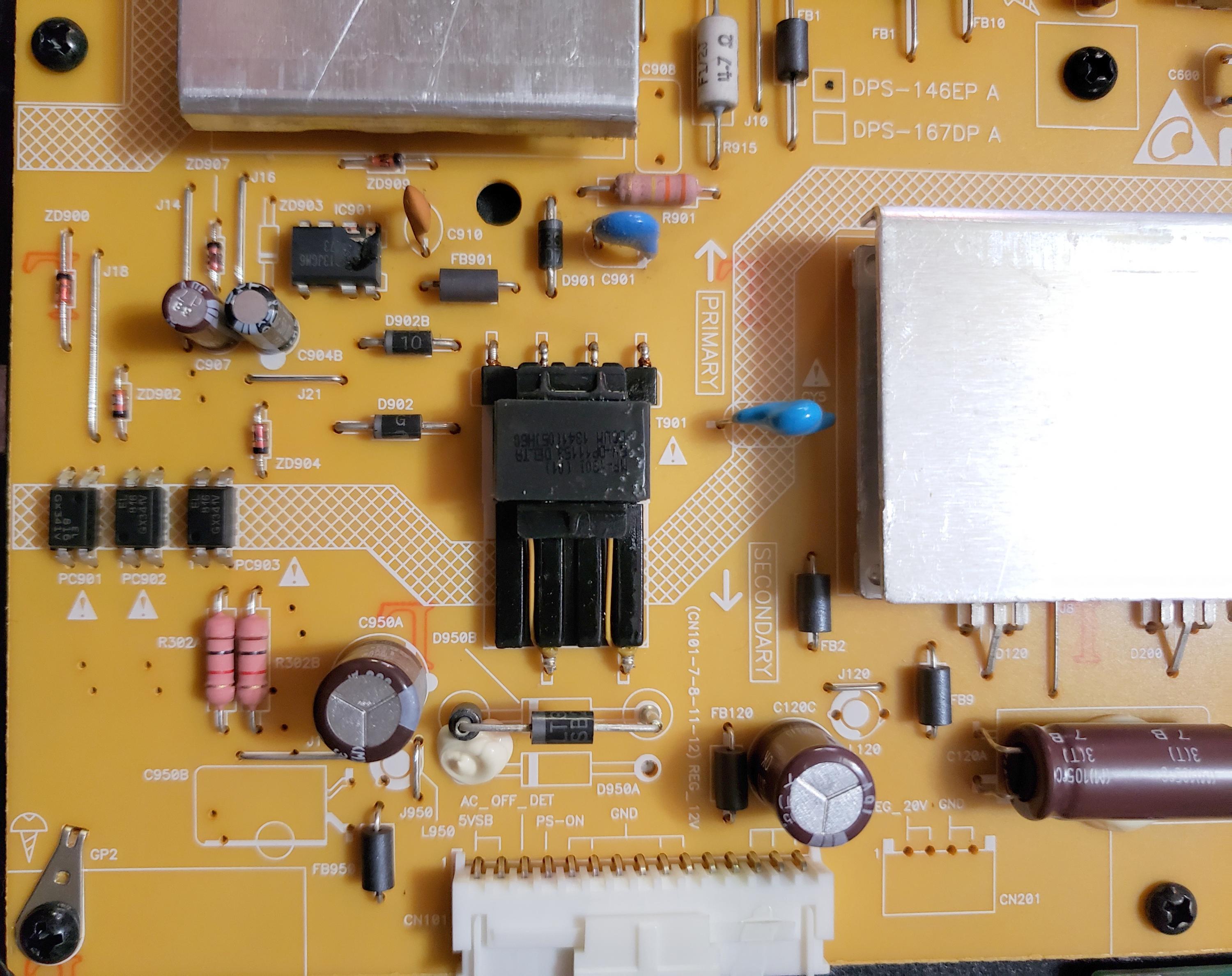

        suggest you check the mosfet transistor connected to ic901 for shorts. it might be under the heatsink above ic901.

          IC901 is the standby ic, it does not drive any mosfets, It could be that it just failed and replacing it will restore the standby voltage, D950b is a schottky diode and will have a lower voltage drop in diode test. .5xx ~.3xx is normal in diode test. BEEPS don't mean anything when checking components.
          There are a few zener diodes (ZD90x) around ic901, check that they are not shorted

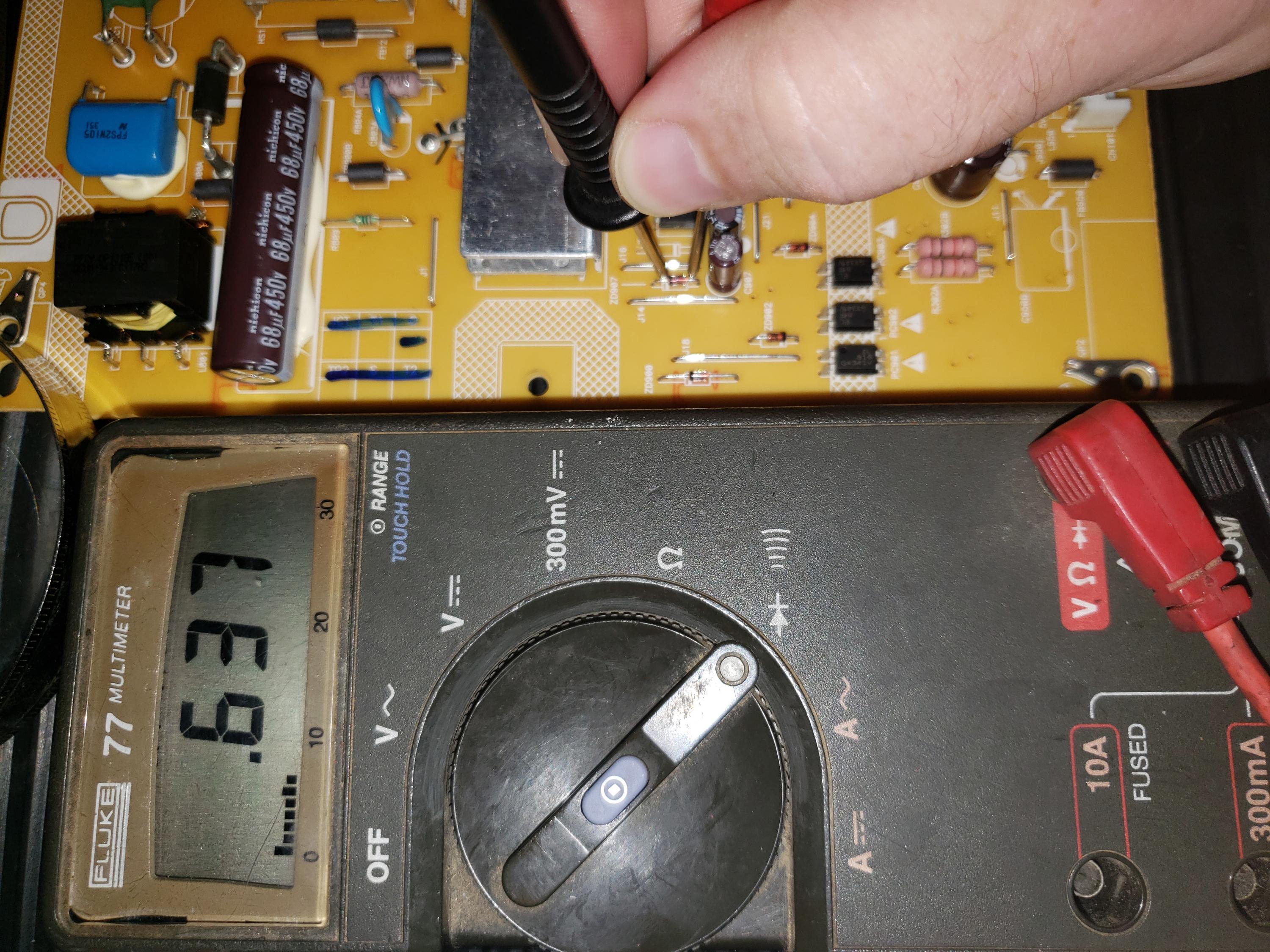

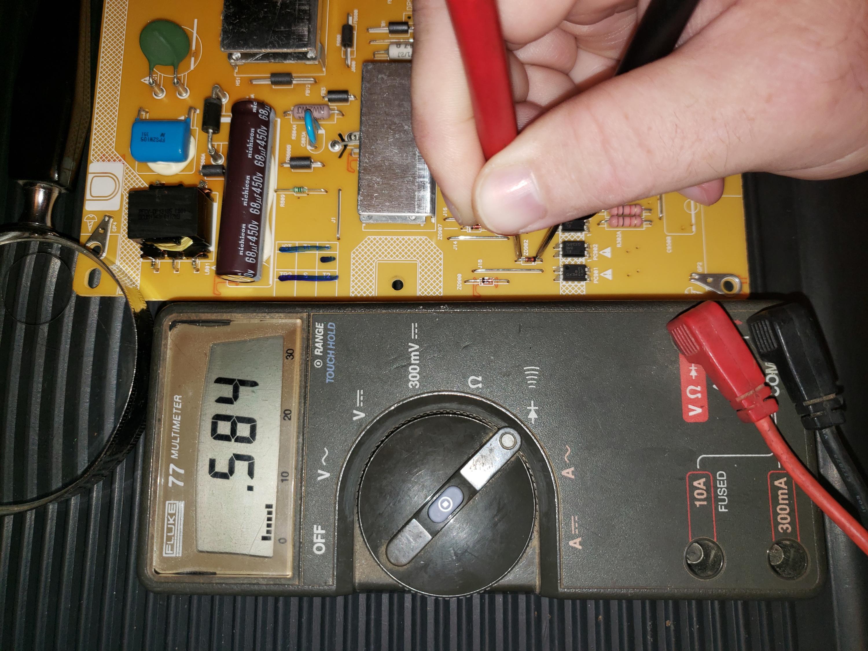

            All these were tested with the board removed and the neg lead on the black banded side of the diode with the meter set to diode mode.
            ZD900=.651
            ZD902=.584
            ZD904=.667
            ZD907=.637
            ZD909=.000 & beeps(I know you said it didn't matter but I just wanted to throw it out there for reference)

              "ZD909=.000 & beeps(I know you said it didn't matter but I just wanted to throw it out there for reference)" Did you re-test this one off the board?

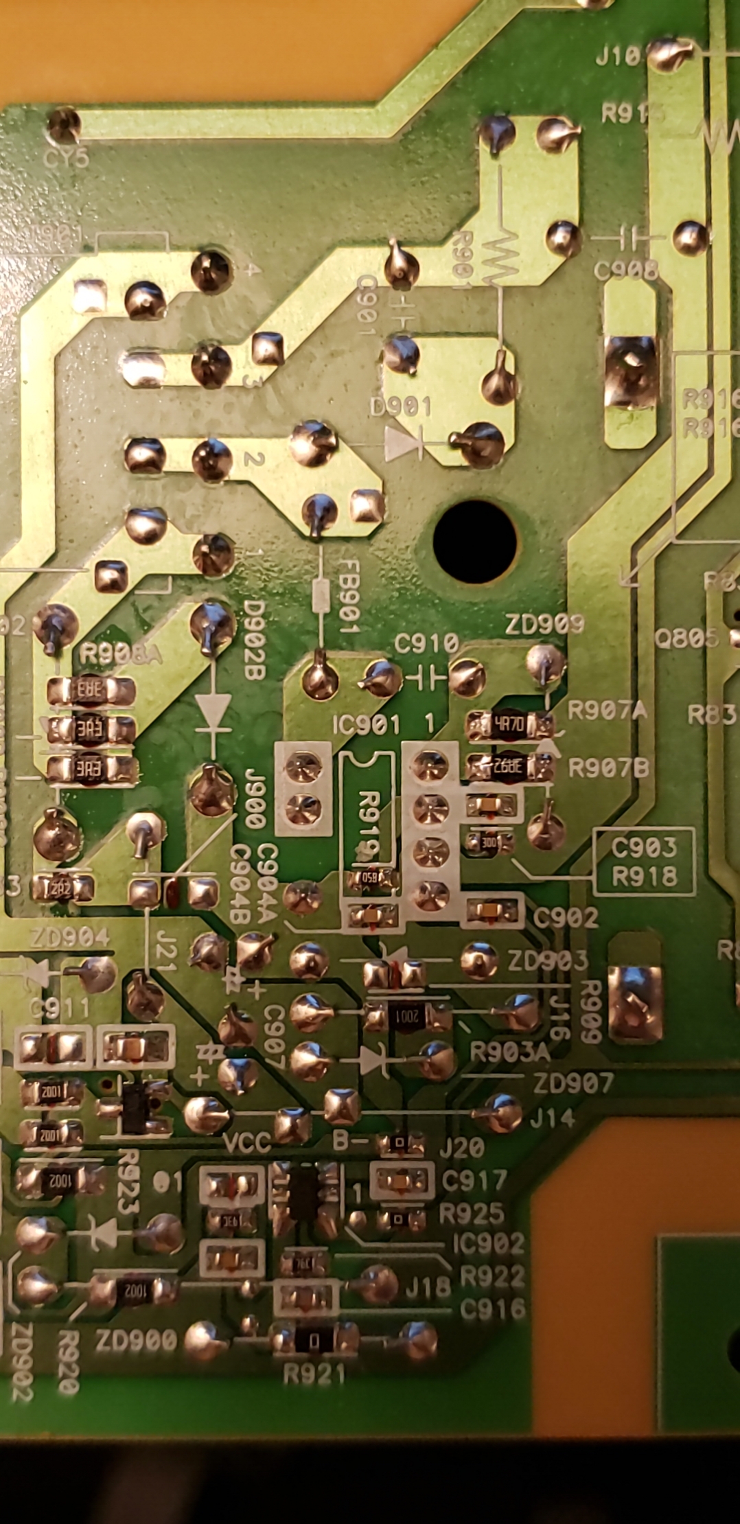

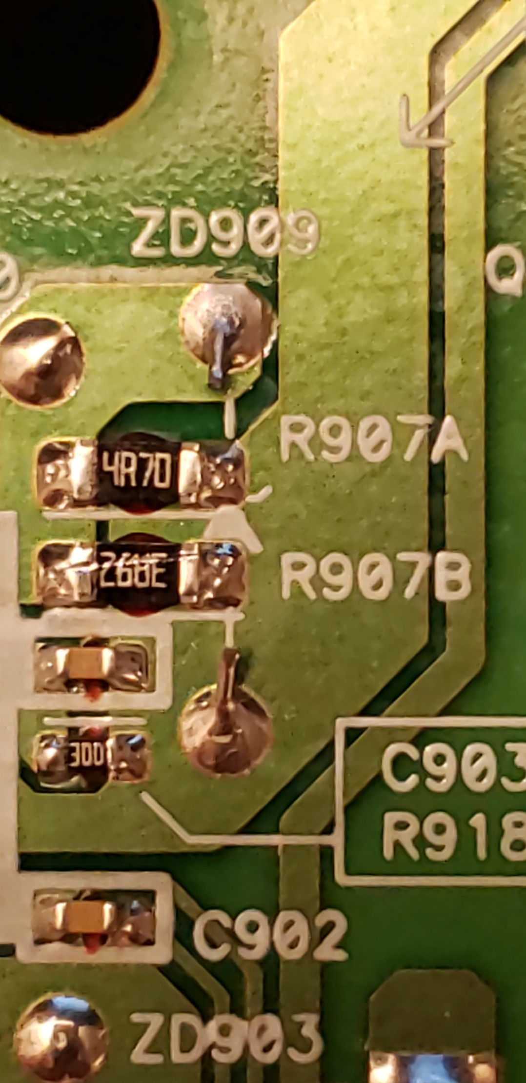

                ZD909 is across the two current sense resistors, R907A,R907B so one end od ZD909 will need to be removed to check it, It is possible it is shorted, if it checks ok out of circuit it is likely ok.

                  No I haven't, I thought it may have read that way on the meter due to R907A&B being between it on the underside of the board.
                  Both R907A&B test 00.5 Ohms.
                  I have been hesitant to desolder anything just yet because if it comes down to it and I have to send the board out to be repaired they have a rule about not sending in boards with previous repairs.

                                ZD909 = .000
                                I hope it didn't matter which leg I pulled up?

                                  So ZD909 checked shorted out of circuit, It does'nt matter which leg you lift, It was nessesary because the two low ohm resistors are in parallel with it. It looks like the number is 4V7 that would be a 4.7 volt zener diode. Yes you can remove the ic

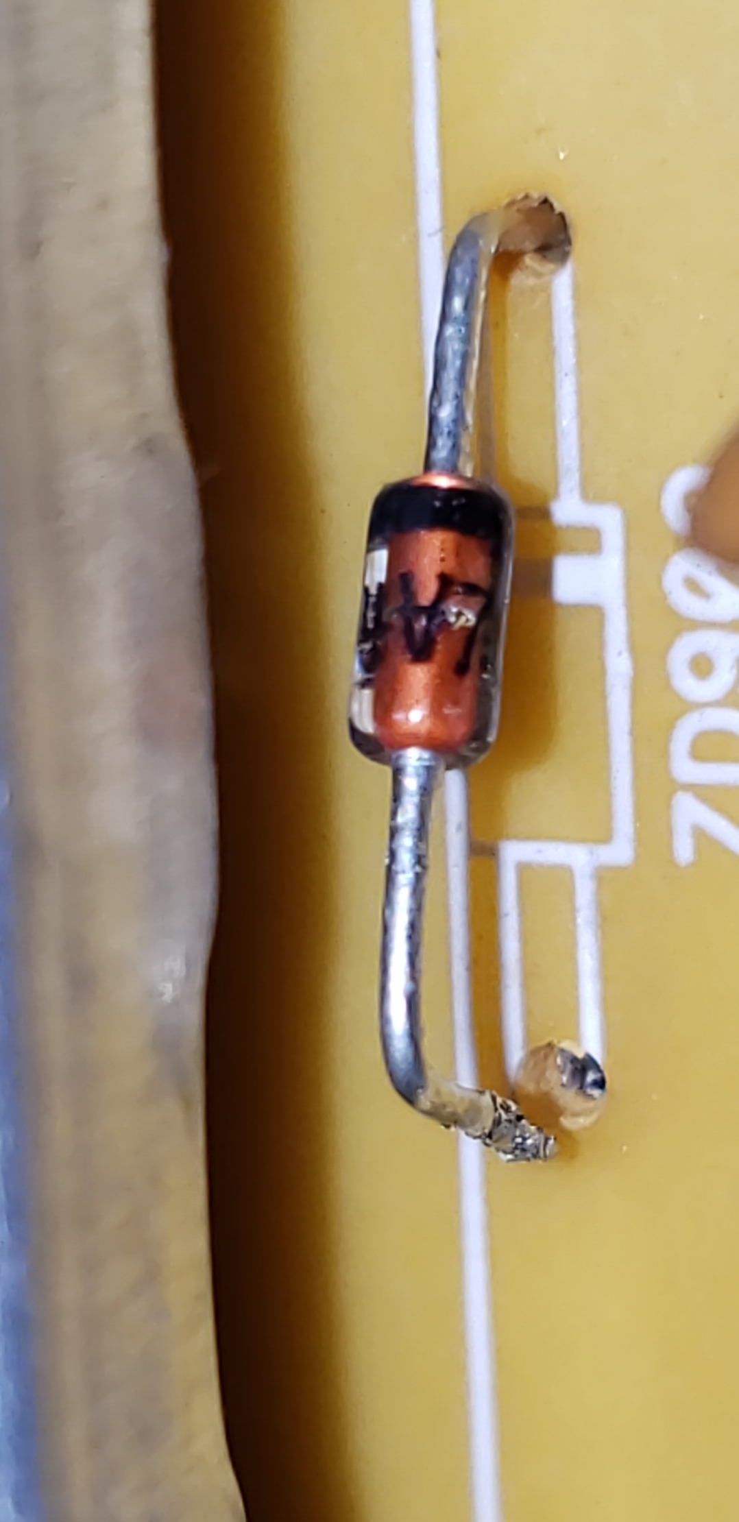

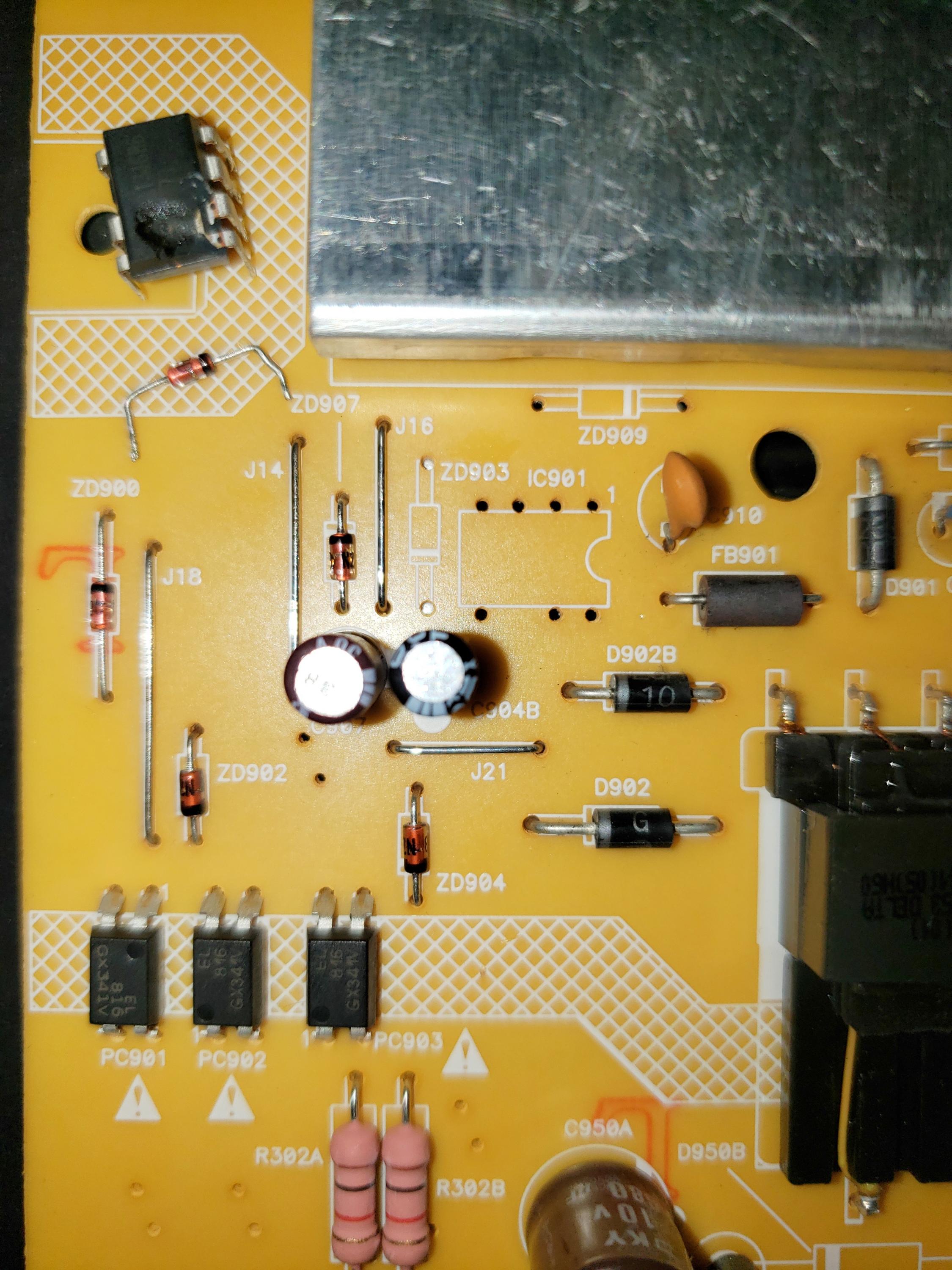

                                    Both the diode and the chip are off the board now. The diode has"4V7D NZ" written on it, I am not certain about the D.
                                    Are there any other components I should test before I order those parts?

                                      The number is likely NZ4V7D you can use a 1N4732A (4.7v 1watt) Just order a few in case there are other problems. hopefully this is all that is bad.
                                        Re: Vizio E480i-B2 Won't Turn On DPS-167DP IC901
                                        Recheck R907A, R907B since ZD909 is no longer connected in parallel with the resistors any more, just to be sure.
