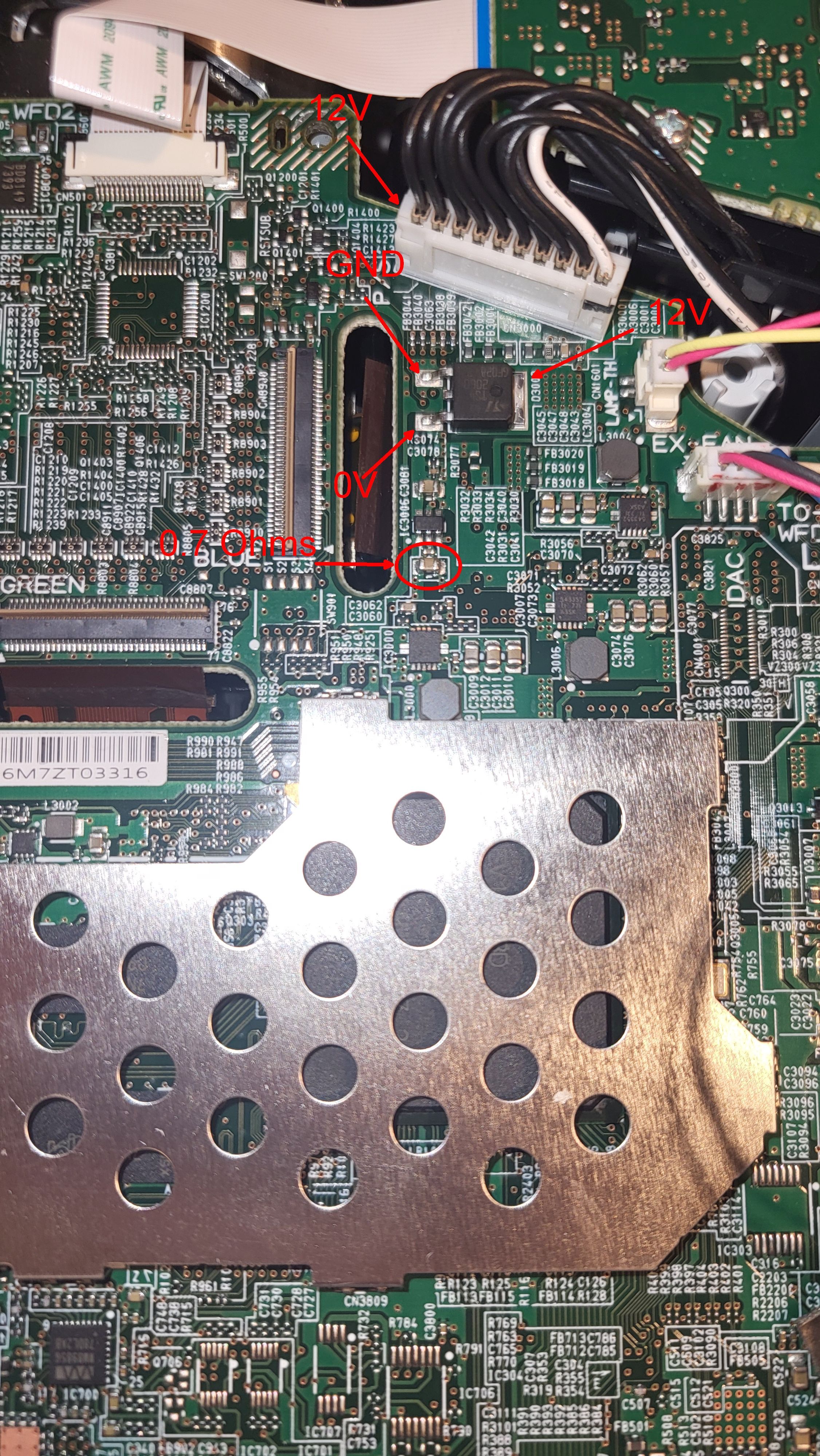

    hi all,
    first of all: i'm a (motivated) newbie, so please forgive me any stupid question i may or may not ask
    i'm currently repairing a projector: Epson EB-U42 that doesn't start (no lights, nothing).
    what i've found so far:
    - the PSU does its job and supplies 12V to the mainboard via the connector.
    - shortly thereafter, there is a mosfet (TS420-600B) where i can test 12V on the one side (in the data sheet this side is called Anode), Gate 0V, Kathode shorted to ground
    - not far away, there's the first cap with a resistance of 0.7 ohms. i've seen many around the processors with 0.7 - 1 ohms.
    (i'm uploading a picture where i enter all the findings)
    questions:
    - are 0.7 ohms normal around the processor? i've heard in some video, that modern graphics cards have a resistance < 1 ohm, processors a few ohms... but are 0.7 ohms normal in a projector?! or does that mean that probably one of the big chips is shorted?
    - do you know a magic place where i can find the schematics to this thing? google didn't show me any good results.
    - is there even a possibility that the Kathode on the mosfet shorted to ground is "normal"?!
    - do you see where the Gate of the mosfet should get its power from? (the pin marked with 0V is the Gate)
    thanks for reading so far.
    cheers,
    narf

    Usually this symptom of yours is a dead shorted MLCC capacitor on the main board backside near the connector and it kills one of the two power rails. Find the ground pin on the connector, then unplug the connector from the main board, then check all the pins and compare connected to the main board vs not connected.
    As for shorted caps showing resistance, I found them not always being a dead short. A thermal camera or 99% alcohol plus voltage injection will show a shorted cap fast.

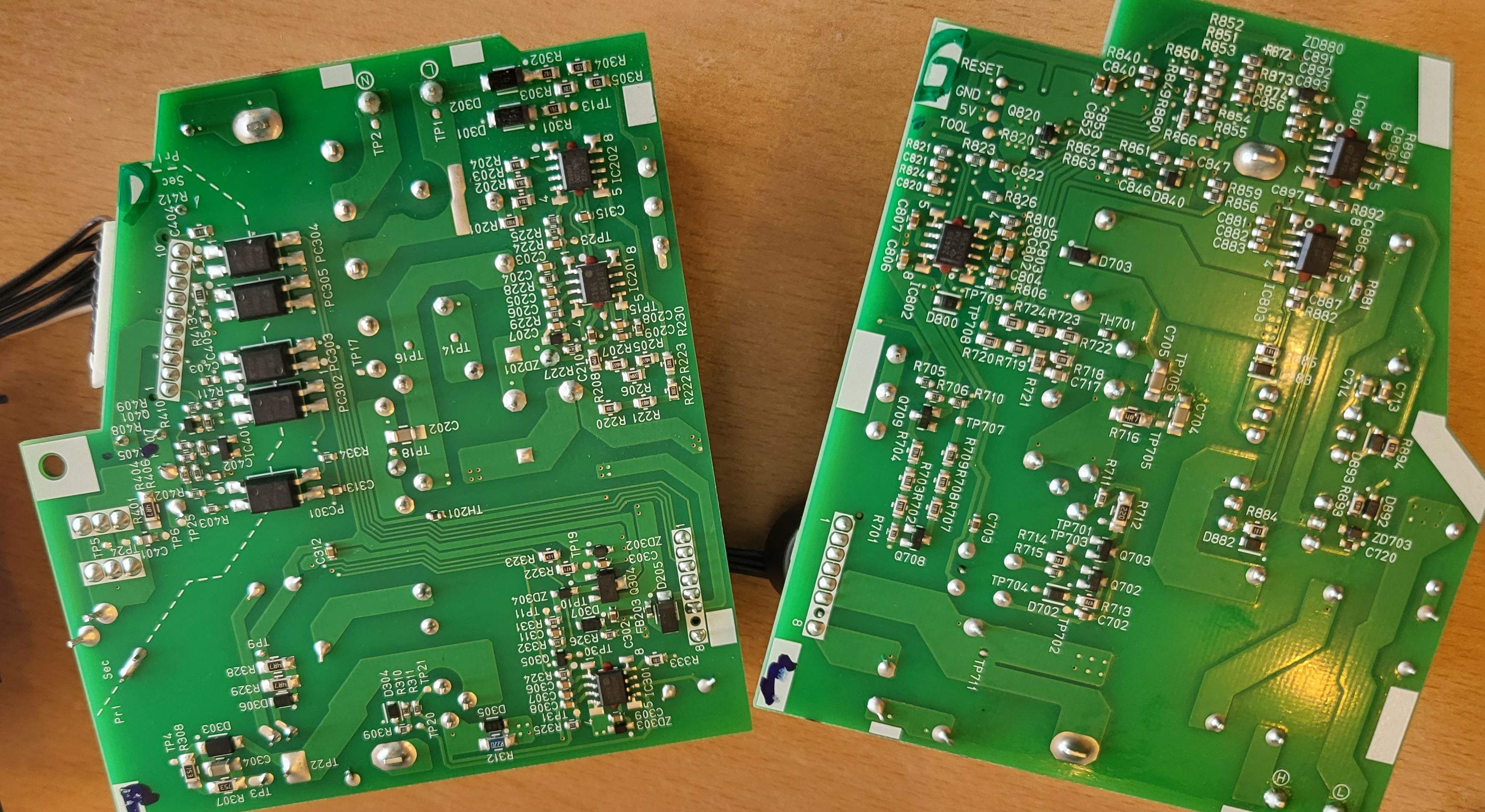

                Man, epson will never troubleshoot in this way... sorry... there are pules Freq Mhz need to send to power to send back low voltage then LED indicator will turn on.. so here need Pulse analyzer
                you have 12V on the socket when all together connected... this is fine... but if there short as you suspected at caps or any other parts this 12V will dropping down before parts will toast warm.
                could you show the power boards where the socket to tell howmany Opto C. installed 3 or 4and the label of them

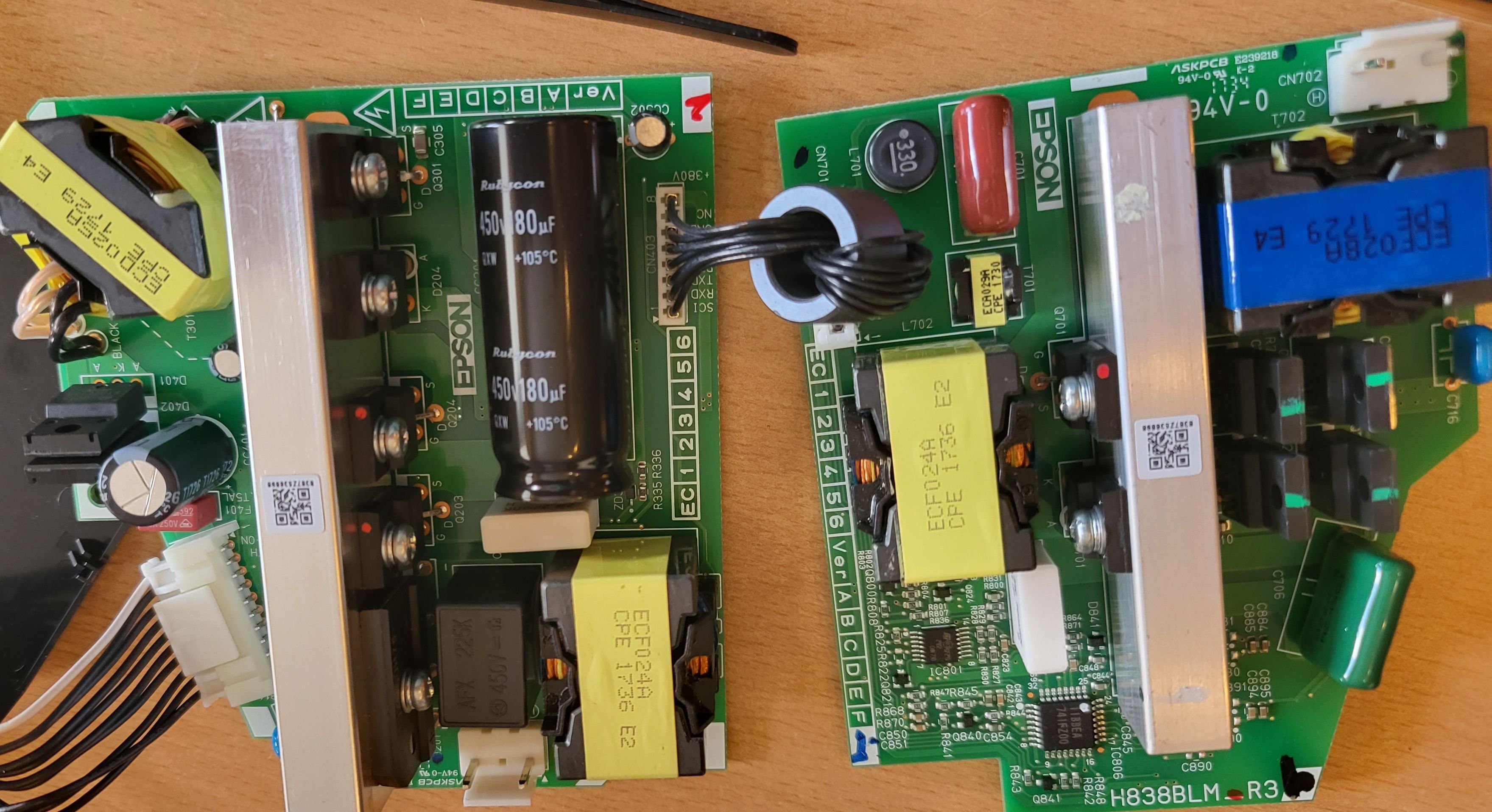

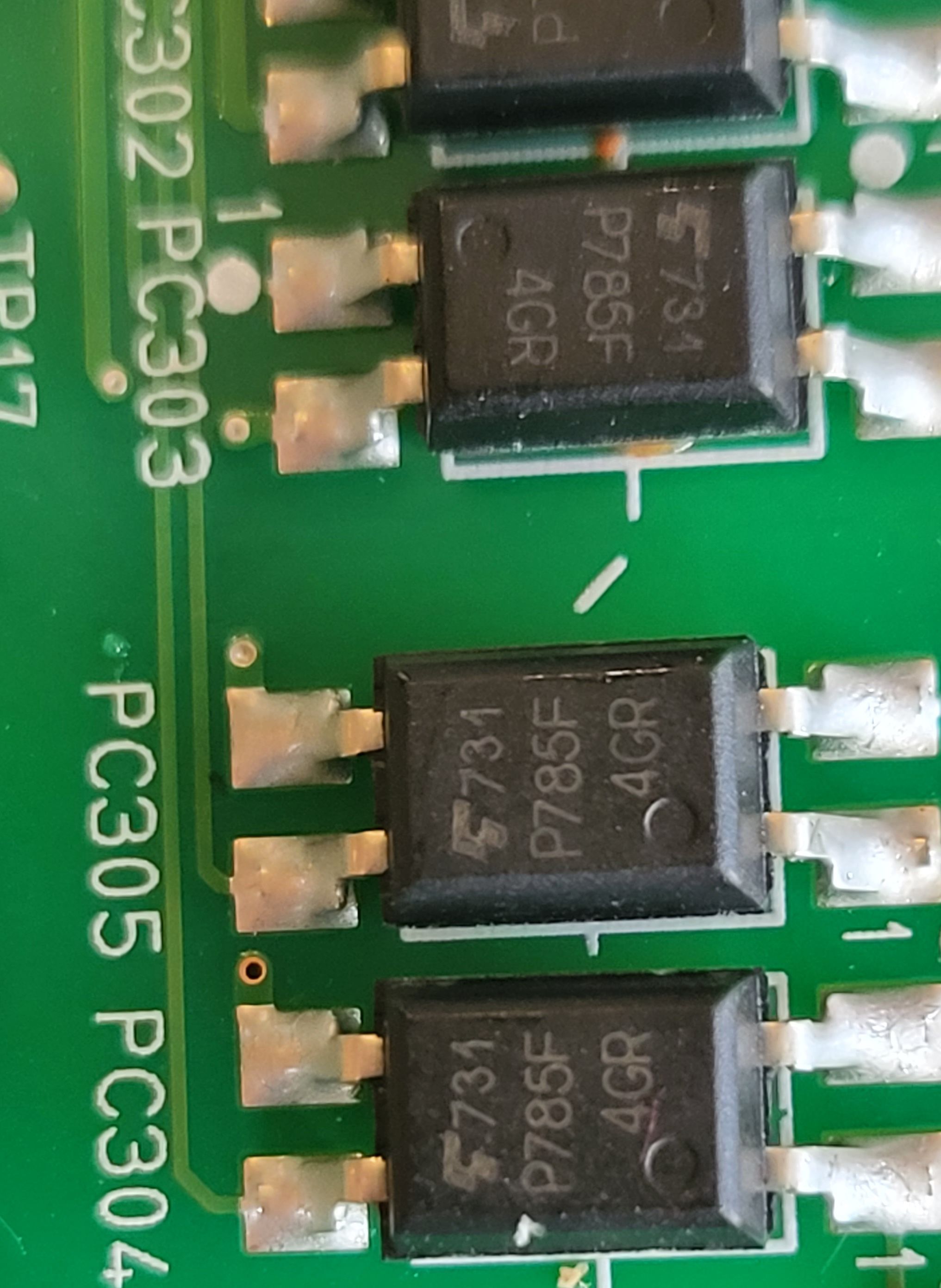

                  thanks for the reply, diah. as i said: i'm a newbie, but i'm eager to learn
                  i'm uploading pics of the PSU + a pic of the 5 opto couplers with labels "731 P785F 4GR"
                  i also saw that a label on the power connector saying 17V (not 12V that i'm getting). i saw this in one of the videos but i think, the guy just changed the PSU altogether.

                    be careful... just the PSU and Lamp driver boards together with AC wall... check if you have on the main big caps >+350V. and on the Lamp driver boards 5V..
                    you can see this PSU working with pules signal via RX & TX. , with out analyzer very hard to tell... but let just try..
                    show the label where written 17V
                    also check F401 close to the socket.. you need to check all SMT R which are low value if they went high or open

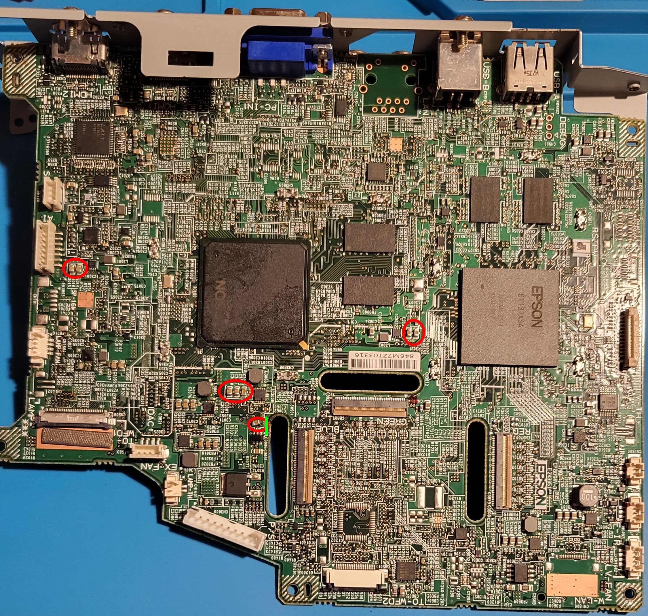

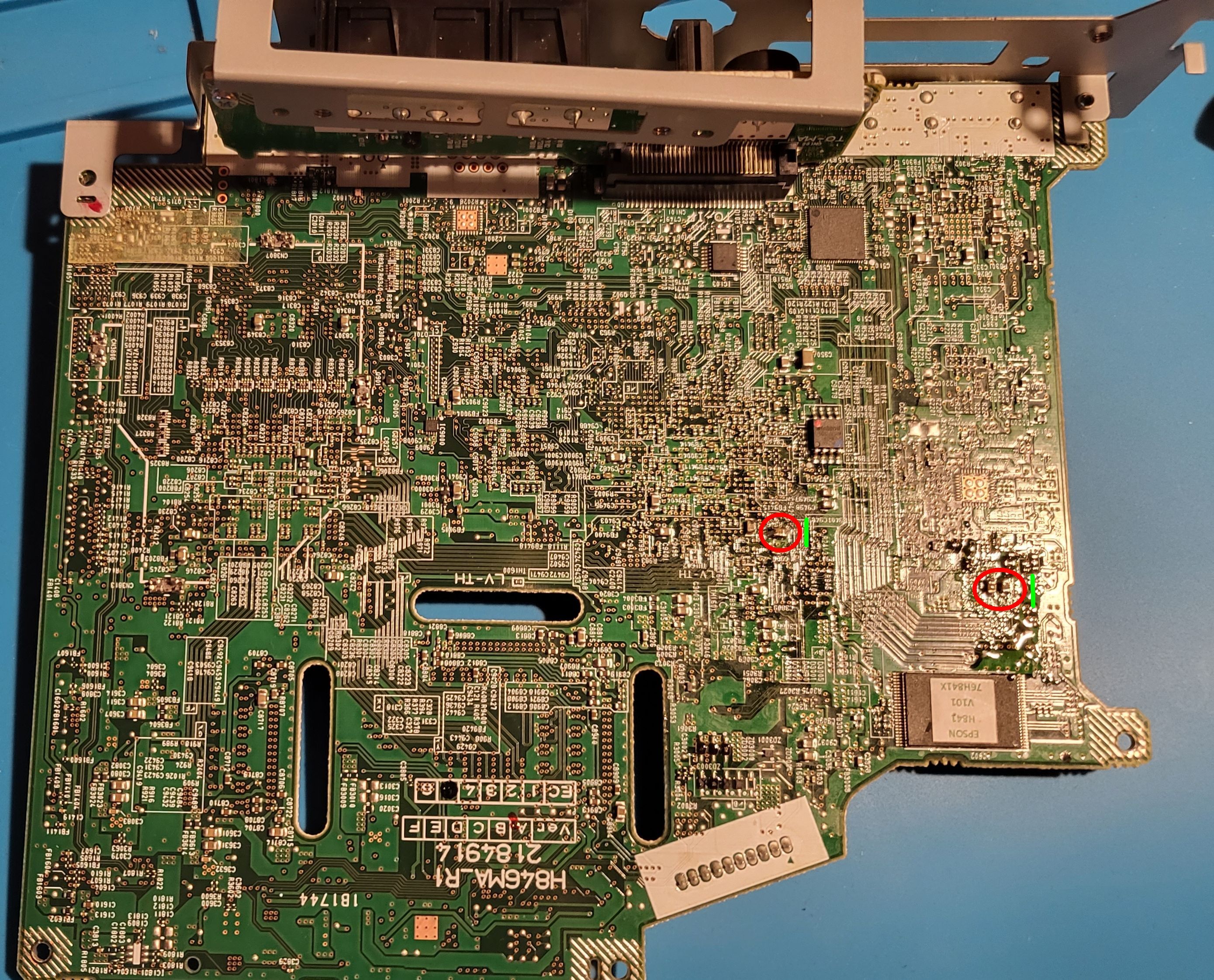

                                    here's a quick update because i haven't written in a while...
                                    i'm uploading pics (front, back) with all the caps with <= 1 ohms. some i desoldered and re-soldered because they were not faulty and the short was readable on the bare board. and yes, they are looking ugly i might have to check some more videos on hot air solder guns or buy better flux - i dunno.
                                    marked in red are all caps that i've identified. a green marker on the side means, i have desoldered and checked them.
                                    they are basically all around the big chip. do you have any better ideas for me than to test all of those caps seperately? because sooner or later, my soldering skills might destroy something is there any other component i might have to check?

                                      update:
                                      i checked all of the marked caps without success. and from all the coils i see, just the one below the big chip marked as L3000 is shorted to ground. so this must be the power rail that's affected. what else can i check before i have to accept that the short is coming from the big chip?
