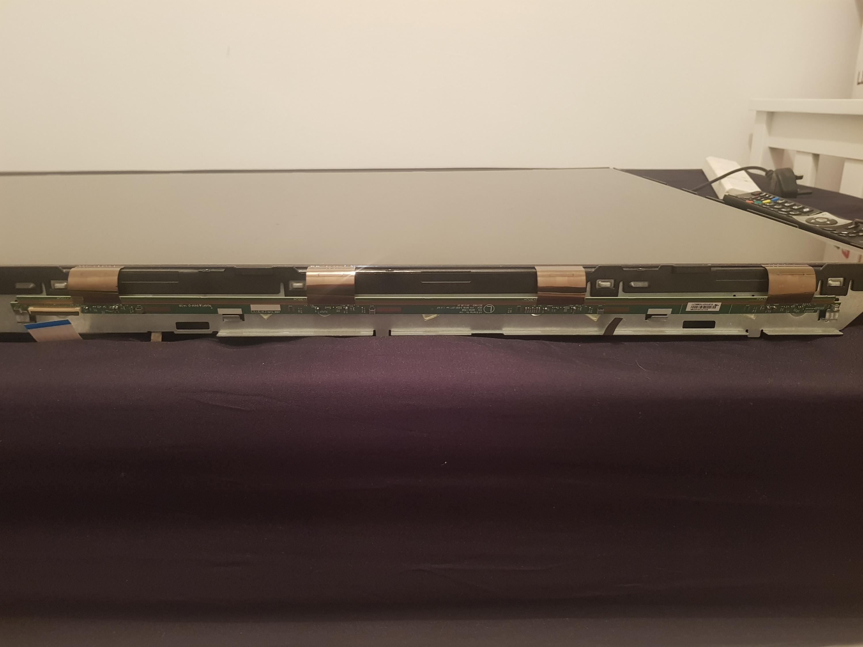

                  Re: Hitachi 50HYT62U no picture
                  Originally posted by Bloopeta
                  If I unplug the left ribbon, I get no change.
                  If I unplug the right ribbon, I get the attached pic
                  Just hoping its not the LCD panel thats at fault :/

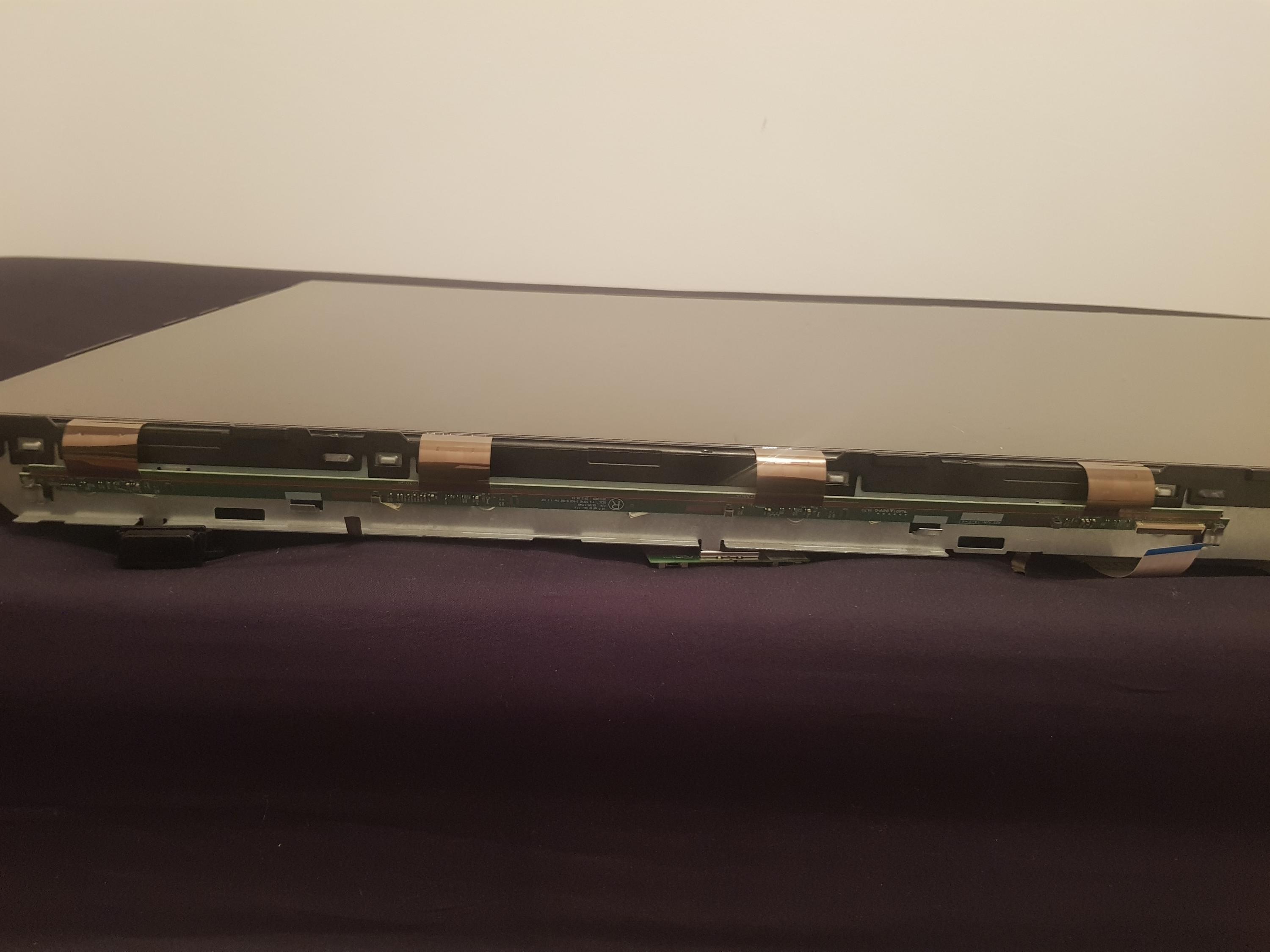

                              Show us the pictures of the boards that are connected to the LCD panel..
                              • Bloopeta
                                • Jun 2018
                                • 526
                                • United Kingdom
                                Hope these help as hard to fit all in pic with being long
