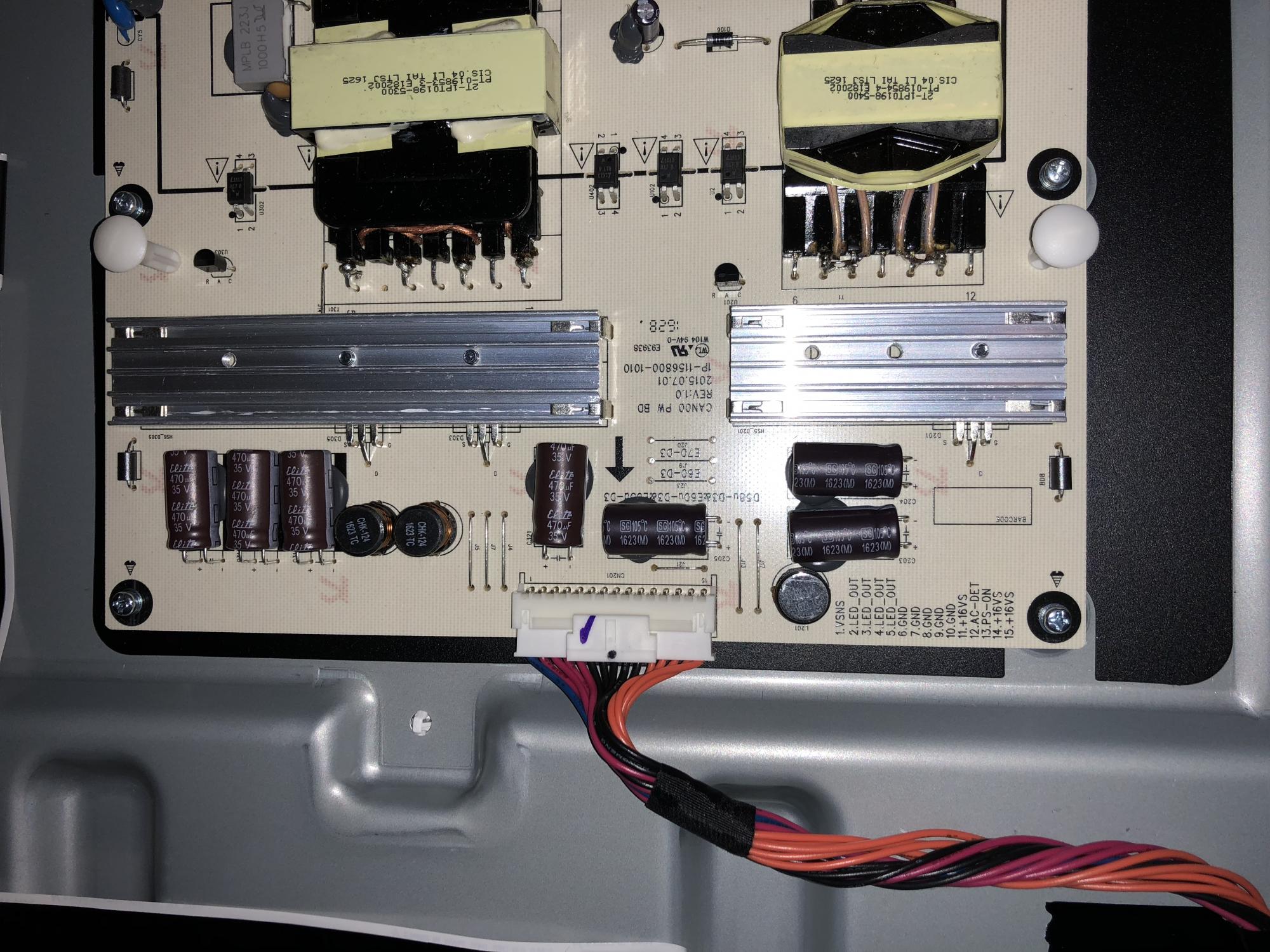

Vizio E60u-D3. Will not come on. No Stand-By light
  • karthur
    • Nov 2015
    • 150
    Set will not come on when I press the power button.
    Verified it is getting 120v to the set.
    Checked the fuse on the P/S board. Its good.
    Here is what I get when I check the voltages on the connector between the p/s and the main board with 120VAC power connected.
    Pin# (Name) Voltage
    1(VSNS) 0
    11(+16VS) 16
    12(AC-DET)1.9
    13(PS-ON)0
    14(+16VS)16
    15(+16VS)16
    Pressing the "power on" button does not change any of these voltages.
    Trying to determine if I have a problem with the p/s board or main board. I think it is the p/s since there is PS-ON is 0volts.

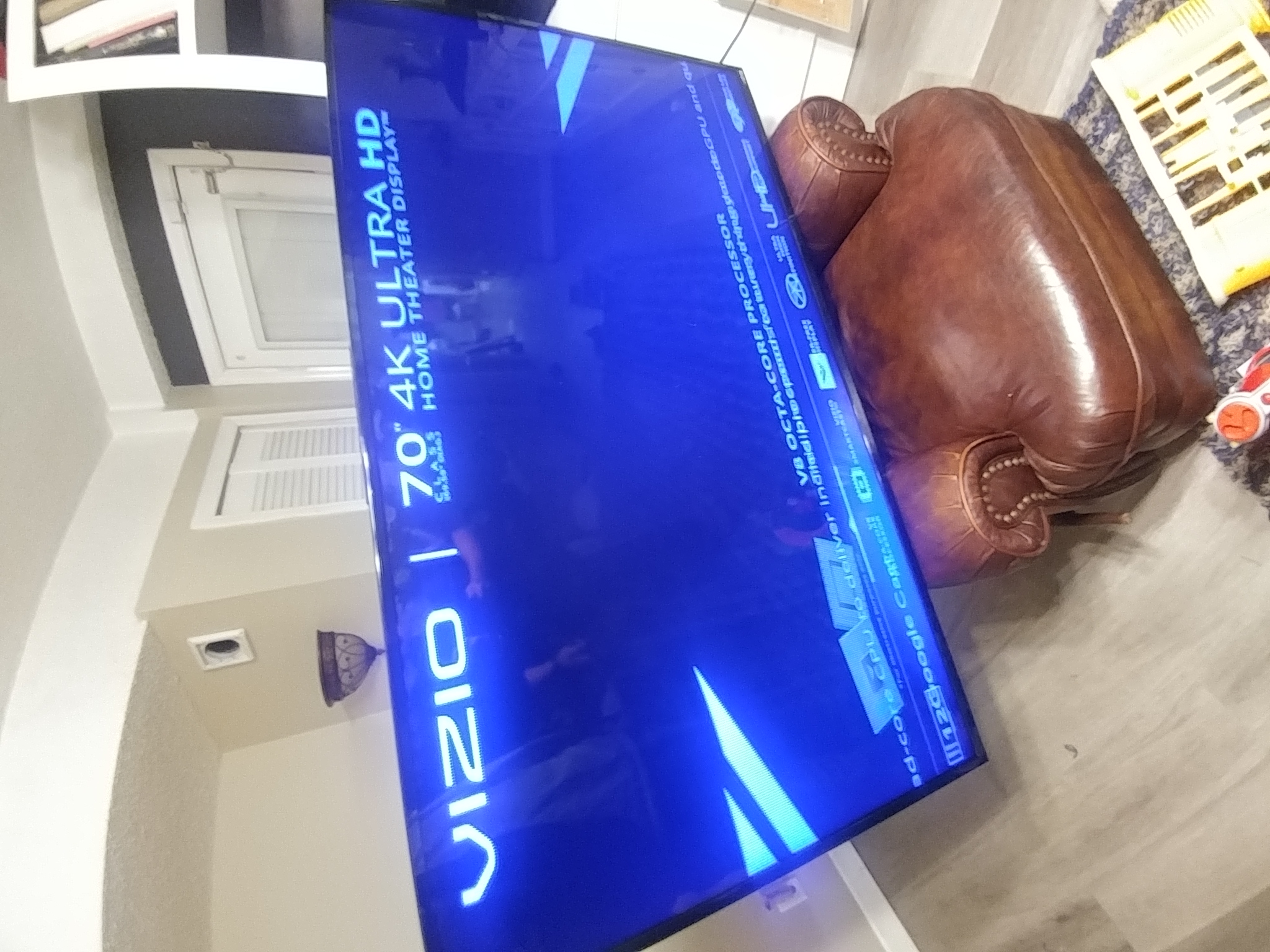

          I replaced the main board. Now when I turn on the power, the screeen tries to come on for about 5 seconds or so, but then goes off for a few seconds, then back on again for about 5 seconds. It does this several times then just doesnt come back on again. Here is what I am getting on the connector going between the P/S and the main board.
          Power OFF -
          Pin# (Name) Voltage
          1(VSNS) 0
          11(+16VS) 16
          12(AC-DET)1.9
          13(PS-ON)0
          14(+16VS)16
          15(+16VS)16
          Power ON -
          Pin# (Name) Voltage
          1(VSNS) 2.4 VDC (for 8 sec, then goes to 0, then back to 2.4....repeats)
          11(+16VS) 16
          12(AC-DET)1.9
          13(PS-ON)5.09
          14(+16VS)16
          15(+16VS)16
          I also have a p/s board that I got from ShopJimmy. Put it in and the set does the same thing. Does not change the voltage values that I gave above.
          Any ideas? Only board left is the T-con and the board with the power and volume buttons on it.

              Now you have a problem with the backlight leds. The VSNS probably is in sync with the backlights turning on and off.
              • karthur
                • Nov 2015
                • 150
                Re: Vizio E60u-D3. Will not come on. No Stand-By light
                I tried unplugging the LED and the T-Con board and the cylcling continued. The only thing left that was plugged into the main board was the speakers. So I unpuged them and the cycling stopped. I reconnected the T-Con and the LED and I now have an image on the screen. The display is no where near correct, but at least I do have an image. I reconnected the speakers and now it does not cycle.
                The rest of the warning is on the other side of the dispay. Obviously, this is not correct. There is not but one other board left. I really dont think the problem is the LEDs, but I guess it is possible.
                Suggestions?
                Thanks.

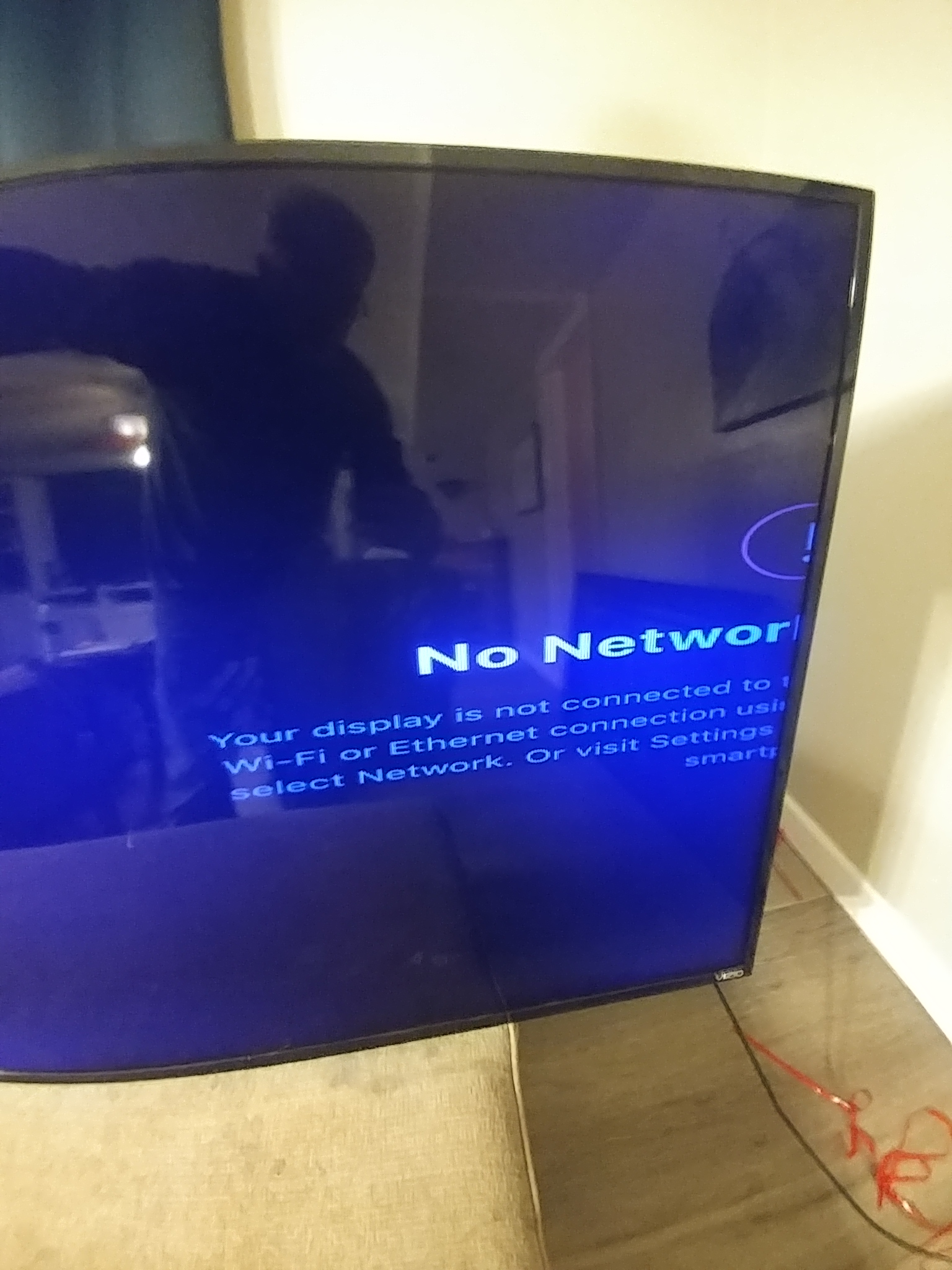

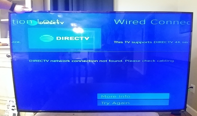

                  So what do you get when you try to play a source, tv, dvd player?
                  • karthur
                    • Nov 2015
                    • 150
                    Here is what I get with a Direct TV reciever connected.
