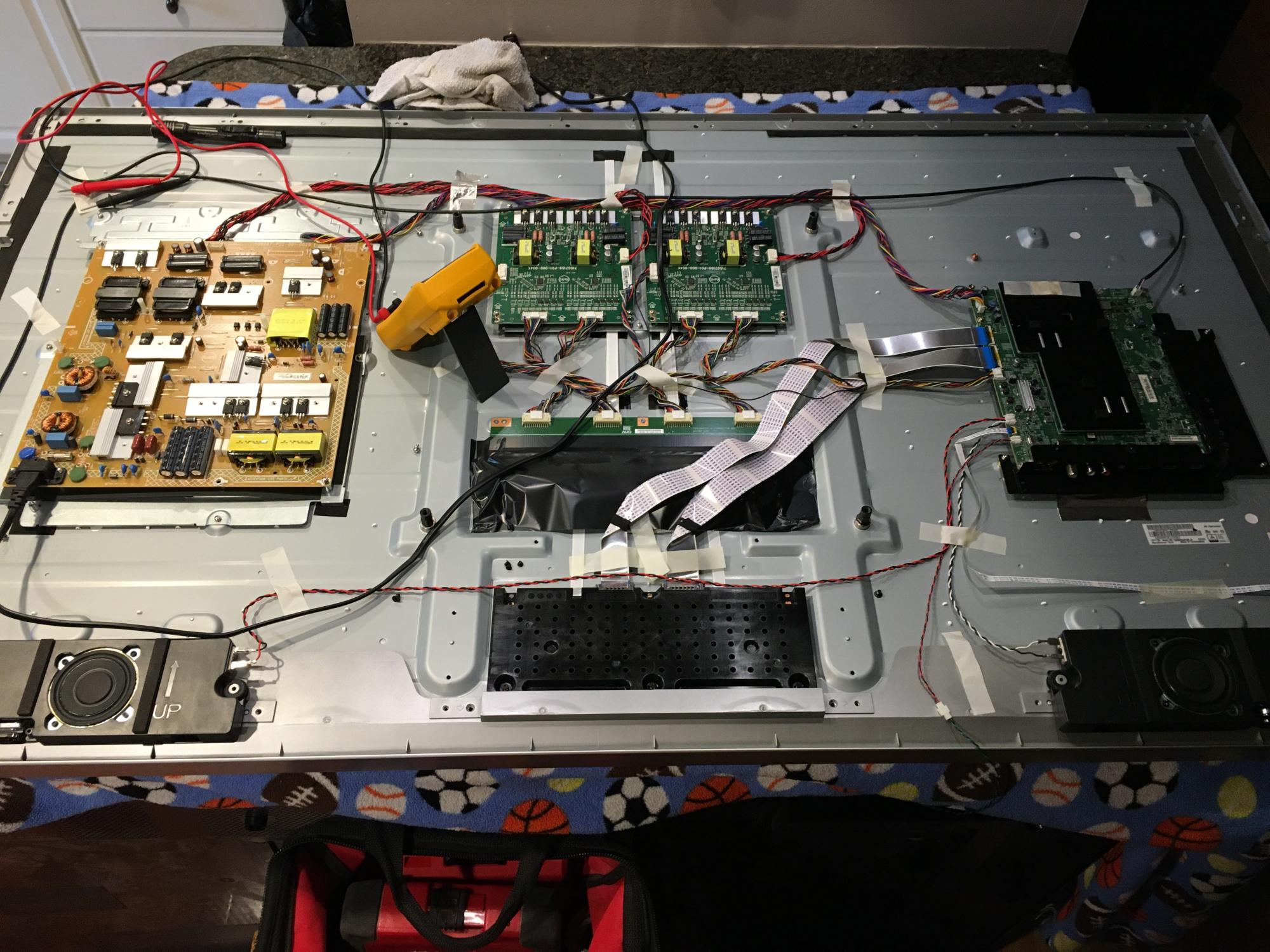

    Last night my TV broke. I was streaming a show and the TV froze. When I attempted to turn it off/and back on all I get is a black screen. The power led indicator goes on for about 20 seconds, then it blinks 15 times and the TV restarts... it does that again and then it powers down. I don't see anything at all on the screen, no logo or anything at all.
    I tried the suggestions from the Vizio website including unplugging, holding the power button for 30 seconds and plugging back in. No differance.
    I unplugged overnight and no change.
    So, I took it apart and so far I cannot see any obvious damage. I followed some advice from a YouTube video and measured the following voltages from the output pins on the power board:

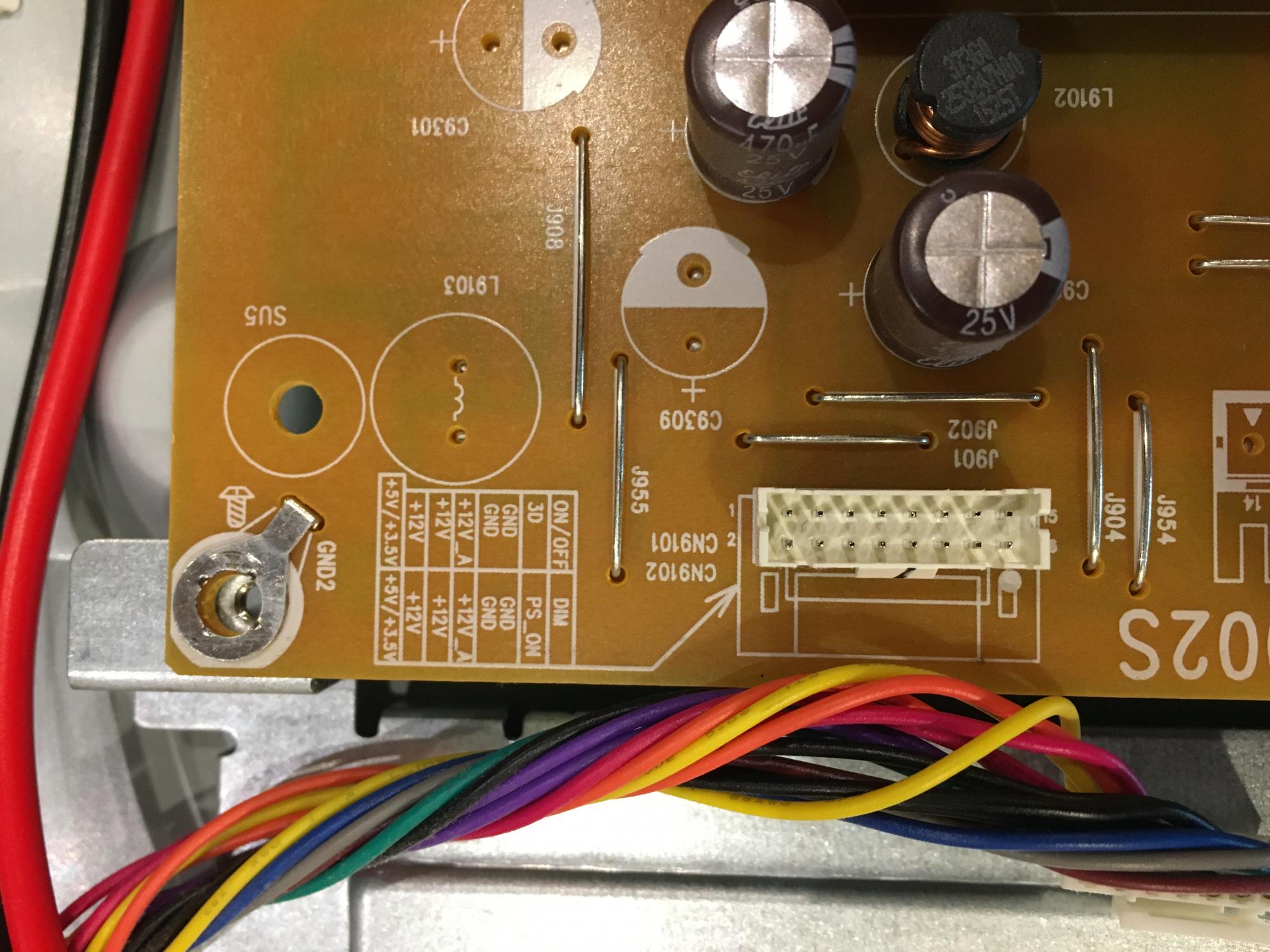

    CM9101
    Pin / Listed on Key / Actual when plugged in / Actual Powered on
    1 / +5V +3.5 / .001 / 5.118
    3 / +12V / 19.08 / 19.06
    5 / +12V / 19.08 / 19.06
    7 / +12V_A / 19.08 / 19.08
    9 / GND / 0 / .002
    11 / GND / 0 / .002
    13 / 3D / .001 / 0
    15 ON-OFF / .001 / .157

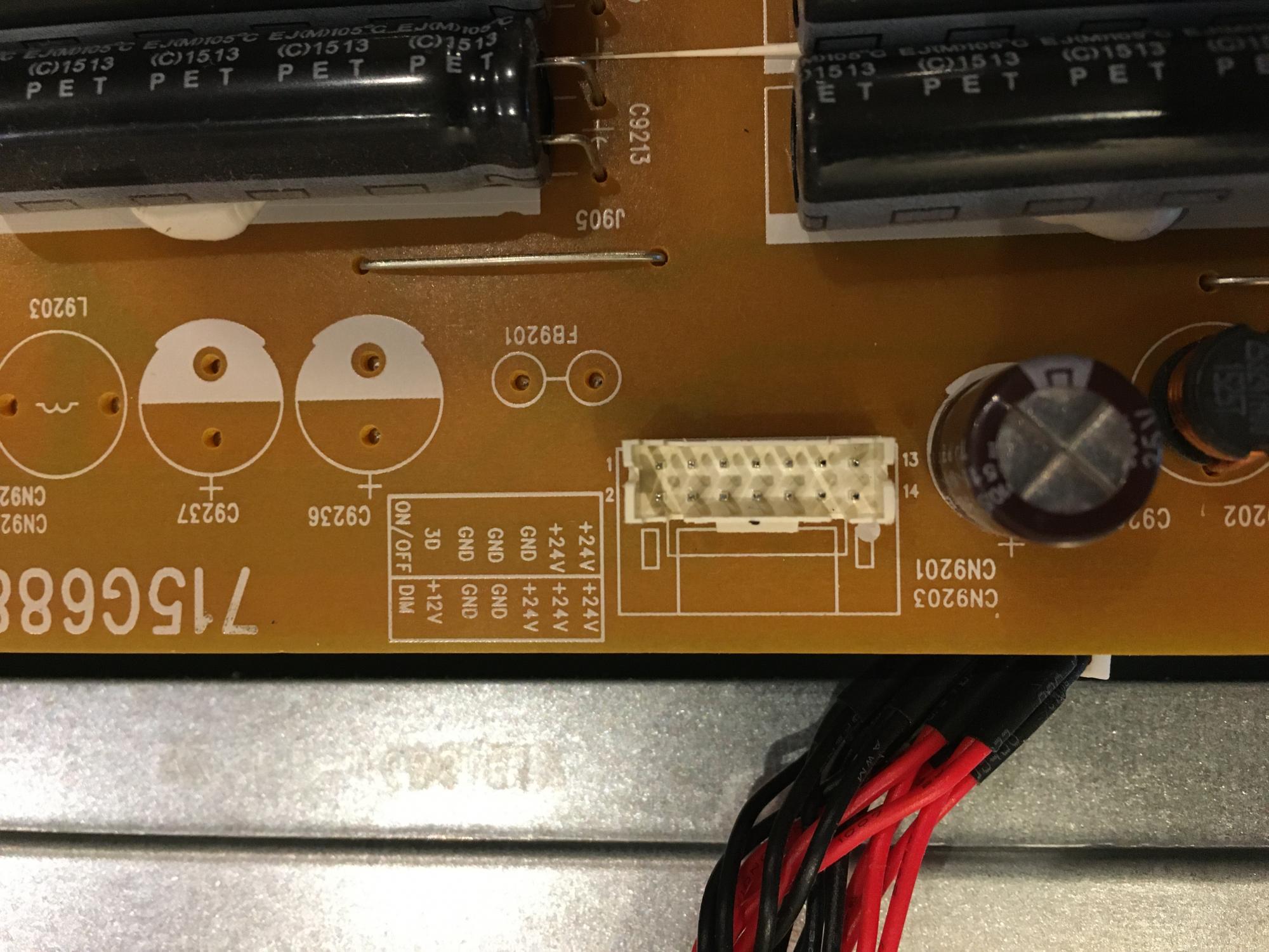

    CM9203
    2 / DIM / 0 / 3.32
    4 / +12V / 19.08 / 19.08
    6 / GND / 0 / .005
    8 / GND / 0 / .005
    10 / +24V / .001 / 24.65
    12 / +24V / .001 / 24.54
    14 / +24V / .001 / 24.53
    CM9201
    1 / ON-OFF / 0 / .03
    3 / 3D / 0 / 0
    5 / GND / 0 / 0
    7 / GND / 0 / 0
    9 / GND / 0 / .002
    11 / +24V / .001 / 24.52
    13 / +24V / .001 / 24.52
    As far as I can tell these voltages look ok. Are they?

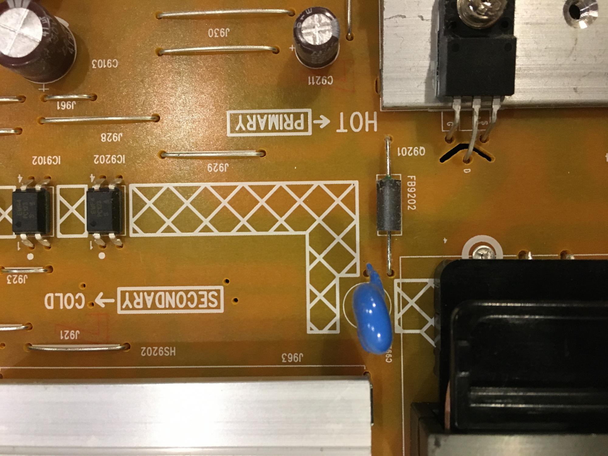

    The only other thing I noticed is when I tested the long transistors (I think they are called that?) for continuity there was only one that beeped... it is in the picture: FB9202
    If there are any suggestions for further troubleshooting I would really like to save this TV... I don't have the money to buy a new one right now... thanks for your help!

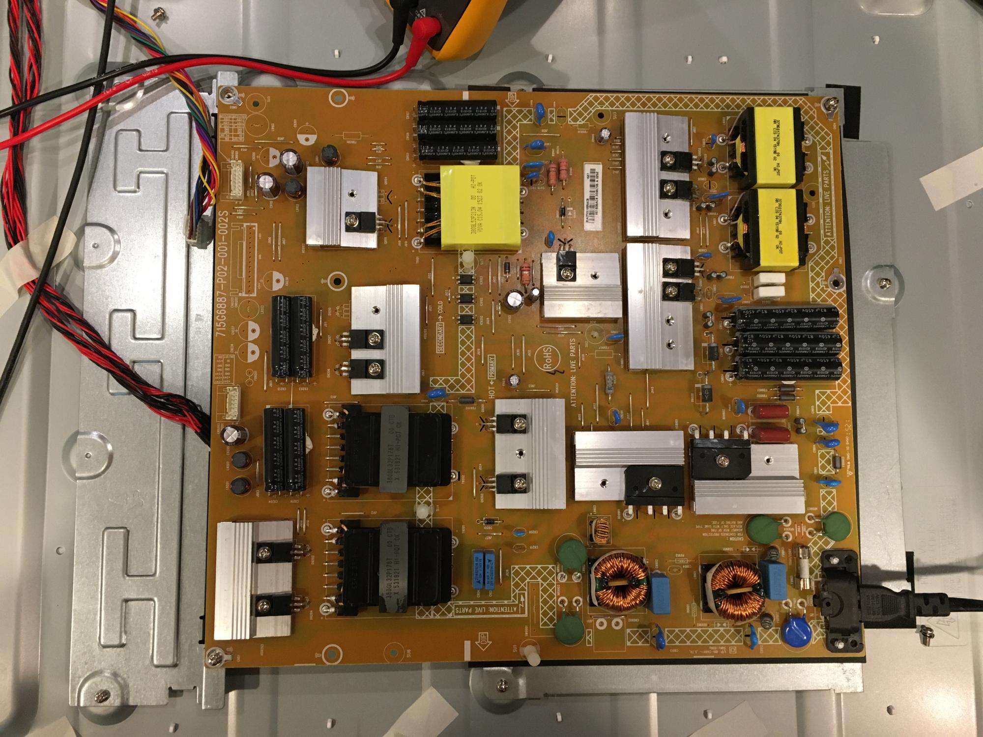

    Re: Vizio M65-C1 - no picture, help!
    Looks like a couple screws that hold down and ground the powerboard are missing, could try replacing those, also PS_ON looks too low which doesn't seem right because you have the 12 v which is 19 on this one.
      I took those screws out to take the board out and look at the bottom and was lazy and only put two back in so it would be grounded when I tested further....
      Does the PS_ON reading give any clues of what to look for next?

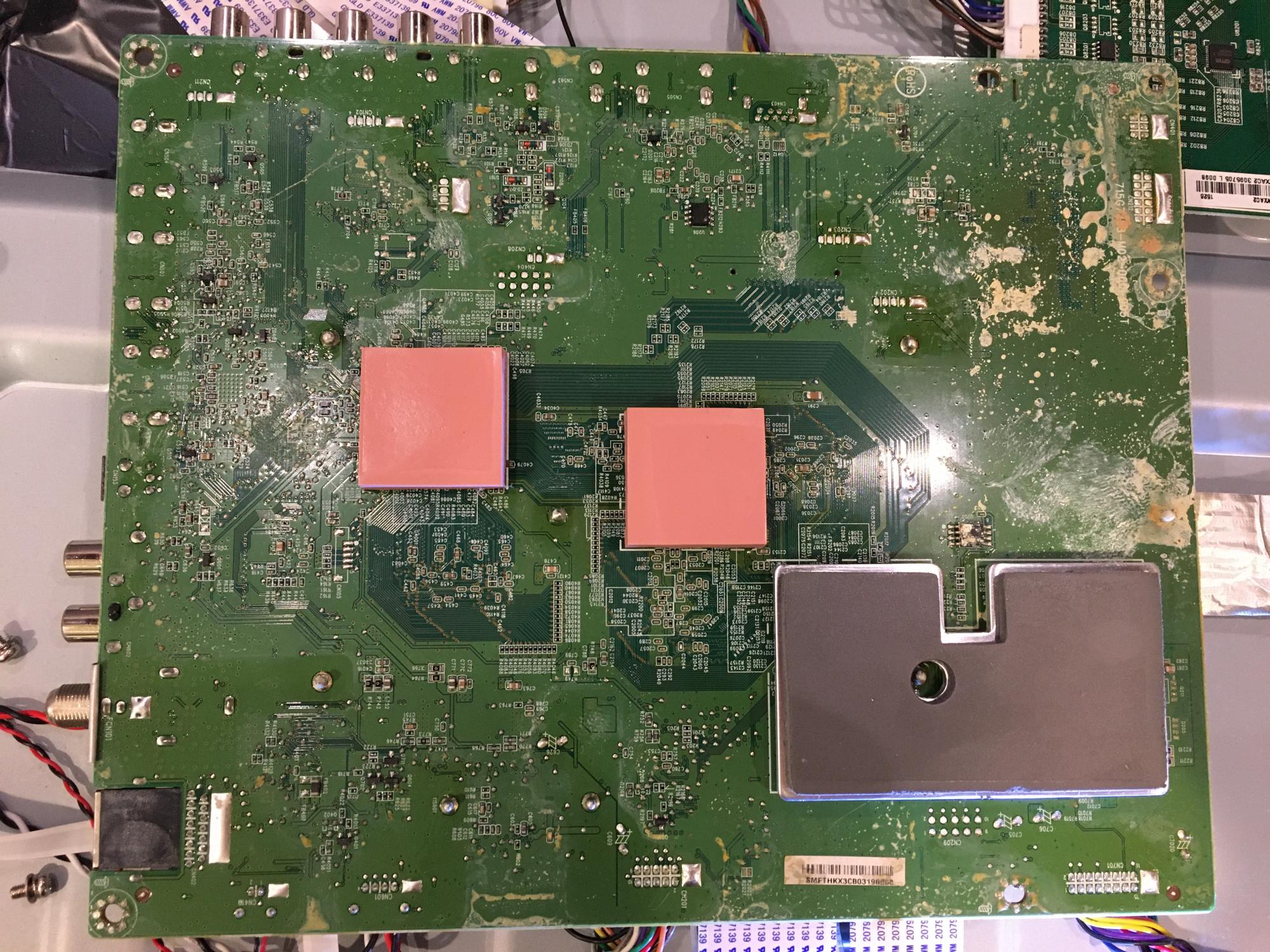

              ON/OFF is the backlight on signal. m series has bga iisues. try heating the main board with a hair dryer and see if it turns on

                  Where specifically should I point the hair dryer? I'm not familiar with the names of the boards...
                    The main board on the right where the Video/Audio connectors are.
                    • jaw3
                      • Oct 2019
                      • 10
                      Thanks...
                      Should I heat it from the top or bottom? I just took out the screws that hold it on and the back is covered with some sort of residue. Does it look normal?

                        After doing some research on "re-flowing" I have some questions before I attempt this...
                        first, it seems like a heat gun is recommended instead of a hair dryer, right?
                        also, I need to remove the heat-sink and aim the heat right at the chip, right?
                        besides that, I am wondering if that residue in the picture on my last post is just excess flux, or something to be worried about that could be contributing to my problem? Thanks!

                          Hair dryer is a test to confirm you have failure in the BGA solder balls on the processor. Heating it up may expand the joints to make contact for the tv to power up. Proper repair is to have the processor reballed. I've only baked boards twice and the problem came back after a couple of weeks (PS3 and a laptop motherboard).

                            I heated up the main board with a hair dryer and powered it on. No change at all.
                            I also cleaned up the residue I had mentioned with some isopropyl alcohol. No change at all (except it is cleaner)...
                            Any suggestions on what to try next?
