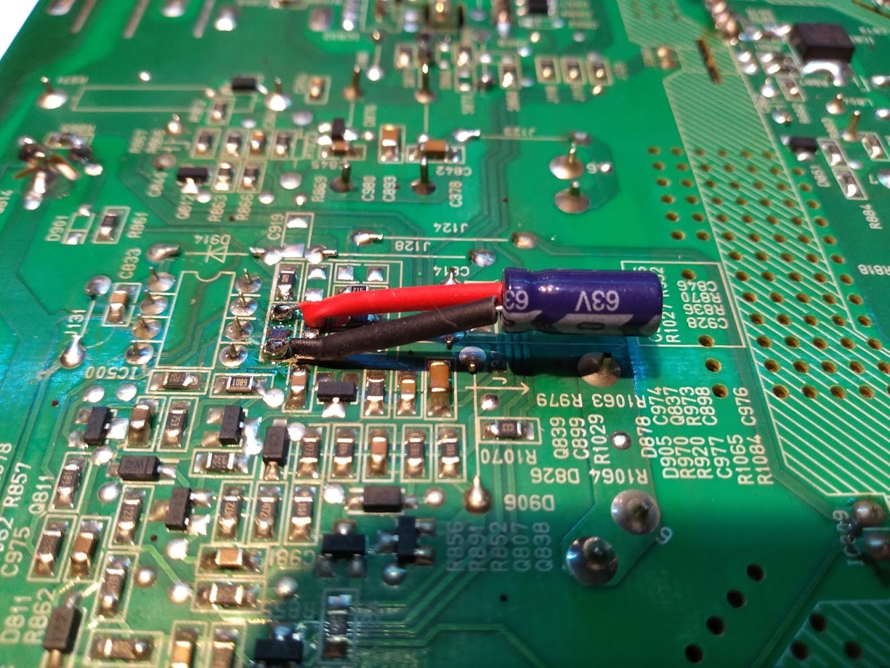

    Re: Vestel 17PW01-4 PS board stuck in standby
    It's a 1uF 63v but assume it'll be ok.
    No change.
      IC500 FAN7711
      1 - VDD 14.93v
      2 - RT 0.001v
      3 - CPH 0.001v
      4 - GND
      5 - LO 0.542v
      6 - VS 13.18v
      7 - HO 13.57v
      8 - VB 14.91v
      The data sheet for FAN7711 says that normal operation is when CPH voltage reaches 7V.
      After changing the capacitor are the FAN7711 voltages as you gave earlier shown above.
        I'm away now till tomorrow PM. Many thanks so far..
        But before I go:
        IC500 FAN7711
        1 - VDD 14.73v
        2 - RT 1.762v
        3 - CPH 1.3531v
        4 - GND
        5 - LO 0.000v
        6 - VS 13.66v
        7 - HO 13.67v
        8 - VB 14.93v
          I'm back now. I feel like we have given this power supply a good effort and it's probably now the time to throw in the towel.. Are we agreed?
            Can you change IC806 (FAN7711) as the last resort to rule it out as being faulty?
            With the diode in backwards then the 12V supply would have appeared to be almost a short circuit.
            You've ruled out the two mosfets as being damaged and the supply voltages for the FAN7711 looks good but it cannot be operating since you are not seeing the 12V on the secondary side of the transformer it's driving.
              I don't have a FAN7711 in stock.
              It's not stocked by CPC/Farnell and RS have it but as a SMD.
              There's one on eBay for £3.09 delivered which seems a bit steep but It might be worth a punt.
              Now ordered.
                Good luck. Can't thnk of any more moves. Keep that smd capacitor (11.19uF) in case it needs to go back in. What was it's ESR
                  The C928 cap measured 9.1uF, ESR 0.00
                    The new FAN7711 arrived and replaced the original but unfortunately no changes were seen.
                          With your help, I've learnt a lot about this board and power supply boards in general. This particular TV had a negative outcome but I'm not overly disappointed. I'll salvage the boards and bin the rest. Sincere thanks.
