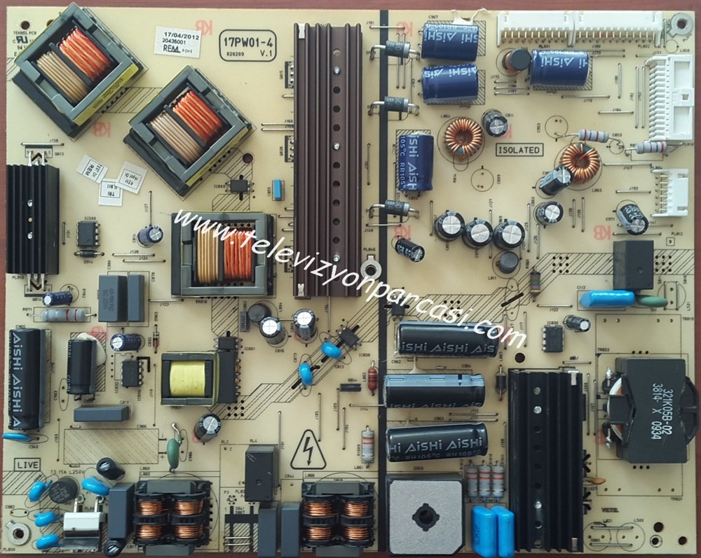

Vestel 17PW01-4 PS board stuck in standby

    Does Pin 5 at switch on reach 12V. If not then check R501. If VCC does not reach 12V at switch on then the IC will fail to drive the transformer which provides the secondary VCC for that IC to sustain operation.

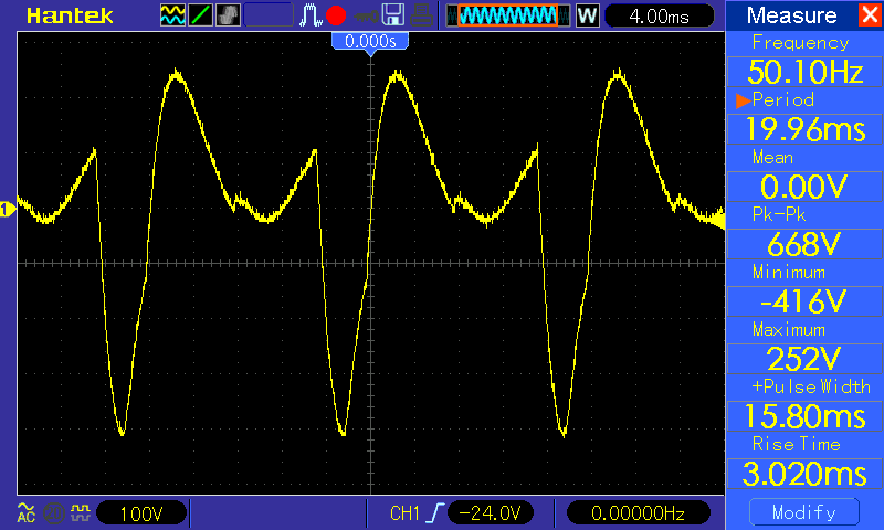

      If that's pin5 on IC806, it gets to 237V on a Fluke 85 in DC mode. The trace is below:
      VCC on pin 2 reveals the same trace.

        IC806 VCC is Pin number 2, be sure to use hot ground when checking voltages inthe primary. I suspect you are using chassis ground for your scope, this will not work for checking signals in the primary. and DO NOT connect your scope ground to the hot ground without an isolation transformer or you will damage the power supply board
        All your scope is measuring is the 50Hz potential between one side of the a/c line and earth ground.

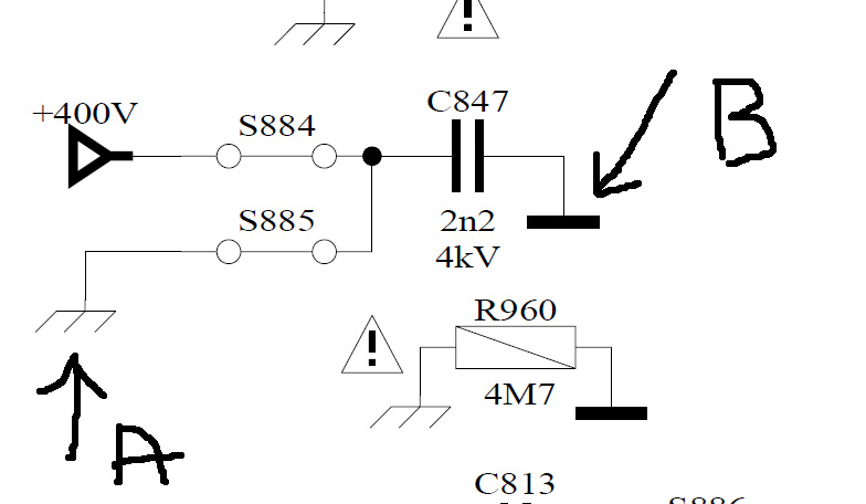

            Looking a the schematic, I am unsure of the difference between these two grounds:

                A is hot ground, B is chassis ground. If the power supply is connected to a line isolation transformer, you should be able to connect the scope ground to the hot ground.
                The two points are NOT connected together
                USE HOT GROUND when checking voltages etc. in the PRIMARY !! PL846 and PL814 are CHASSIS GROUND in the SECONDARY

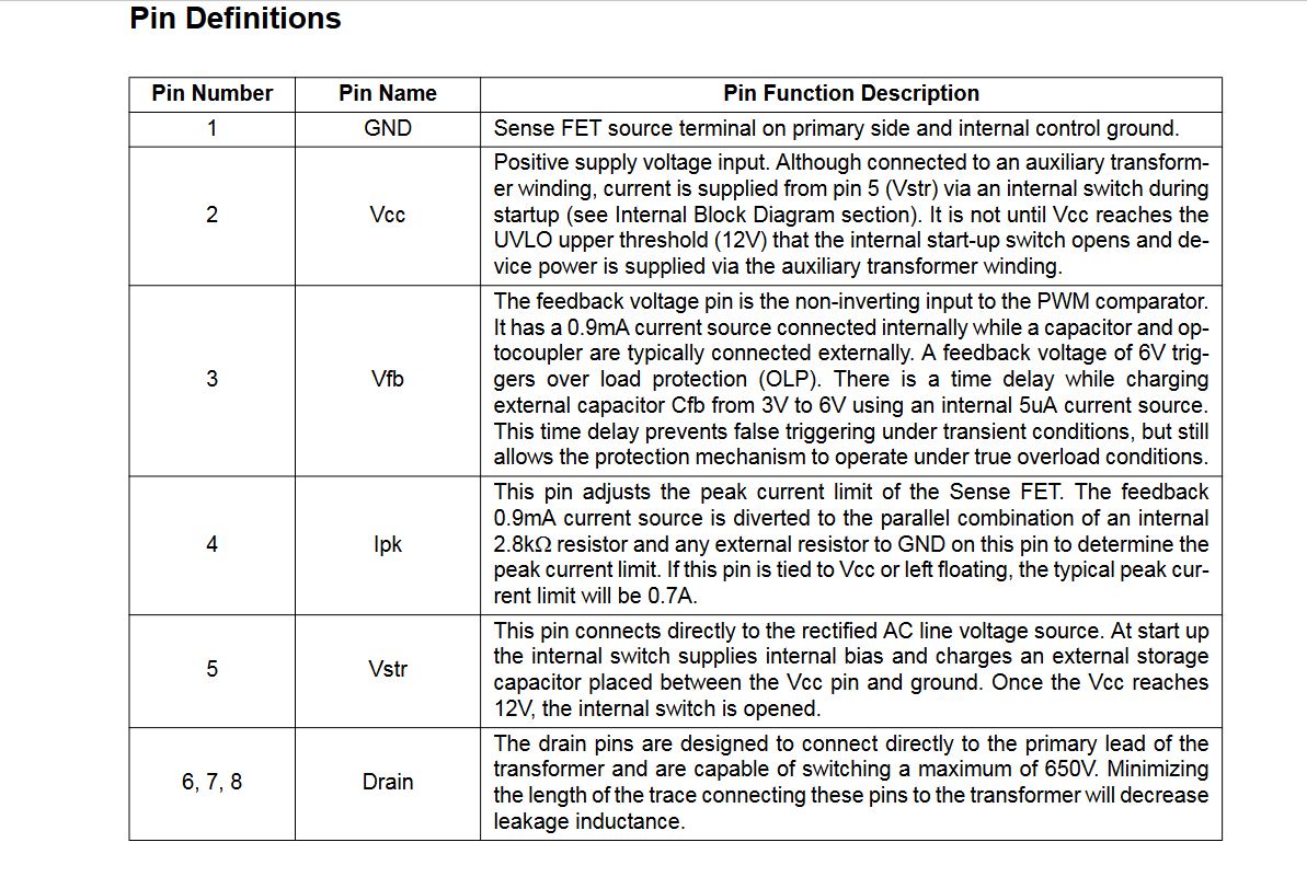

                            That voltage is too low to kick start IC806. From the data sheet for FSDL321. Read Pin2 and Pin 5 function.

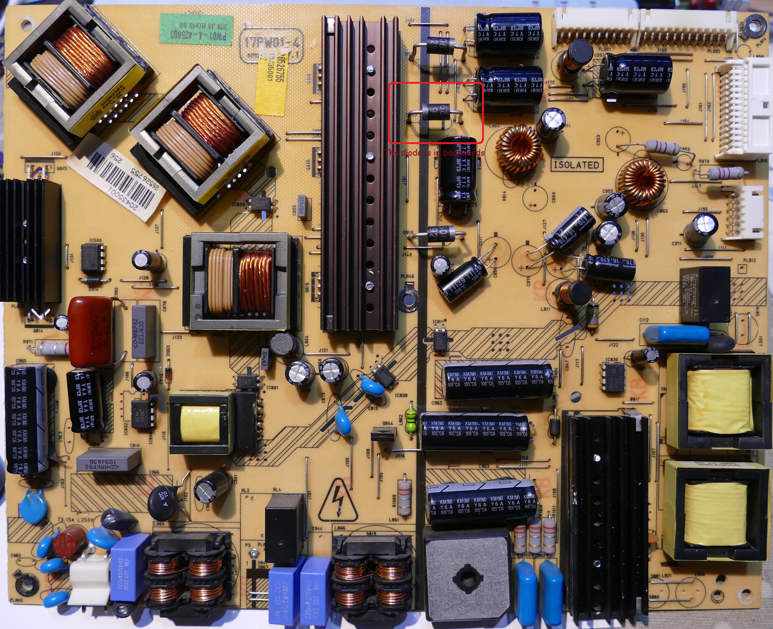

                              the 10K R501 measures 10K. D896 shows a voltage drop of 0.5V.
                              where does the +400V supply come from on the anode side of D896?

                                Re: Vestel 17PW01-4 PS board stuck in standby
                                Generated by NCP1653, (IC830)

                                  I think I found it. Is it at the right hand side of all those caps (962-963 et al)?
                                  To the left of them is L867 which has a low resistance, so I guess is OK(?)
                                  To the left of that is D110 which is difficult to measure in circuit as it's under a soldered in heat sink. With the meter in diode mode i'm measuring: a drop of 0.354v.

                                          One of your diodes supplying +12V is in backwards.
