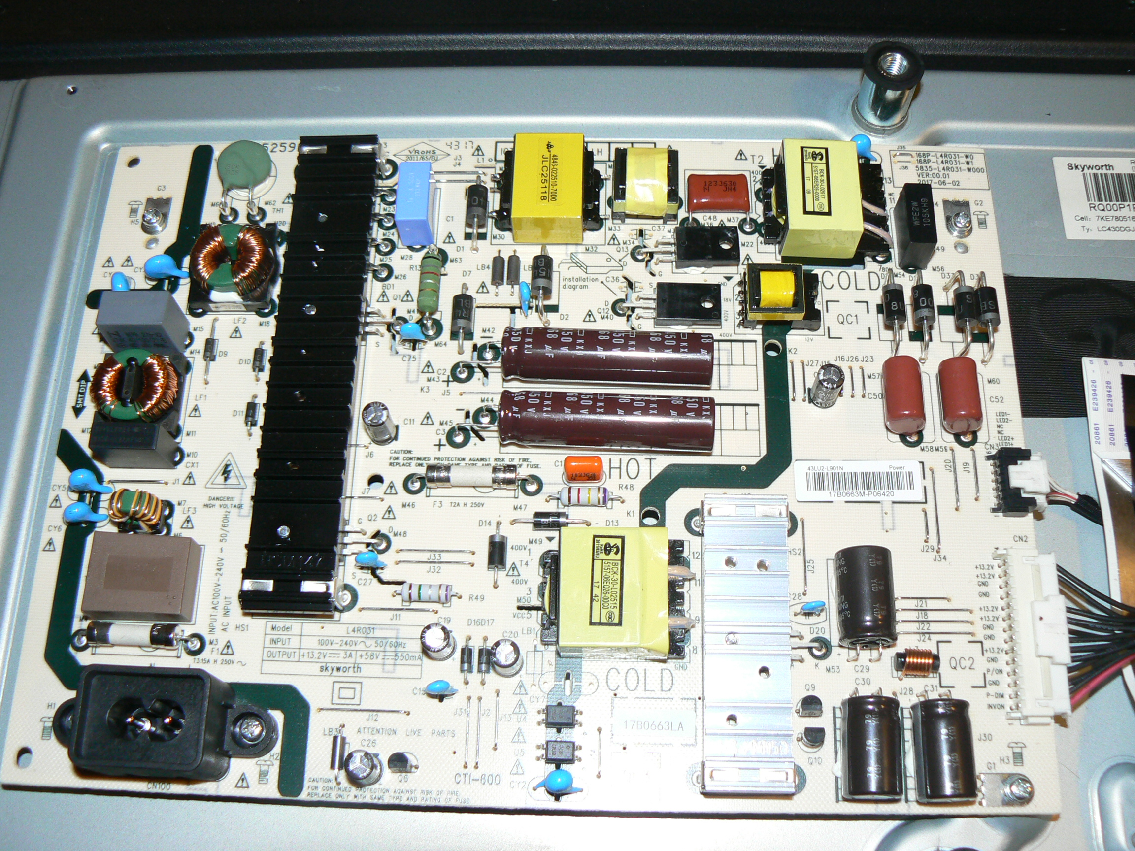

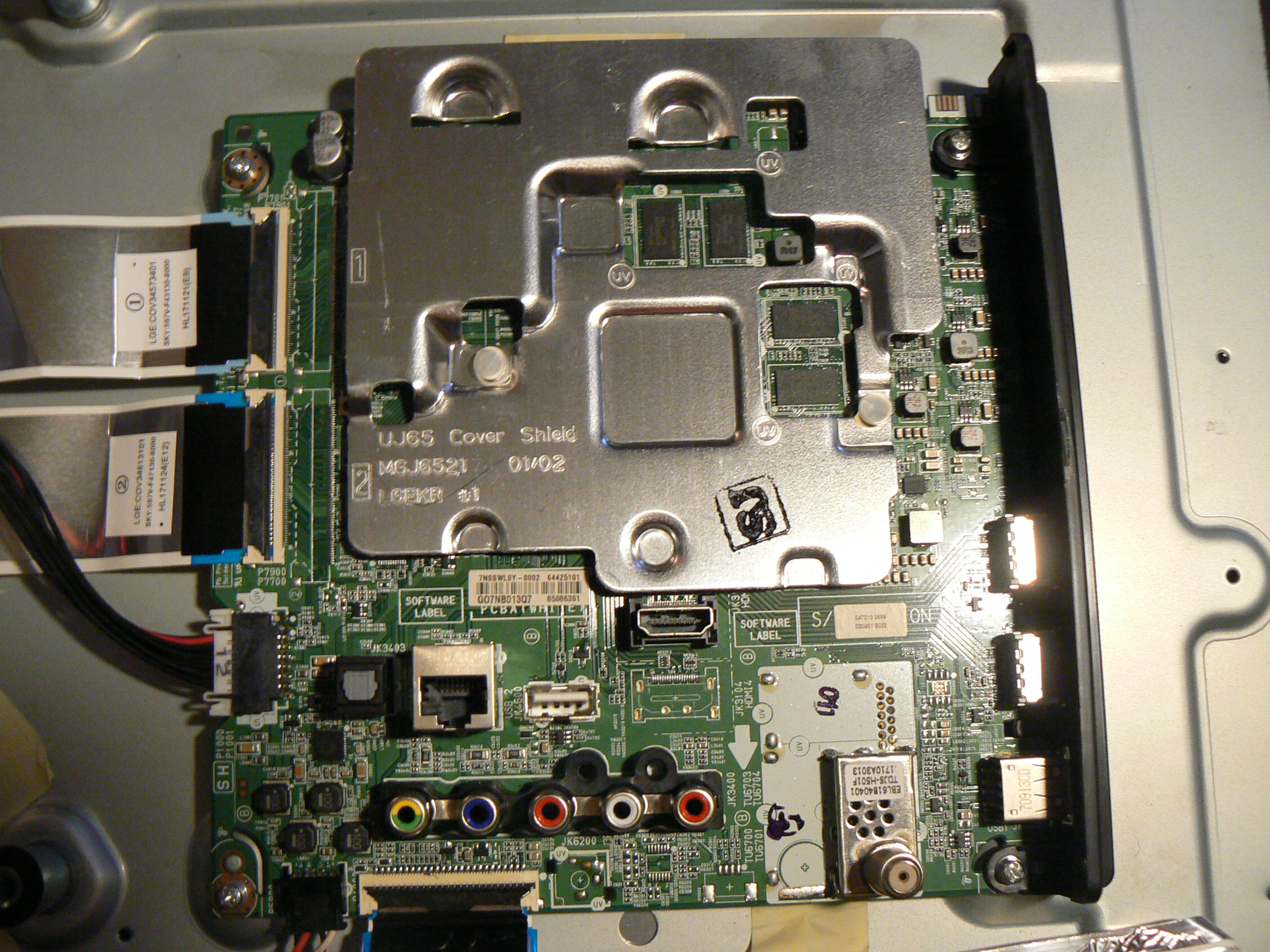

      Lest see good clear pictures of the whole backside of the TV showing all the board, and then good clear straight shots of the whole top and bottom side of the power supply/LED driver board.

                  Re: LG TV sound no picture, boards replaced
                  So where are the pictures I request? Are you really going to take the panel apart without doing more Voltage testing?

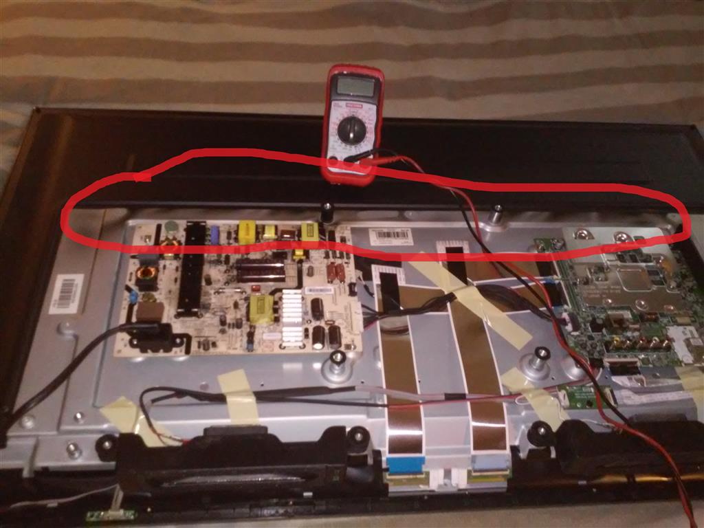

                    I have to find a hosting sight for pics. I have done more voltage testing. I believe I was doing the tests improperly before . When I tested before, I would power the TV "on" then place my VOM meter leads on the connections. This time I have the meter leads on the connection before turning the TV on. My updated results are below:
                    Sound no picture. Flashlight test shows picture. When TV is turned on, "LG" flashes for a split second, then no picture just sound. Six pin connection from power supply board to LED's shows 19.55V when turned on then quickly drops to .03V. This happens at both LED1 and LED2. With six pin LED connector disconnected, when turned on, shows 15.6V to 26V then quickly drops to .0V the drop happens so fast it is hard to see on the meter.
                    Does this sound normal if some of the LED's are blown? If it does, I did not know the drop or shut down occurs so fast.
                      LGs are famous for this.
                      You have one or more bad LED strips..
                      It IS repairable, but it's a bear.. The good news, it's only 43" so it's definitely doable..
                        1) You can upload the pictures here, no need for hosting site.
                        2) Is this your board? https://www.shopjimmy.com/lg-cov3444...iver-board.htm
                        3) You have two LED strings, LED1 + (Anode) , LED1 - (Cathode), LED2 +, LED2- each pin of the LED connector is labeled, so your report does not mean much without the pin names.
                        4) You need to leave black probe on the chassis, keep red probe on each LED pin one at time then turn on the TV to see how high the Voltage jump up too and settle down to, repeat that on the other 3 LED connector pins.

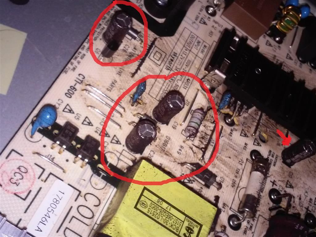

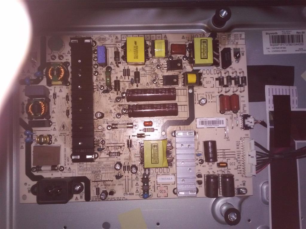

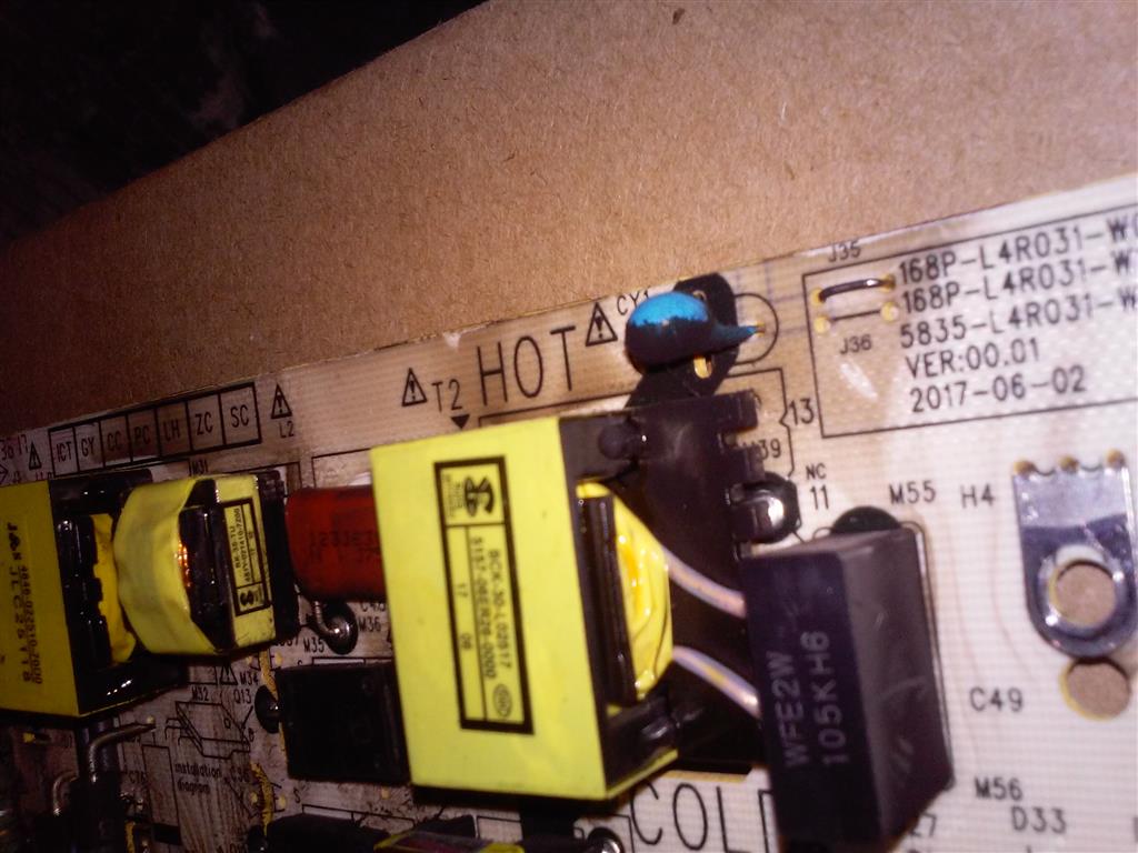

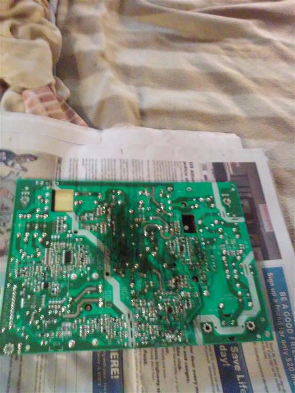

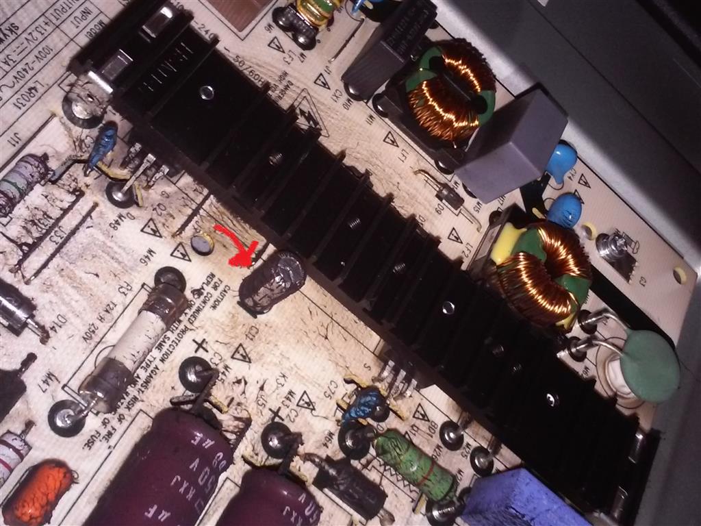

                            Pics of old board show something burned up. Board is coated with black residue from whatever burned up. You can see top of back panel in circled area where the smoke or residue went up. The 3 capacitors circled were coated with residue but appear normal. I do not know proper way to test them. I only found one component, I dont know what it is on the upper right corner of the board, it is blue in color. Either it burned up or the thing next to it (to my uneducated eyes looks like a transformer?) got really hot as one side of the blue thing is coated in thick black residue. The board at this area (upper right corner) also shows signs of heat and is stained.
                            The back side of this board shows black residue (from heat?) in the middle, but otherwise looks ok. To be clear both this board and the main board have been replaced. My assistant is taking notes lol
                              If you look at the Voltage chart printed on the board, the LED power supply is rated at 58Vdc with current capacity of 550mA, but are only getting 20V without LED connector in place, so your readings do not look right.
                              What DCV do you have when measure right between the two legs of the main filter caps when TV is turned on?

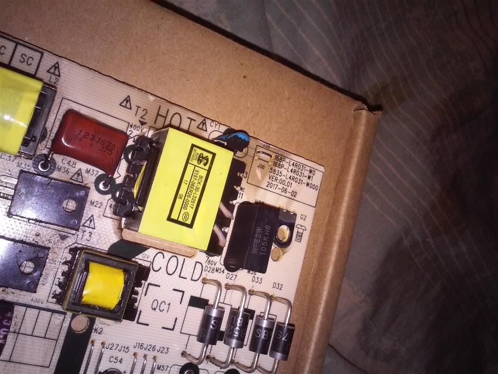

                                  Main filter caps are the long brown caps rated 450VDC laying on the side.
                                  Pictures of the new board? and where did you get the new board from?
                                    New board came from ShopJimmy, I have soldering tools but if board is defective, shopjimmy will and should replace it. Voltage at main filter caps with TV on: 373V each
