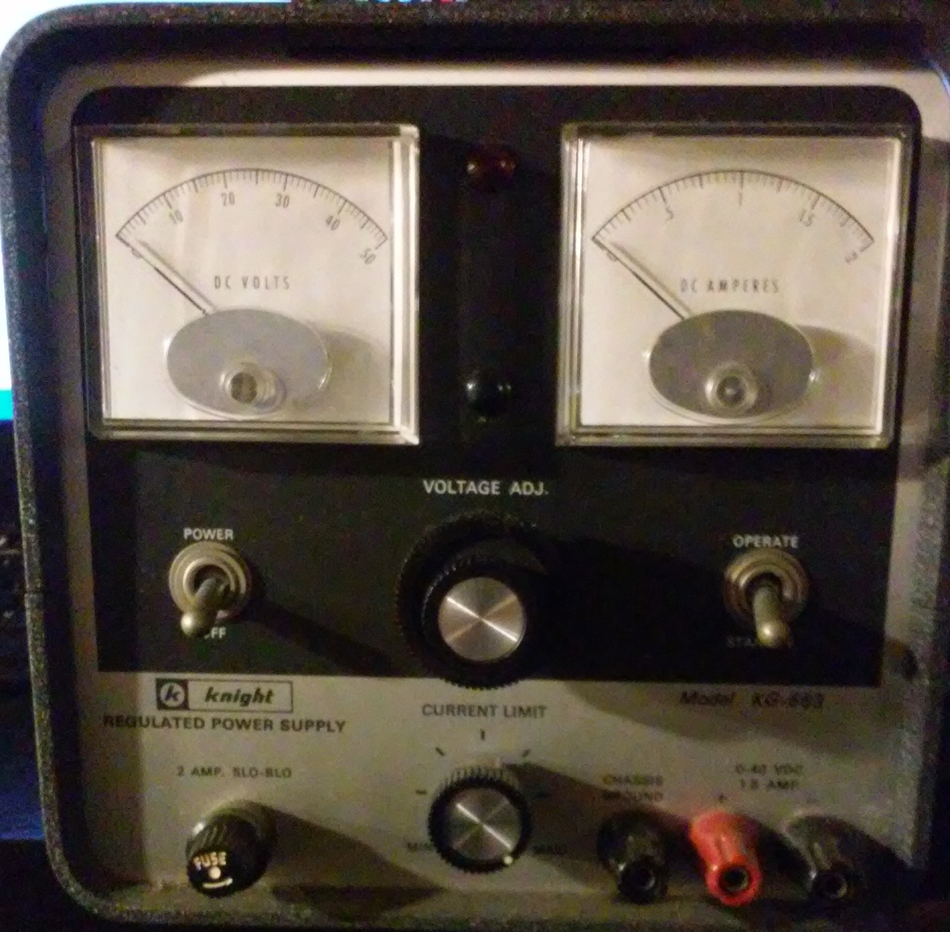

          I do not have a LED tester but I do have an old Knight regulated power supply. Could I use this to LED1+ and LED2+ to confirm back lights?
          What do you think about the old board? The heat marks and black residue? Im guessing something went bad and maybe voltage spiked and blew some LED's out?
            Re: LG TV sound no picture, boards replaced
            In the typical LED driver the LED1-, 2- do not go to ground directly, they connect to ground via PWM controlled MOSFETs and current sensing resistors to ground to maintain constant current through the LED strings. LED's are driven by constant current power supply, not by regulated Voltage power supply.
            So set your power supply to about 40V for starter and limit the current to about 100 ma (you must limit the current) then connect it to each LED string (connector removed from the board of course) to be tested.

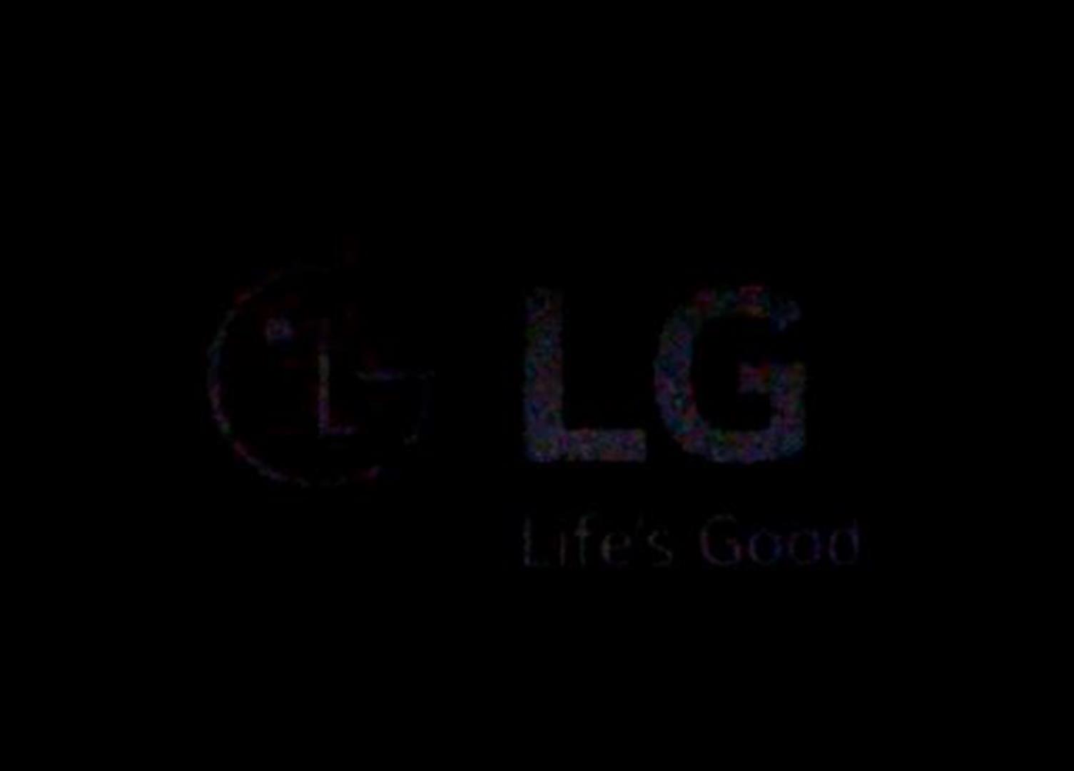

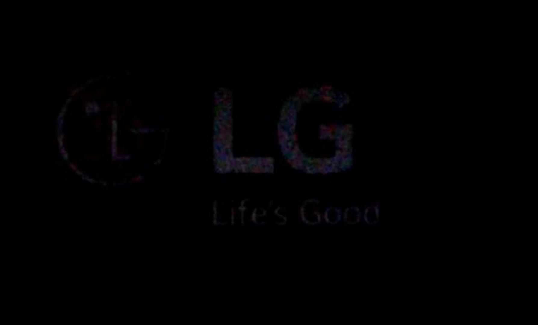

                            Tried video taping the split second flash. It is really fast. The "LG" and "lifes good" (not anymore) does not look right. Is this possibly what only a few working LED's might look like when flashed? These are stills captured at the best frame of video.
                            • neilc6
                              • Nov 2015
                              • 1550
                              #34
                              You need to video the flash with the panel removed. See my blog post here

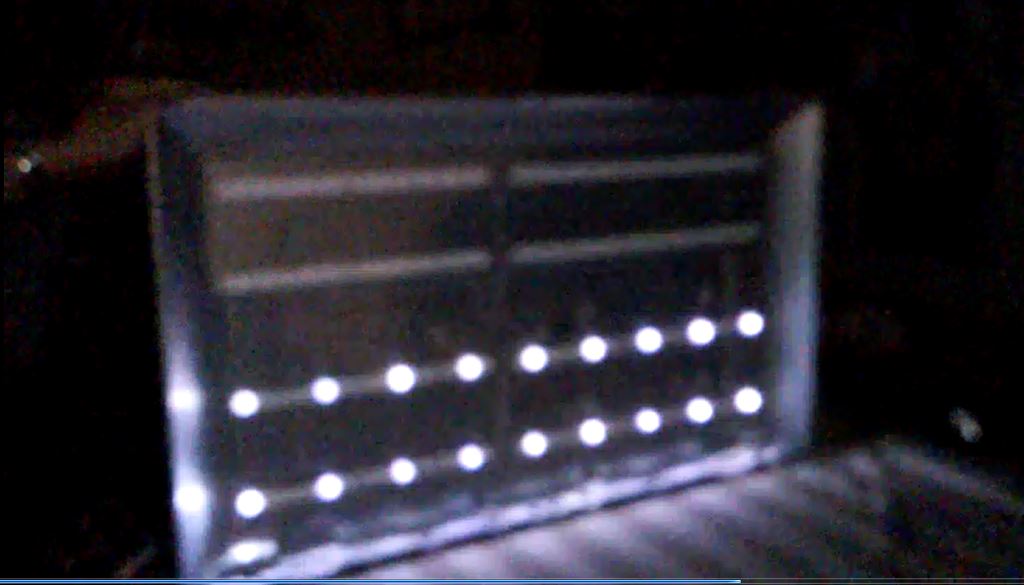

                                    I have an update on my LG4300
                                    I removed the screen, many thanks to nomoresonys, the video you gave me was very helpful. I was shocked to not find anything burned up. The wiring and all the LED's look pristine. I powered up the set without the screen and the top two rows of LED's are out. So only the bottom 18 are working. Nothing visibly notable about the top 18. Is it common for two whole rows to go out at once? Whatever burned up has to be on the power board or main board. Both have been replaced
                                    I understand that when any LED's burn out the power will shut down and you get nothing or rather no picture just sound. Powering up the set without the screen per neilc6 suggestion has shown me which ones are out. I intend to test the bad strips to confirm. Your thoughts, suggestions, and how to procede from here would be much appreciated.
                                    • neilc6
                                      • Nov 2015
                                      • 1550
                                      #38
                                      You have an open LED in the top half causing the whole string not to light up. Tougher to isolate but you can use a multimeter in diode mode and check every LED or swap each non lit strip into the working string. Can replace only the bad strip but all the LEDs have wear and could fail in the future. You need to turn down the backlight level on all inputs and all smart apps after repair. Top and bottom strings are probably wired separately so the backlights flashed from only the bottom string. I think I have a full set of strips for this model (from new cracked screen tv) for this model on ebay (check the part number printed on the strip).
