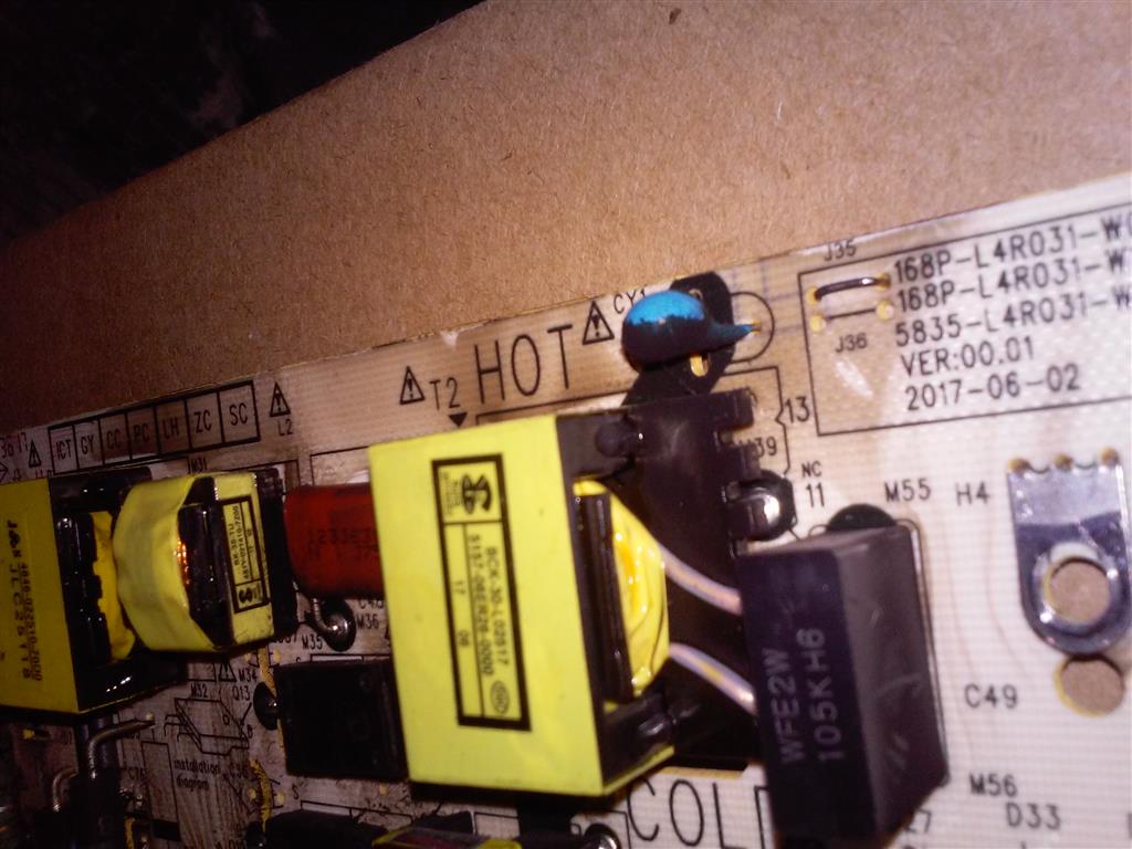

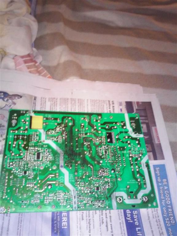

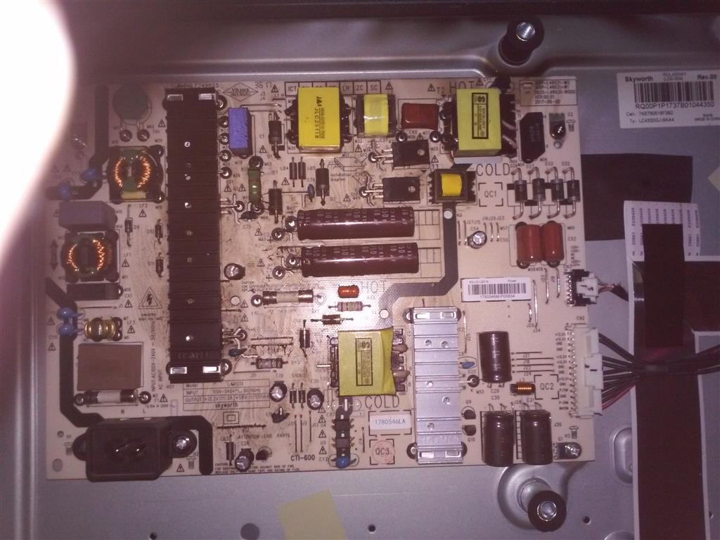

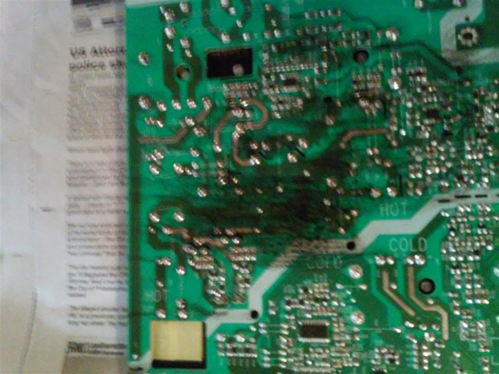

    The black soot seems to have originated at the center, and possibly the upper right corner (look at the soot deposit on that blue component) of the power board, even though there are not any visible signs of bad components. The capacitors all "look" good. The center of the power board shows soot and also at the center of the back of the power board. This is all black soot which easily wipes away. The main board is clean. The front LED area was absolutely clean, not a smudge.

      You can get black soot on boards if the tv is in a home with a heavy smoker.

        No smokers in house. Sent you a IM

          You got a new power board right? so get the strips and see if that does it.

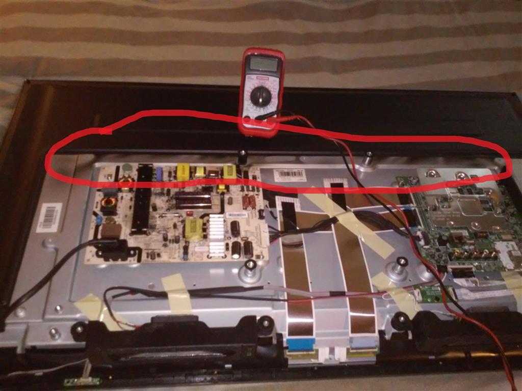

                      One thing, when testing the power board at the two LED outputs, with the LED's disconnected, I used two different multimeters. The cheap craftsman was not fast enough to read the peak voltage before the board would shut down. All the readings I got were inconsistent and varied a lot. I used an older Fluke multimeter and it would read 25VDC before shutting down. The specs are Minimum 51.4 VDC at each channel. The Fluke was also inconsistent and varied. I don't know if 3 of the LED's blowed and caused the power board to burn up or the other way around.
                      Many thanks to Badcaps forum, budm, nomoresonys, neilc6 and everyone here who took the time to help me. I was able to fix my TV and learned something while doing it. I hope this thread might help others with the same or similar problem.
