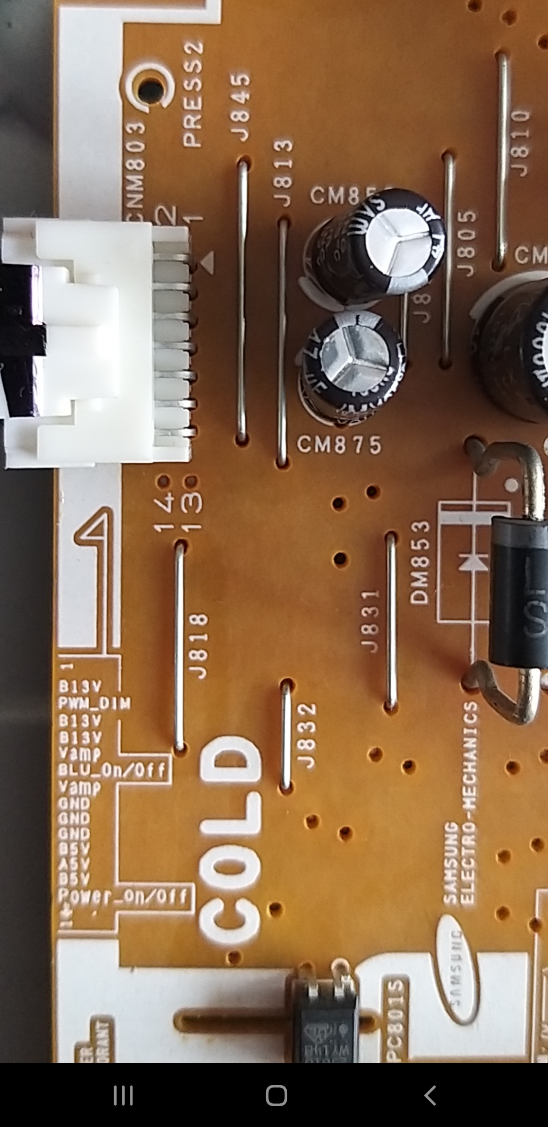

    UE40EH5000KXXU No power completely dead
    No power led at all!

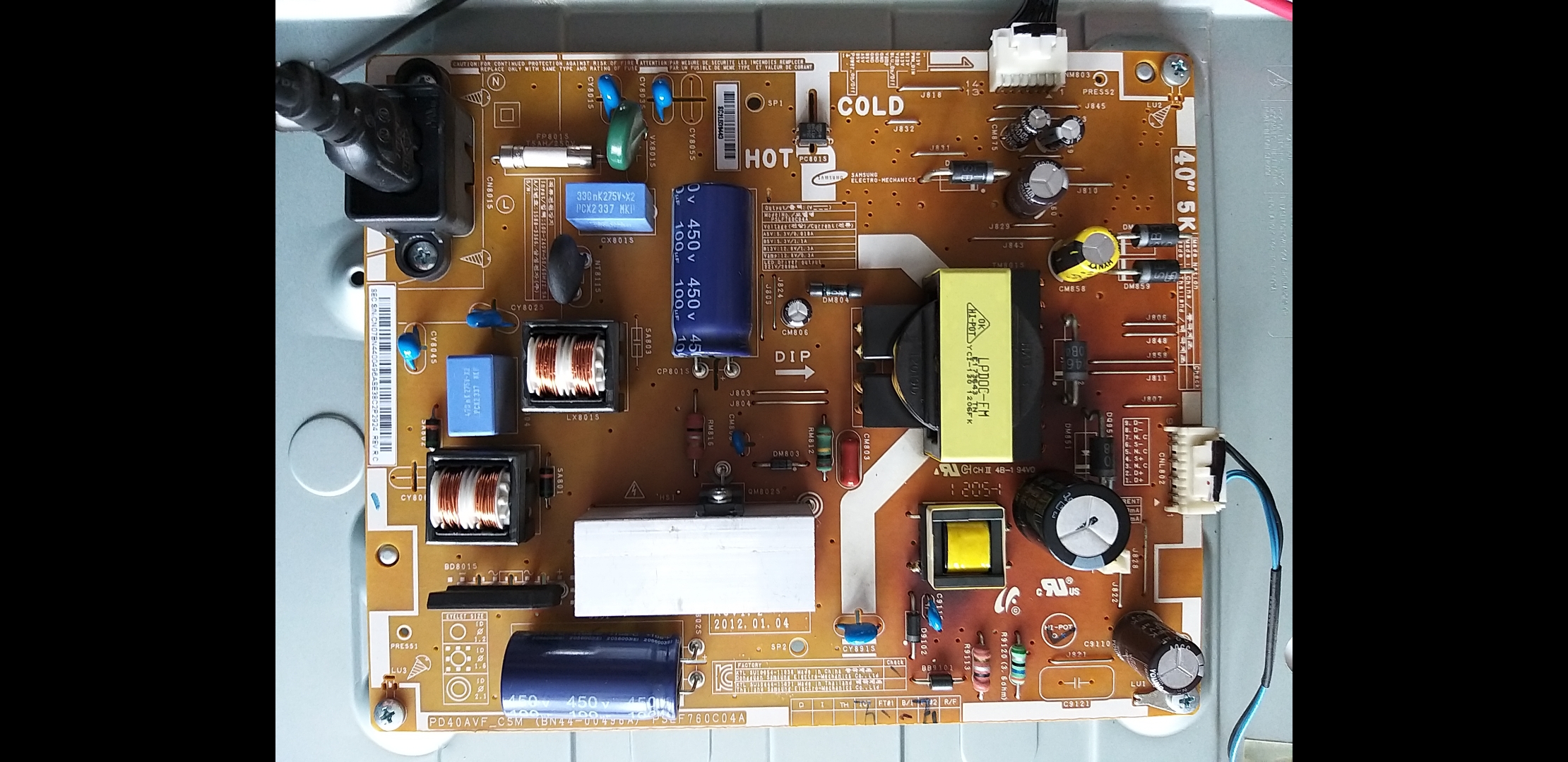

    Psu bd - BN44-00496A
    Main bd - BN41-01795A
    Key bd - BN41-01840B
    Main CNM803
    Pin 1 13v
    Pin 2 0.08v
    Pin 3 13v
    Pin 4 13v
    Pin 5 13v
    Pin 6 4.86v
    Pin 7 13v
    Pin 8 0v
    Pin 9 0v
    Pin 10 0v
    Pin 11 5.27v
    Pin 12 5 27v
    Pin 13 5.27v
    Pin 14 3.37v
    No change in voltages when pressing the power button.

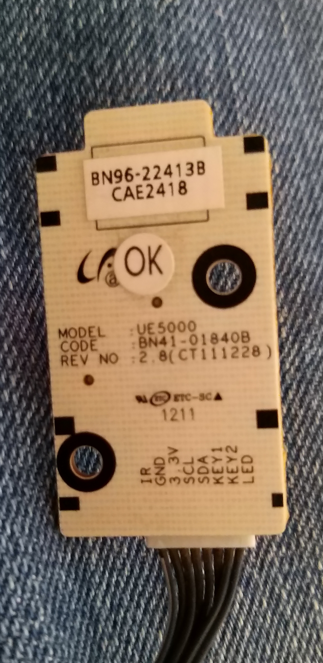

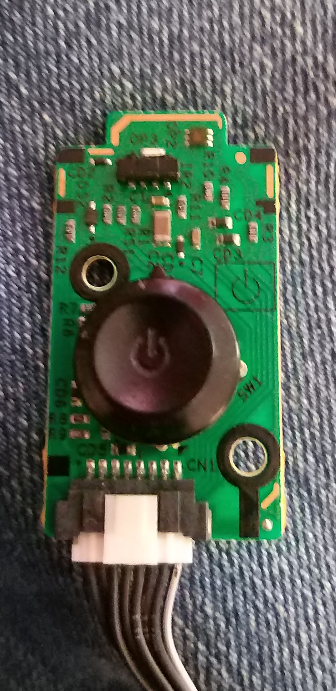

    Highly suspect the Main bd as theres no voltages present on the key bd (i.e power button/ir sensor/function buttons), theres no 3.3v.

    PSU CNM803 Pinout

      Re: UE40EH5000KXXU No power completely dead
      Looks like your tv is in an on state (pwr_on and bl_on) are both high. If you disconnect the cable between the main board and power supply board, do the backlights come on? If not suspect bad backlights. Seen lots of failures on EH model years. Front led not coming on may be a different problem.
      • R_J
        • Jun 2012
        • 9551
        If you disconnect the cable between the main and power supply, and you don't have backlights, check the voltage on pin 6, BL ON/OFF, if it is around 5 volts, take that pin to ground and then your backlights should come on
          Ok, yes. Get backlights come on by disconnecting the main bd. Around 3v on pin 6.
          With main disconnected voltages read:
          Main CNM803
          Pin 1 13v
          Pin 2 3.13v
          Pin 3 13v
          Pin 4 13v
          Pin 5 13v
          Pin 6 2.94v
          Pin 7 13v
          Pin 8 0v
          Pin 9 0v
          Pin 10 0v
          Pin 11 5.27v
          Pin 12 5 27v
          Pin 13 5.27v
          Pin 14 3.13v

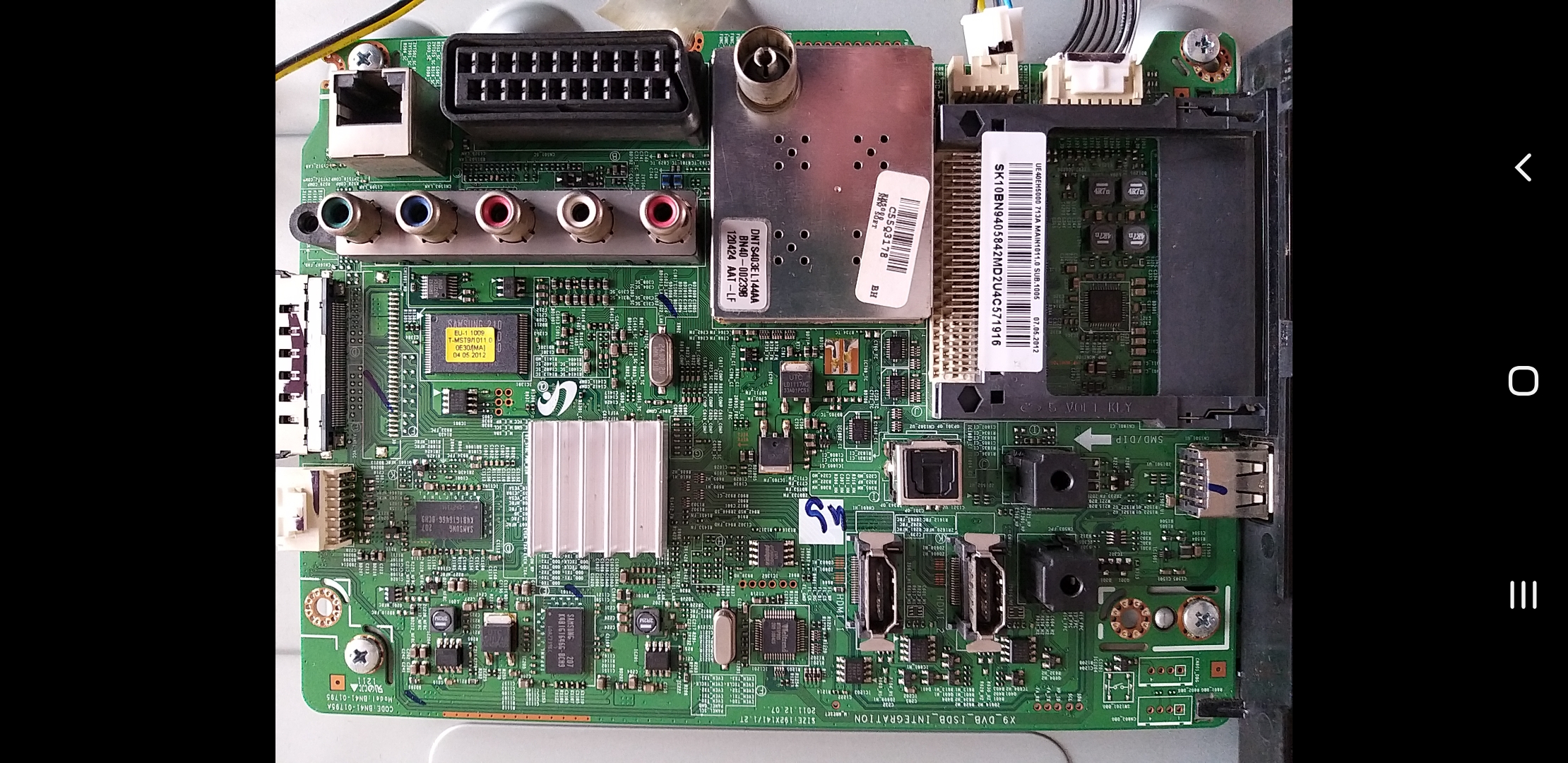

              Main bd connected and T-con disconnected still nothing.
              Firmware corrupt?

                        Theres no 3.3v to the key pad (ir sensor/power button etc...)
                        and believe theres no 5v to the USB port.
                        Will have to check for voltage at the CL slot but doubt that either.
                          These boards use a WT61P805 which is prone to failure shorting the 3.3v line.
                          Could be the reason you're not getting 3.3v to the key pad.
                          They need to be programmed. They are available on ebay https://www.ebay.co.uk/itm/WT61P805-...-/273573661006
                              If its the MT61P then replacing is not an option, don't have a heat gun and not sure I would successfully be able to do it anyway.
                              Perhaps I'll just wait to source a replacement main bd.
                              Though meanwhile,
                              Volt reg's
                              IC205 LD1117AG - 0.26v 1.5v 3.3v
                              IC707 LD1117AG - 0v 3.3v 5.2v
                              IC705_FN 9915-12 - 5.2v 0v 1.2v
                              • notallbad
                                • Oct 2012
                                • 1190
                                Unable to locate any smd fuses on the main bd.
                                Also, if it were the WT61P805 shorted wouldn't there be voltage on pin 2? No voltage on the nearby crystal either!
                                Nor is there voltage on 25Q40BVSIP pin 8
                                    thats correct budm. no voltages on any of the keypad connector pins.
