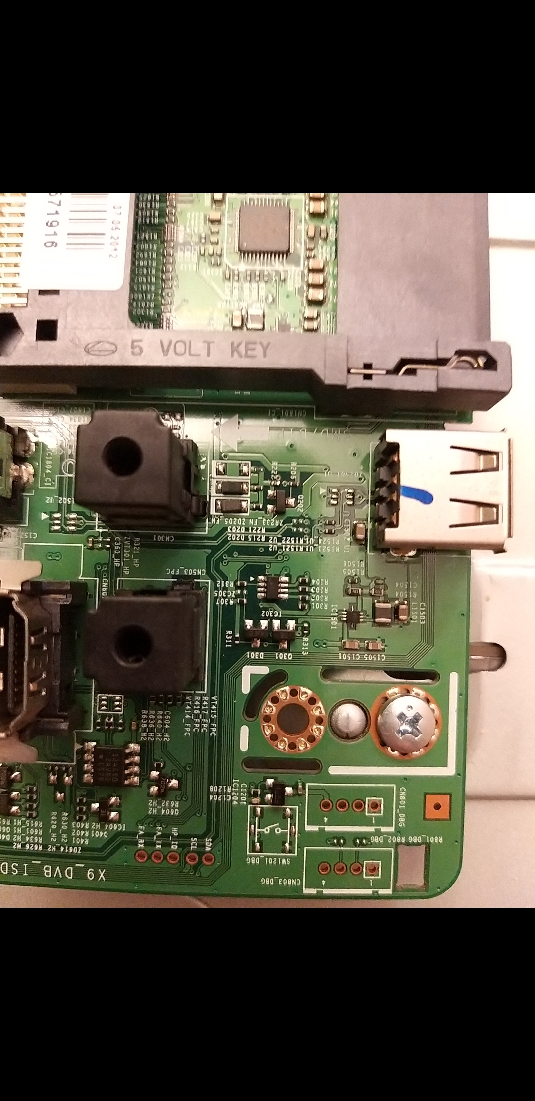

            The keypad 3.3v line traces back to pins 3, 4 & 8 of an SMD 8 pin ic marked WAA P which is IC302.
            Pin 1 - 0v
            Pin 2 - 3.29v
            Pin 3 - 0v
            Pin 4 - 0v
            Pin 5 - 1.6v
            Pin 6 - 5.22v
            Pin 7 - 5.27v
            Pin 8 - 0.02v
            Pin 1 does not appear to be connected to anything.
            • notallbad
              • Oct 2012
              • 1190
              Re: UE40EH5000KXXU No power completely dead
              Pins 3 & 4 appear to be gnd.
              Pin 8 is also connected to gnd but a couple of ohms higher.
              • R_J
                • Jun 2012
                • 9535
                Which plug is for the keyboard? the ic seems a long way from the plugs, Also if you look at the edge of the board next to the tuner input, there are holes with names FUNC_xxx etc. I would think the third hole would be FUNC_VCC or the sixth hole FUNC_BT_VCC could have 3.3v?
                • notallbad
                  • Oct 2012
                  • 1190
                  CN1202 is keypad
                  CN201 is psu
                  Func_P_Det is 3.29v
                  Func_bt_vcc is 0v
                  Func_vcc is 0.02v

                        Try and trace ic1203's vcc, maybe it goes to a transistor where they switch the vcc on and off, I do see a resistor between WP and VCC so maybe they do switch the vcc on and off.
                        • notallbad
                          • Oct 2012
                          • 1190
                          #32
                          Ic1203's vcc pin 8 goes to ic202 - 1G1 R tran.
                          pin 8 shows short cct to keypad vcc pin 3.

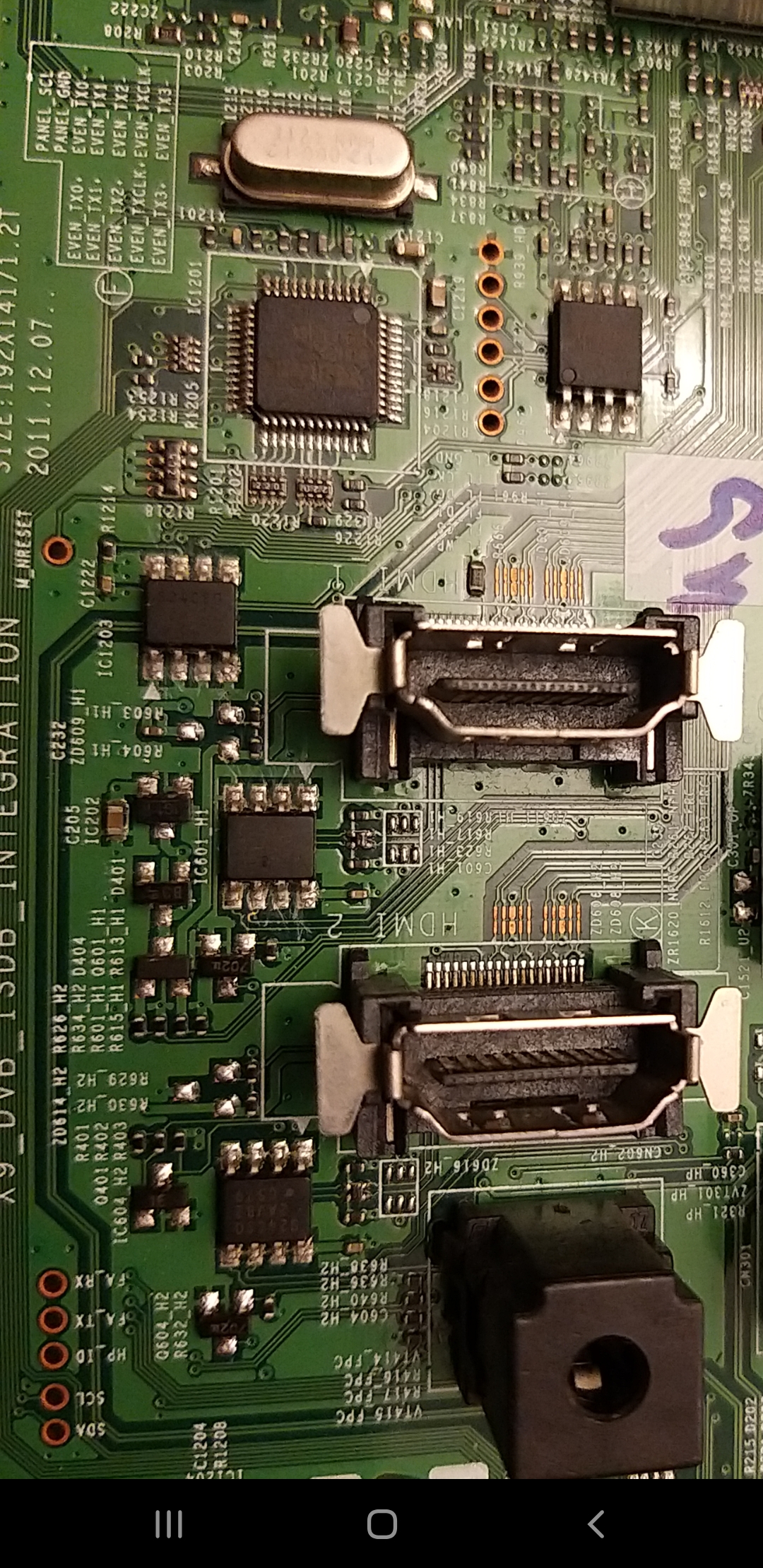

                            What voltage do you have on IC202, It "might" be a mcp1700 3.3v ldo, It IS marked as an IC
                            • notallbad
                              • Oct 2012
                              • 1190
                              #34
                              If IC202 is an mcp1700 the pins are as follows
                              pin 1 gnd 0v
                              pin 2 output 0.02v
                              pin 3 input 5.27v
                              It is marked 1G1 R.
                              • R_J
                                • Jun 2012
                                • 9535
                                #35
                                And that could explain the missing 3.3v , Either there is a short on the output or the ic is bad and not supplying the voltage.
                                When I said it was marked as an ic I ment its board designation. so its not a transistor (Q) or diode(D)

                                      Wait, it is not possible that all that ICs are fed by a small sot23, diif has said one important thing, he knows of a common problem on Welltrend chip, and since it is a standby MPU it is explained why no led blinkings, second, i remember that AVboard has only one AOZ1051P, the remaining two pwm chips are from Texas, something like TPS4427, right? The most important thing to do is to use a bench PSU and feed on the 3,3v rail (put for example on the pin8 of IC2301, the settings eeprom) starting with 3,3v and 0A and rising the Amps until something gets hot, especially the MPU..
                                      • R_J
                                        • Jun 2012
                                        • 9535
                                        #39
                                        That ic202 (sot23-3) is NOT the main source for the 3.3 volts for the board. IC707 is likely the main source for 3.3 volts as it has 3.3 volts on its output.
                                        • Davi.p
                                          Hobbist Tech
                                          • Sep 2009
                                          • 4302
                                          • Italy - Milan
                                          #40
                                          Another hint, the AOZ1051P in its datasheet it's marked as "Not recommended for new designs", so i guess it has reliability problems..
