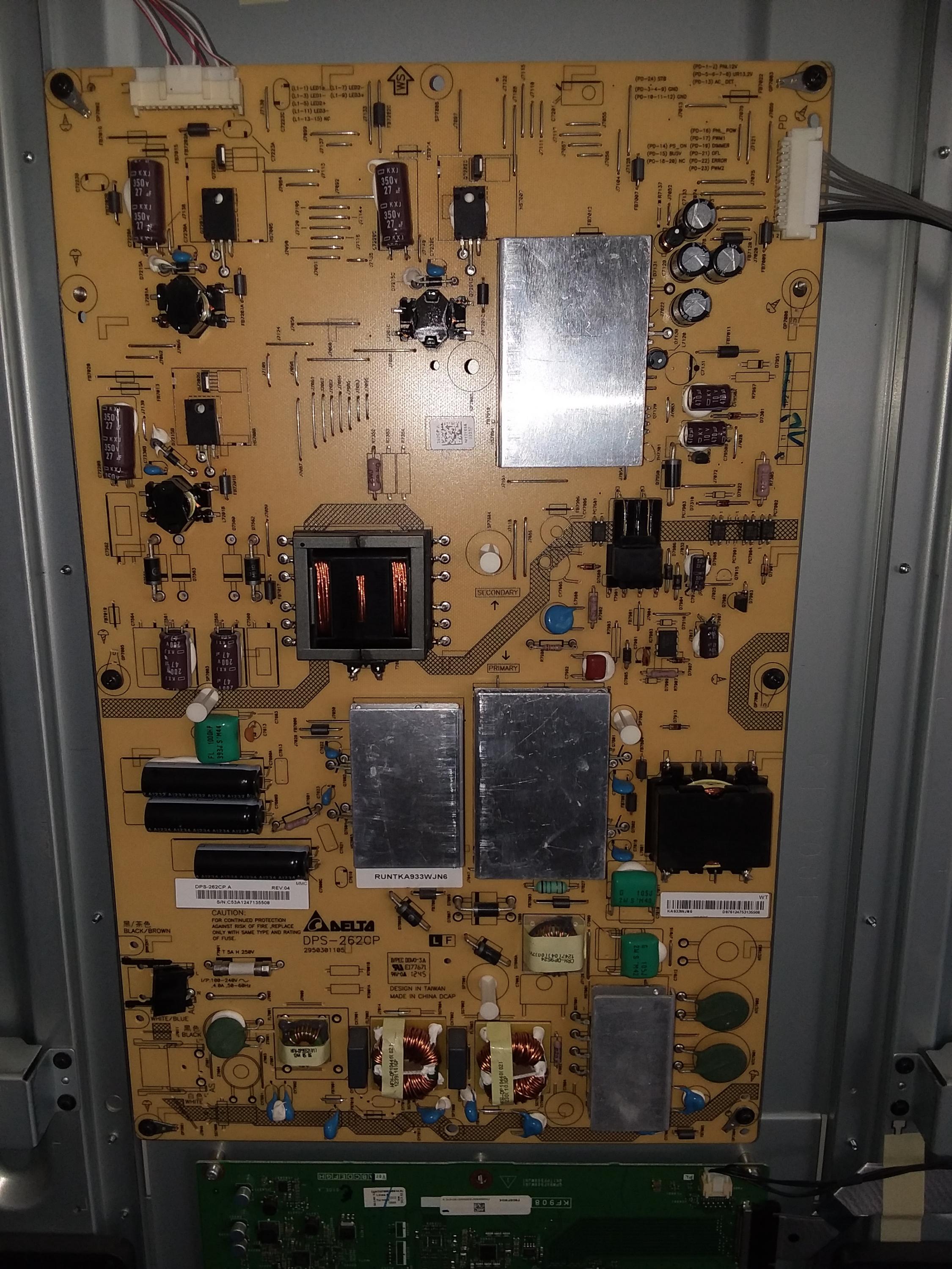

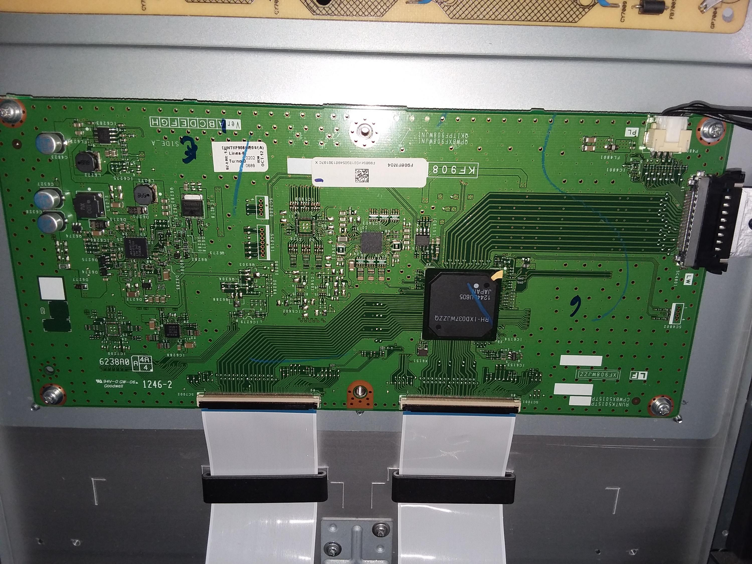

    I pulled the cover off and this is what I've found:
    * On the PD plug on the power supply board, pin PD-15 BU5V has the required 5 volts.
    * No other pin has voltage.
    * Pressing the power button does not pass the 5 volts to the pin PD-14 PS_ON.
    Over on the main board, if I jump those two pins (easier to do on the main board), I get appropriate voltages on the other pins EXCEPT FOR:
    * PD-1-2 PNL 12V ---- has 0 volts
    * PD-16 PNL_POW ---- has 0 volts
    I simply do not know where to go from here!
    As soon as I post this, I will go take pictures of the configuration of the boards in the tv as well as of each individual board and post them.

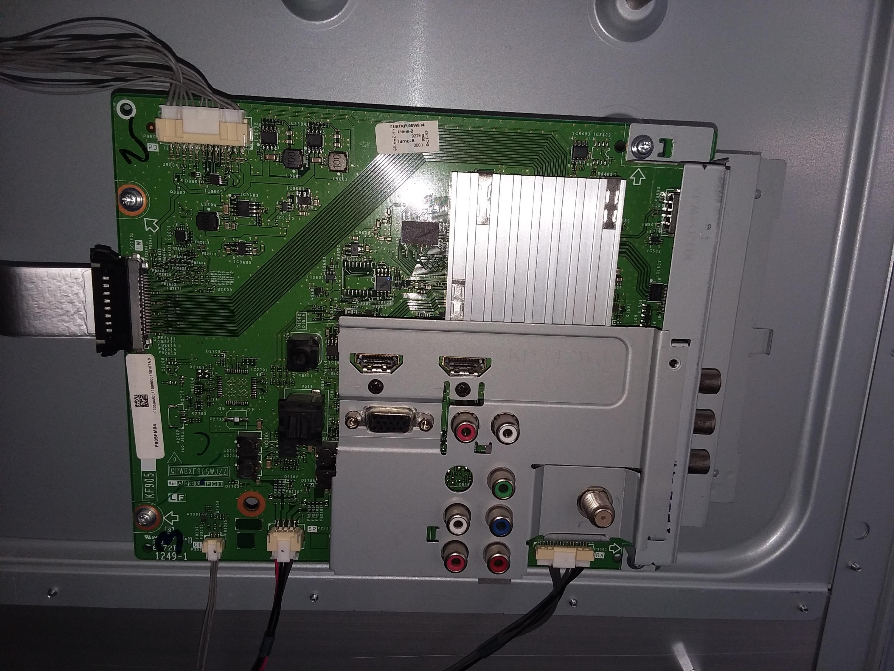

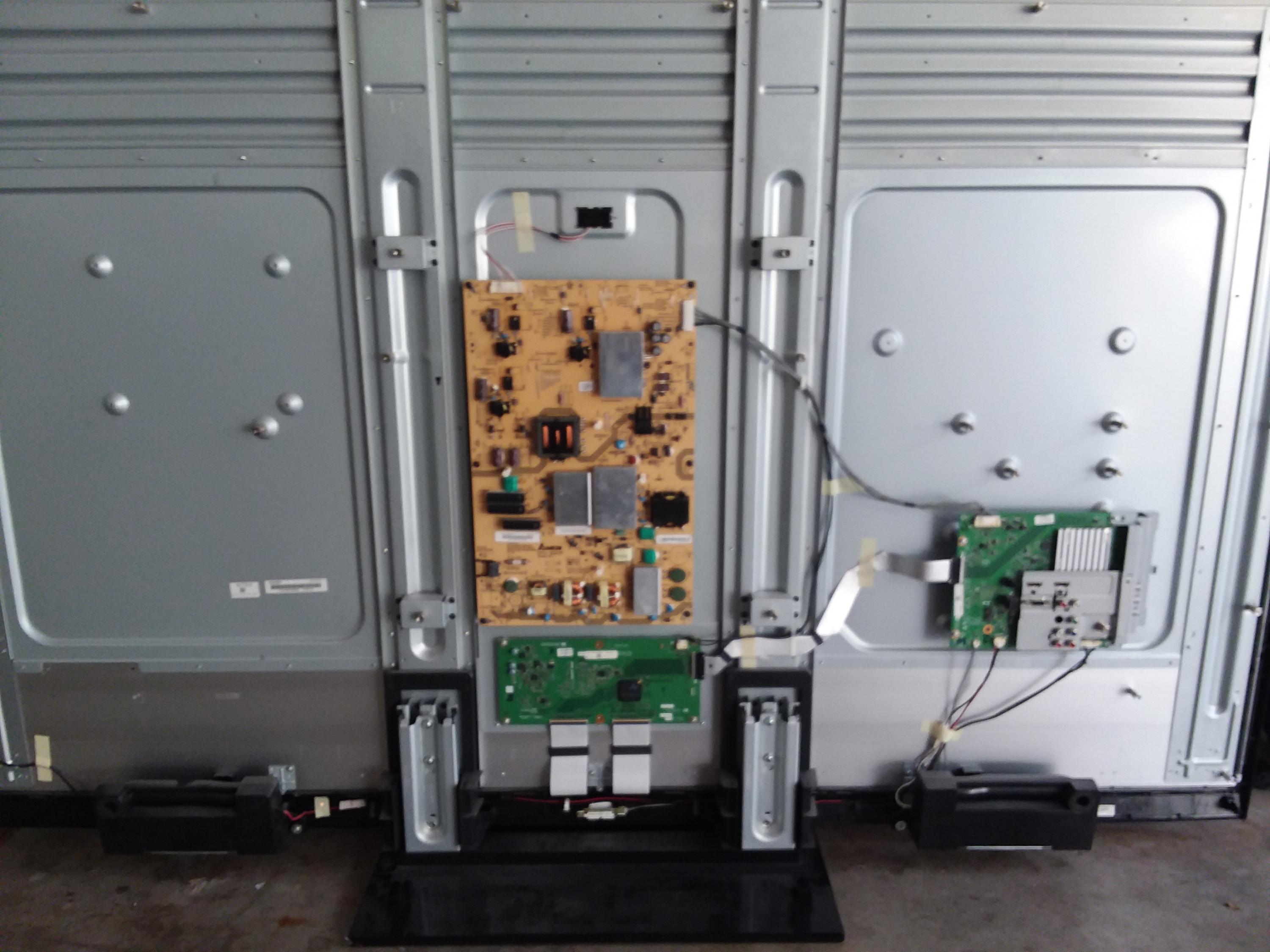

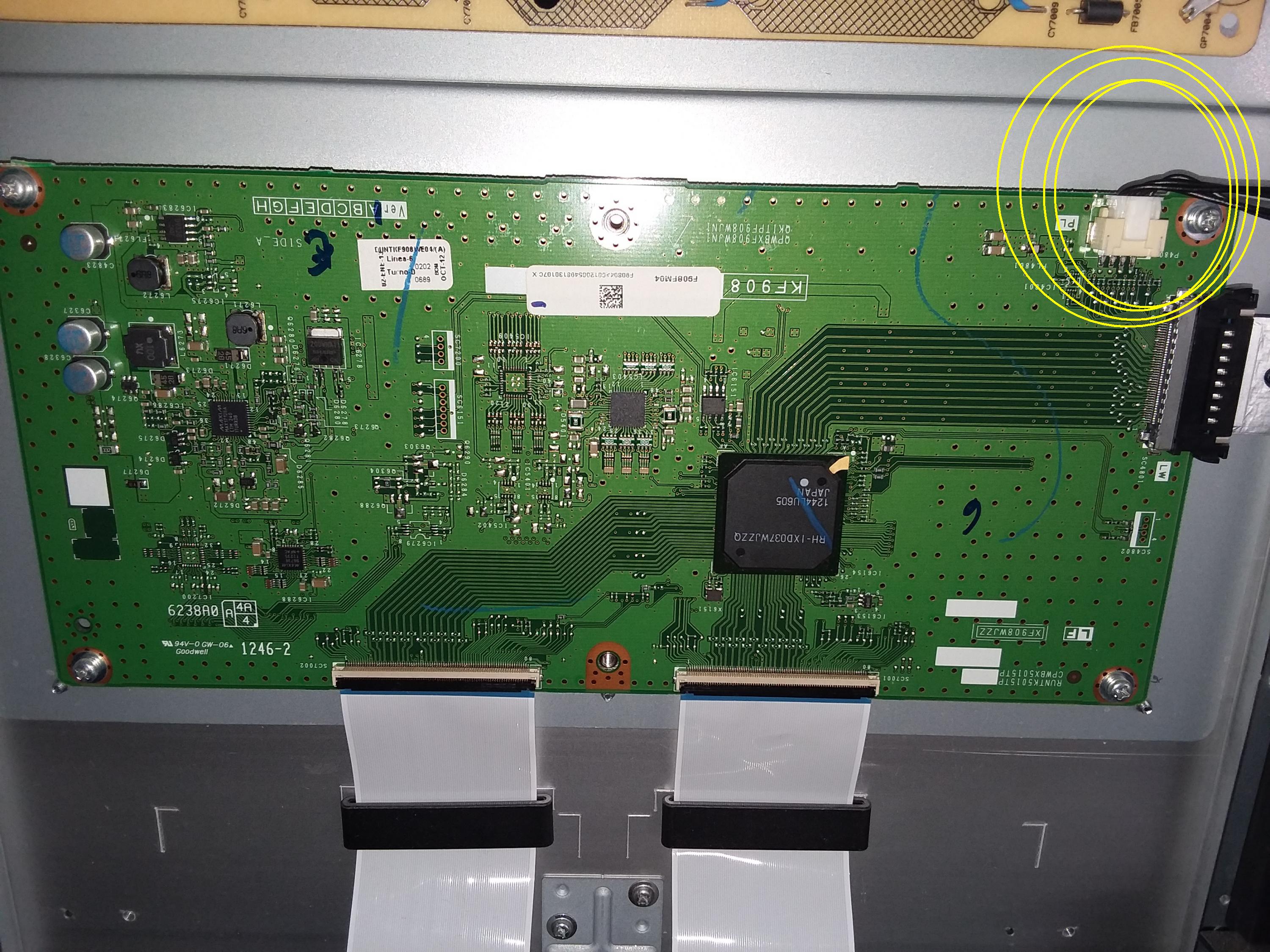

    So here's the pictures...
    better pics and more info can be provided if needed and any help would be GREATLY appreciated!!

        lots of 70 threads to read... do the regular "disconnect tcon to panel cable" one at a time and see what happens. If nothing, get out your meter and do some measurement of the connector at the power board which usually has labels for the pins there.

            You have standby 5v from the power supply to the main board, make sure the 5v does'nt drop when you press the power button. If the 5 volts standby stays up the main board should supply the PS_ON voltage, when the power button is pressed. If it does'nt, the fault is very likely on the main board. Without the PS_ON, the power supply will remain in the standby condition.
            Shopjimmy does offer a eeprom, so that might be the problem, or you can try unplugging the tv, freezing the eeprom with cold spray, pluging in the tv and see if it turns on, sometimes this trick works but not always.

                Ah... so you mean while I'm literally pressing the power button? Sorta like a battery load test in a car, test voltage while turning the engine over with the starter. I'll check that this afternoon.
                As for the eeprom, is that on the main board or the tcon? There's nothing that looks like a large computer chip on the main board.
                Also, the large chip on the tcon board gets really hot. Like, can't hold your finger on it for more than a second hot. Is that normal?

                        PD and PNL_POW are panel display and panel power.
                        Perhaps the issue is on the driver board. The thin board the two cables from the TCON connect to.

                          the only reason I asked for this test is that I have seen some sharp power supplies where the +5v standby would drop as soon as the power button was pressed. If this voltage stays up it is not causing the issue in this case.
                          The eeprom (or SPI) ic is a 8pin smd, IC8401 located on the main board.
                          The t-con board must be getting PNL12v as it is supplied directly from the power supply board.
                          Try disconnecting LVDS cable and PL plug on the T-con board and see if at least the tv's backlights come on.

                            Sorry, I should've been more clear on this. The chip on the tcon board gets hot when I start the tv using the input and volume down buttons while plugging in the ac cord. Otherwise, just using the power button which does not turn the tv on, no, it doesn't get hot

                                So today, twice, the tv has come on upon being plugged in (no buttons pressed) while several other times only flashing the chevron once. Not once has it shown any signs of life upon pressing the power button.
                                When pressing the power button, 0.0 volts at the pin PD-14 PS_ON. No jump/fluctuation. Nothing.
                                Here are the pins in numerical order, name/description, tv off plugged in, tv on.
                                PD-1 PNL12V, 0, 11.91
                                PD-2 PNL12V, 0, 11.91
                                PD-3-4 GND
                                PD-5 UR13.2V, 0, 13.17
                                PD-6 UR13.2V, 0, 13.17
                                PD-7-8 UR13.2V (NO WIRES)
                                PD-9-10-11-12 GND
                                PD-13 AC_DET, 0.05, 3.26
                                PD-14 PS_ON, 0.04, 2.81
                                PD-15 BU5V, 5, 5
                                PD-16 PNL_POW, 0, 3.21
                                PD-17 PWM1, 0, 0.47
                                PD-18 NC
                                PD-19 DIMMER, 0, 1.68
                                PD-20 NC
                                PD-21 OFL (NO WIRE)
                                PD-22 ERROR, 0, -0.01
                                PD-23 PWM2 (NO WIRE)
                                PD-24 STB, 0, 3.2
                                Just to be clear, all readings while holding the power button are identical to tv off.
                                Unplugging the flat cables at bottom of tcon and force starting the tv, the large chip does still get quite hot. I just don't know how hot is acceptable.
                                    Try disconnecting that PL plug on the t-con and see if the tv will turn on normally. This is how the t-con gets its power not from the flat cables at the bottom
