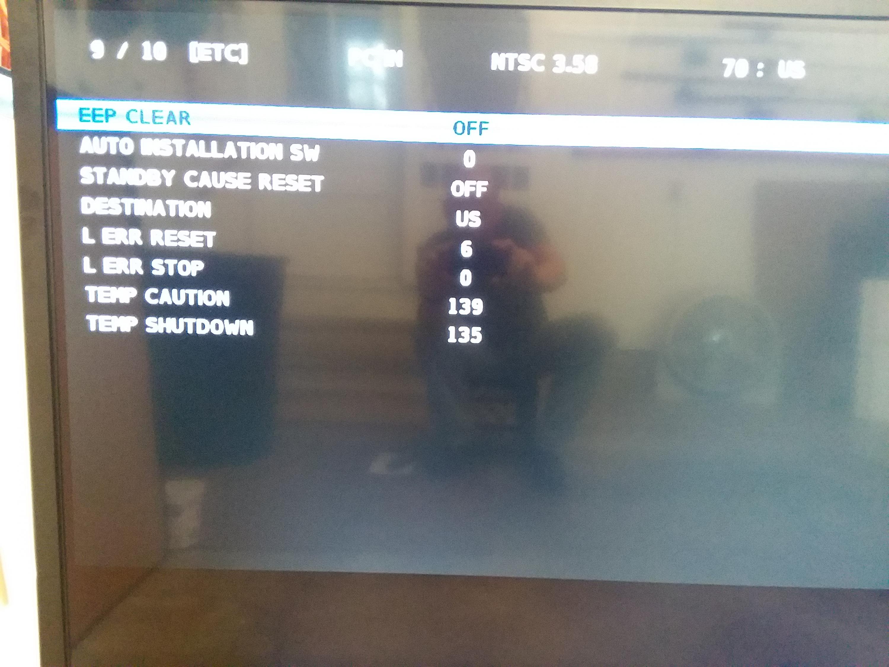

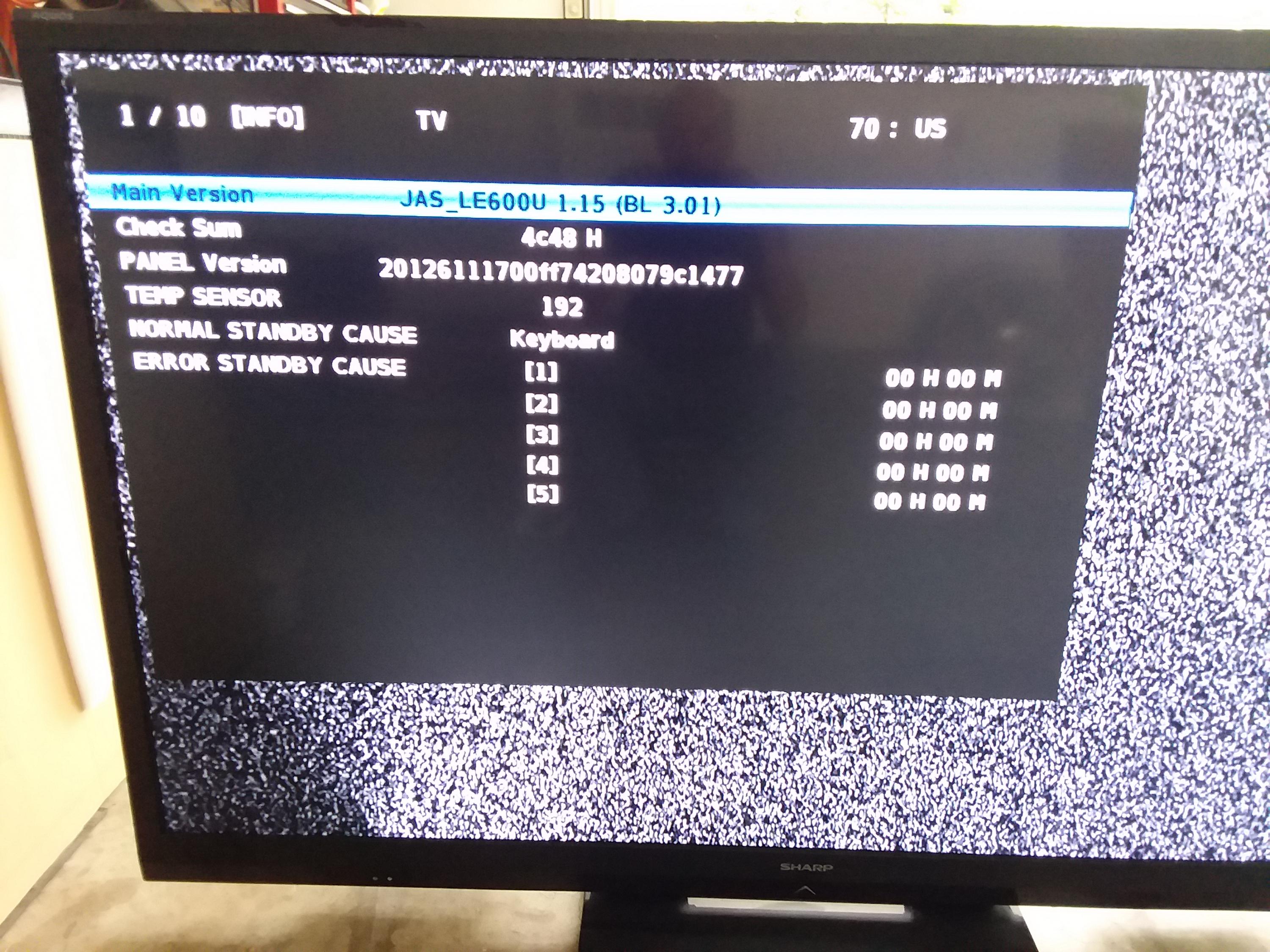

                    So I just got into the service menu on the tv and I'm including a couple pics, one showing page 1 and one of page 9.
                    Can you guys take a look at the values on page 9 and tell me if they give any hints as to what may be wrong?

                    I see a "STANDBY CAUSE RESET" but that's the closest thing and it just says "OFF"
                    Oh wait... I just saw the NORMAL/ERROR STANDBY CAUSE lines on page 1. Those values seem logical to me as if there were nothing wrong?
                    Check lamp error count, thinking it will be at max, reset to 0, make note of any faults and clear them, be VERY CAREFUL in that service menu.
                    L ERR RESET says 6... is that the lamp error count? Should I change that to 0? I also don't know what faults I'd be seeing to make note of and then clear.
                    Should I set the EEP CLEAR to ON?
                    Also... I included a pic of page one because it shows TEMP SENSOR 192, and on page 9 it shows TEMP CAUTION 139 and TEMP SHUTDOWN 135. Are these related? And can this be part of the issue?
                    Sorry for my ignorance, I just don't want to jump to conclusions OR do anything inside this menu without knowing that I'm doing the right thing!!!

                      If you highlight L ERR RESET and press enter, you should be able to set it to 0 by using the < > arrow keys
                      This is likely why the tv won't turn on, 6 is the maximum for the error count.
                      I think the temp data is wrong, why have shutdown at 135 but caution at 139? I would change them to something like 200, that 192 could be wrong data causing the tv to shut down also. Those will likely be in the range of 0~255 and not temperature.

                        I'll try setting the L ERR RESET to 0 first and test it. If it doesn't work, then I'll change those temp values. I will give these things a try and get back to ya!

                          So setting the lamp error count back down to zero worked. I lugged the thing out of the garage, around to the back of the house down the hill and into the family room in the basement. Hooked it up to my system... very not impressed with tv's sound hookup options, mainly the lack of optical audio cable signal even though it HAS A PORT! But I digress. Anyway, within an hour or so, the faded triangle in the lower left corner doubled in size and the tv shut off. The good news is that it did start blinking a code. But since I was done for the day and trying to watch tv, I just unhooked it and set it aside and hooked up my original tv again.
                          The fact that more of the lights went out right before it turned off pretty much tells me that those burned lights are more than likely the problem (even though that faded triangle has been on the screen for one to two YEARS).
                          How expensive are these strips, and how difficult are they to change them? I'm not sure I want to even bother at this point though, given the lack of compatibility with my sound system.
                          I wonder what I could get for it if I put on craigslist or facebook marketplace (after fixing, of course!).
