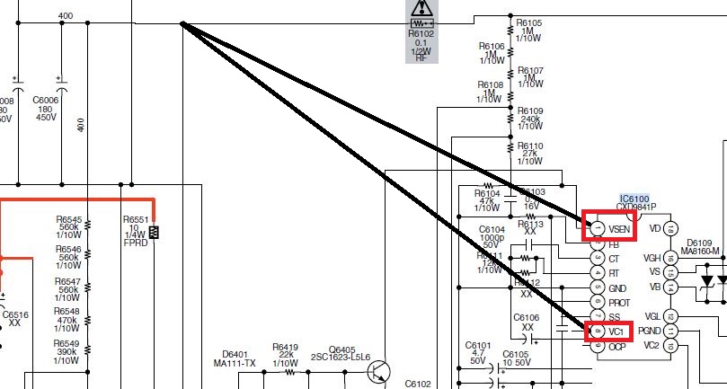

              Hi Standby pin HAS steady 3.3v with PSU to Mainboard cable connected or disconnected. (CN6200)
              Originally posted by budm
              In your post #8 ...
              So the question is, is the 3.3VSTBY always stay at 3.3V or it drops to 0V with or without having main board connected?
              So keep meter probes on chassis and 3.3V STBY pin and tell us if it is going up and down or not.
              I can confirm the standby voltage stays steady at 3.3v.
              That is what I am trying to find out if the 3.3V STBY is dropping in and out or what, OP said he gets 0V on 3.3V STBY then the main board will not have any power to run it to produce error code if 3.3VSTBY is not present. Trying to get the answer from OP.
              "I can't get a reading from the IC as it cuts to the error mode too quick."
              0V on all the pins?
              VSEN cannot be 0V since it is connected to the main filter cap via resistors that has 330VDC in standby.
              VC1 will be 0V if PS-ON is not present, VC1 is generated by the 3.3V STBY AUX winding of the 3.3VSTBY SMPS transformer.
              Did you us chassis GND of HOT SIDE circuit ground which will be the negative leg of the main filter cap in the hot side.
              Measured:
              VSEN pin 1 = confirmed 330vdc
              VC1 pin 8 = 330vdc
              Both measurements taken from hot side after negative leg of the main filter cap for ease of access.
              Thanks for your help on and hope these results I have gathered now make more sense.

                VC1 cannot be 330VDC, the filter cap C6105 connected to pin 8 VC1 is only 50V cap. https://www.badcaps.net/forum/attach...5&d=1565389163
                But right now at least we know that 3.3V power supply is steady.

                  He's using chassis ground not HOT ground to measure the voltage.

                      According to poster, he used the "negative leg of the main filter cap for ease of access". I have doubt now about the data we are getting.

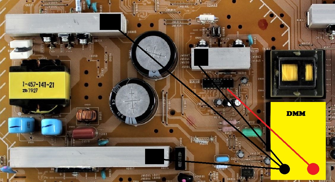

                          Ok Budm I shall try putting the NEG lead of DMM on the Heatsink of the HOT side and remeasure VC1 pin to clarify this, I took your advice to measure from the area you referred to in previous post as I didnt have access from the top of the board I used the point in my pic to show this. I must have misread this and was taking measurement from the Chassis GND and not the HOT side like R_J quotes above my bad I will try sort this out tonight and update my results. Thanks for your help.
                          I have attached a small illustration to clarify I a going to be taking my measurements from the correct area of the board.
