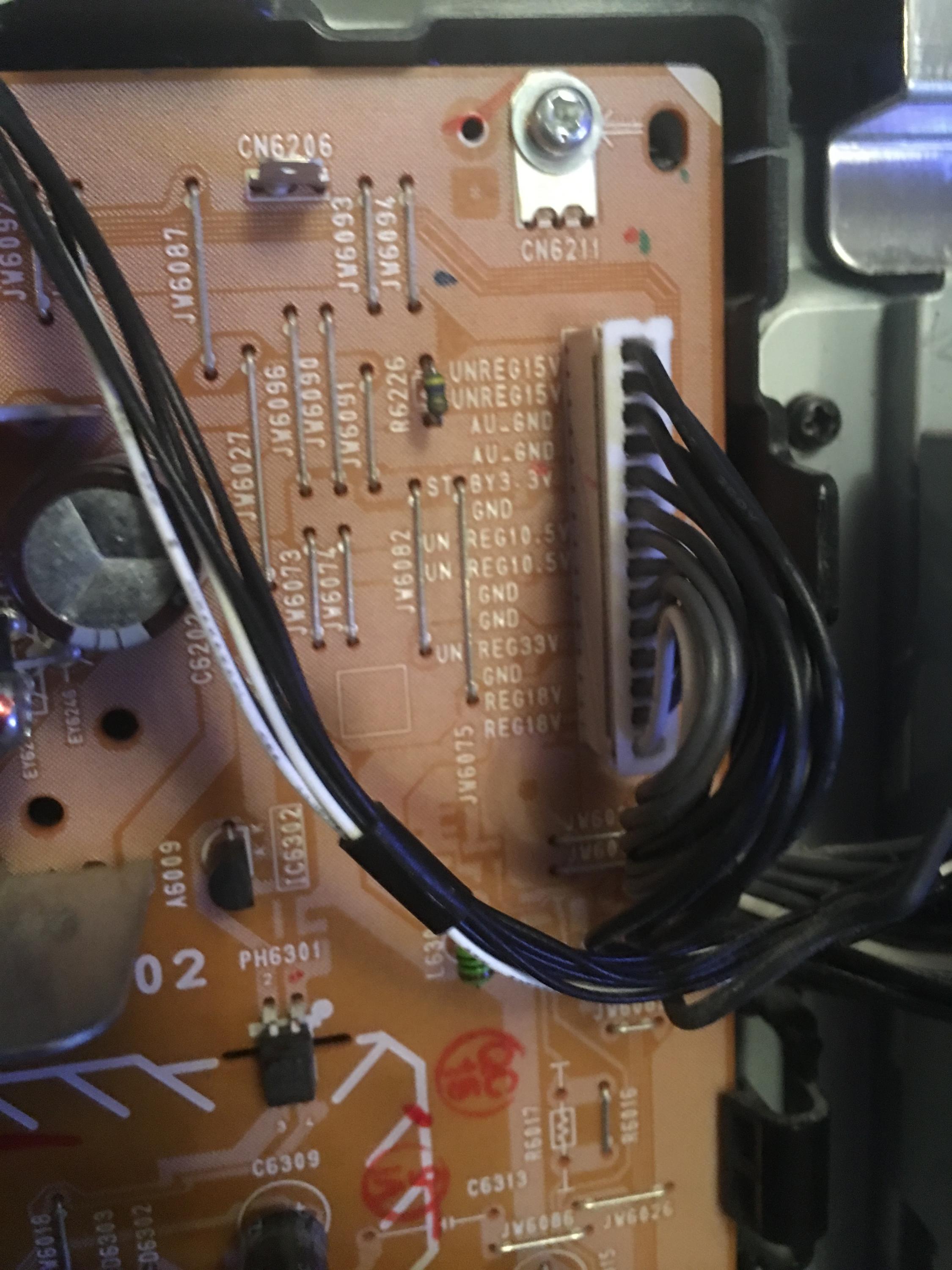

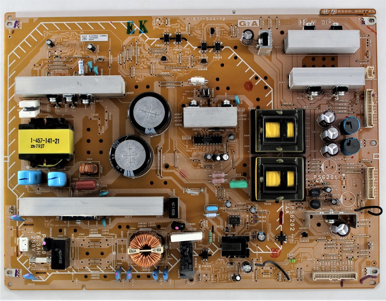

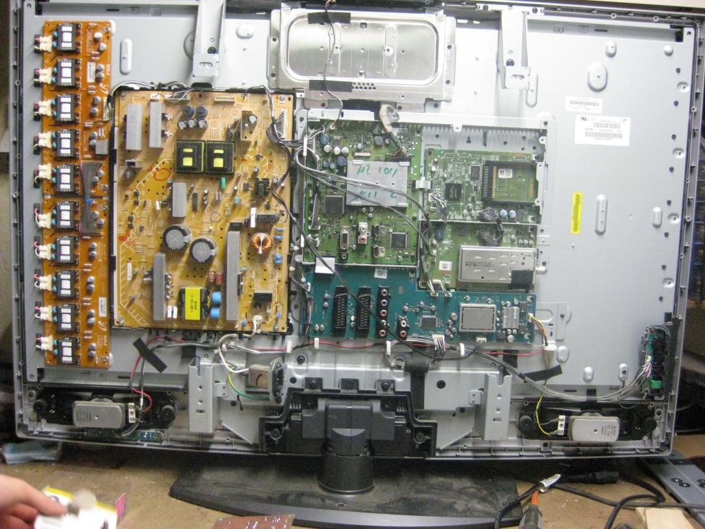

    Hi all looking for some help on repairing this old TV for a friend in work. Its a Sony KDL-40W2000 (Old LCD TV).
    Any Help Guidance would be much appreciated.
    TV has the LED error code 3 -
    UNREG10.5V, PANEL5V Voltage Trouble (DCALERT1).
    When power is applied and the power switch on tv is pressed you can hear the relay switching the LED goes from RED to Green for a brief couple of seconds then it goes into the flashing Red LED state. (3 blinks pause 3 blinks pause and so on.) On doing some reading up I've found:
    "" Three blinks - B+ over voltage protection (OVP), unit goes to the standby mode then displays the 3 blink fault.
    This is also a problem in the power supply circuit, check T603 and R672. (I cannot find these parts on the schematics at all most parts have the letter of the component and then 4 numbers.) ""

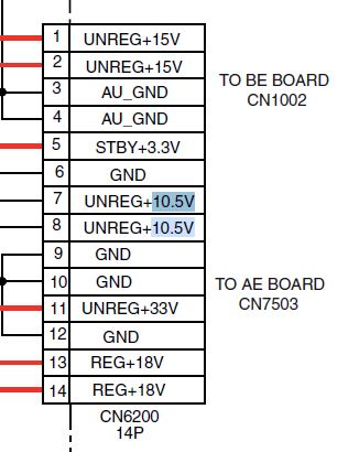

    I have attached a pic of connector CN6200 as I took some measurements from it but no voltages were present with the connector seated or unseated.
    Some pics are attached and I hope to get back to this tonight to get more pics and measurements

    Not even standby voltage, powerboard issue, you need at least the standby voltage to get started, check the fuse on powerboard if you didn't already.

      Try with tv unplugged from power, unplug everything from powerboard, plug power cord into outlet, so only thing you are powering up is the powerboard, see if you have the standby voltage.

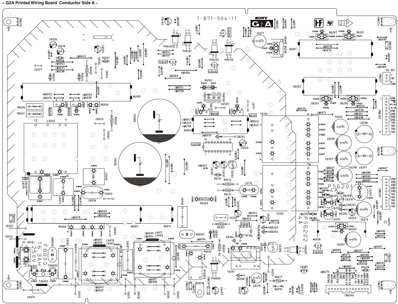

          Are you sure you have the right schematics?

              Yes i'm pretty sure they are the correct schematics, they came from here >>

                Gettting ~240v on both sides of the fuse - What i don't get is I get nothing on the standby 3v3 pin and i have a Red standby LED then goes to green when powered then, when failure occurs and 3 blinks code appears. I monitored pin 5 STBY+3.3V (CN6200) when on standby, green light and when 3 blink error is repeating, still nothing. DMM set too Auto range on VDC = 0.00v
                Will redo everything tonight again - if I can eliminate one board from another I will let him know what the price is with a board swap, just trying to keep the price down and get the TV back to him

                  I see, something is amiss, can you try your meter on something else, to verify it's working correctly?

                    Its seeing the 240v input at both sides of the fuse when metered and on AC then switch to DC to take readings from connector but no voltage coming from pins.

                        did you inspect the back side of the PSU of crack soldering point?
                        could you listed the voltage you have on all legs of IC6100. be sure the black probe on HOT area chassis

                                Error code 3-blink:
                                3 ) UNREG10.5V, PANEL5V Voltage Trouble (DCALERT
                                So perform test as RJ suggested.

                                      look on the photo OP posted PSU 18 legs IC
