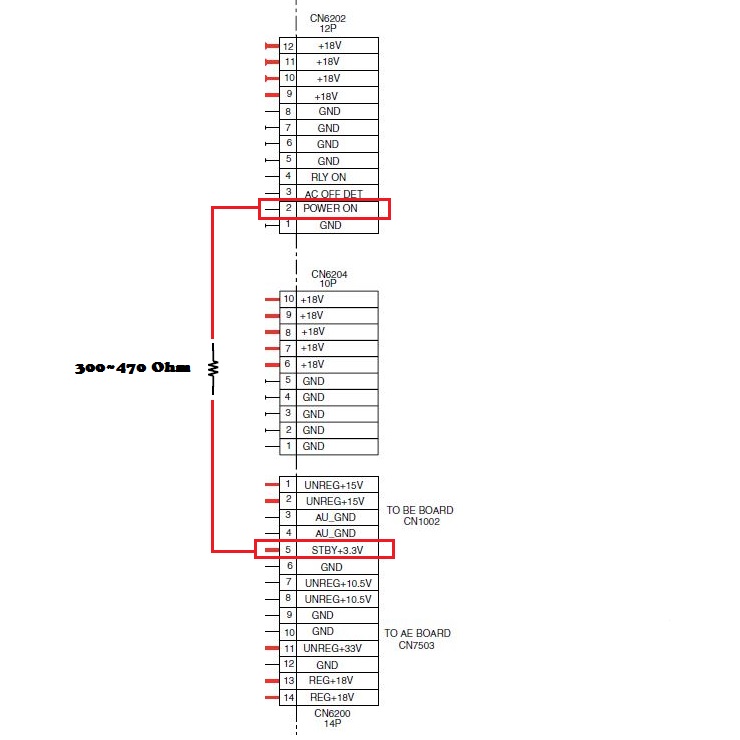

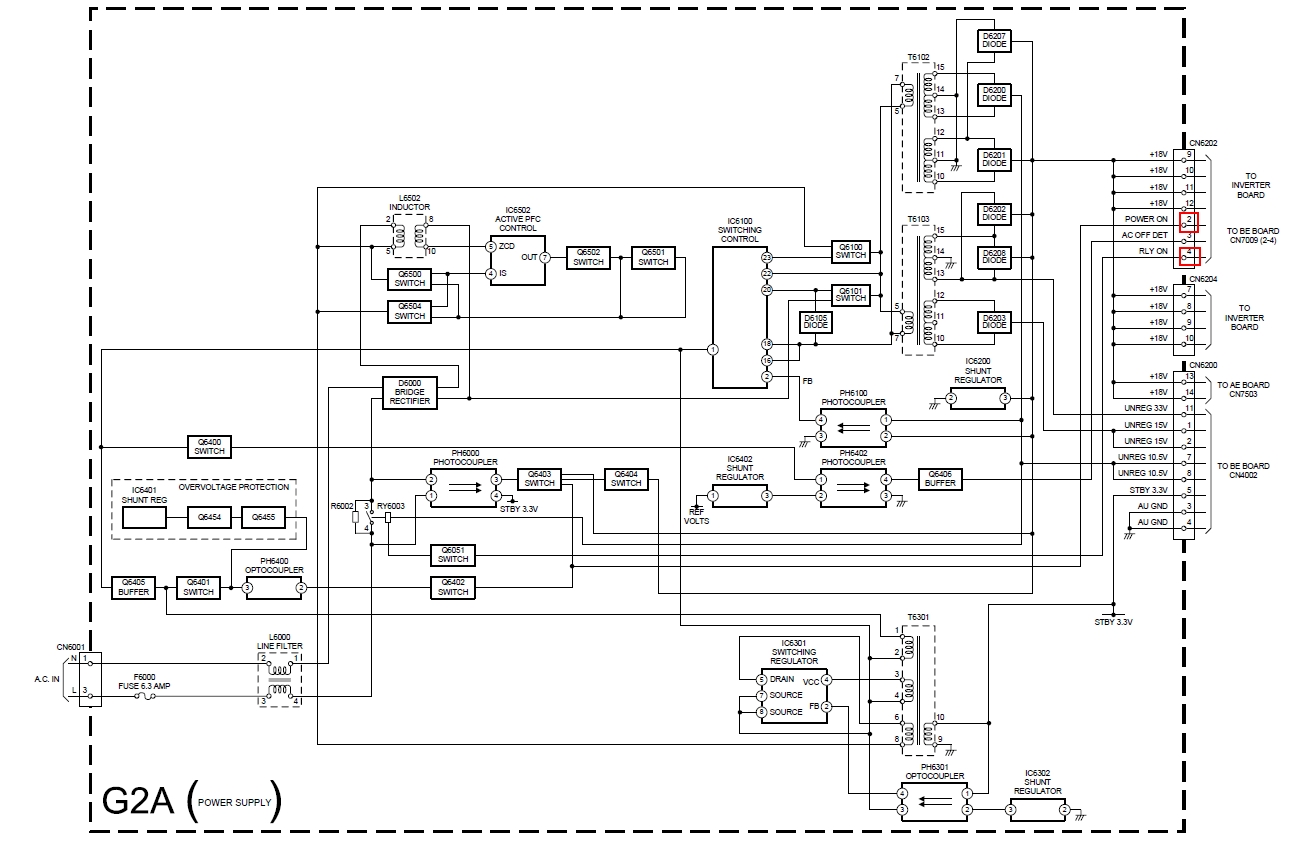

          So what happen if you run the power supply board by itself and do the force on using 300 ~ 470 Ohms resistors between 3.3V and the POWER ON, and RLY_ON?
          Do you get all the Voltage outputs as shown in the diagram?

            Hi Budm, I have ordered a replacement Mainboard. Although I can try out these measurements over the weekend, can I take the measurements direct from the CN6200 pins 1, 2, 7, 8, 11, 13, 14 or locate the points you have highlighted on the Schematics? I've attached a pic to illustrate my connections between CN6202 pin 2 and CN6200 pin 5.

              You need another resistor for the RLY_ON (Relay On), pin 5 (CN6200) to pin 4 (CN6202) with another 470 Ohm resistor.
              Yes, you will be taking the Voltage measurement of the power supply connector since there will be no connection to the main board, we are doing the test to find out if the power supply board is OK or not.

                      I did the the voltage check by doing the Resistors trick
                      I used 470 ohm resistors from standby 3.3 to POWER_ON and RLY_ON
                      I put the 2 resistors on the single standby connector
                      than I measured n CN6202 18v to ground and that works.
                      Can someone tell me how to proceed ?

                        So you have all the supply voltages. 3.3V, 10.5V, 15V and 18V
