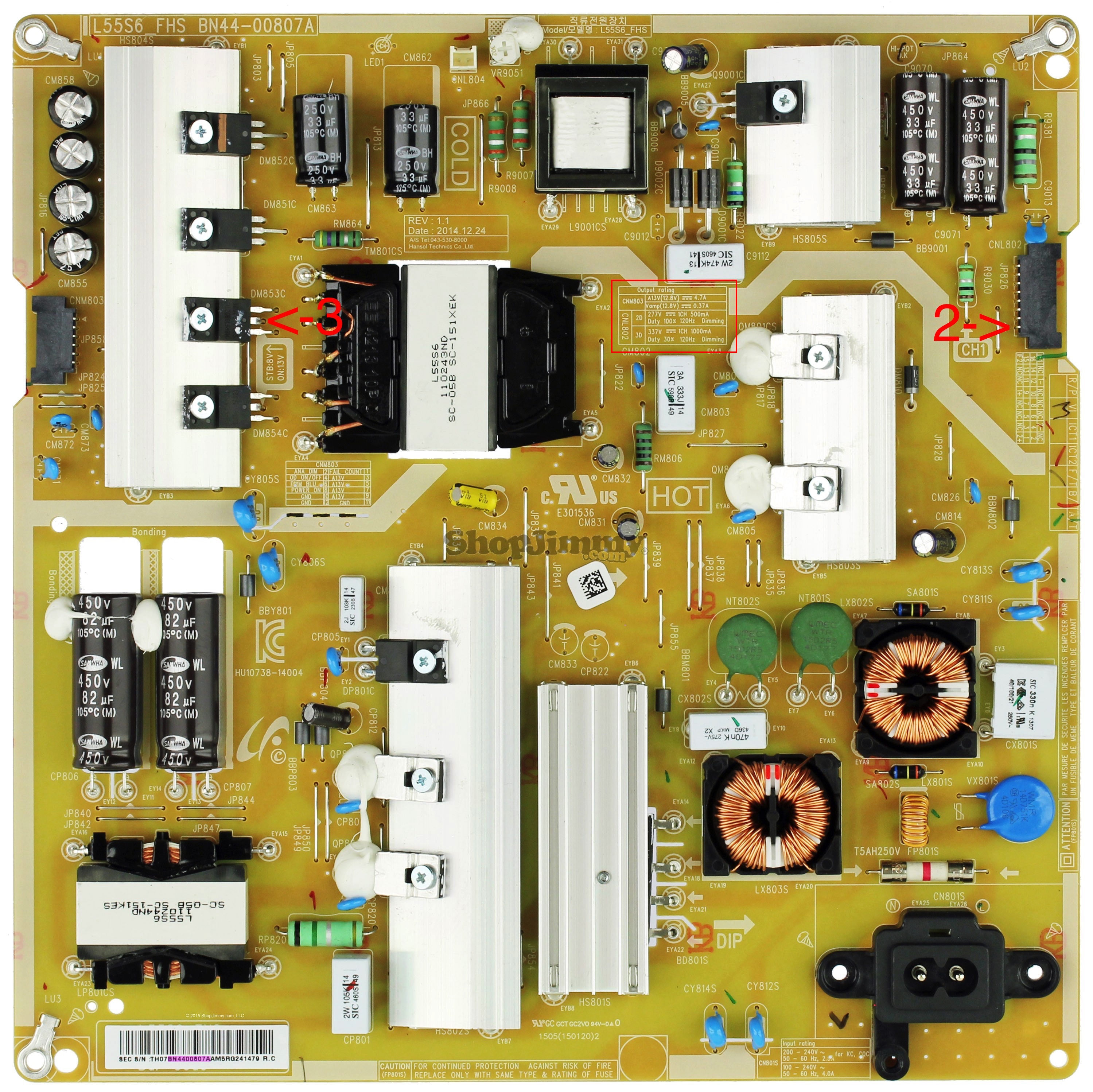

    I have the following tests / results. All measurements are DC volts. I added a #2 and a #3 on top of the board pic to show where I made the measurements (with respect to the chassis ground.)
    1. Disconnect power supply board and Turn on TV: No backlight
    2. Measure CNL802 (backlight connector) pin 1 indicator: 180V with processor board connected, 88 to 95V with processor board disconnected. If I unplug the backlight connector its about the same - 88 to 100V. If I understand the silkscreen note it seems like this should be either 277 (2D) or 337(3D).
    3. Test point at DM853C and DM854C Cathode: 12.8 with periodic drop to ~3V, probably once a second. Also seems to be accompanied by very faint 'pop' or 'tick.' Silkscreen on board says Standby 8V / On 13V. It's definitely not either of those steady state. If I disconnect the processor board, it varies from 9V to 13V.
    Anyone have any thoughts they are willing to share? Or additional recommended tests to clarify the problem?
    Again, I'm trying to decide if this is enough information to determine that the power supply board is faulty and that replacing it will fix the problem. I can also post pictures of the system layout and harnesses.

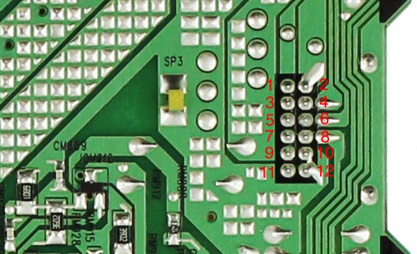

      Test connector from mainboard to powerboard on powerboard side with all boards hooked up, test with tv plugged in but off then hit power, report both conditions here, give pin number, pin description/name and condition both off and when you hit power on. So we can see all the voltages and what they are doing. Try to do test just as instructed, example in second link below if needed.

        Thanks for the help so far. Here are updated test results.
        Configuration: Entire system assembled, plugged in.
        'Reading on' is after pressing 'on' button. I noticed no difference. My wife watched the indicator LED on the IR receiver and it blipped the same way as before each time.
        Most of these oscillated - both before and after pressing the power button. I estimate they cycled every 2 seconds. Did not time with a stopwatch or scope.
        Pin / Signal / Reading Off / Reading On / Note/Comment
        1 / FAIL COUNT / 0.3-0.4 / 0.3-0.4
        2 / ANA DIM / 0-1.6 / 0-1.6 / period approx 2s
        3 / A13V / 12.8 - 3 / 12.8 - 3 / Stable at 12.8, then dropping to 3. period approx 2s
        4 / OD ON/OFF / 3.6 - 0 / 3.6 - 0 / period approx 2s
        5 / A13V / 12.8 - 3 / 12.8 - 3 / Stable at 12.8, then dropping to 3. period approx 2s
        6 / PWM BLU / 0-1.12 / 0-1.12 / period approx 2s
        7 / A13V / 12.8 - 3 / 12.8 - 3 / Stable at 12.8, then dropping to 3. period approx 2s
        8 / POWER ON / 0-3.4 / 0-3.4 / period approx 2s
        9 / A13V / 12.8 - 3 / 12.8 - 3 / Stable at 12.8, then dropping to 3. period approx 2s
        10 / GND / not measured / not measured
        11 / GND / not measured / not measured
        12 / GND
        All measurements made with respect to pin 12 (GND) as shown in top of board silk screen. I measured these on the back side of the board using the pinout that I have marked up and attached.
        I should have put this in the initial post but forgot: This TV was working fine and just turned off while my daughter was watching it. I don't really think it changes the diagnostic process, just thought it was worth mentioning.
        Which is unfortunate because when I was a kid I always told my parents I hadn't done anything when something broke. In almost every case, I had but didn't want to admit it. Seriously though, I have no reason to suspect she did anything. She turns into a zombie when it's on anyway and won't get off the couch for anything.
        Also no visual signs of damage on the boards when inspected.

              Check the voltage on one of the main filter caps, (CP807) In standby it should read around +160v, when the power button is pressed it should read over +350v. The way the 13v is droping suggests to me the PFC circuit is not working.

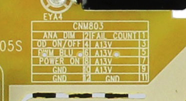

                CNM803 connector from power board to processor (main) board. This was done with the CNM803 connector disconnected (so the main board is not connected to the power board). All measurements here WRT pin 12 GND. Also, I pushed the power button each measurement even though both the IR receiver and the P function board plug into the main board (which was disconnected for this test). So I didn't see any change.
                1 / FAIL COUNT / 0 / same /
                2 / ANA DIM / 2.36 / same / steady
                3 / A13V / 8.9V to 14 / same / about 1s period
                4 / OD ON/OFF / 2.5 to 4 / same / about 1s period
                5 / A13V / 8.9V to 14 / same / about 1s period
                6 / PWM BLU / 2 to 3.5 / same / about 1s period
                7 / A13V / 8.9V to 14 / same / about 1s period
                8 / POWER ON / 2.8 to 5 / same / about 1s period
                9 / A13V / 8.9V to 14 / same / about 1s period
                12 / GND
                Recorded a video to illustrate the oscillation period seen on A13V: https://www.youtube.com/watch?v=f4G6KOTJ1z0

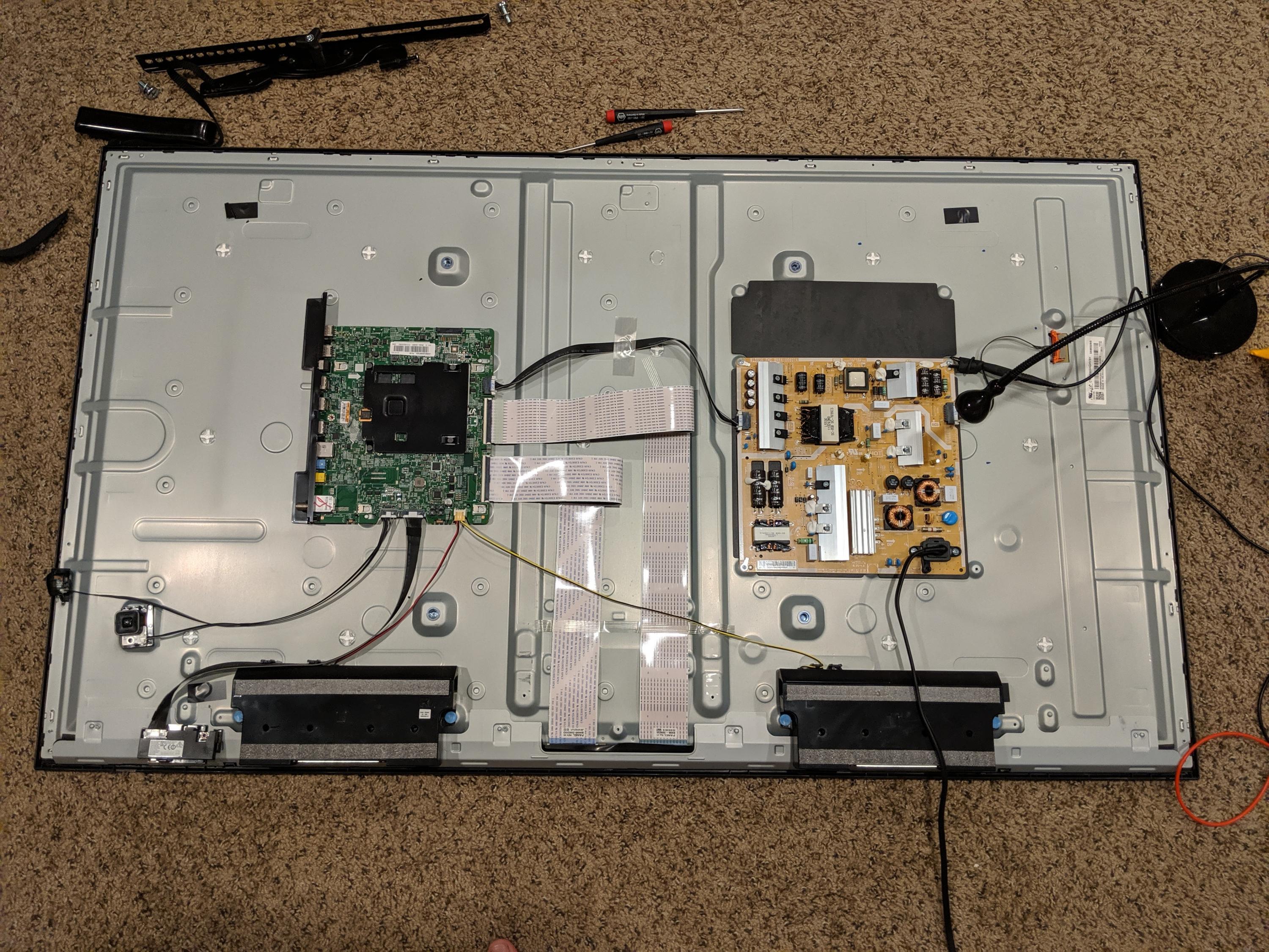

                Also finally attached a picture of the entire system. Sorry, probably would have been good to have that from the start.
                Hope this helps to provide info to assist with diagnosis.

                  Just a note: if the main board is disconnected from the power supply, pushing the power button will have NO effect as the main is disconnected.
                  Knowing this, The power supply board has pullup resistors to turn the power supply ON with the main disconnected, that is why you have +390vdc on the main caps. This means the PFC circuit is working. Have you tried disconnecting the plug going to the backlights to see if the A13V becomes steady?
                  Another thing you could try is short the POWER_ON pin to ground, this will turn OFF the power supply so the A13V should be steady (and the main cap voltage will drop to 160v)

                    BN44-00807A
                    https://assets.shopjimmy.com/media/c...00807a-top.jpg
                    When this power supply is in standby mode (PS-ON not present), the A13 will be about 8V, when PS-ON is present then it goes up to 13V.
                    You may want to inspect all the solder joints, especially around the transformer legs.

                              I created a thread on repairing this power supply not so long ago. I think you may have the same problem.
                              Unsteady output voltages is usually caused by one of the smd diodes failing
                              • Hamie
                                • Apr 2014
                                • 1383
                                Re: Samsung UN55KU6300FXZA
                                https://www.badcaps.net/forum/showthread.php?t=90116
                                Please test that diode in the above thread.

                                  I ended up guessing and buying a replacement power supply board online and that did the trick. TV has been working fine for the last year or so. I didn't really dig into the design of the board but I could see even on a DMM that the voltages weren't stable so that seemed like a good guess.
                                  Appreciate everyone's help on this. I totally would have tested/changed out the diode at the time if I had this info. Thanks all!
