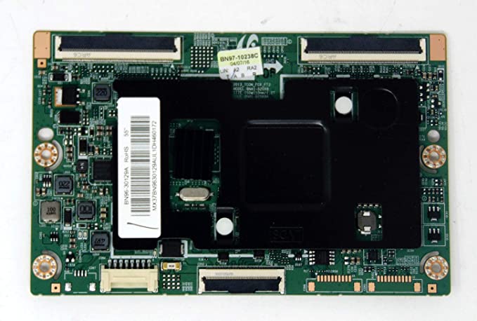

            Re: Samsung UN55KU6300FXZA
            My main board is BN94-10651G. Power board is good. I'm having trouble finding this exact one. Do other models work? I don't care if I lose a port or something.

                          #32
                          Originally posted by distearth
                          Thanks. I ordered one!
                          There will be no image or it will be very distorted, since you ordered a board for a 40 inch model, and you have 55.
                          T-CON is built into the motherboard and the firmware in it is for a specific matrix.

                            • lotas
                              • Jan 2016
                              • 4803
                              • Russia
                              #34
                              I did it with an un55h6350, had to modify one connector, lengthen a speaker wire and cut out a bit of the back cover, didn't have to change anything in service menu.
                              This can be done when T-CON is not built into the motherboard (when T-CON is installed at the bottom or soldered to the bar of the matrix itself).
                              This model has a separate un55h6350 T-CON (not built into the motherboard), here you can put any motherboard from this series (chassis).

                                #35
                                ok, thanks for the explanation Lotas, so it doesn't look like that board will work in this case, probably best to cancel the order from shop jimmy, I did see a board for about 50 bucks for the 55 inch.
