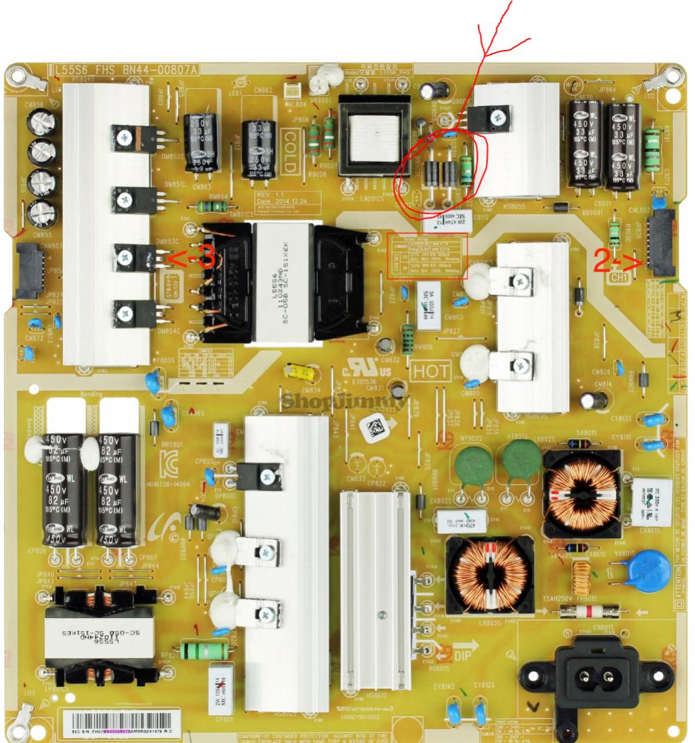

                        • u00ldl3
                          • Jan 2023
                          #52
                          Re: Samsung UN55KU6300FXZA
                          I had the exact same problem and one of these diodes were shorted (one of these 2 diodes marked with the red pen). The only way to test these are removing it from the board. The shorted one has to be replaced.
                          • nomoresonys
                            • Jan 2013
                            • 12306
                            • U.S.
                            #53
                            good policy is to replace both those diodes.
