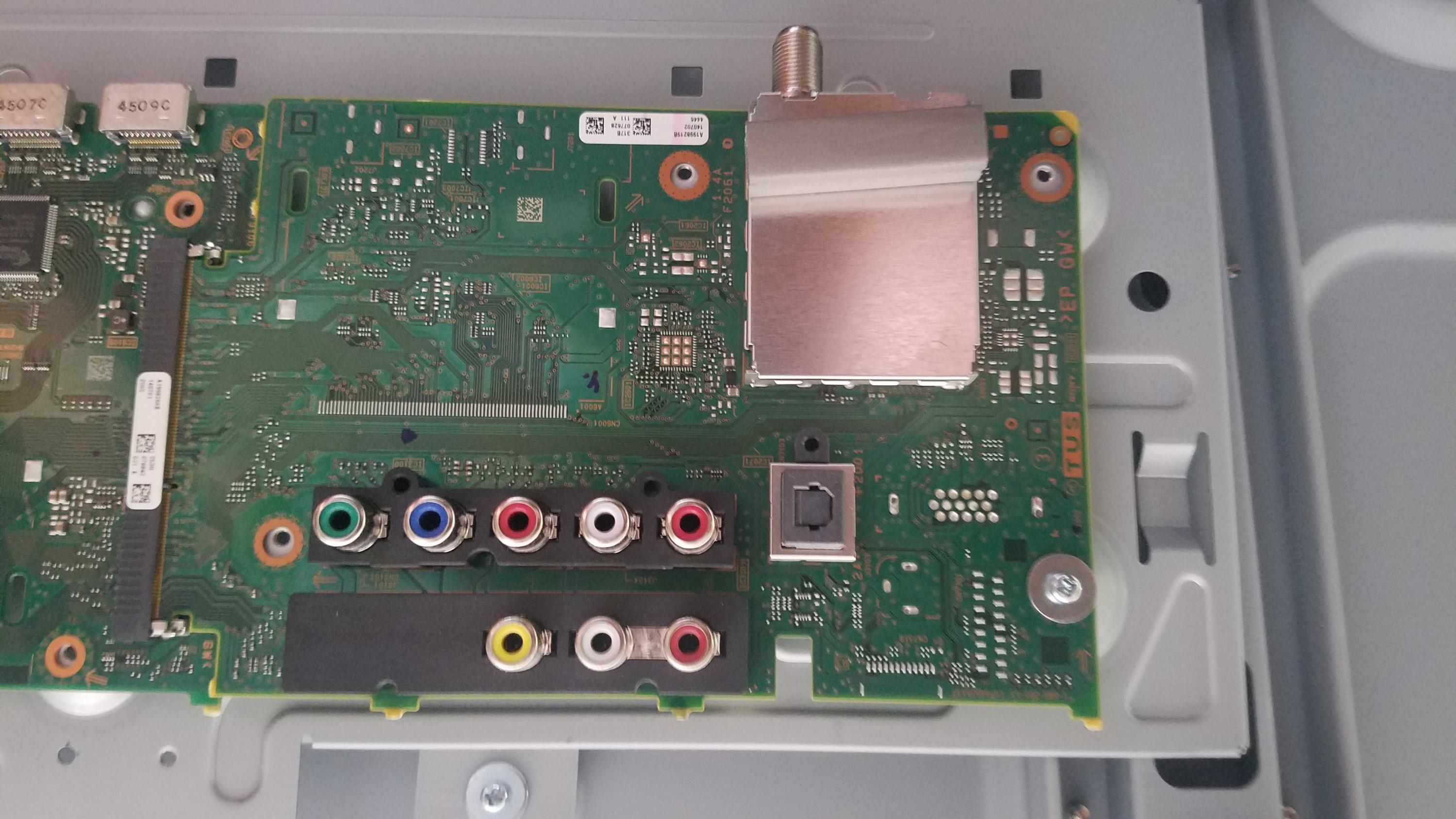

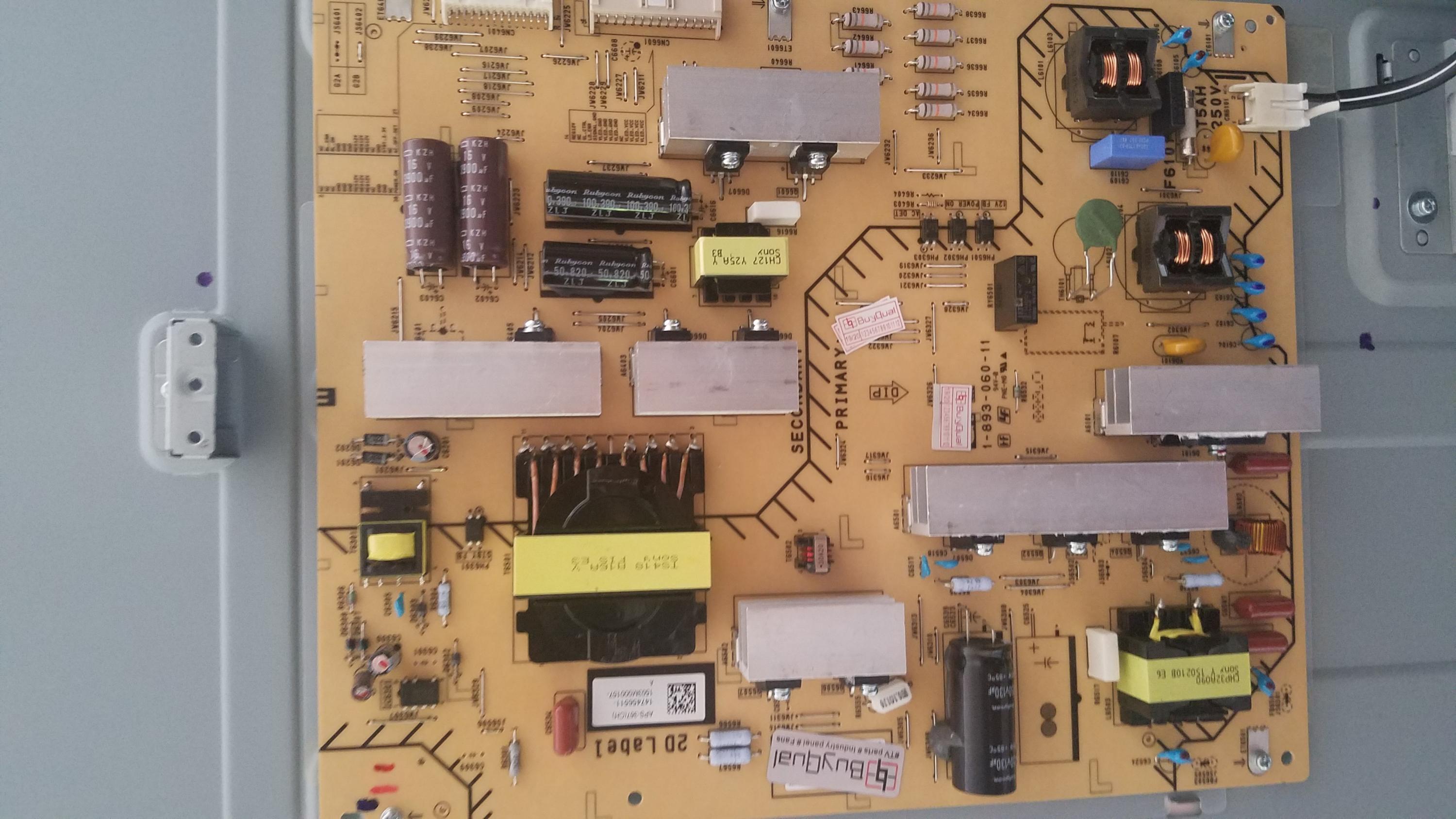

      Re: kdl70w830b main board 3 blinks
      Good pics. of the whole back and close up of each board?
      • Brucetafer
        • Jun 2018
        • 133

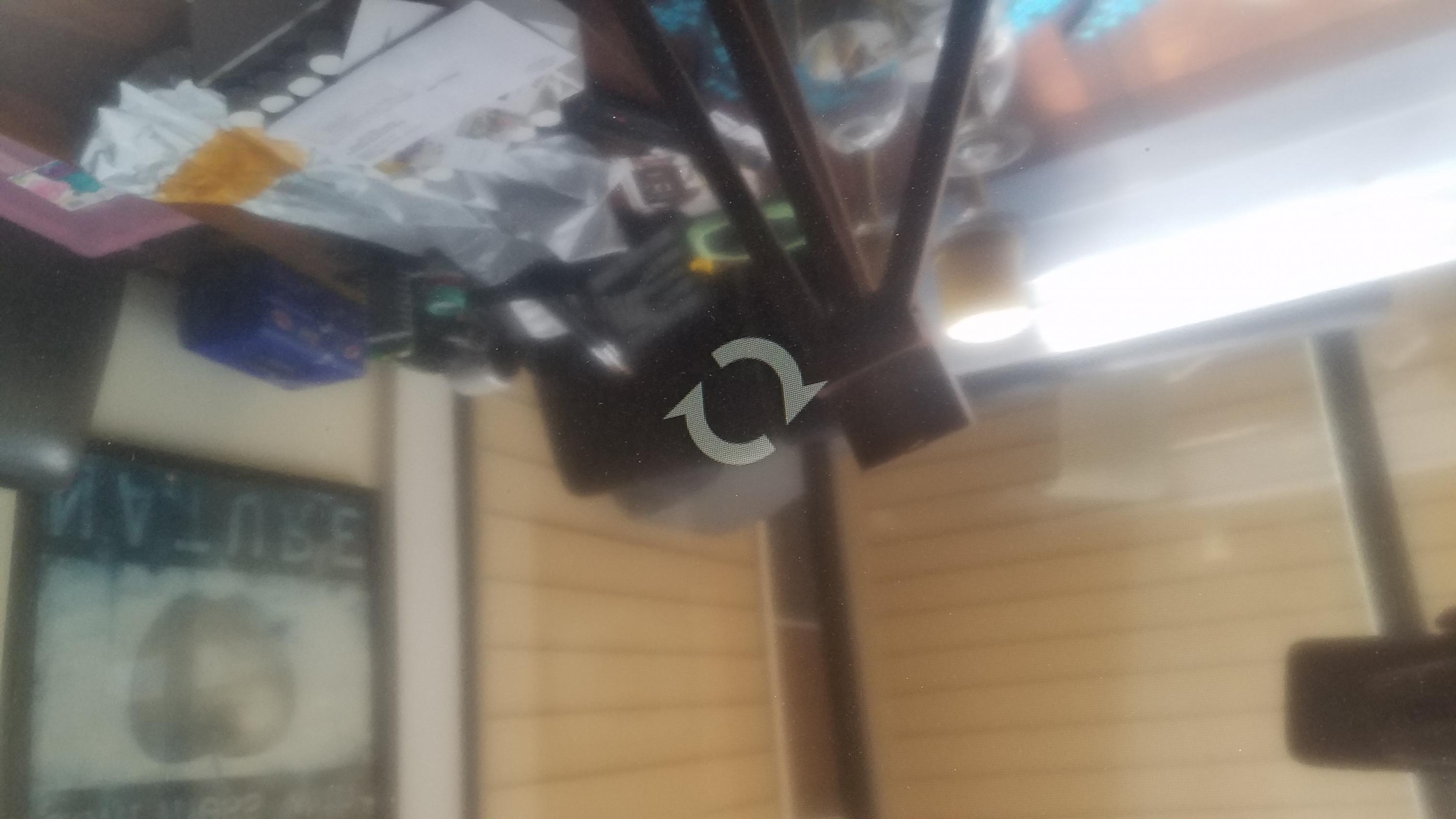

        As you can see the horribly reflected picture of the spinning arrows, they spin like its in a restore mode or something.. now when I plug the TV in it does that for 8-12 seconds then click, screen off, and 3 red blinks over and over.

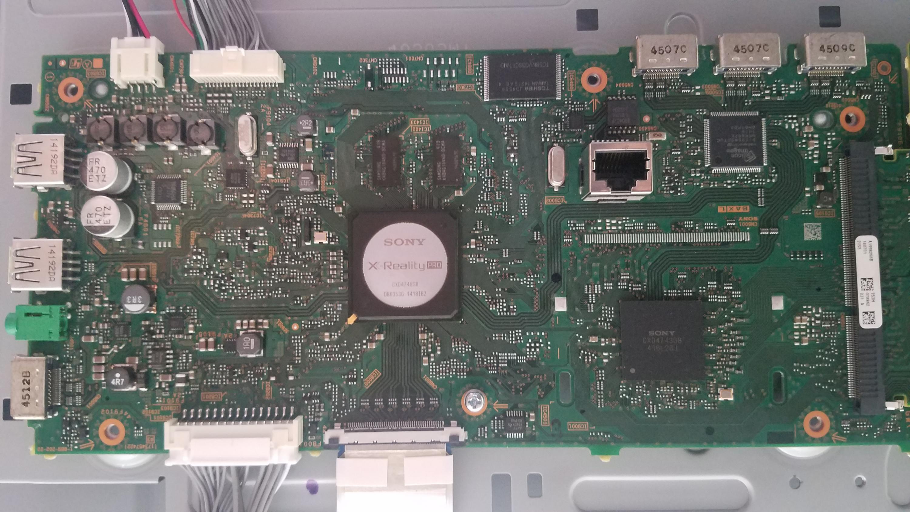

          A 3 blink code does point to main baord as primary suspect, The spinning arrows seems to indicate it's trying to update its firmware, Leave it connected to the internet (over night), or download the firmware to usb stick and try that, If that does'nt work, its likely a fault with the X-Reality chip, maybe poor bga connections?
          The grease on the main board is likely from the thermal pad attached to the rear bracket that covered the main board
                failed to load driver... its much like you have AV board issue... disconnect speaker socket from MB and the AV board from MB and then turn it on.
                • Brucetafer
                  • Jun 2018
                  • 133
                  100% correct, I bought a brand new power supply and another board from a 60-850 and uploaded the correct firmware and works, but now the problem is the middle of the screen is dark (see picture) and no idea what could have caused that..
