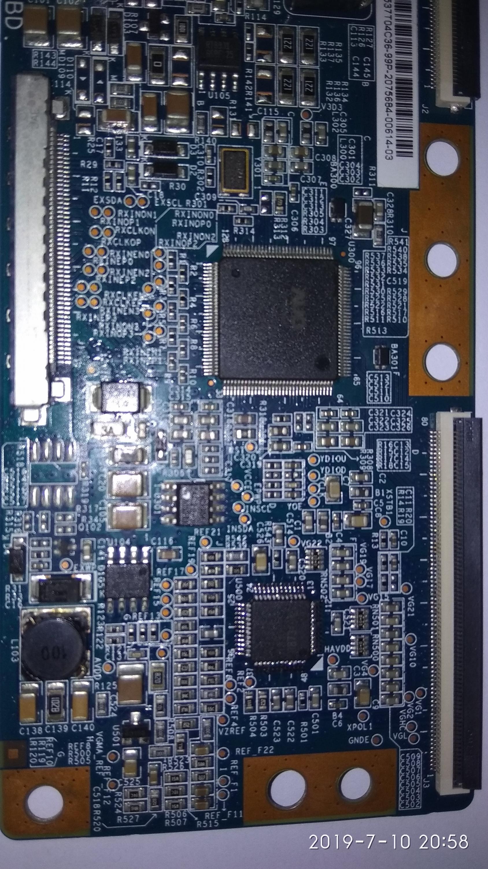

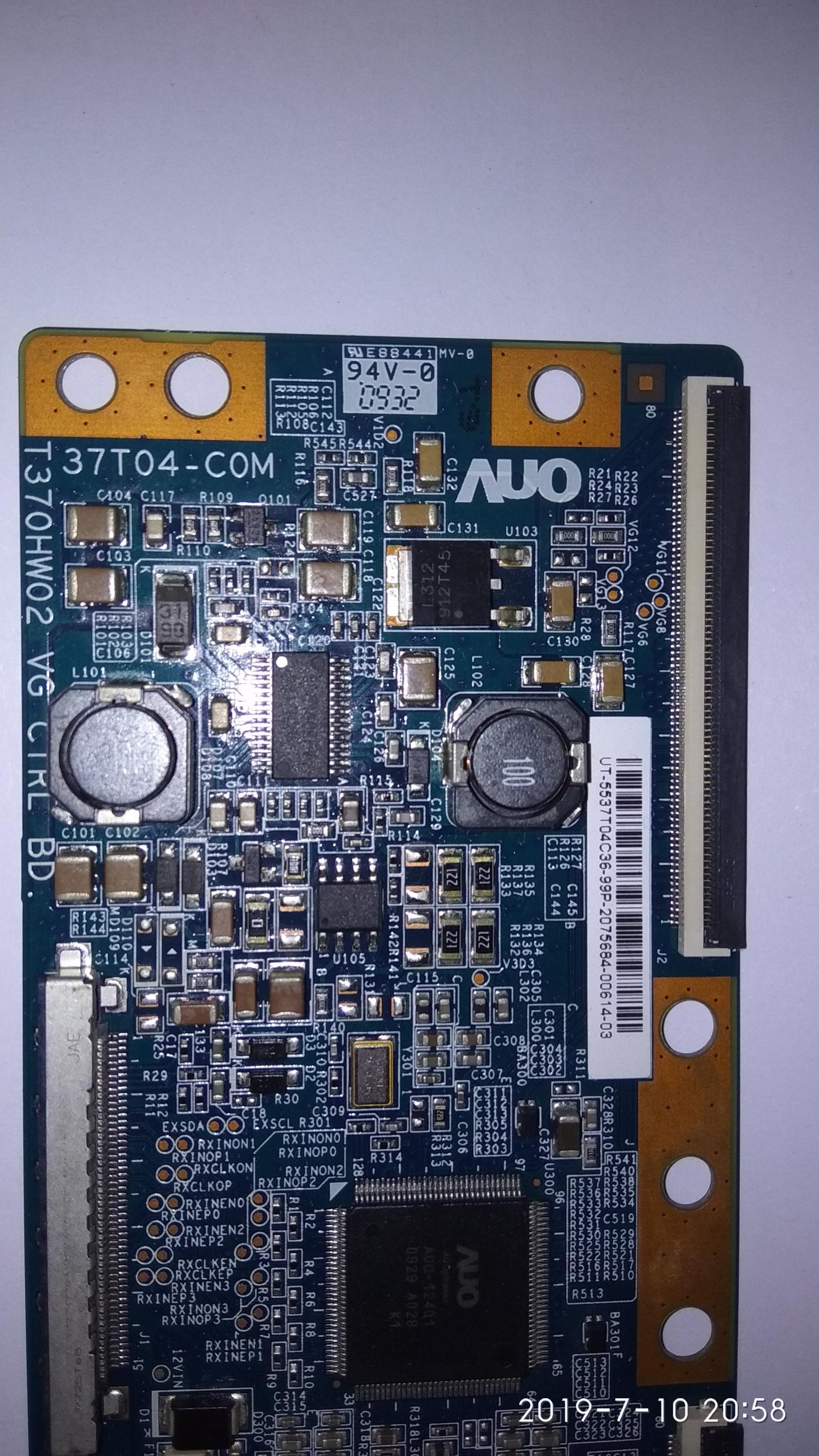

            Re: Lg 37lf2510
            pictures of board attached.
            regards,
            mark.
              Re: Lg 37lf2510
              "11-7.76
              12-6.78
              13-7.04"
              That is not right.
                Re: Lg 37lf2510
                Originally posted by gemadar View Post
                ok, board came back, flicked normal for a couple of seconds and then went straight back to a white screen with picture behind.
                Was the thermal pad and shield fitted ?
                Who is it that has done the repair ?
                  Re: Lg 37lf2510
                  Budm, yep didn't spot that, any ideas, is this still the chip?
                  Doug, tcon board was sent to have as15 chip replaced,
                  I removed from TV and refitted.
                  Mark.
