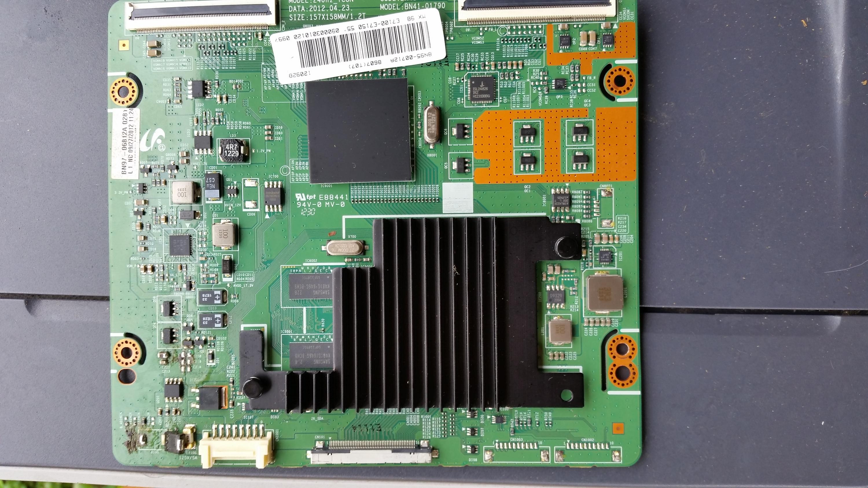

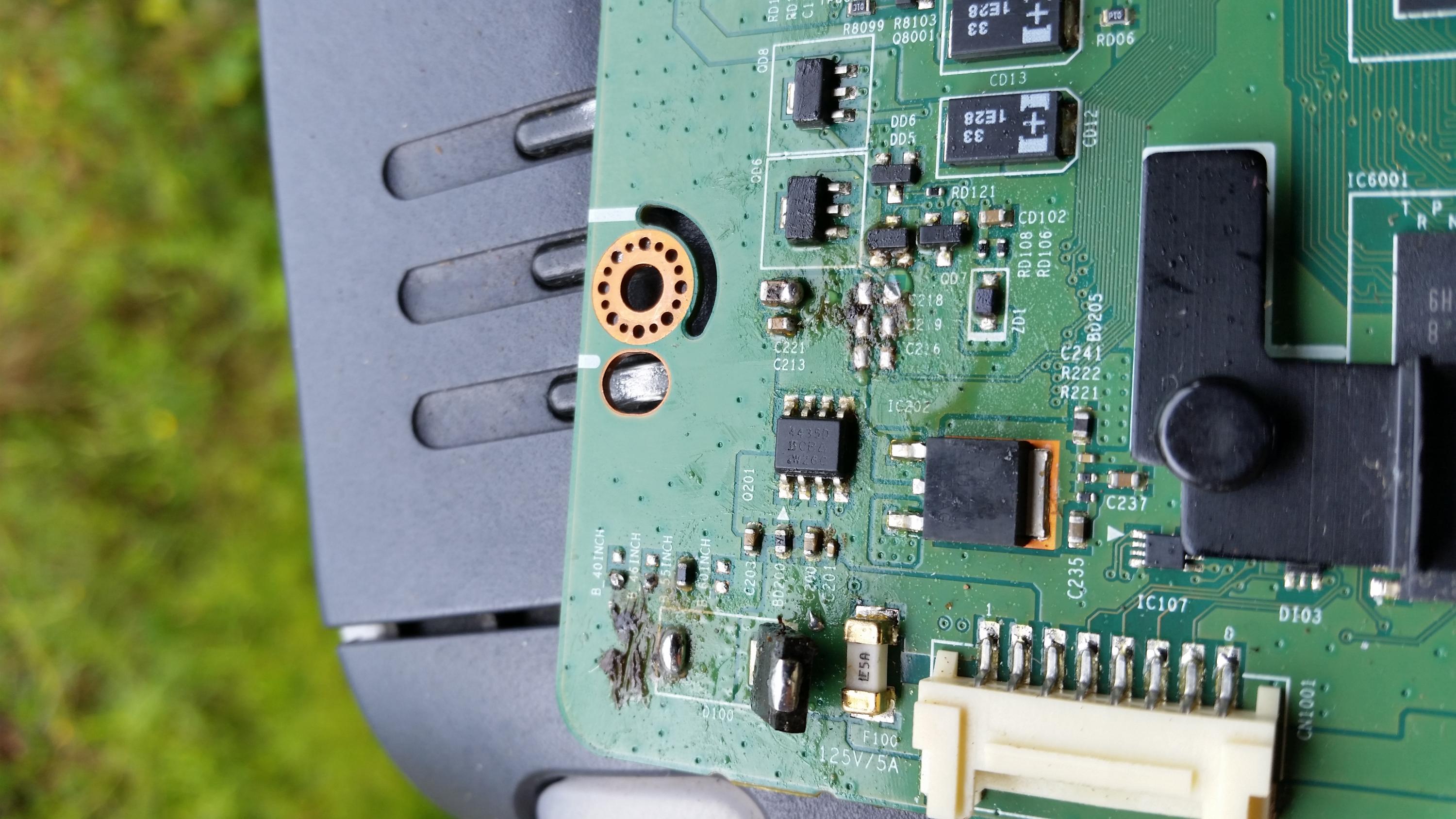

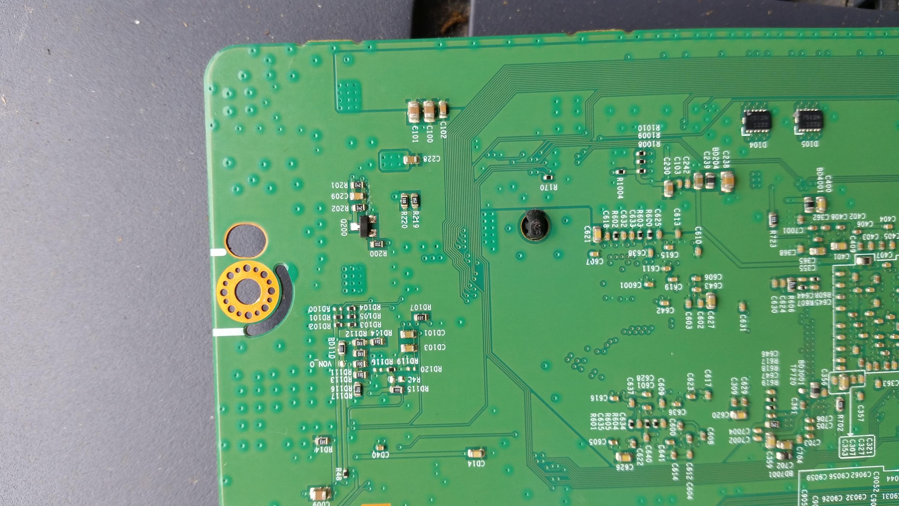

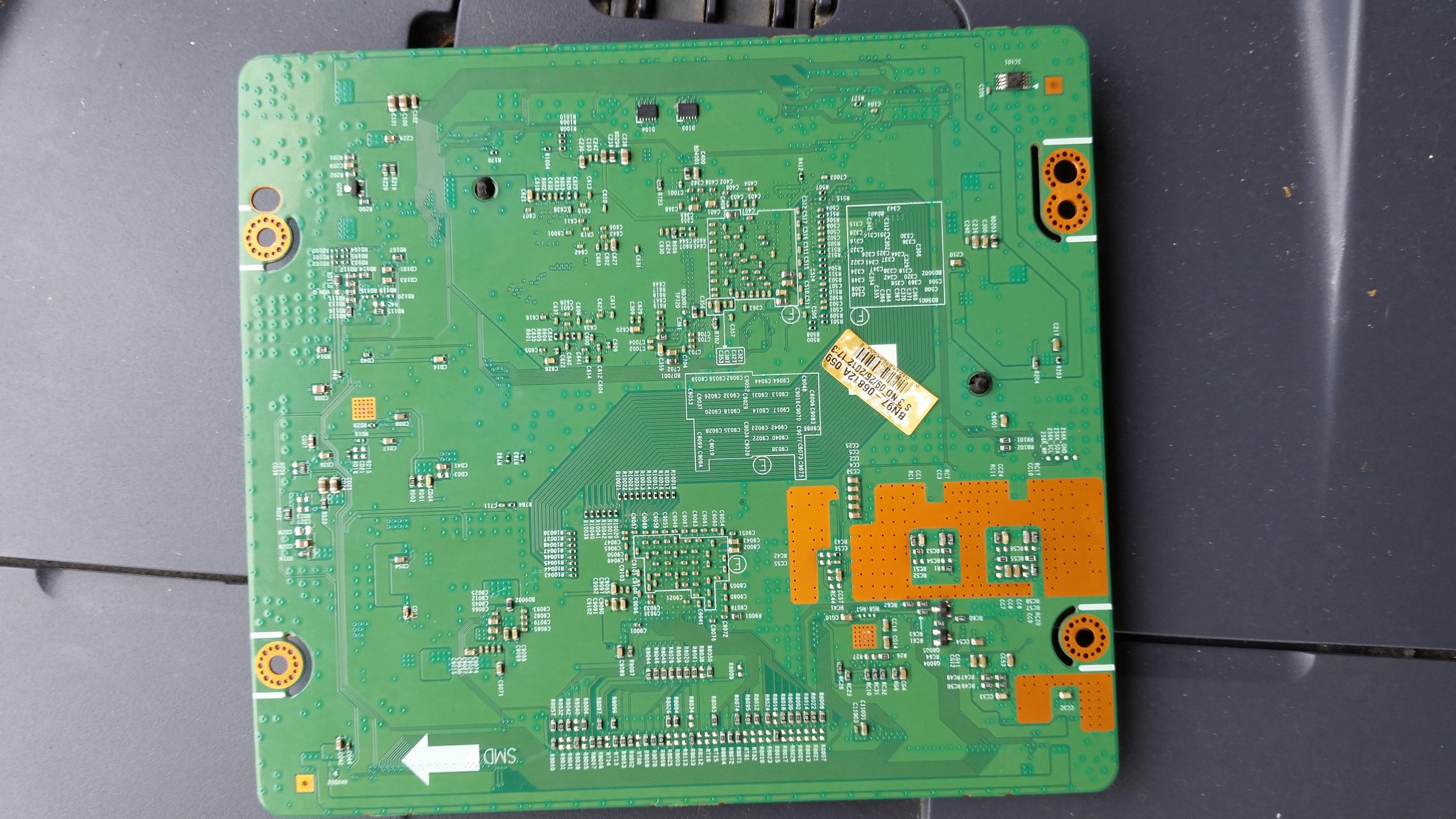

    inspected TCON more closely (should have done on first house call) and found that 12v is coming into the fuse,
    but not out the other side. fuse is blown!
    further inspection reveals there is a short to ground somewhere in that area of the board.
    the short to ground seems only in that area and affects 3 capacitors on the backside of the board as well.
    i removed 3 small surface mount ceramic capacitors on the front and lifted the leg of diode D100 but the short is still there.
    i am thinking of removing the IC that is in that area as it also shows shorted and could be the source of it.
    if that doesnt work i can continue shotgunning parts off the board, or actually learn how to do voltage injection.

        good logic, it usually is the ic next to the caps that are reading short that is bad.

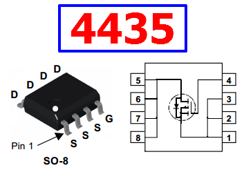

                  Look CD12 33uF 25V and QD1 FDC658AP

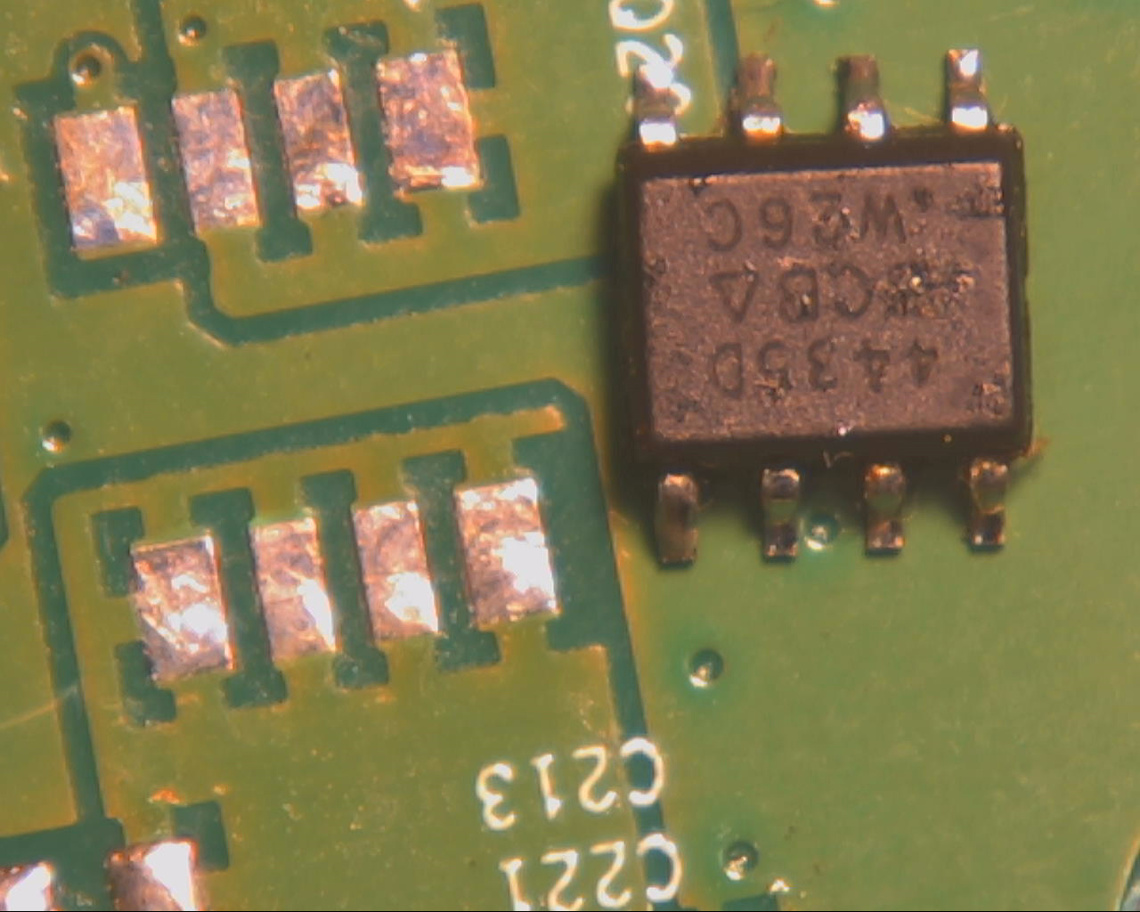

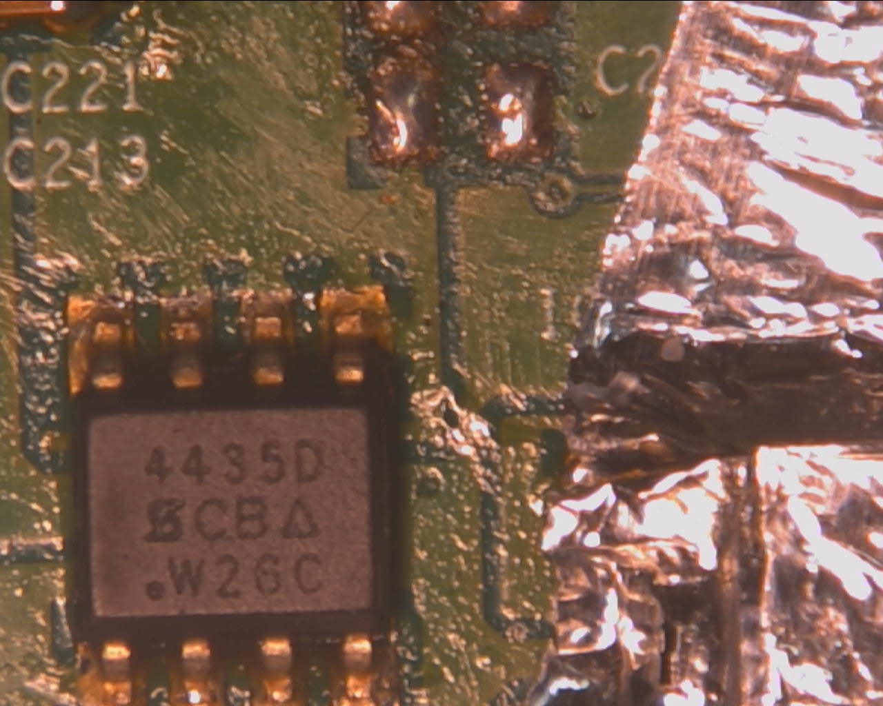

                    "i am thinking of removing the IC that is in that area as it also shows shorted and could be the source of it": so did you try this?
                    I finally got around to it and sure enough, the ic is shorted across and with the ic out the shorts have disappeared. I should have attacked the ic first! Now I have these 3 mlccs to deal with...it raises another question. How do I know what spec these mlccs are supposed to be when they aren't marked? How can I get a correct replacement if I've damaged them?
                    The ic is labeled 4435D so probably fairly easy to look that up and find another one but now I'm worried about the mlccs more than anything else!

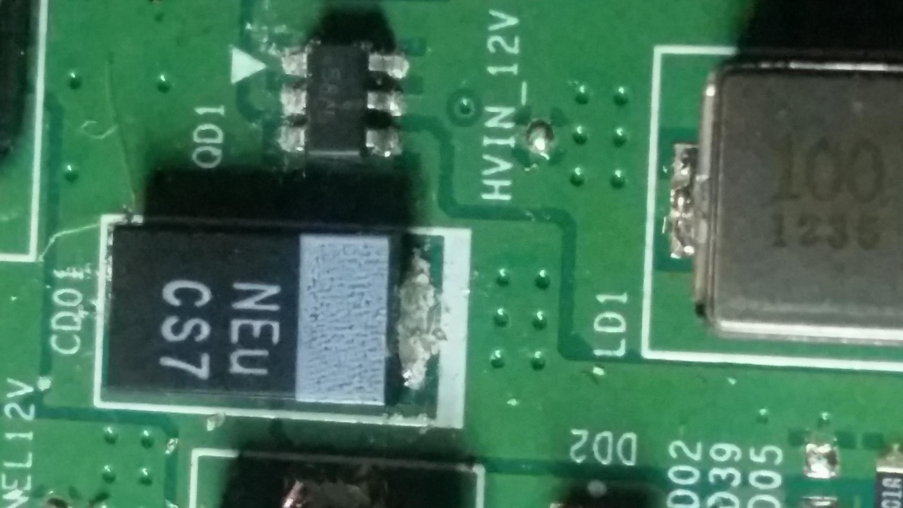

                        Greetings Thomas
                        Cd12 seems fine but qd1 pins 1,2,5,6 are shorted to each other and the part in cd1 is shorted to ground on both sides. Only pin 4 of qd1 is shorted to ground. Probably is the ground pin. Not sure what this ic should look like but 4 pins shorted to each other seems suspicious...or maybe not...the traces on the board do look like they are all connected there...pin 3 looks like it doesn't go anywhere...
                        CD52 and CD53 are shorted to ground on both sides as well...but all the other components in the area are either not shorted to ground at all or only on one side which seems normal
                        Edit: I noticed BD200 which is between the fuse and the source pins of Q201 is shorted...but what is BD200 in the first place? Don't know all the codes.
                          very good question, not sure how standardized they actually are, a little info there: https://passive-components.eu/mlcc-c...rds-explained/

                            • R_J
                              • Jun 2012
                              • 9576
                              Re: Samsung UN55ES7003 has blown fuse on TCON and short to ground.
                              The D (cDxx) is likely just that area of the circuit, just like the other side of the board has C (cCxx) and rCxx qCx etc.
                              The bd200 is just a ferrite Bead (it will check as a short)
                              CD52 and CD53 are likely 1µf/16v

                                    this tv got fixed by replacing the Mainboard and the TCON ... bad failure somehow took out both. i still have the bad MB and bad TCON which i may continue to investigate/repair
