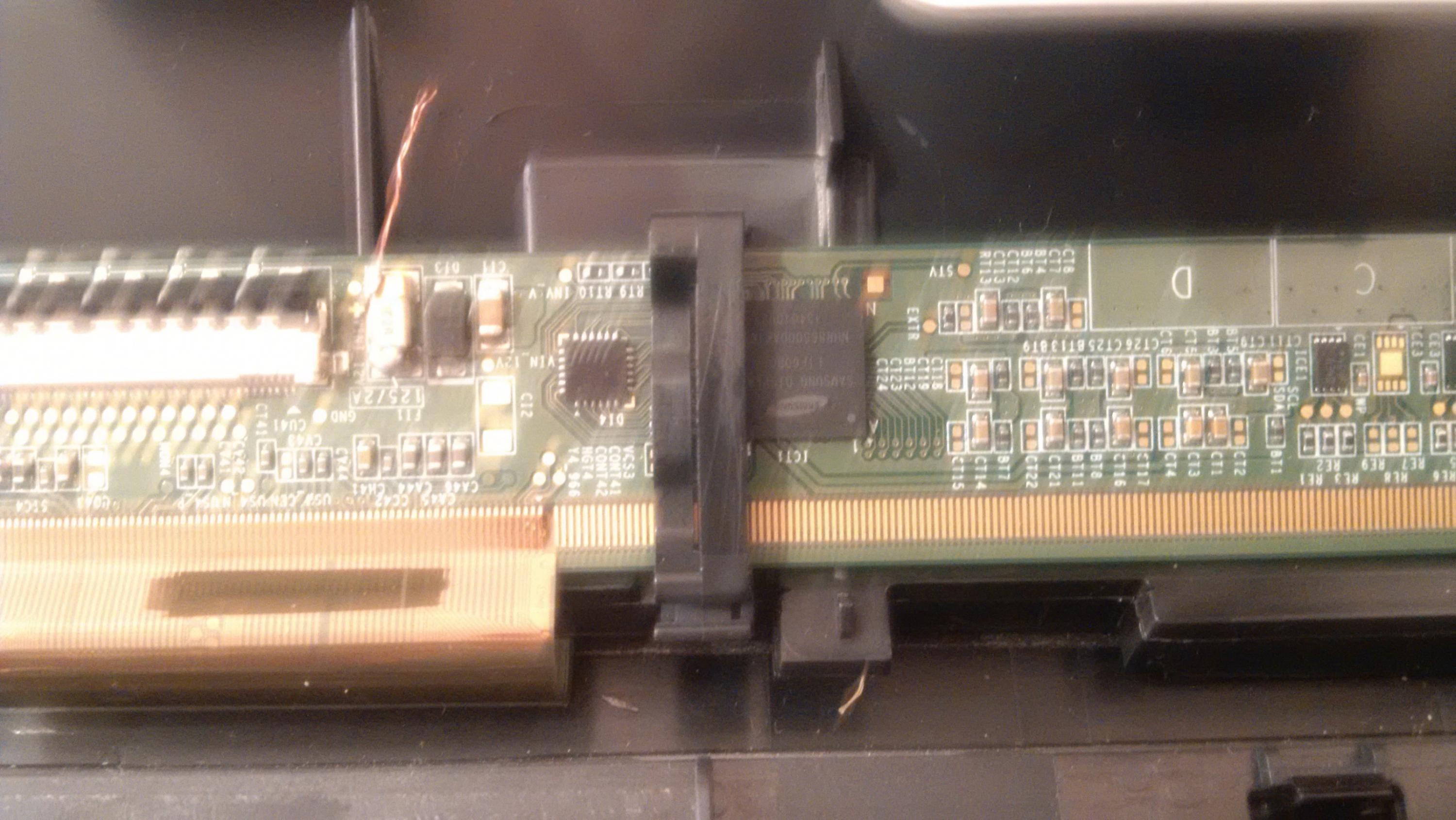

    today I buy Sony KDL-48W605B for repair
    tv turn on ,backlight on but no picture, i click menu sound ok.
    I found little fuse on tcon?(see pic) blown. so I solder wire to check if it work,but not working
    what do you think?
    panel or ?

          Re: Sony KDL-48W605B no picture but sound
          Safety has fired because it is a short or very high consumption. Look for a smd capacitor in short or a dc-dc converter with trouble.
            Yep, start checking for shorted cap/s on that integrated T-CON board, do not put wire in place of the fuse.

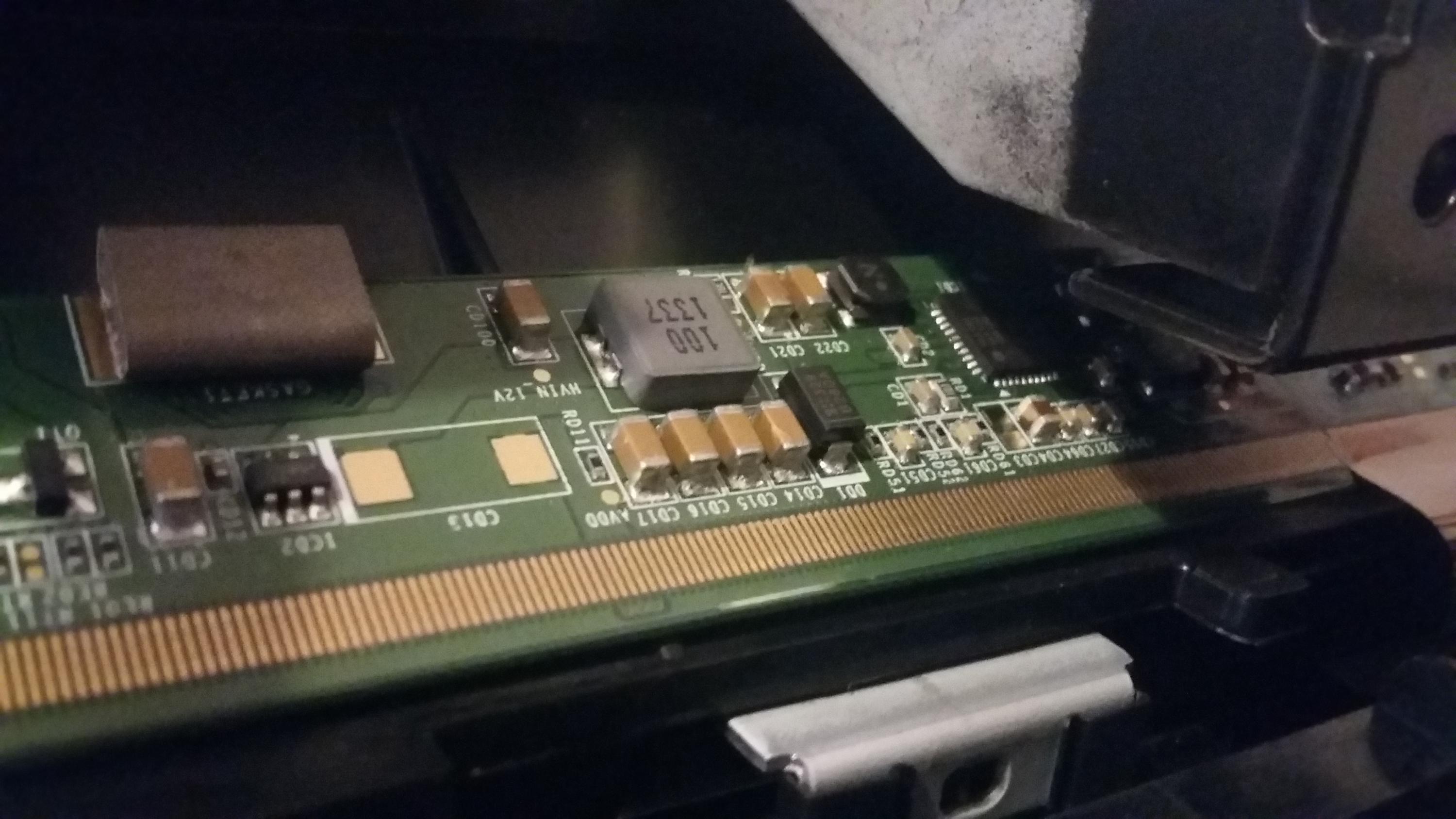

                  ok guys ,I think I found something
                  I found 4 caps shorted to ground CD14,CD15,CD16,CD17
                  but what I see CD14 is cracked?
                  • chrle
                    • Sep 2013
                    • 158
                    • slovakia
                    ok removed cap from board,and now no short on 3 caps to left
                    now I need to find specifications of cap I removed,I dont have capacitance meter
                        The four capacitors are in parallel. It works with just 3. If not, there are other problems.

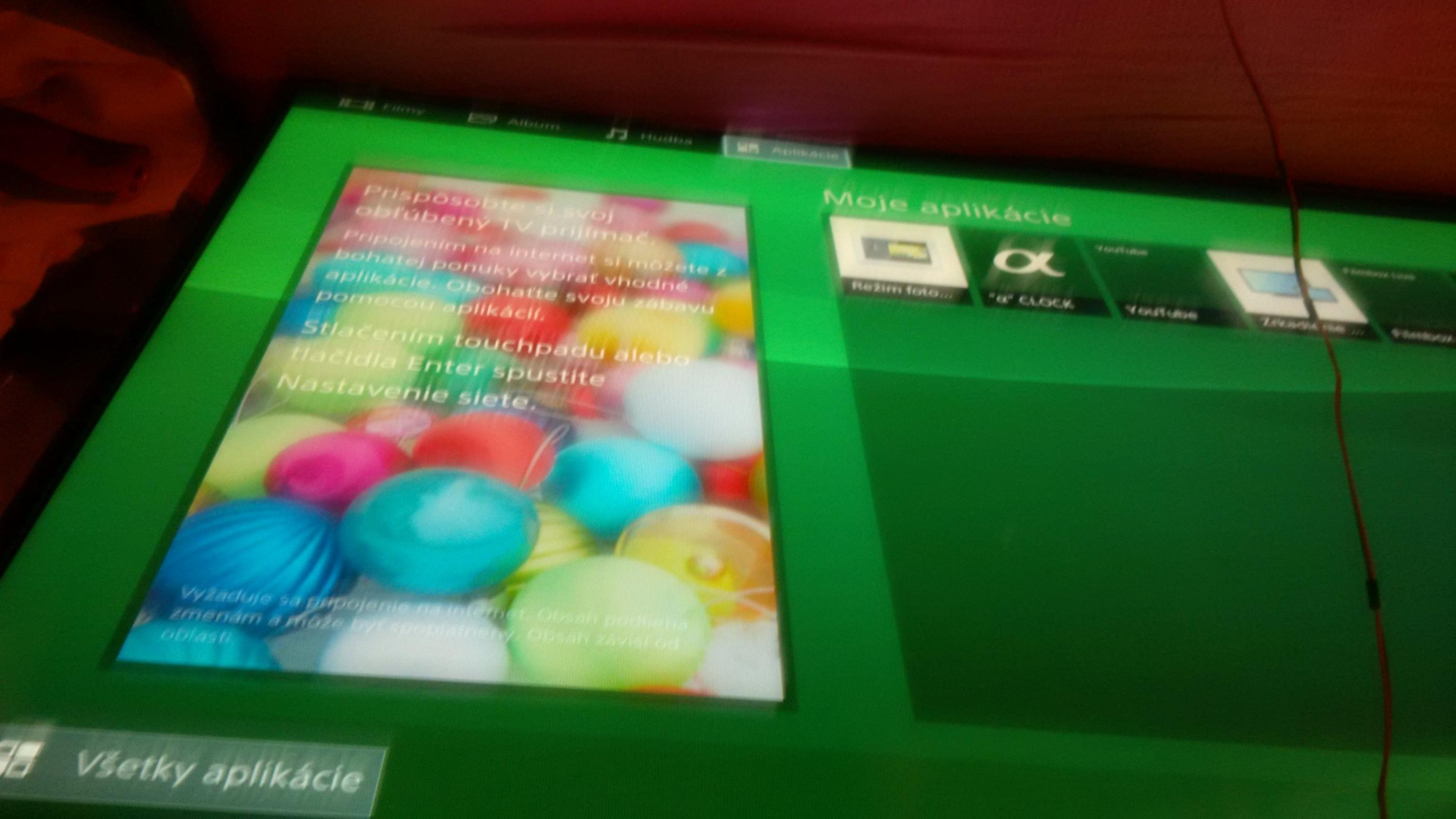

                            tv turn on,no red light but still no picture..hmm
                            my mistake,I have tv on my bed so I dont see picture till I click menu
                            • chrle
                              • Sep 2013
                              • 158
                              • slovakia
                              Ok, so what do you get with the one bad cap removed, any change??
                              ok guys , I have picture without cap that is shorted.
                              tv is working fine,I will test him for few hours.
                              anybody know that cap values? or leave it like this?
                                CD14,CD15,CD16,CD17 are probably all the same value. If you have any way to measure capacitance, then you can remove one of the good capacitors and measure it's value.
                                • yokoono
                                  • Apr 2010
                                  • 481
                                  Leave that. It also works with 3 parallel capacitors. Do not ruin him worse.
