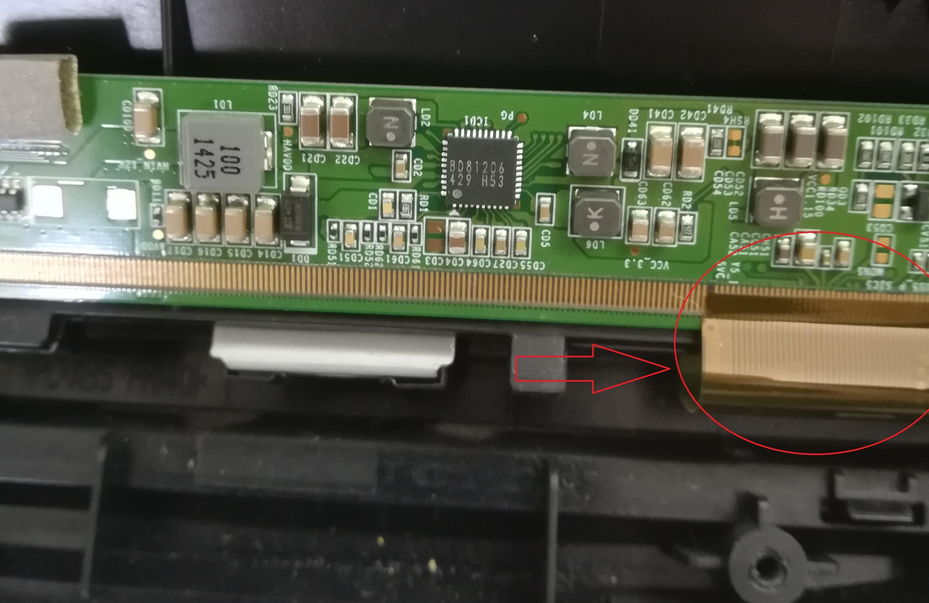

                    Hi, I have the same issue, have sound but no picture,
                    Anyone have a picture of what I should be looking at

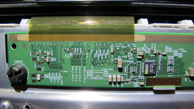

                        Re: Sony KDL-48W605B no picture but sound
                        Have the same problem with this tv, measured the voltages and went through the chart in the service manual > states to replace faulty t-con.
                        Now the problem, how to replace the t-con board.
                        I would appreciate it if someone can tell me how on how to remove the bronze colored panel ribbon cable from the TCON board that seems to be connect at the other end to the panel, without destroying it. I hope to then fix the ribbon cables on the new TCON board.
                        The cables look like they have been glued on to the TCON board. I've attached some pictures to hosw the cables. Any help would be appreciated.

                          #32
                          NO do not remove that, what they are referring to is a stand alone tcon board, what you have there is not and you are right, removing that will pretty much ruin the tv.
