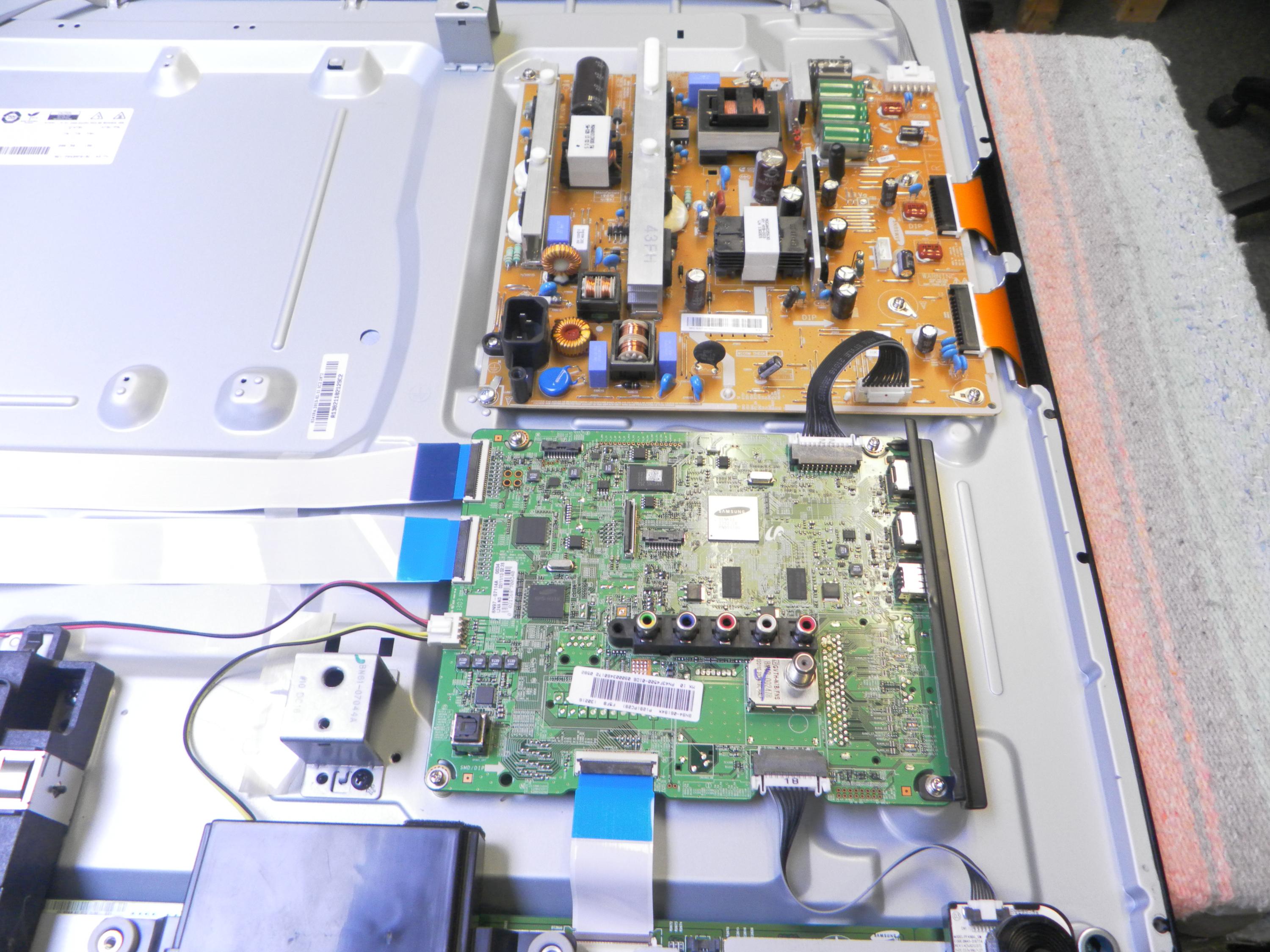

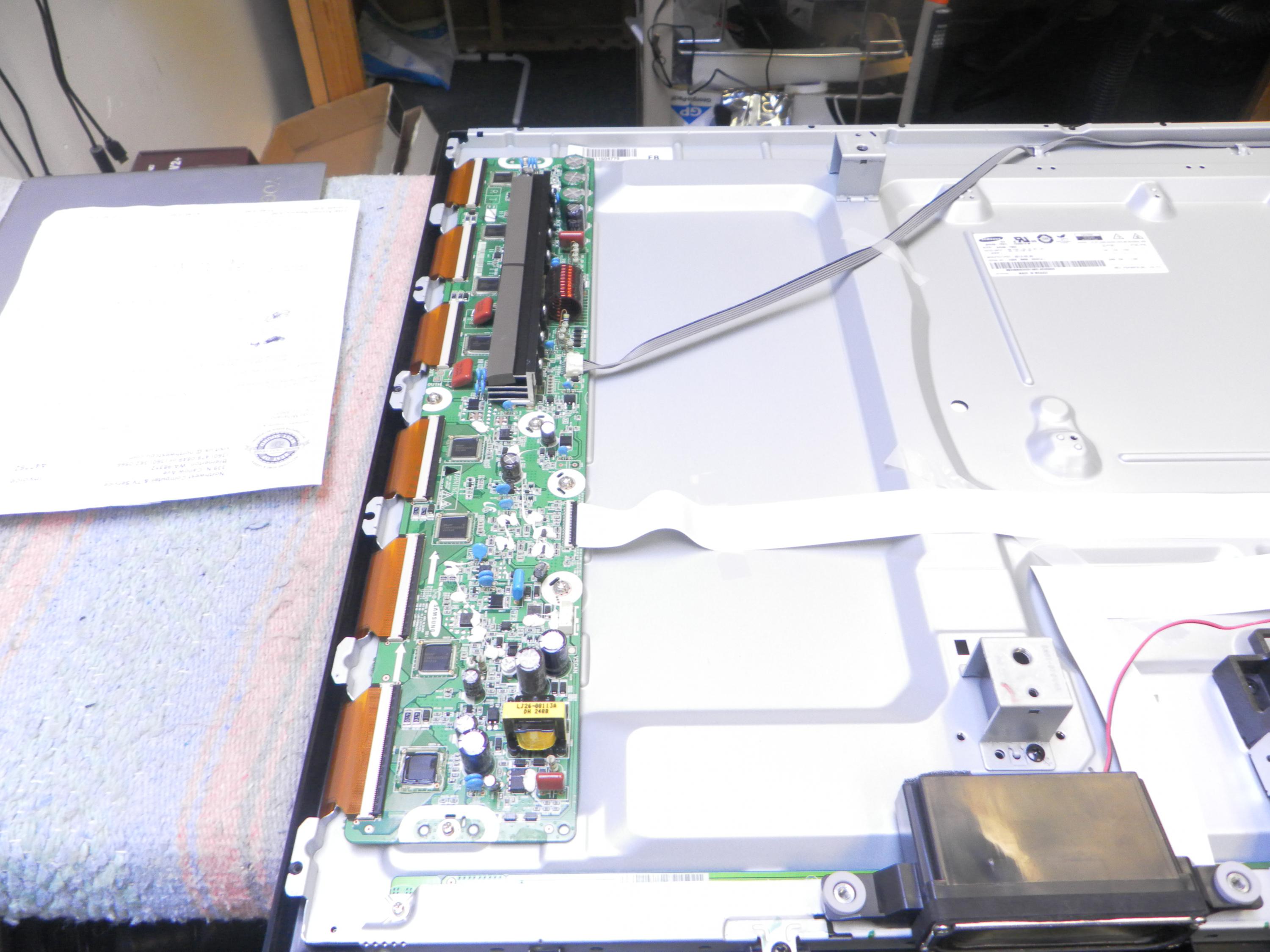

    Samsung PN43F4500FXZA turns on no picture or sound
    TV turns on I get proper VA of 58V but VS is 250V and should be 208V and I can not adjust it with the pot. Also voltages at CN4009 are correct when first turned on then they start to drop to 0. I can not find any thing online about this problem with this model and was hoping for some direction.

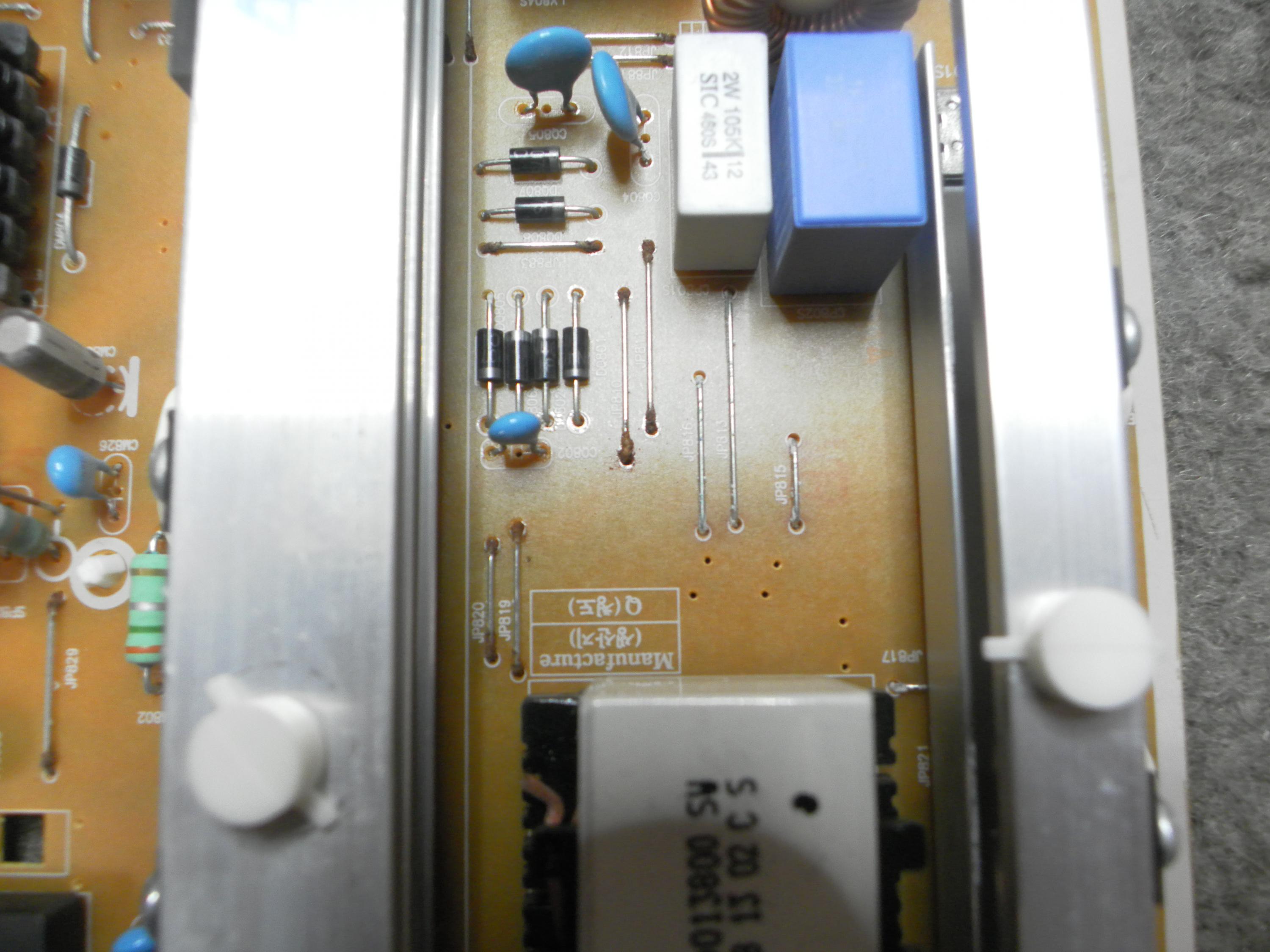

              Re: Samsung PN43F4500FXZA turns on no picture or sound
              That high voltage could be due to a lack of feedback to control the voltage, check the components around the control all the way to the optocoupler, I would also check on the primary side of the optocoupler. most power supplies go down in voltage when they loose feedback for safety
              Check that 0Ω off of DS853C, It supplies the low voltage for the feedback circuit on the secondary
                Don't know how I missed this but there is corrosion all over the power supply board.
