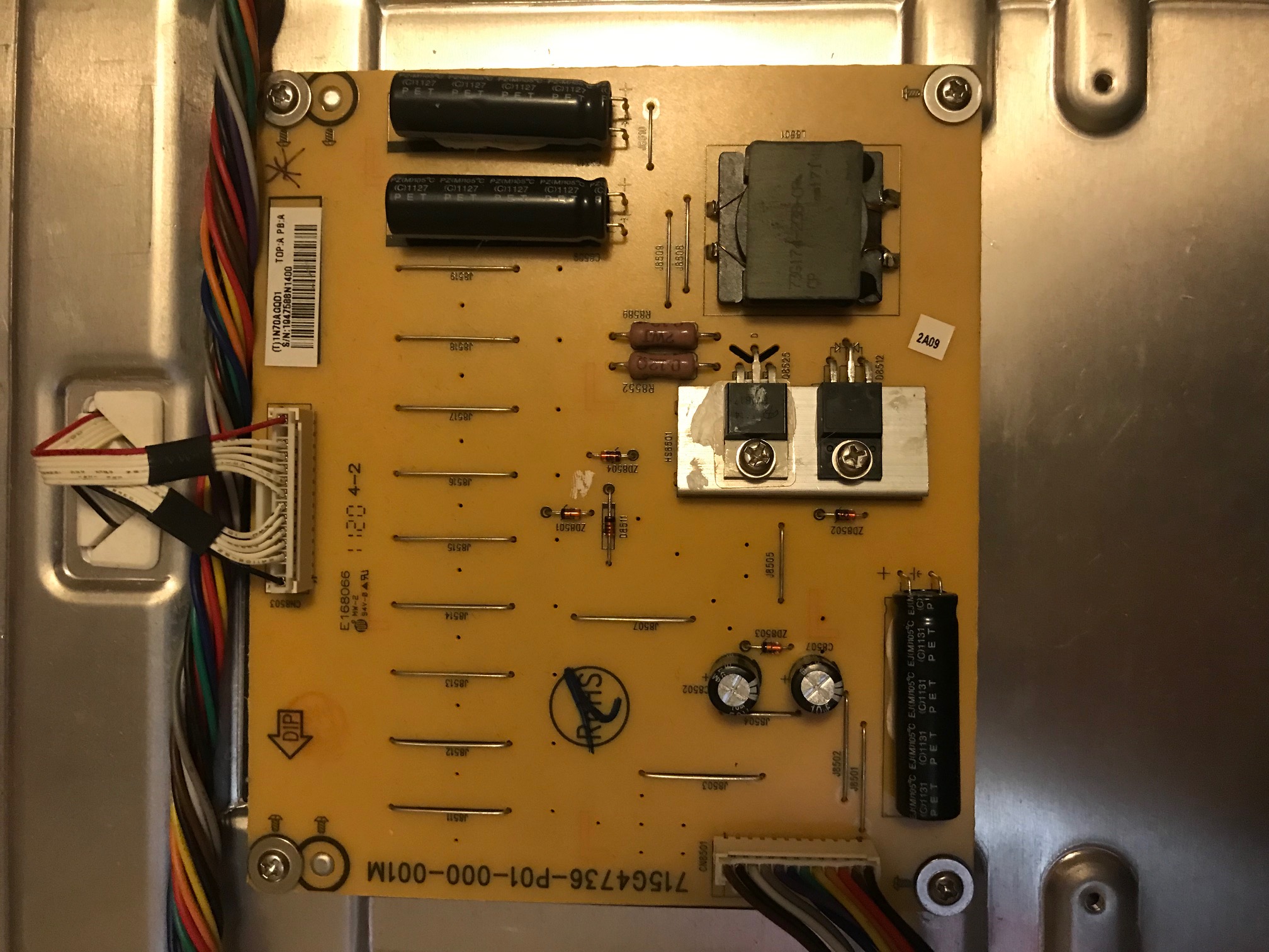

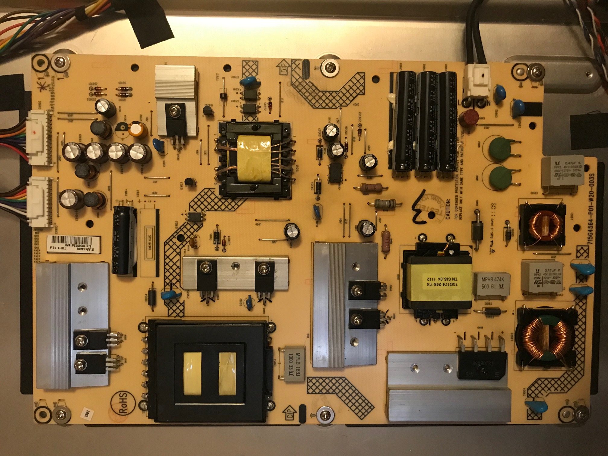

    Have another Vizio E370VT that won't turn on when power applied. Was told it was working previously, but now it won't turn on at all, just steady amber standby light.
    Unplugging the main and trying the power button again results in the same, no response.
    I feel like I should be getting some kind of reading across the On/Off and Dim. Typically I thought I usually got .1 on the others I had.
    On/Off: 0
    Dim: 0
    +12v: 26.4
    +12v: 26.4
    Gnd: 0.00
    Gnd: 0.00
    Gnd: 0.00
    +24: 54.9
    +24: 54.9
    PS_ON: 9.9
    5v+ 10.9
    5v: 10.9
    NC: 0

    1) Check your meter's batteries. No way those Voltages can be that high.
    2) Make sure meter is set to read V DC.

      Sorry, you're correct...meter was on AC, not DC.
      On/Off: 0-.1 (was going back and forth)
      Dim: .1
      +12v: 12.3
      +12v: 12.3
      Gnd: 0.00
      Gnd: 0.00
      Gnd: 0.00
      +24: 25.3
      +24: 25.3
      PS_ON: 4.8
      5v+ 5.2
      5v: 5.2
      NC: 0

        Are those readings both in standby and when you hit the power on? if so, looking like the mainboard isn't sending proper signal/s for turning on, could try unpug powerboard from mainboard and force on powerboard with resistor/s and see if you have backlights.

                Your voltages seem to be ok on the power supply, You could be missing the backlight, have you tried looking at the screen using a flashlight to see if there is any image? you may need to press the menu button to bring up anything if its not on a working source.
                The on/off (and dim) controls the backlight from the main board, The two control pins pass through the power supply but do not control the power supply, they only control the inverter

                  On/Off: 0-.1 (was going back and forth): Missing BL-ON = No Backlights.
                  Dim: .1: Missing Dimming control
                  +12v: 12.3
                  +12v: 12.3
                  Gnd: 0.00
                  Gnd: 0.00
                  Gnd: 0.00
                  +24: 25.3
                  +24: 25.3
                  PS_ON: 4.8: PS-ON is fine otherwise you will not have the switched 12V, 24V
                  5v+ 5.2
                  5v: 5.2
                  NC: 0
                  You can try forcing on backlights by disconnecting the ON/OFF and DIM wires going back to the main board first then use two 1K resistors; one between 5.2V standby power supply pin and ON/OFF pin and another one between 5.2V standby power supply pin and the Dim pin.

                    So that worked, I have backlights!
                    So...what does that mean?!

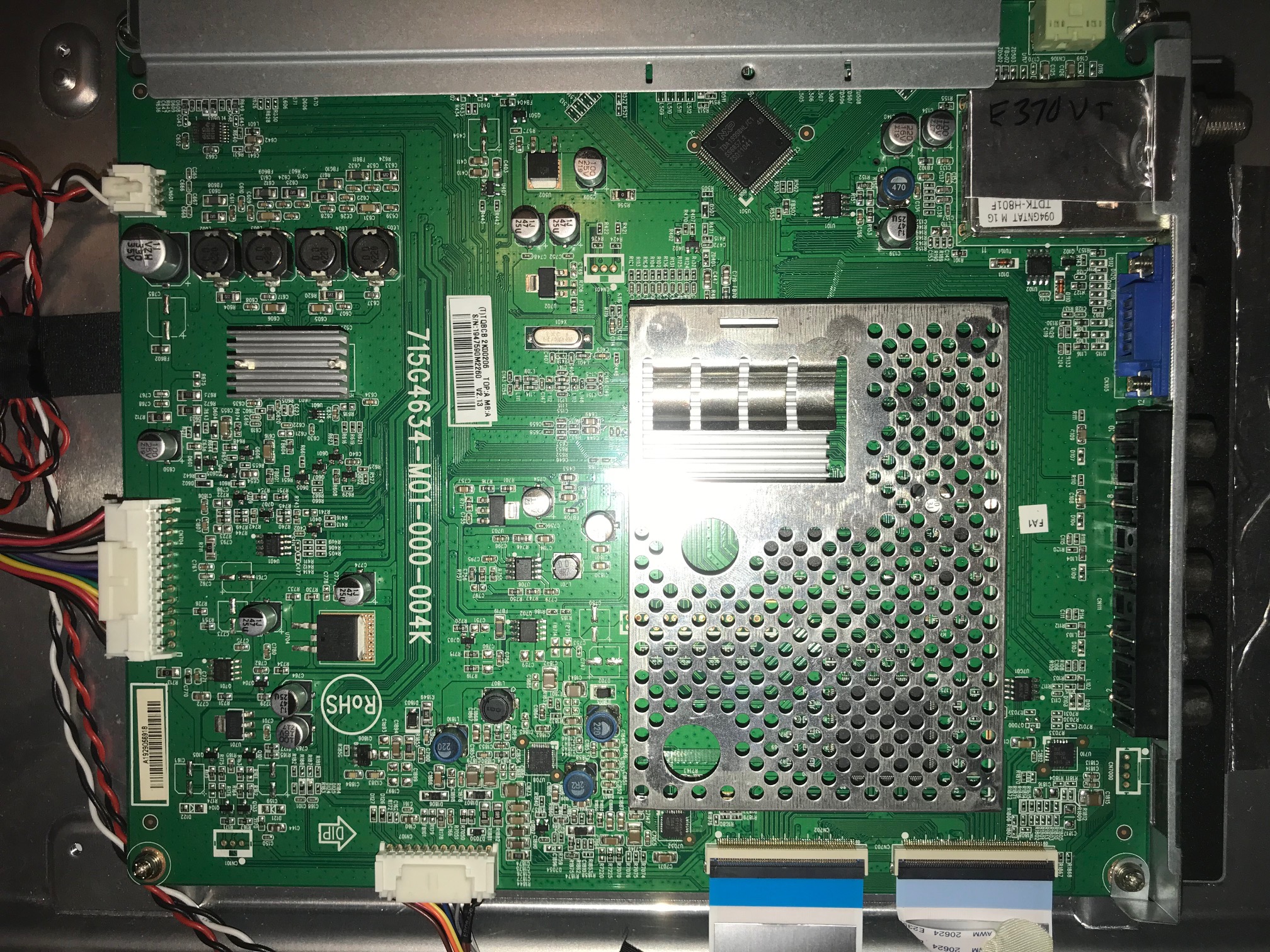

                        Yeah I don't get any images on the screen (tried menu for example and volume up/down). I tried a second main board, which I received from TV Parts Central and same thing. I also have another LED driver board which I tried swapping out and still the same.
                          Re: Vizio E370VT
                          Are you 100% sure that the replacement main board is good?

                            No, I can only take their word for it. Maybe I'll see if I can source another. Not sure if I wanna throw much more $ toward this thing though.

                              It may be an eeprom issue on the main board, do you have a way to freeze the eprom (U408) on back of main, Either use freeze spray or an inverted can of caned air. Unplug the tv, freeze the ic, then plug in the tv and press power and see if turns on.

                                Tried canned air and freezing U408 on the back of the main board and plugging in and hit the power button and nothing. Thanks for the idea though!

                                  Maybe send that board back and see if tv parts central will send you another one, it may be faulty, do you get the exact same low/missing voltages with both mainboards?

                                      This is a vizio mainboard, but looks similar those made by AmTRAN.
                                      Try obtaining Vizio firmware from their website, place the firmware on a correctly formatted USB stick, place usb stick into USB port on TV, then plug TV in and see if the TV automatically installs firmware from USB. You may have to leave the USB plugged in for 10 minutes or more.
                                      I repaired a 32" Panasonic LCD TV a few years ago that had similar design and didn't work despite everything testing ok. Installed firmware via USB and voila!
                                      There may be some LED blinks from green to red, or whatever. I can't remember but try USB update.

                                        now that you got backlights, maybe you need to move further along the video path towards the tcon to check things there. Should be some voltage labeling somewhere on the tcon that you can check.... along with any fuses.
                                        of course a picture of the back of the set showing how the cards are connected may help. Depending on the configuration, if 12v is switched at the main, you might want to check that it gets there and then again leaves toward the tcon.
