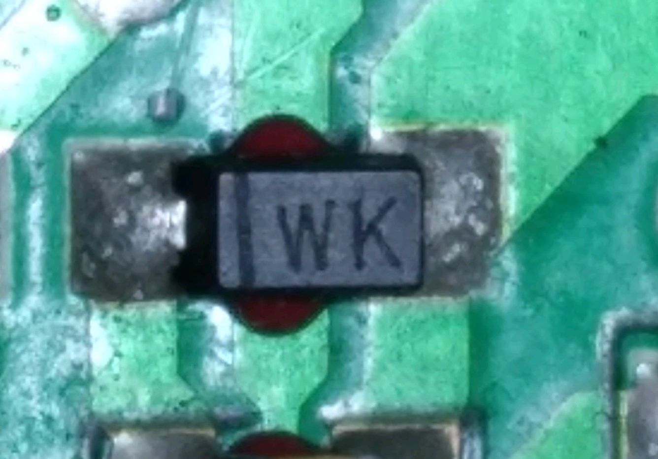

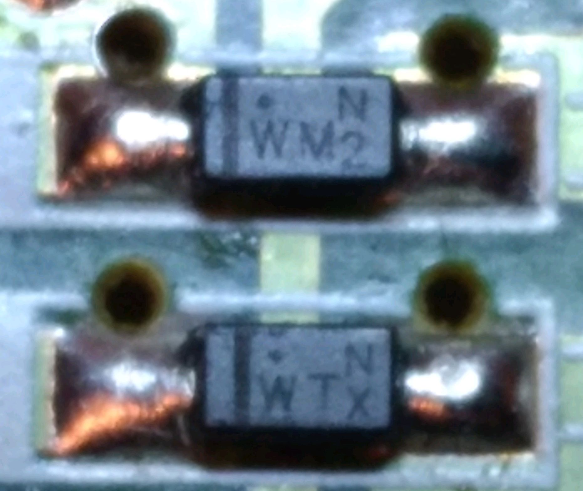

                    • DXseekerMO
                      • Feb 2018
                      • 1119
                      • US
                      #50
                      Re: Sharp LC-55N620CU PSU 192020 help ID'ing a transistor
                      Originally posted by R_J
                      MMSZ16T1G, I can't make out the letters from here.
                      The letters are WK, picture below. The picture with two Zener's are on a scrap board. Will either of these work for testing?
                      And you're sure your rectifier diodes are ok?
                      Yes, just checked it again.

                              #54
                              The WK diode seems to be a BZT52C13 13 volt zener, put one in and see if that voltage gets to 13 volts, if it does you know the original is bad, no weather the power supply will operate at 13 volts is boarderline
                              this part of the circuit could not be simpler, 160v through 3 series resistors (which you checked are ok) to the 16 volt zener, the voltage at the zener will be whatever the zener is.
                              • R_J
                                • Jun 2012
                                • 9551
                                #55
                                I misread post 50,
                                Here is a pdf of the zeners
                                And if you look at Diodes incorporated
                                WK = 16 volt
                                WM = 20 volt
                                WT = 39 volt
                                I would try and find something closer to 16 volts if you can, if not try the 20 volt
                                Some mfgr's list the WK as 13 volts but I will trust the schematic
