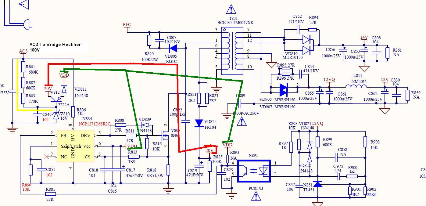

Sharp LC-55N620CU PSU 192020 help ID'ing a transistor

    Re: Sharp LC-55N620CU PSU 192020 help ID'ing a transistor
    Looks like it is ok, so why is there only 6~7 volts on it?
    It could be that V812 is leaky
    • DXseekerMO
      • Feb 2018
      • 1119
      • US
      #62
      This is excellent question. You said this Zener has series resistors before it so maybe I should be re-checking these? There doesn't appear to be enough voltage at the Zener to start with?
