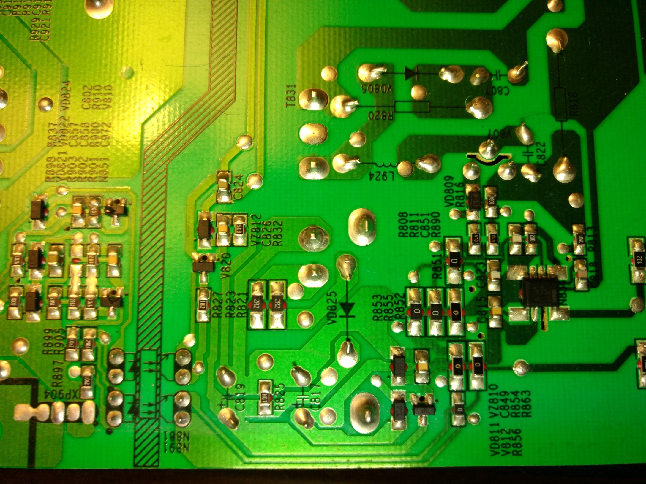

Sharp LC-55N620CU PSU 192020 help ID'ing a transistor

    Have you replaced N851 ? If it is still in circuit and shorted, it could be shutting down the power supply by turning on the opto
    "PIN6 is 6.6v to 11.1v up and down" That tells me the ic's startup cell is working, the ic should pulse the fet's gate and the fet should drive the transformer, this will give you the +20 volts on C819, so check that R821 & R823 are ok.
    Also check that you have +160 on the V807 Fet
    Ok I think we're getting somewhere. On the OPTOs my board's callout is N881 and 891. Both cold side pins of N881 show 3ohms resistance.
    If I am seeing it right R821 and 823 are in parallel, Both 2R2 resistors and with 1.5 ohms across both
    V807 has 166V

          3Ω is low for the led of the opto, Did you replace the blown TL431? as for the opto 817b and 817b are the same.
          I believe N881 opto is for turning on the backlight, so don't worry about that circuit now.

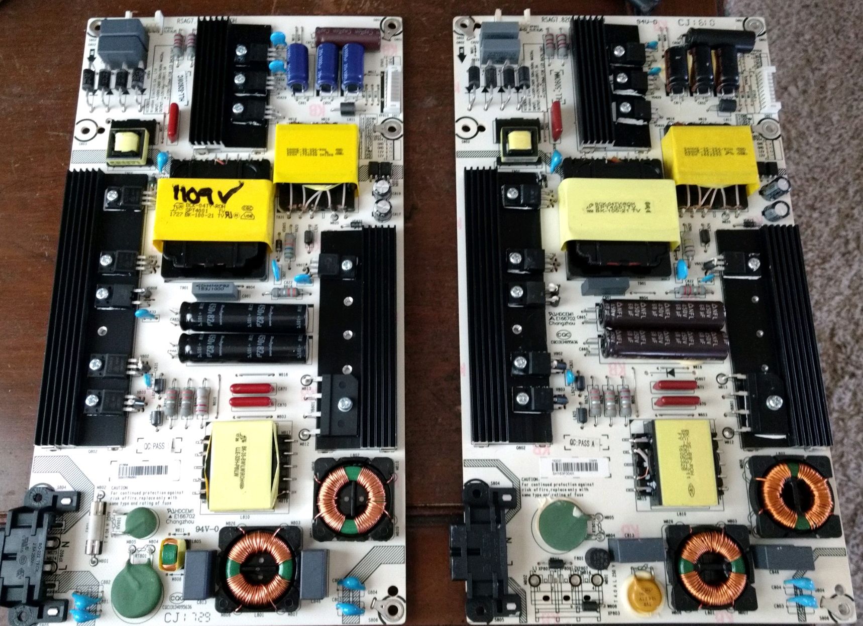

            I have not replaced the blown TL431 just yet. What I did do is have a look in my inventory list and found a near identical board (217654) from a LC-55N6000U.
            TL431 definitely needs replaced. I'm looking for one similarly marked on another board to transplant for testing. Is there a list somewhere I can look at for compatible IC's with other markings?
            I feel the need to go back to the up-and-down voltages off the bridge rectifier for just a minute, because when I fire off the 217654 power board the voltage at its bridge rectifier is rock solid.
            I guess the reason I went back to this is to ask...do you think the shorted TL431 is causing the voltage fluctuation, or is the bridge rectifier suspect too?
            Also, both boards have the same output specifications and pinouts. Can I substitute this board in place of my original to test the rest of the TV? If so I don't think I'd do that until I pull the main board and have a look for "crispies".
            With all of the damage on the cold side of the board I'm wondering if the damage trickled down from the main board? It's a confirmed nearby lightning strike with immediate thunder and other cooked devices in the home.

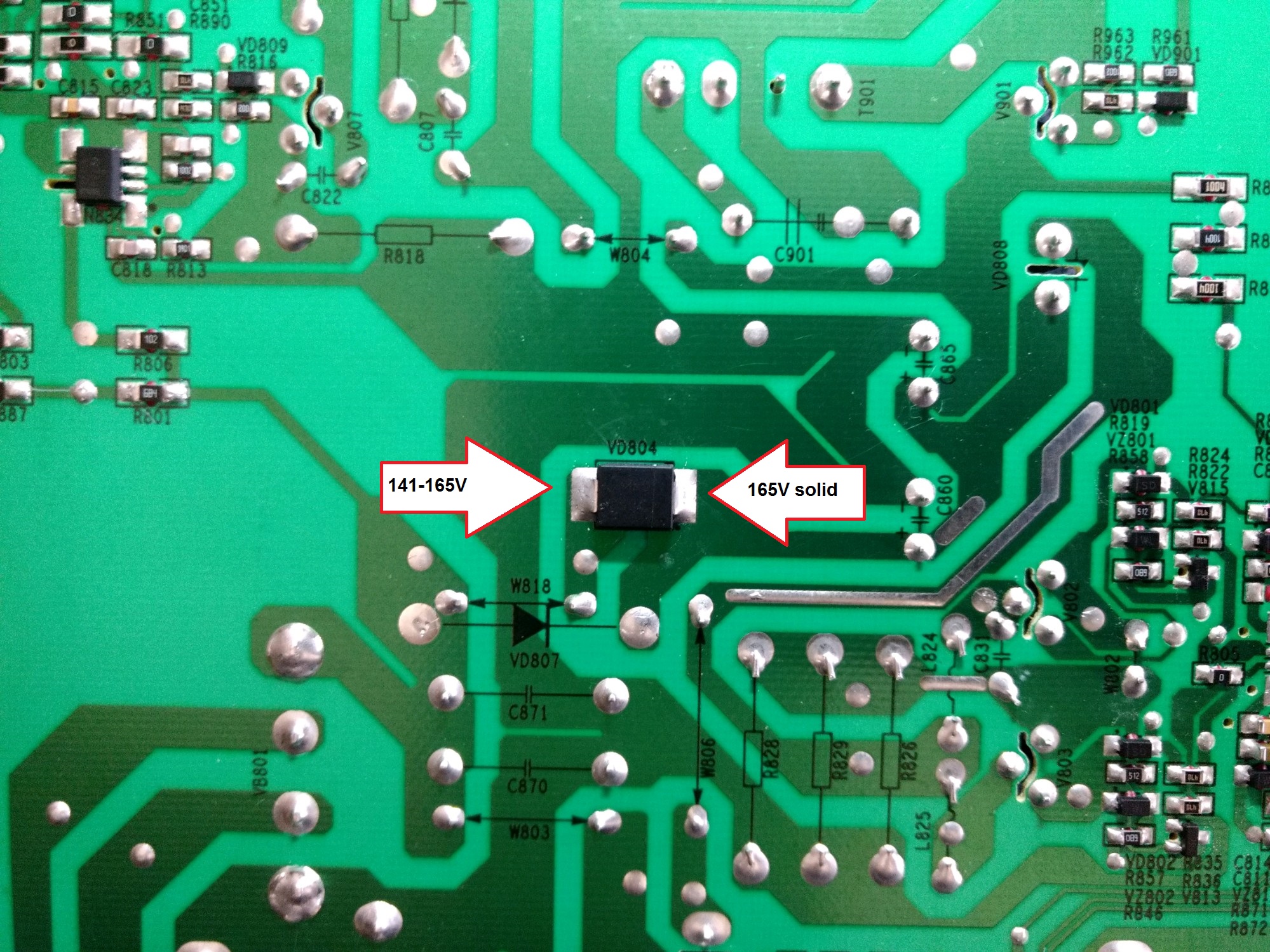

              Re: Sharp LC-55N620CU PSU 192020 help ID'ing a transistor
              Something is not adding up since the Voltage on the main cap is stable but the output from the bridge is not, if output of the bridge goes up and down then the Voltage on the filter caps should follow.

                The boards do look the same, so it should work. The TL431 is a Precision Programmable Reference. it is there as a reference so the 12 volts can be regulated by driving the optocoupler and controlling the N834's ouput. like I said before, almost all smps use this reference ic, usually in a to92 case. (3 leg through hole mount)
                Budm: there is a diode (VD808 &VD804) between the bridge output (ac3) and the main filter cap in the pfc circuit, so the bridge voltage which is not filtered could change if the N834 ic is trying to start and stop, pulsing.

                  This is the only device between the caps and the bridge rectifier.

                    That diode (boost pre-charge diode) is part of the PFC Voltage booster circuit, the Voltage on the anode is 120Hz DC pulse.
                    See fig. 3

                      Installed the P6000's PSU. Its good news and bad news. The good news....the best I can see the OSD appears OK......but with no backlights its hard to tell.

                      Do you agree with R_J's belief that the fluctuation is from the board trying to start? It sounds exactly like what that Samsung 50" EH5300 was doing and it sounds logical.
                      EDIT/ADD: Backlight availability on this TV is super lousy, either high dollar used or cheap from China, ebay seller christmas2carol and arrival from late march to the second week of april.
