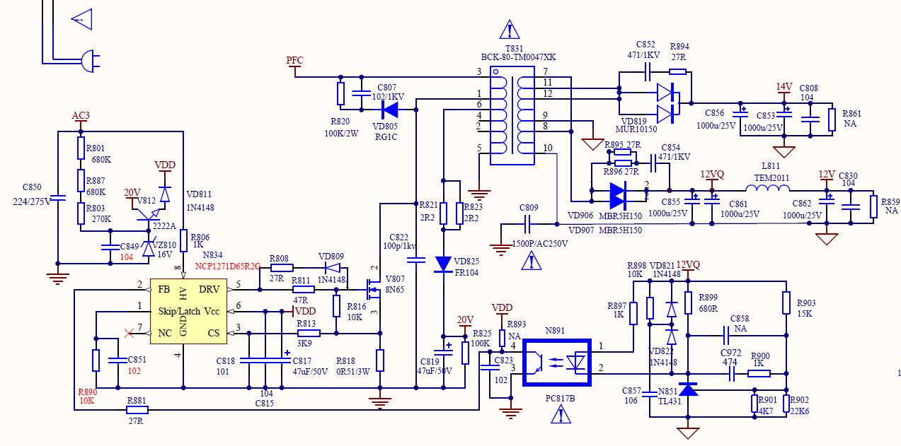

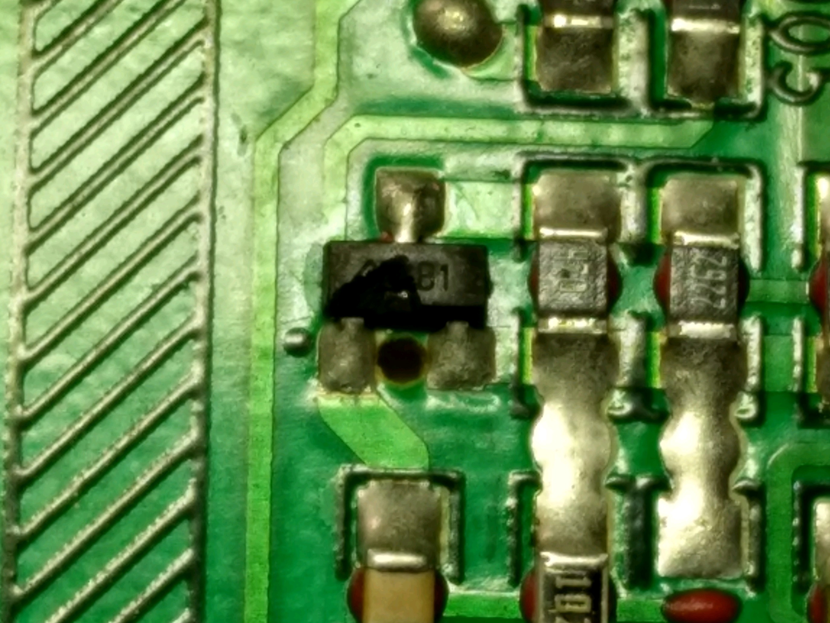

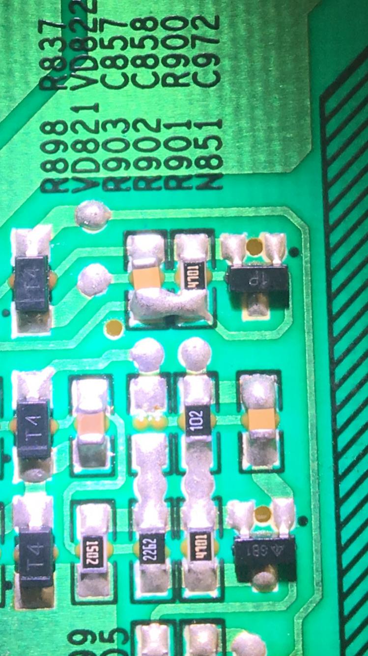

    I'm working on the stand-by portion of a HiSense/Sharp power supply #192020. I found a transistor blown apart to the point I can only read a couple numbers. Can anyone help me ID this?

    I happen to have one of these on hand. GB1 is the marking. Here's the picture.
      Shout out to linksys1127 and Hernando MS! Thank you for posting that, super stoked up you had that board!
      The placement of this and the other transistor in the circuit makes me wonder if the over voltage event originated on the main board?

                          N834 is 1271A, believed to be NCP1271, datasheet attached
                          I was unable to conclusively find a datasheet for either of those transistors. I'm having a hard time turning a the numbers on them in to a part number so I an get the right sheet.
                          The 1P transistor is directly short on the top center and lower left pins
                          EDIT/ADD: I checked the components near N834 and all appear to check OK in-circuit. The IC itself is not shorted to ground and ground is not shorted to any other pins

                            That GB1 is a TL431 reference ic
                            Using hot ground, check if you have VCC on N834 pin 6, Also check for aprox +160v on pin 8. Then check the base of V812, it should have +16 volts (VZ810 is a 16v zener)
                                Thank you R_J, how did you translate the number on the IC to the number you gave me?

                                  N834:
                                  PIN6 is 6.6v to 11.1v up and down
                                  PIN8 checks just like across the rectifier diode, about 144v to 161v
                                  Base of 812:
                                  6.7 to 6.8v, up and down rhythmically
                                  They call me......."threadkiller"
                                  • R_J
                                    • Jun 2012
                                    • 9558
                                    Re: Sharp LC-55N620CU PSU 192020 help ID'ing a transistor
                                    Check R801,R887,R803, Are you sure that was the base of V812 you checked? AC3 comes from the + of the bridge rectifier.
                                    maybe check all 3 pins of V812
                                    See if this helps
                                      See if this helps
                                      I am sure I checked the base of V812, verified with the datasheet. The other two pins of V812 check at 6.2v
                                      R801 = 628K in one direction and about 852K in the other
                                      R887 = 632K in one direction and about 852K in the other
                                      R803 = 628K in one direction and about 750K in the other
                                      EDIT/ADD: The schematic above shows R803 as 270K resistor. The one installed on my board has the numbers 684 on it, same as R801 & 807.
                                      After that series of resistors the test point has 6.8v and is mostly stable. At the first resistor that comes directly from the + of the bridge rectifier the voltage is up and down from 141V to 165V.

                                        Have you replaced N851 ? If it is still in circuit and shorted, it could be shutting down the power supply by turning on the optocpupler. If you don't have sot23-3 find a to-92 style and use it for now, most smps use them.
                                        "PIN6 is 6.6v to 11.1v up and down" That tells me the ic's startup cell is working, the ic should pulse the fet's gate and the fet should drive the transformer, this will give you the +20 volts on C819, so check that R821 & R823 are ok.
                                        Also check that you have +160 on the V807 Fet
