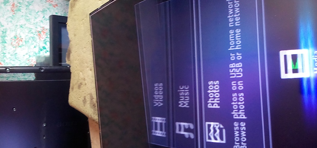

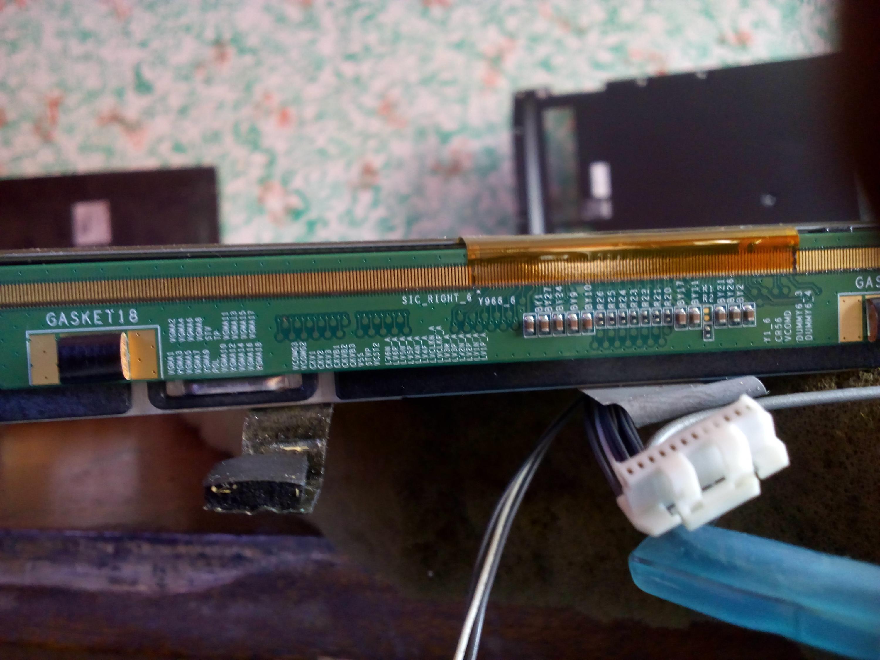

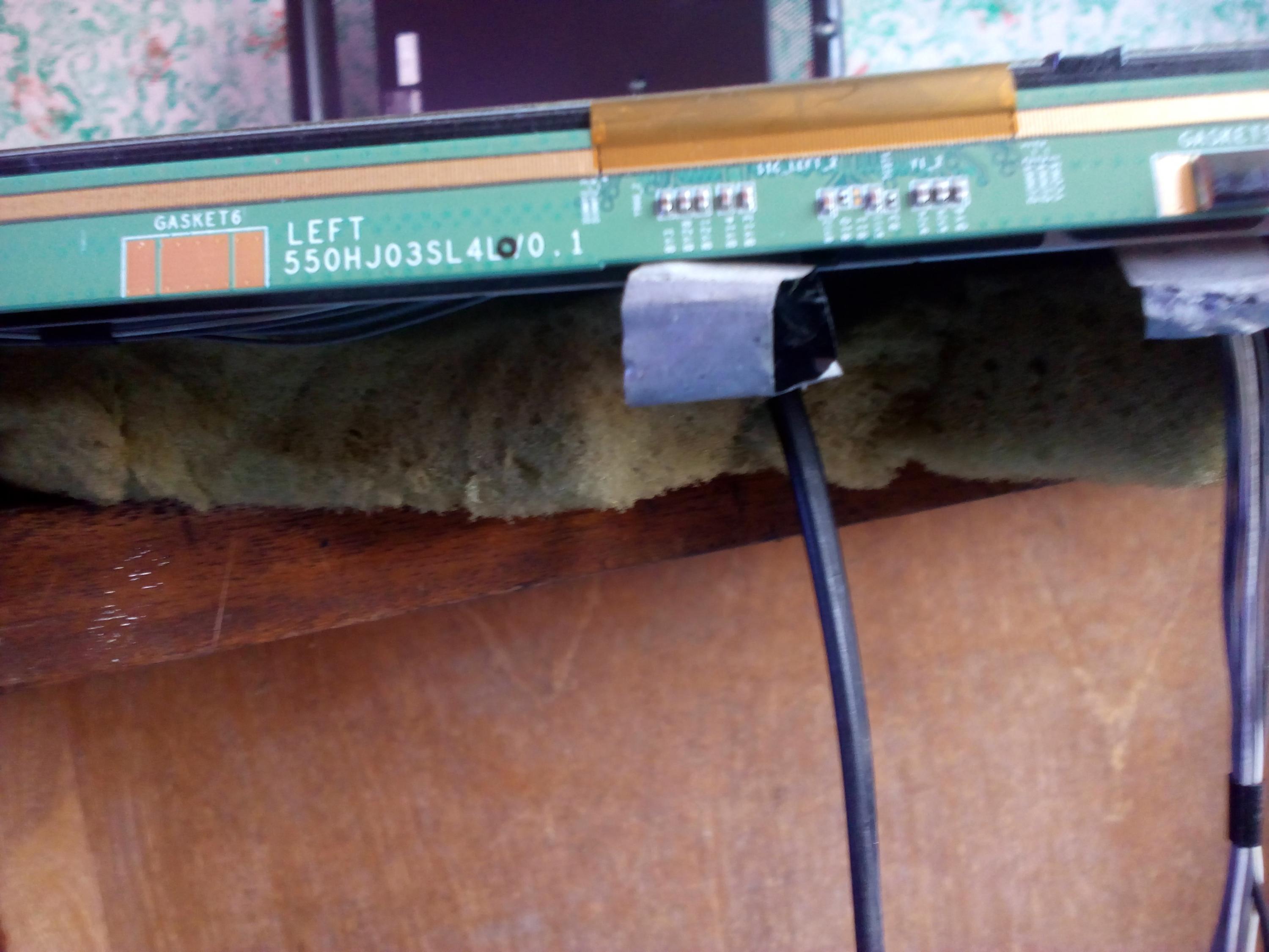

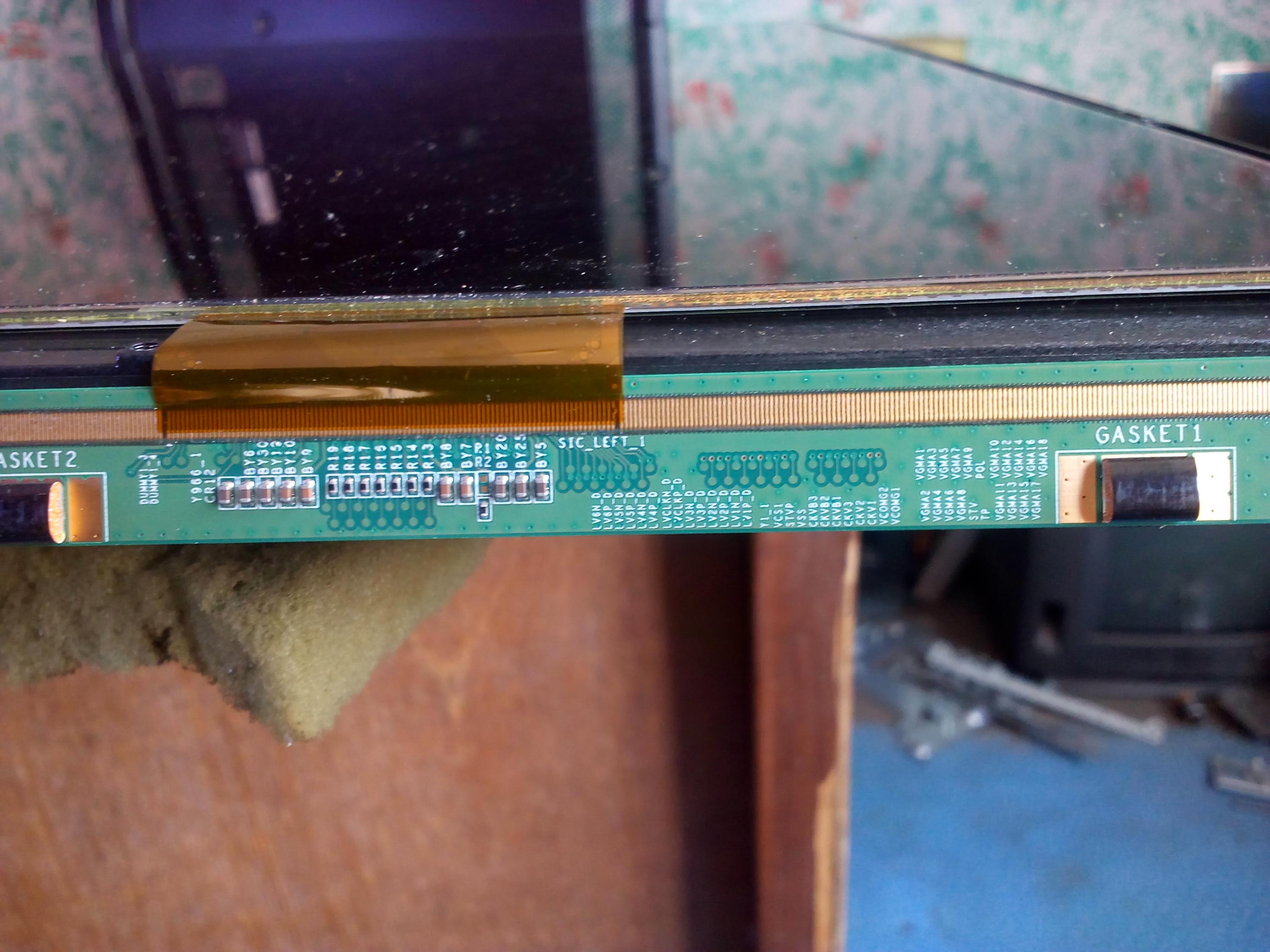

    Hello all, i just received this led tv with double image, but am confuse on which point to cut, here is the pictures of the T-con and image of the fault, can anyone please show me with picture

    you don't cut any of those... you use a piece of tape and place it on a set of contacts at the tcon board on a connector going from the tcon to the panel. This basically acts as a "cutoff" of signals that go to the panel which then might help get a better picture. This process is "trial and error" but because you are using a piece of tape, it causes no long term problems and can be repeated as often as necessary. Cutting those cables picture is a permanent one time thing and is a BIG GAMBLE.... don't do it.

      Cut signals ckv1-ckv2-ckvb1-ckvb2-stvp on lcd board

        yes i know i need to cut, but my challenge is i can not identify which of the point is the cvk1 ckvb1 and so on, that is my challenge, if anyone can show me i will be grateful

          ok, can you show me which end to insulate ?

              Re: Sony Kdl-55ex721 double image
              What is the LCD panel model number? T-CON P/N?
              The tape off method is to tape off the pin to the COF GATE drive.

                I finally fixed the tv by cutting ckv2 and ckvb2 on the left side panel, tv working very fine now.

                  Nice job, did you get a picture of your cuts to show us?
