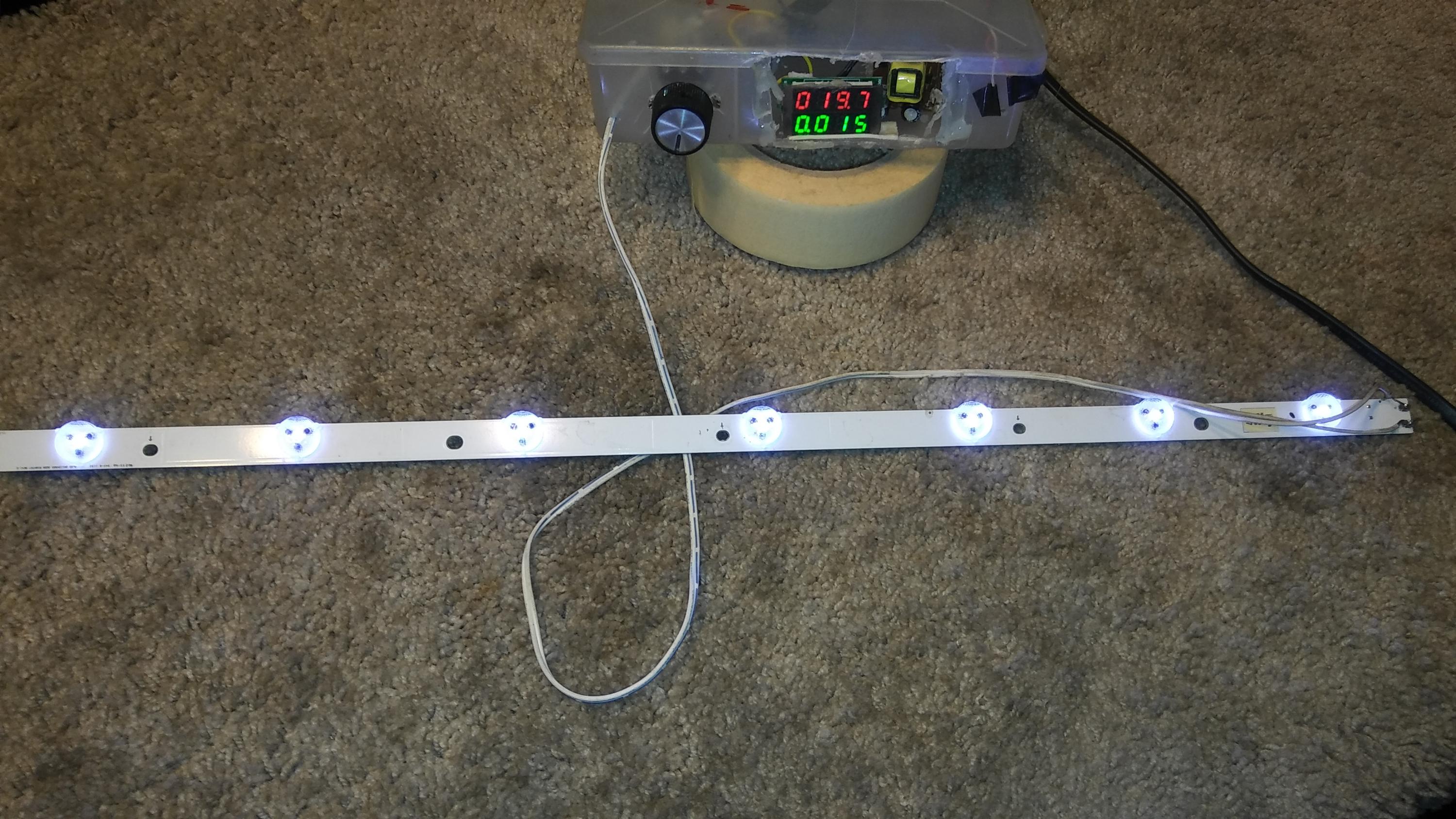

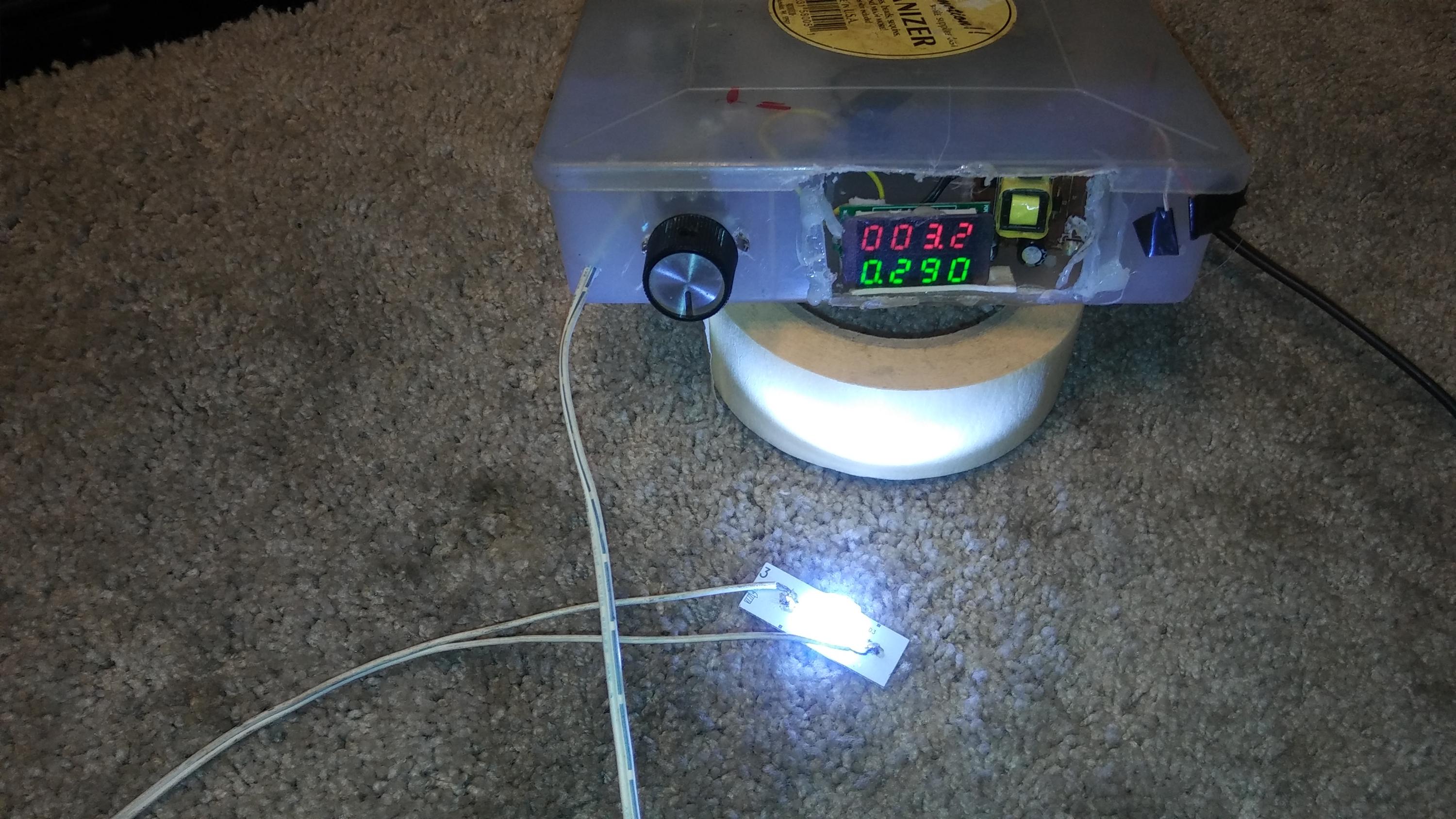

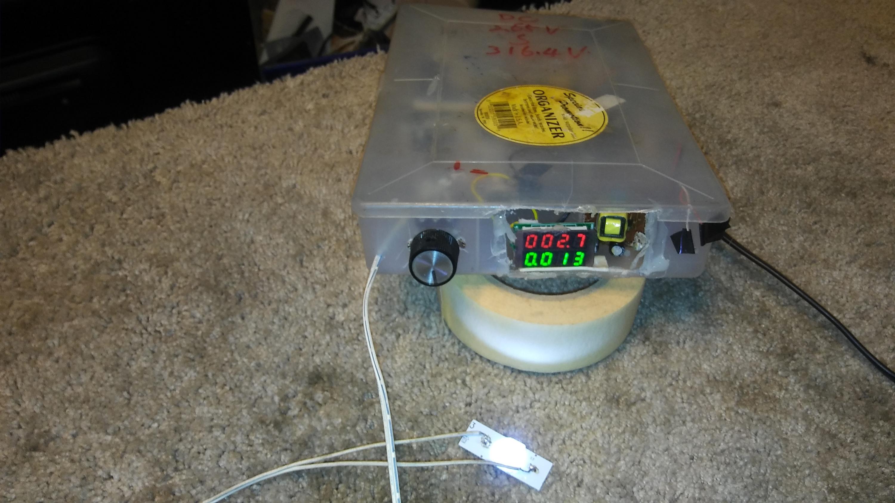

                      • capwizard
                        • Jun 2016
                        • 1991
                        Re: Homemade LED tester for tv.
                        Originally posted by capwizard
                        For ex: samsung 40" up tvs. they will need 256 to 425v to test all the serial led strips at same time. LG tvs have 2 groups led strips will need to isolate the problems and give customers right estimates asap. At least should have 320v. (Ex shopjimmy's tester)
                        If I do not use good tester. I opened the screen then found out I am wrong that happened to me all the time.
                        I tried to achieve is the one better than the commercial one. With cc and cv Adjustable control and will cast you almost nothing.
                        My goal is to help people in Africa.

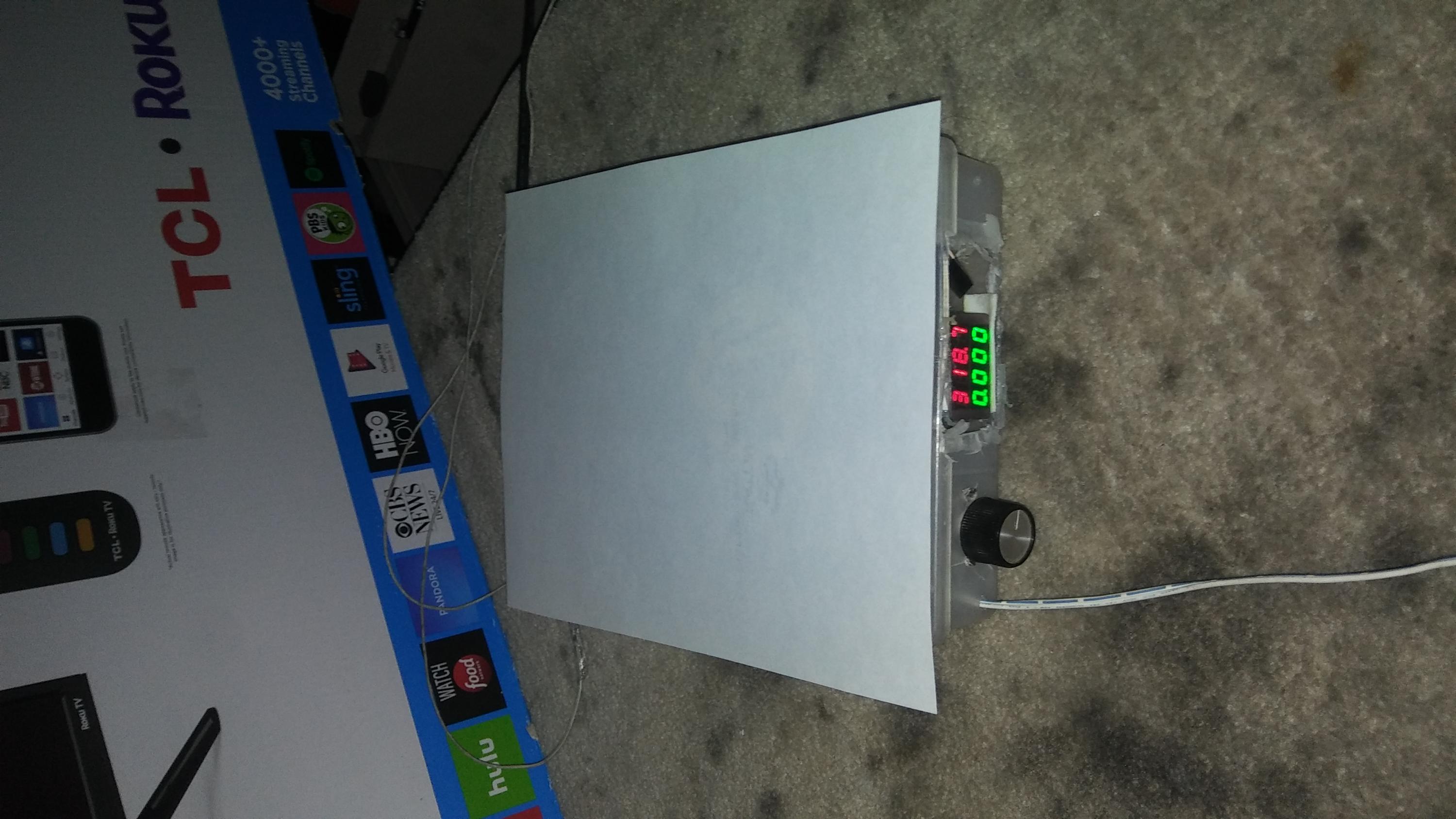

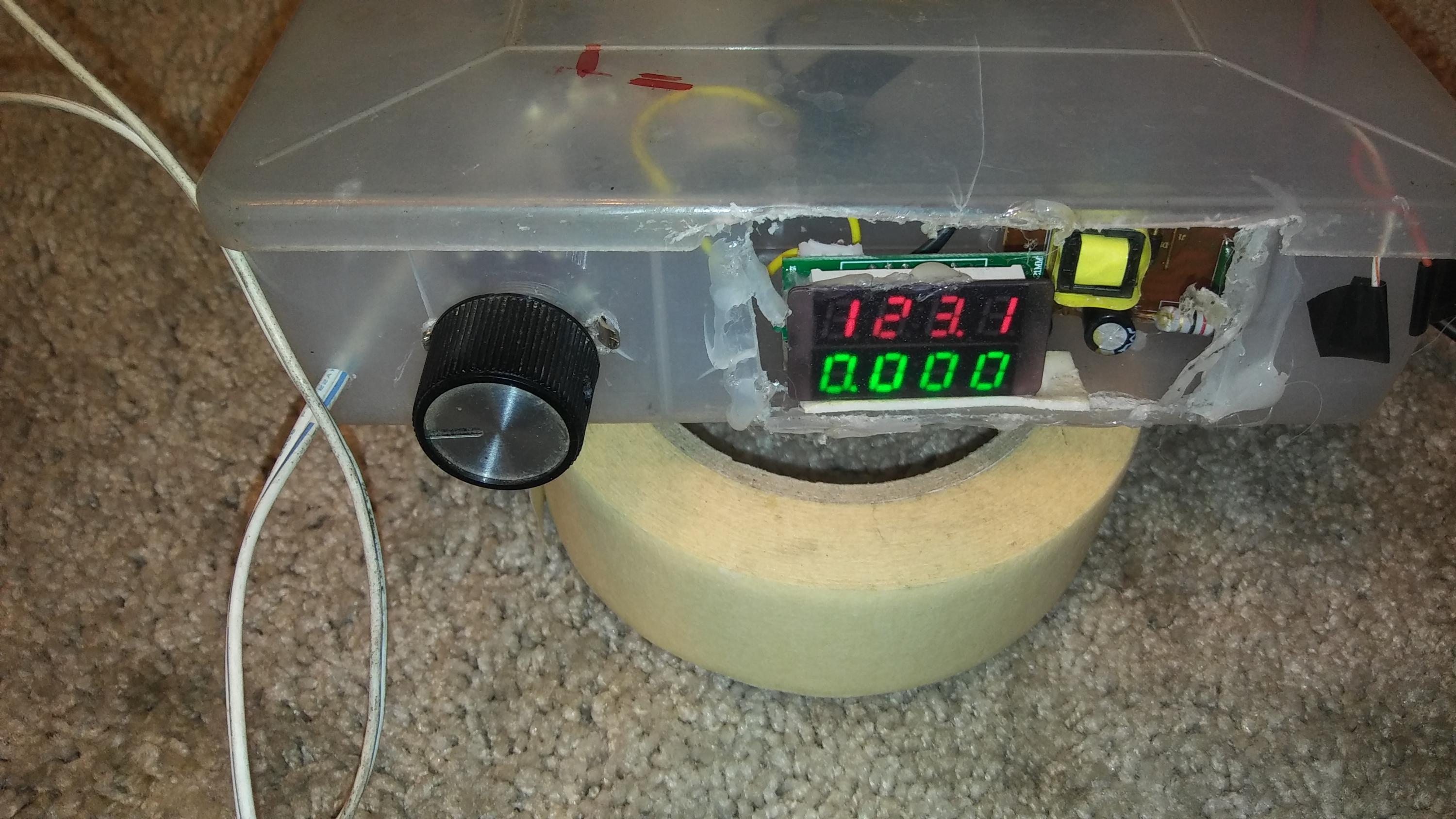

                        This is the tester I've been used for years. Adusteable votage dc 2.6v to 526v. current sets to 10ma or 256ma.
                        The tester inside is a Samsung led tv power board modified with few resistors and potentiometer.

                          so you converted it to CV? I mean you adjust the HV up and down, right?

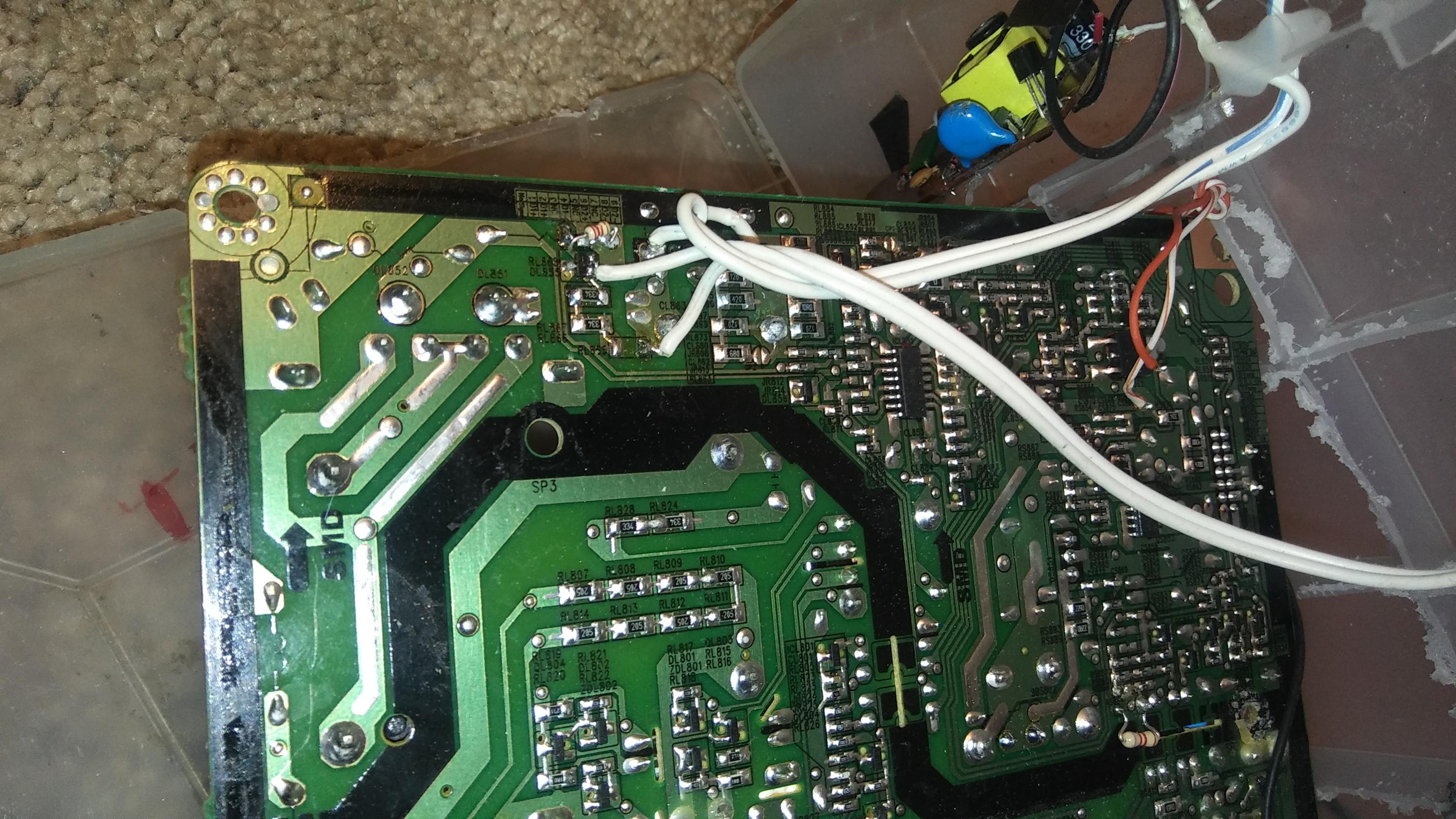

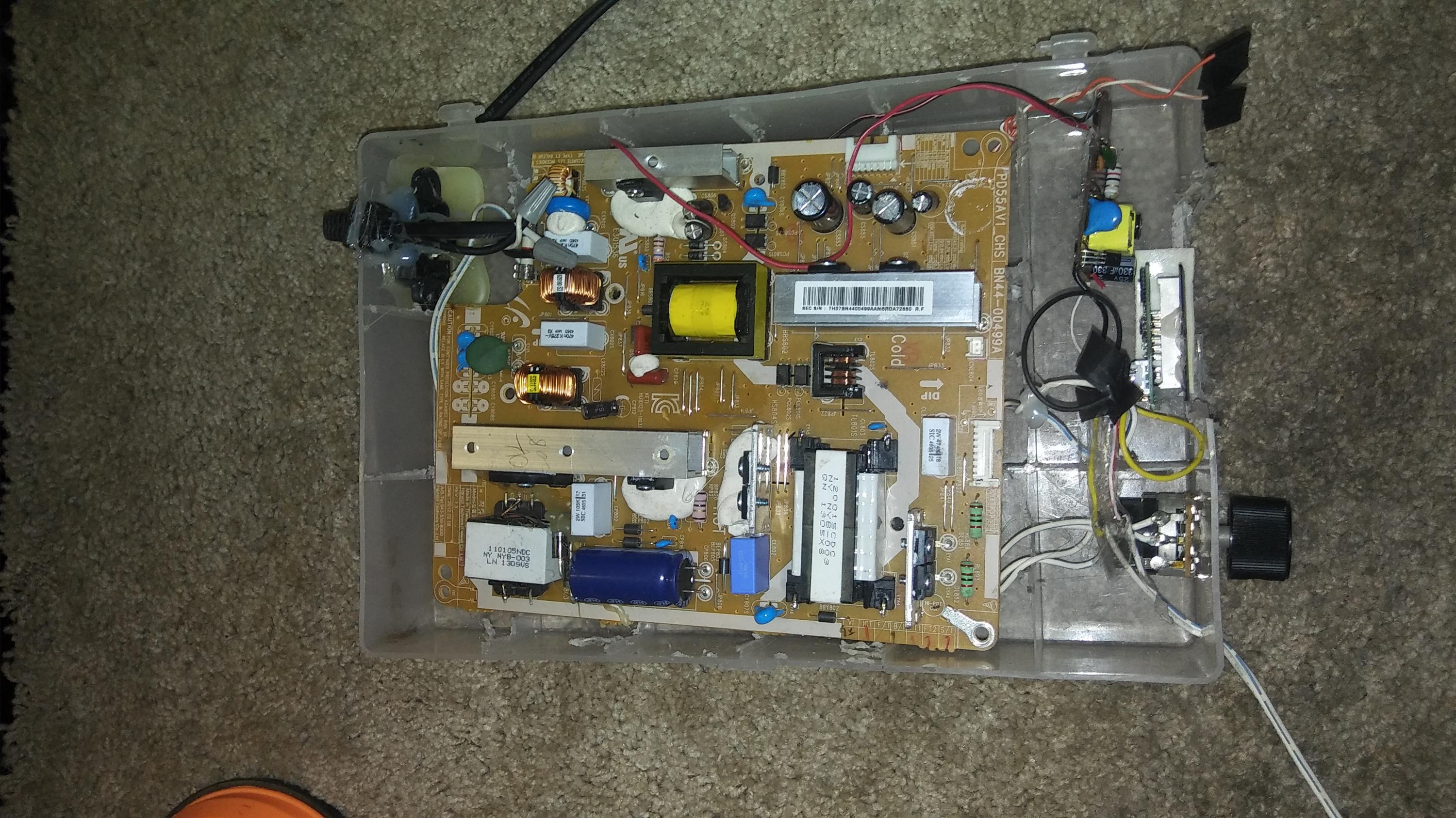

                          • capwizard
                            • Jun 2016
                            • 1991
                            Yes sir

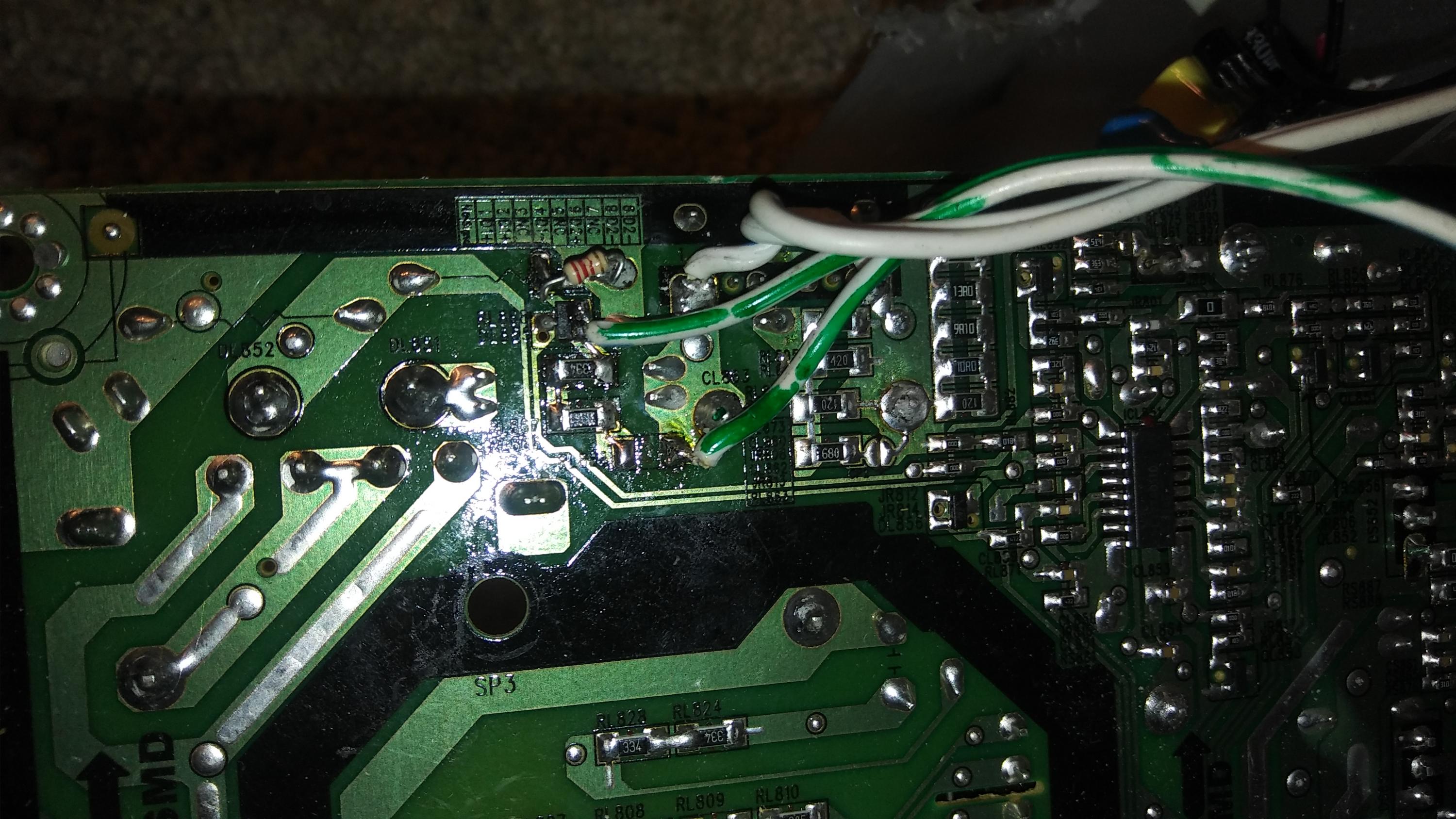

                            Just similar to TL431 I put a potentiometer to change the reference voltage. And then i have a variable, adjustable voltage power supply.
                            The green wires are connected to potentiometer. The other two white wires are for the output.
                            The other side of the power supply board. I changed 12 volt to 24 volt so I can use the T12 soldering iron. I connect a potentiometer to the tl431 after I found the value then I put a resistor over there. So LED screen tester and Power supply for solder iron.
                            Somehow the meter couldn't use the 5V inside the board so I have to use external 5V power supply. I put a USB charger to provide the 5v for the meter.
                            I set the high-voltage to 300v because more than that I begin to have a feeling to the high voltage.
                            Basically if you have any led tv power supply laying around. all you need is one resistor and one potentiometer then you have it.
                            Ps...The potentiometer I used is a 500K from light dimmer with switch.

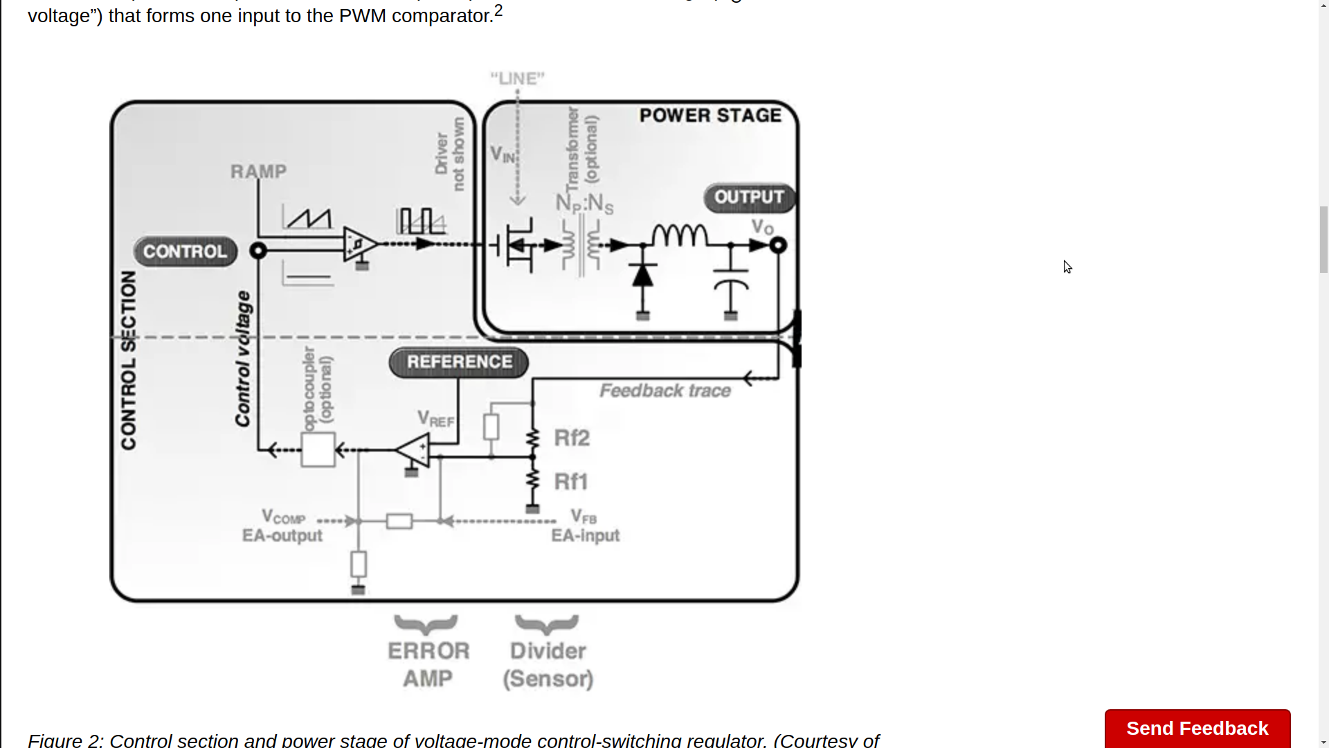

                              So it is CV supply, so how do you set/limit the LED current to be as specified?

                                it is one of original factory settings. current control was branch out, became very complicated.
                                it wont be too hard to convert current control to voltage control which i changed Rf2 to potentiometer and Rf2 to a resistor in the picture 1
                                  Dim control will vary the current through the LED or change the existing LED CC sensing circuit that the LED driver already has.
                                  That feedback in your circuit is for sensing the output Voltage so the feedback is used for maintaining the Voltage so it is Voltage control. you need to sense the current flowing through the load to maintain constant current.

                                    i knew that but it is very hard to find out cc sense circuits with no circuit diagram. 289ma at 331v was factory setting. 10ma current i used LR8 high voltage regulator to accomplish the job. if it has cc would be wonderful.
                                        Up load pictures of the board. You can also look for the LED driver IC psec and application notes so you can modify the circuit.
                                        BTW, how do you connect the LED to the power supply board, the Anode of the LED string to the Booted Voltage output pin and the Cathode to chassis GND? or L - return pin, that is important since the LED return circuit is not directly connected to GDN but through PWM Controlled MOSFET and current sensing resistor to maintain constant current through the LED's which your board is made for, low side (active element is on the return side of the circuit) constant current circuit.
