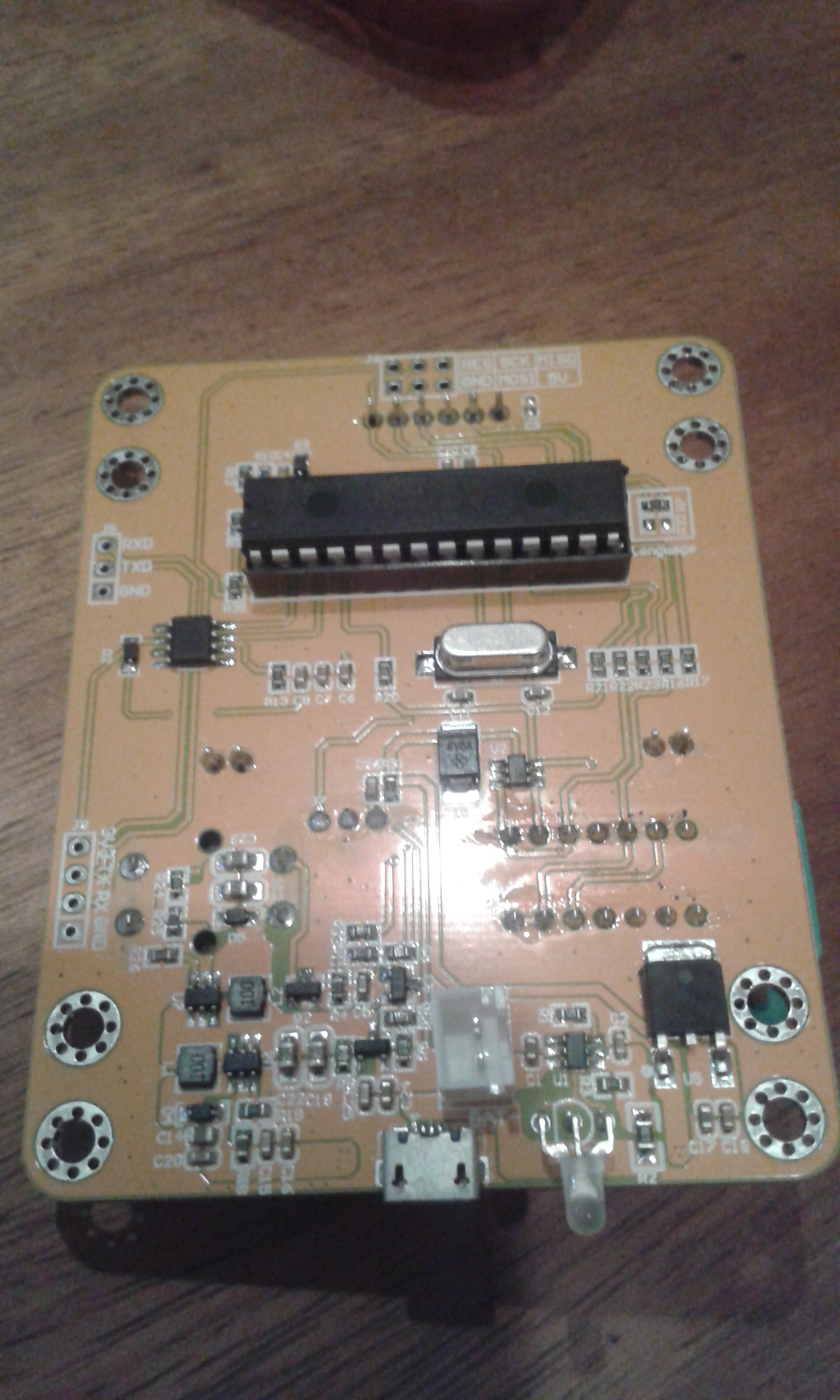

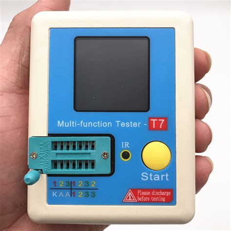

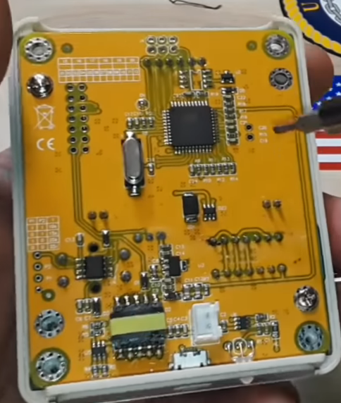

                      I've had one of the T7 testers for a few months now, which seems ok. The main gripe I have is that the clamp pins lose their grip a bit from constantly removing and inserting the test leads, so it would be a great improvement if it had individual sockets and pins for the three test leads. A mod which I'll probably end up doing.
                      Another observation is that there are at least two completely different testers on the market within identical casings, as can be seen in the photos. The 2nd one seems to be a better build, but how you can tell just from the front (pic 3) I couldn't tell you.
