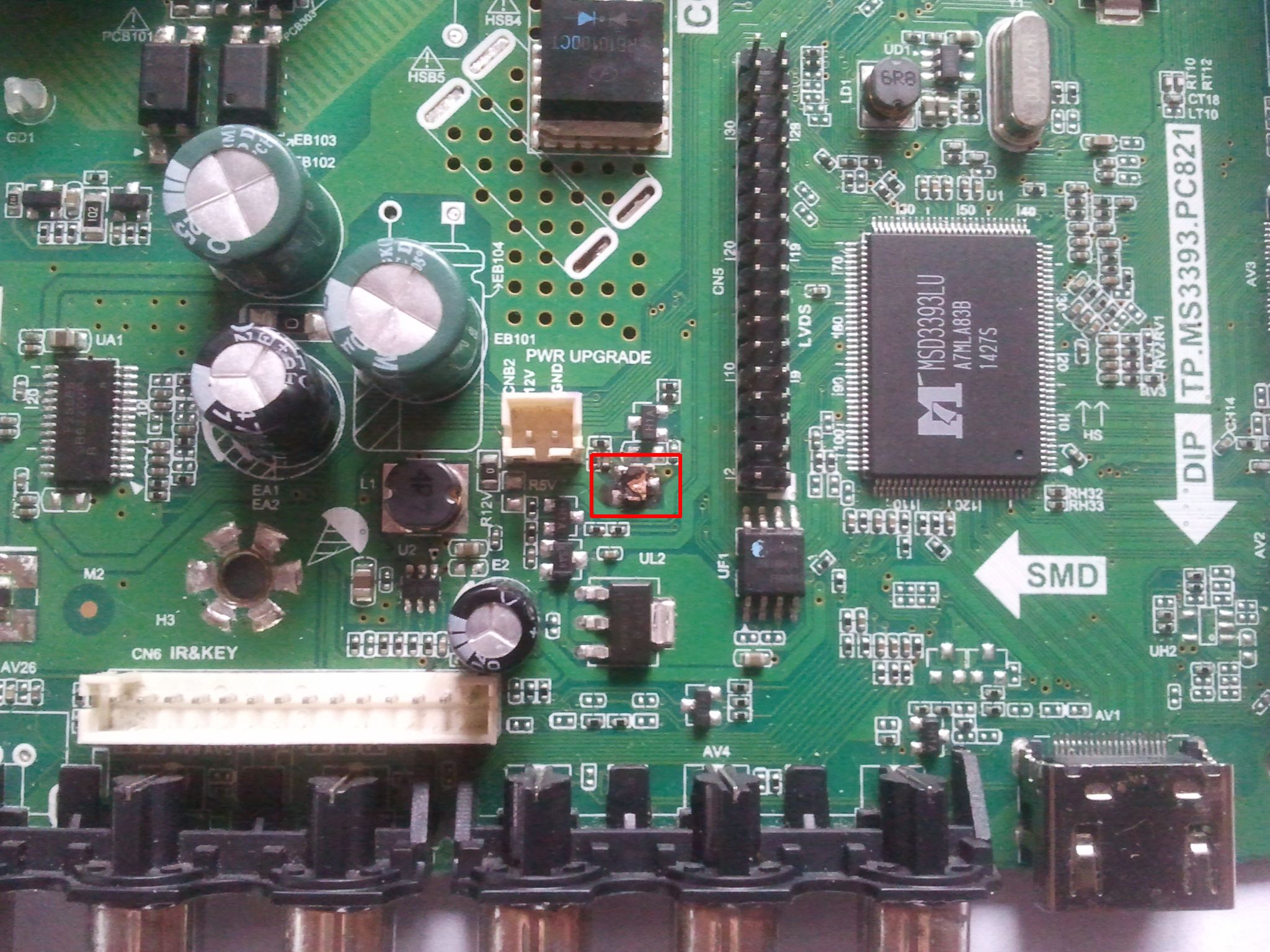

    Smd wp9f
    I would appreciate knowing where I can find the data sheet for SMD components WP9F and WP9U.
    The 3 terminal WP9F, SOT23 component is from a RCA / Proscan LED TV.

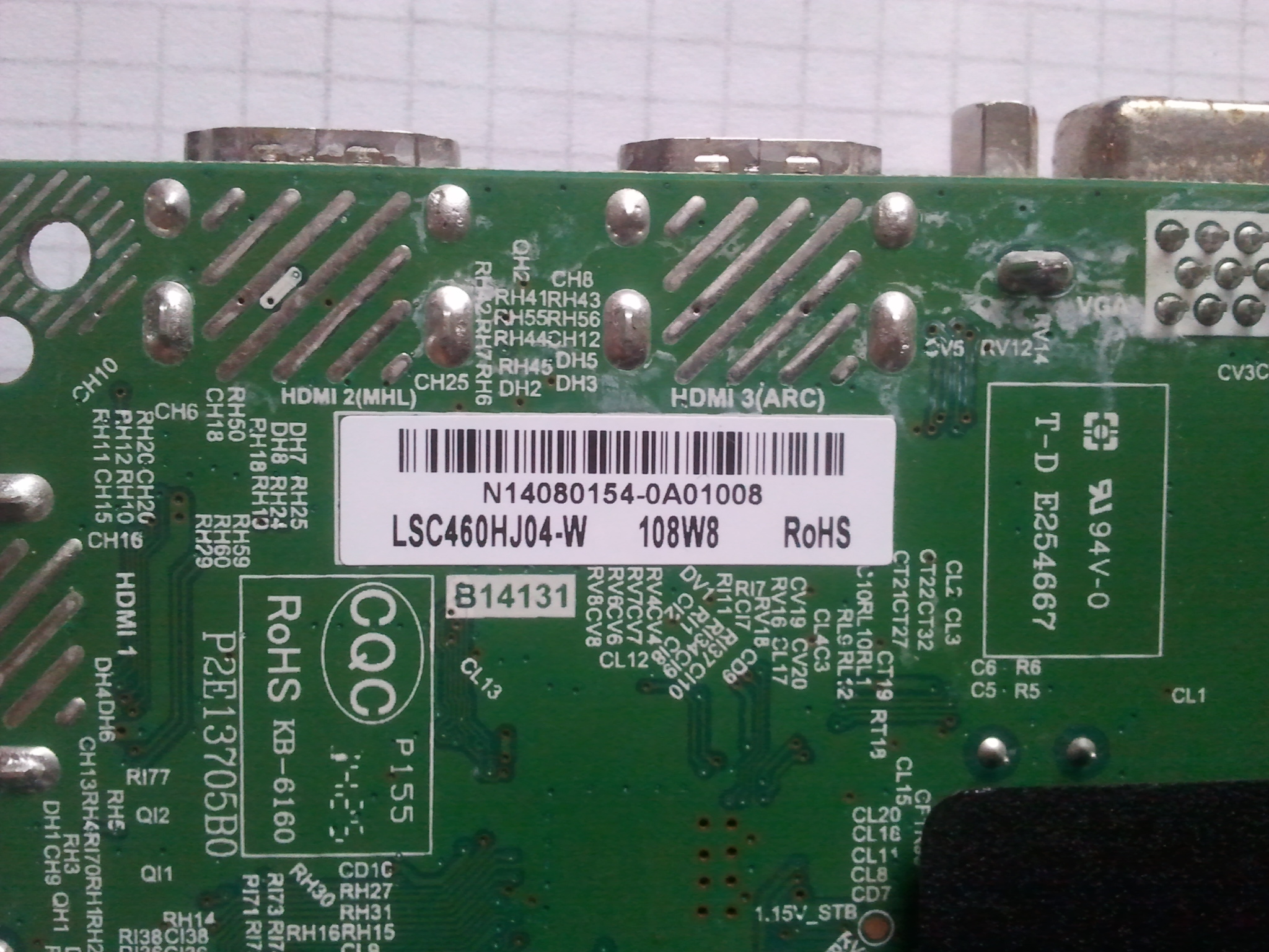

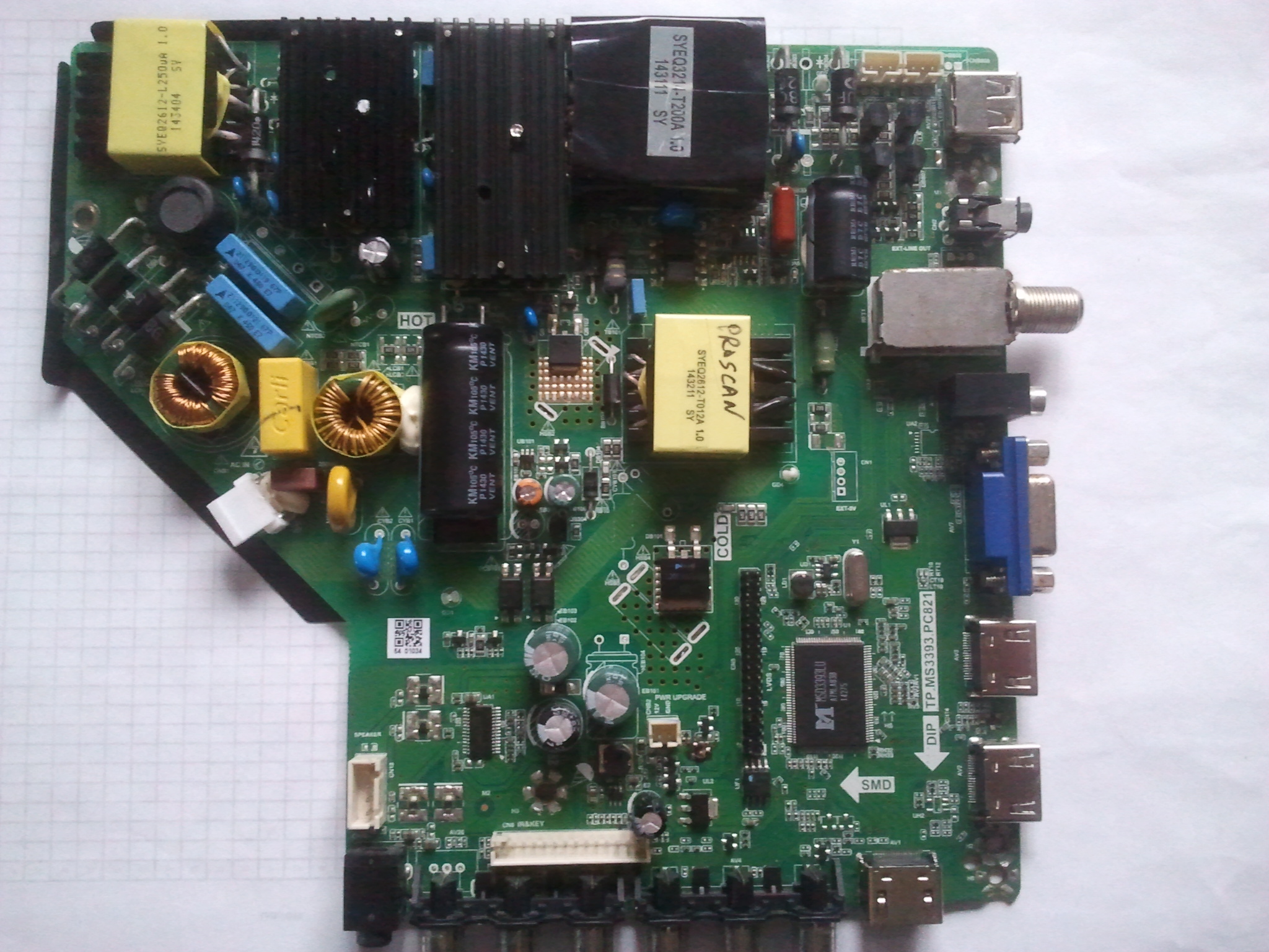

    can we see a high resolution pic of the board marked with the location where these supposed to be? Also the model number of the TV and board.
    • kodiac
      • Jul 2010
      • 116
      Re: Smd wp9f
      RCA N14080154 (LSC460HJ04-W) Main Board

          Re: Smd wp9f
          Yeah I am still around, just busy...
          let me guess... you don't have any panel power on that LVDS connector next to it, right? It is probably some lower power mosfet.

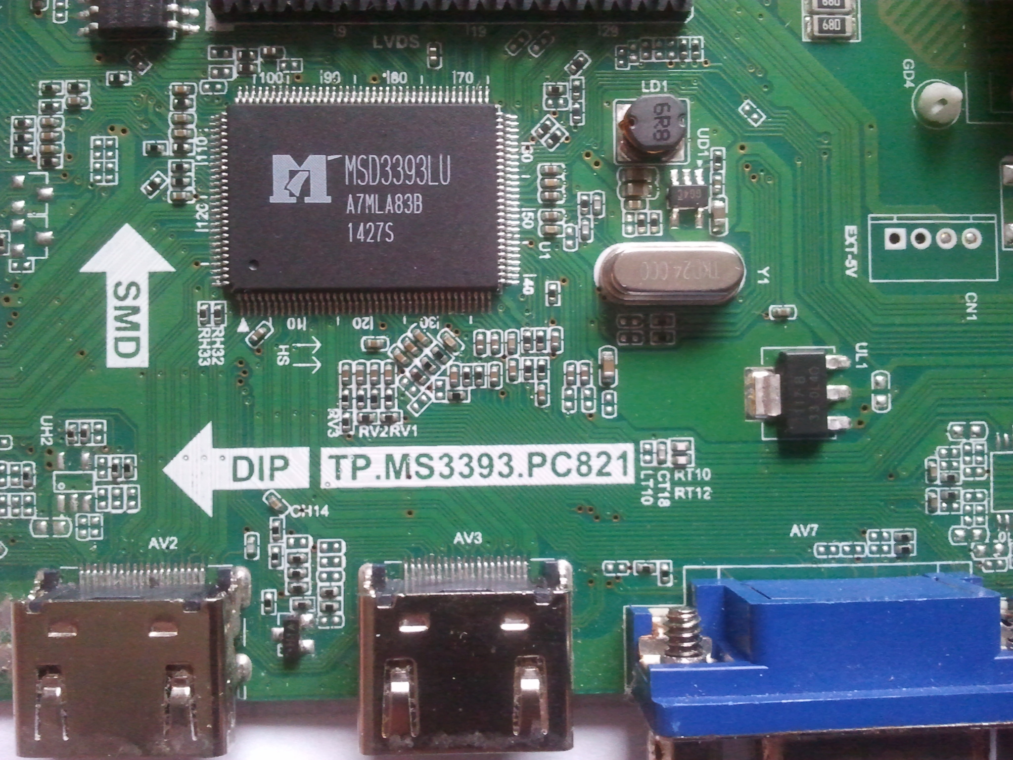

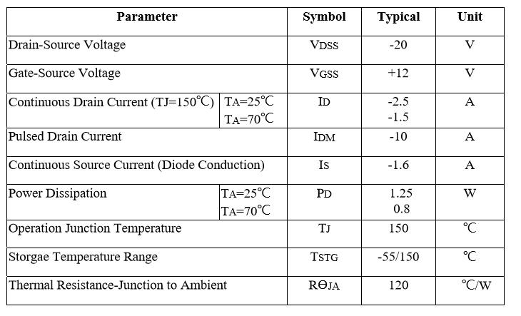

                Re: Smd wp9f
                That wp9 P-channel mosfet is a WPM3407C The (F) and (U) sorry, are the month codes
                The (H)1A is a MMBT3904 I believe (H) is the date code

                  Re: Smd wp9f
                  " you don't have any panel power on that LVDS connector next to it, right?"
                  Yes sir that is correct.
                  Thanks for all the information
                  All the WP9*'s are the same type of P-channel mosfet WPM3407C.
                  I replaced a WP9F with a WP9U and the WP9U overheated and burned up.
                  Thanks for confirming the WP9F and WP9U are the same type of p-channel mosfet.
