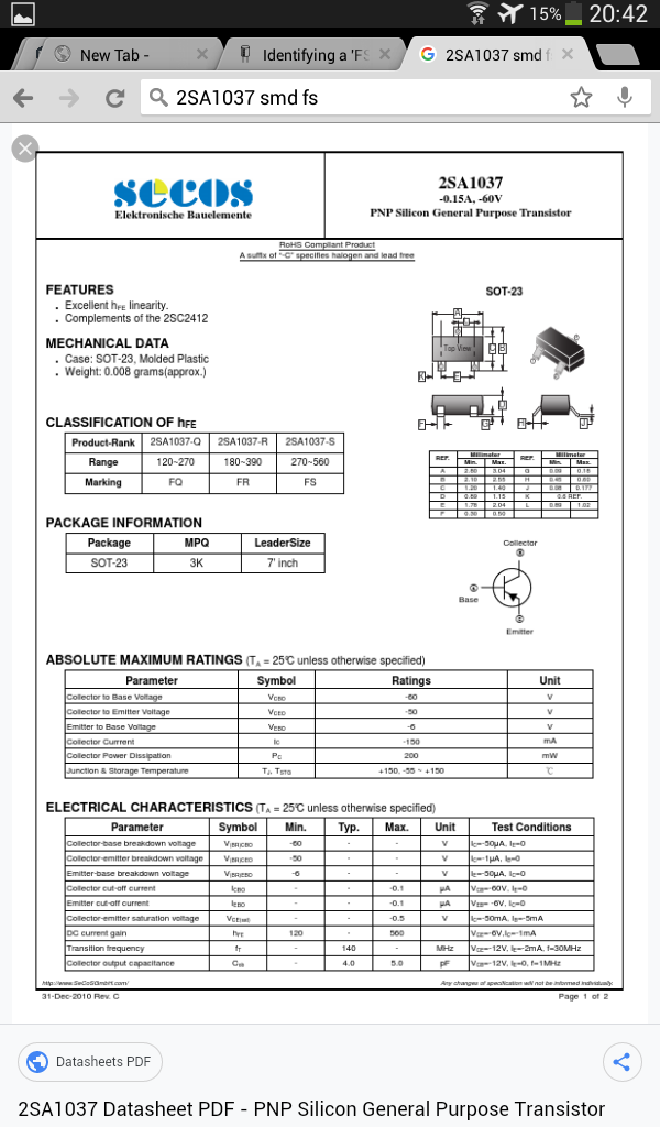

    I'm trying to repair a PCB that has some surface mount SOT23 devices that apear to be transistors but testing them on the board are giving confusing results.
    Its named FS45 but I can't find a datasheet that seems correct.
    The device is used in 10 places on the PCB. In 4 cases they appear to be controling triacs and the attached picture it shows it connected to a BT136 triac with the FS45 connected to the gate leg of the BT136.
    Can anyone identify the device and suggest an alternative?
    Many thanks.
    PS: I have a newer version of the board where the SOT23 devices are used in the same positions as the first board discribed but are different but equally hard to identify.
    I've attached 4 example pictures.

    2SA1037
    PNP general purpose transistor

      That's great. Many thanks for your help.

        Or maybe 2SA1576A.

          Too many candidates:
          http://markingcodes.com/search/c/ts
          http://markingcodes.com/search/c/fs
          https://pl.aliexpress.com/item/1005004756587472.html (photo of 2SA1037)
