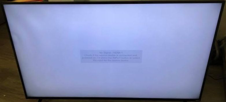

    Hello everyone, I have a shot at this TV and was wondering if anyone else thinks this is potentially a "Gamma Correction Chip" issue, or maybe something similar?
    Thanks everyone!

    Re: Vizio E65x-C2 question about Gamma
    Well (gulp) here it is in my living room and what the screen looks like with a picture on it.
    WOW that's bright!
    What do you all think?

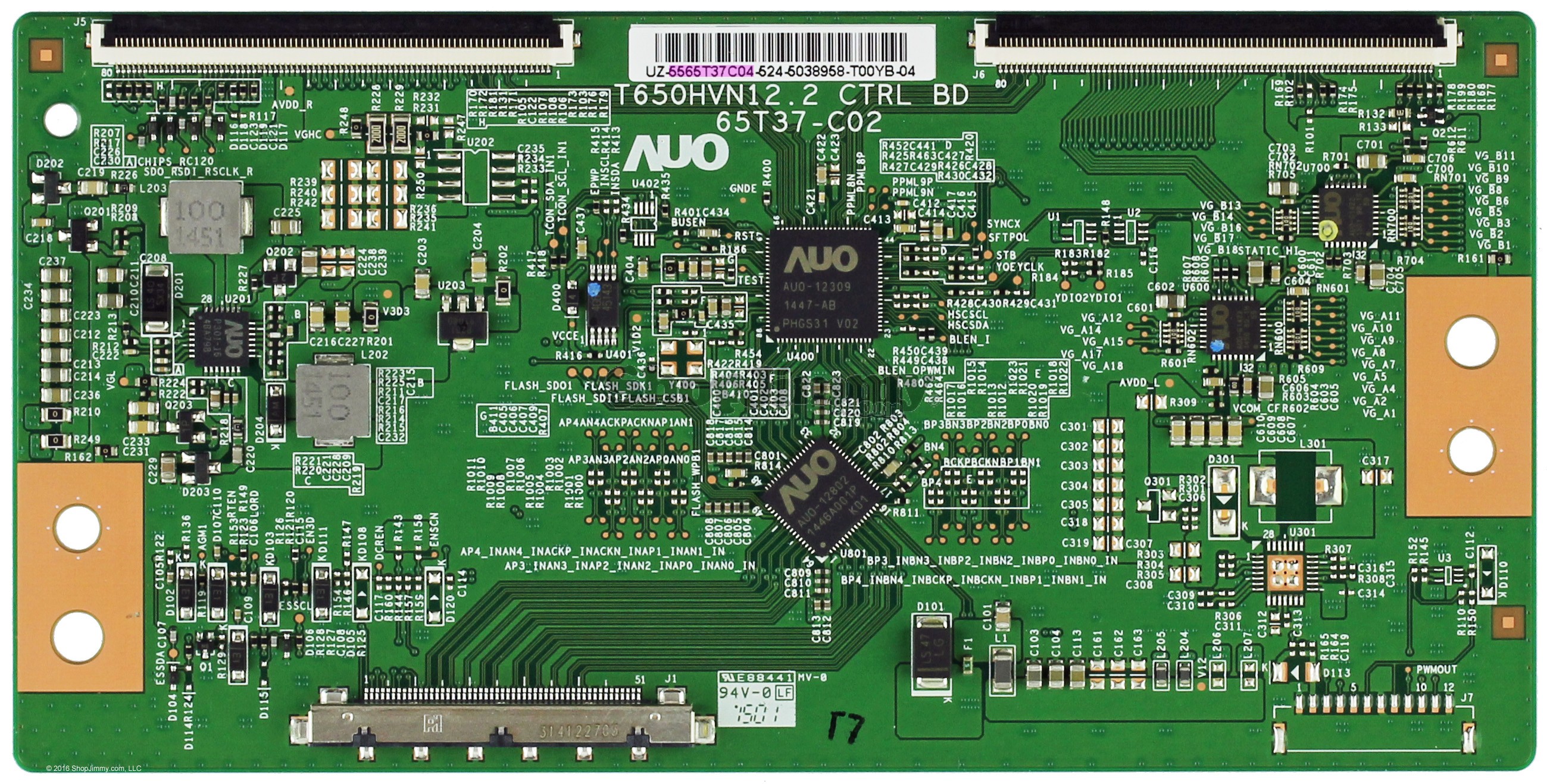

      How about the pictures of the T-CON board and some Gamma Voltage readings?
      What is the history of the TV?
      Hard to help with so little details information.
        I haven't opened it up yet, so I'll post this pic of the one choice of t-con from ShopJimmy and ask for instruction on test points to obtain gamma voltage readings. I'll check the voltages and post pics of the back of the TV at that time.

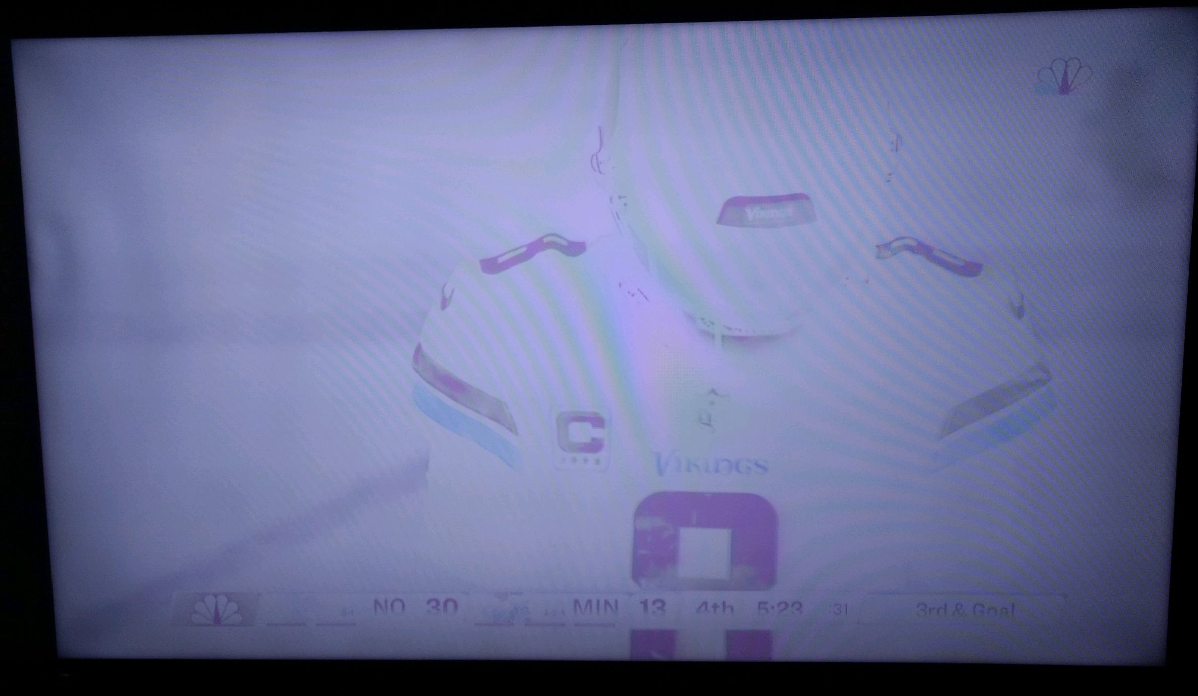

          Hasn't this tv been posted before? If you look at the corners, there is some darkness there plus the panel appears to have "waves" (left side). It appears to have had some led work done on it and maybe some of the layers aren't right.
            Hi Budwich, I suspect the same thing about LED work and the waviness, diffusion sheets bunched up behind the screen artifact. I searched the forum and found only one other post for this model TV and it wasn't this one.
            Still hoping for the test point locations and anticipated voltages to check the gamma chip.
              yes I found the other post, different set... same strange wave display. But if the layers aren't back properly, can the display show up like this "white out"?
                        Maybe that is just the way the Panel failures for these sets show up. To be certain, if it was my personal TV I would try a T-CON Bd to be absolutely certain

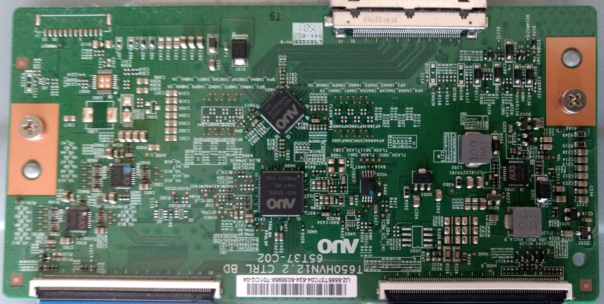

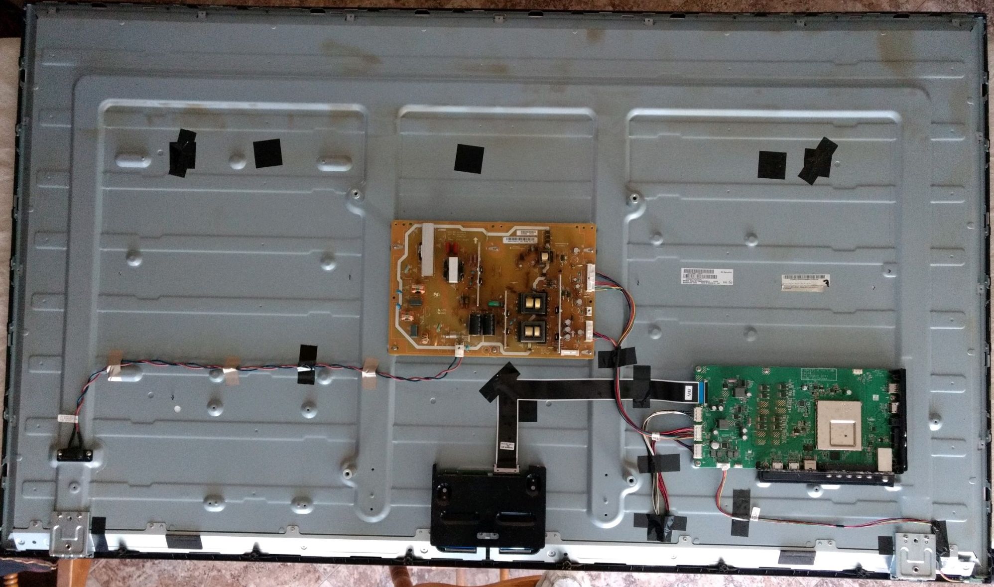

                            Board pix
                            Ok now I know a little more about this TV. First off, its pretty dusty in there, so it looks like its been a while since the back has been off, or whoever worked on it beforehand didn't clean anything. There are witness marks on the main board and trim bezel screws that show it's been apart previously.
                            It looks like the person I got it from was telling the truth when they said "they don't want to deal with it" and "didn't touch it". None of the dust inside looked like it was recently disturbed.
                            There are no obvious failures I can see on any of the boards, all of the cables are seated and all the board screws are tight.
                            Interestingly enough the main board itself is the same board in the Vizio E55-C2 I recently did a cap bypass on. Link: https://www.badcaps.net/forum/showth...ghlight=e55-c2
                            I'm now ready to test the Gamma voltages.

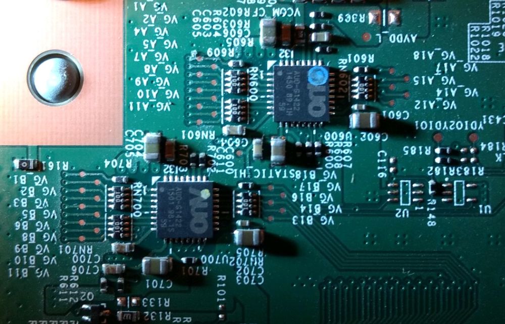

                              Guys, I don't know how to check the gamma voltage on this board. Does anyone have any service information for this? Thanks
                              They call me......."threadkiller"
                                U600, U700 look to be for GAMMA BUFFER IC's.
                                What is the P/N as printed on top of the IC'S?
                                VG_A*, VG_B* test points look to be for GAMMA Voltages but we cannot tell until we verify the P/N of the IC's.
                                • DXseekerMO
                                  • Feb 2018
                                  • 1119
                                  • US
                                  budm, here's the numbers:
                                  U600:
                                  AUO-G1422
                                  1450 89.14
                                  59
                                  U700:
                                  AUO-G1422
                                  1501 98.15
                                  59
                                  Since there are two, is one for the right side of the panel one for the left?
                                    So far no luck finding the spec sheet.
                                        Since you are "thinking gamma", you could just do some "blind measuring" with hopes of seeing some "pattern" on the pins.
