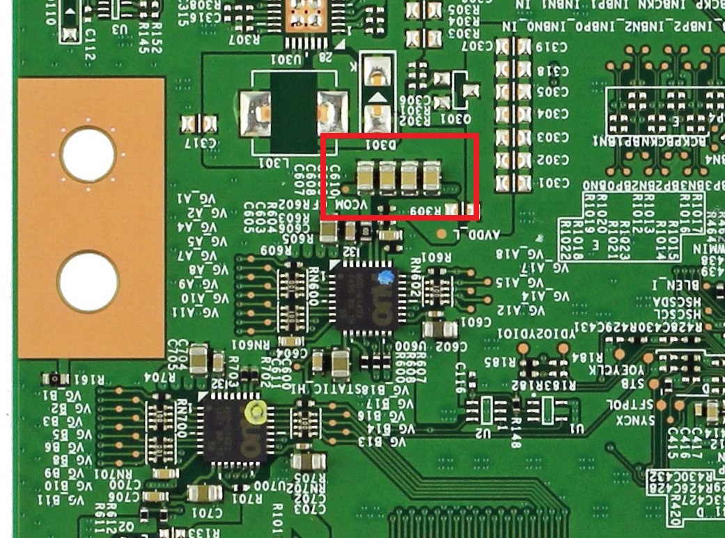

            Re: Vizio E65x-C2 question about Gamma
            Thanks for the link budm. I thought I would go ahead and post the voltages from the VG_A and VG_B test points plus a few others, just in case someone might see something.
            VG_A1…..11.21 VG_B1…..14.37
            VG_A2…..11.06 VG_B2…..12.32
            VG_A4…..11.00 VG_B3…..11.71
            VG_A5…..10.98 VG_B5…..10.67
            VG_A7…..10.96 VG_B6…..10.49
            VG_A8…..10.94 VG_B8…..10.07
            VG_A9…..7.76 VG_B9…..8.35
            VG_A10…7.70 VG_B10…7.18
            VG_A11…4.39 VG_B11…5.44
            VG_A12…4.37 VG_B13…5.00
            VG_A14…4.34 VG_B14…4.34
            VG_A15…4.32 VG_B16…3.55
            VG_A17…4.23 VG_B17…4.24
            VG_A18…4.03 VG_B18…0.41
            AVDD_L……...15.58
            STATIC_HI…..15.32
            VCOM…………0
            AVDD_R………15.59
            When I look at the pattern here it appears VG_B1 VG_B2 and VG_B18 do not follow. The others are fairly close to one another. The only other question is VCOM at zero volts, I verified it three times.
              Those Voltages look to be really close to each other, I.E. A2-A4, A5 ~ A8, etc.
              VCOM…………0V: That is not right. If you at some of the Voltages as reported in that link, Vcom should not be 0V.
              Are you able to find VGL (Minus Voltage supply)?

                    #29
                    Verified no volts at VCOM again. VGL tested at -6.97v. Sounds in range with what you said.
                      And if I'm properly reading this info I just found, missing VCOM voltage should equal no picture displayed on the screen? I also read that VCOM is related to contrast and this voltage is part of the gamma correction circuit?
                      This makes me wonder if something on the display is loading the t-con and mis-directing the VCOM voltage?
                        I just put that theory to the test, unhooked both FFC cables from the t-con to the panel and VCOM is still absent. While I was at it I re-installed one FFC, turned it on and that side was gamma'd out.

                          SIGNIFICANT find!
                          The area outlined in the picture below is a bank of SMD caps right off the VCOM test point. When continuity testing across all of these caps they indicate short, .006 ohms. Furthermore there is identical continuity from the VCOM test point to chassis ground.
                          Other SMD caps in the area do not test short.
                          So I'm guessing one or more of those SMD caps in that bank are shorted and re-directing VCOM to chassis ground?
                          Does this sound reasonable?
                          Last edited by DXseekerMO; 10-31-2018, 12:24 AM. Reason: Forgot pic and aint got no good english

                            Vcom at 0V is your problem. No Vcom = low level contrast. If you can get a replacement T-CON Bd that is working your problem will be solved.

                                  Re: SIGNIFICANT find!
                                  Yes, it can be one or more of those MLCC which are connected in parallel has shorted out, you can remove them one at a time to see if the shorts will go away, nothing to lose at this point.
                                    So this afternoon I removed the T-CON board to have a closer look at the caps in that bank. The visual inspection showed nothing obvious, no burn marks or arcing, they look normal, so like the good auto tech I was trained to be I "checked to make sure the problem still exists before continuing" and did an ohms check on VCOM with it out of the TV...and the short is gone.
                                    My half-second of glee was immediately replaced by "oh s***, so now what else is shorted...and where". I re-installed the T-CON but with nothing hooked up, no short. I hooked up the cable from the main board, re-test, no short, but when I hook the FFC cables up from the source driver boards, either side, VCOM tests short.
                                    Looks like I've isolated the problem to the panel.
