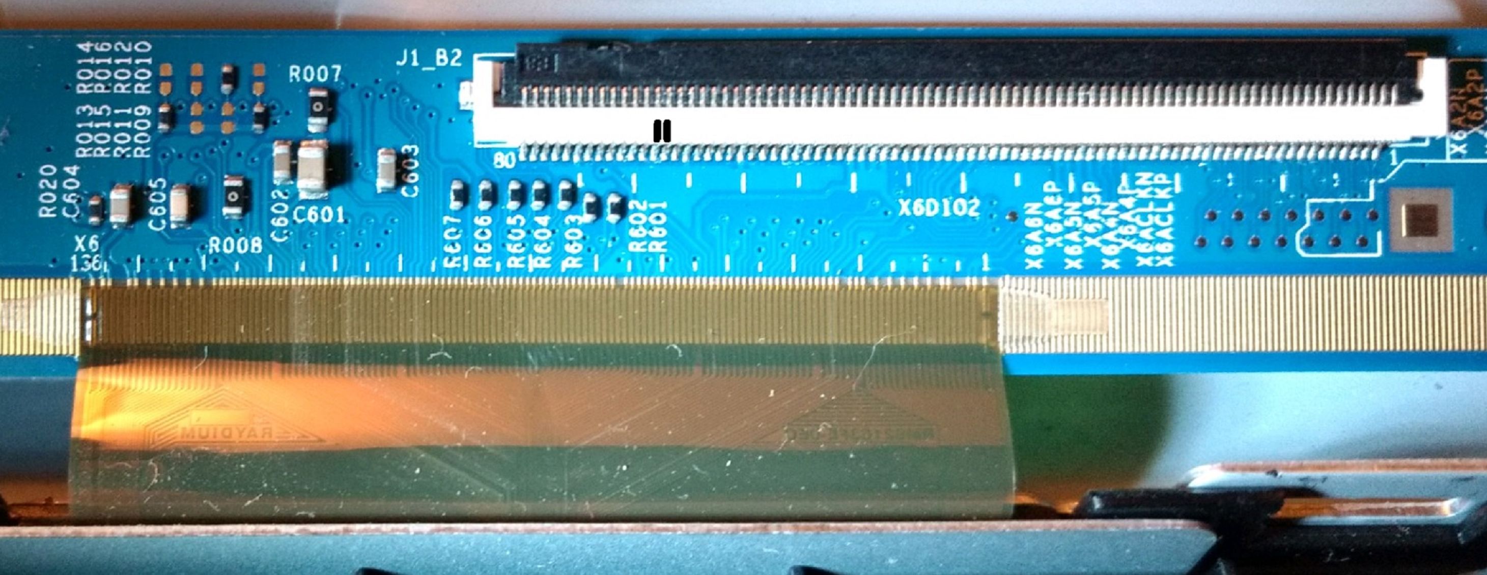

    Maybe the end of the road

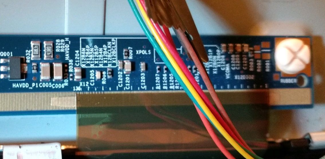

    I removed the source driver board covers (such fun) so I could take a closer look. I came up with a divide and test strategy starting with all cables hooked up, testing at the t-con VCOM test point
    First I detached the left driver board from the left center driver board, short still exists
    Next I detached the right driver board from the right center driver board, short still exists
    Next I detached the left FFC cable from the t-con, short still exists
    Next I re-attached the left FFC cable and detached the right, short still exists
    Lastly I detached the left FFC cable from the t-con, open line.
    Budm, I have concluded for a short to exist in the fashion tested does indicate a failed panel, namely a short somewhere upon the panel in the VCOM circuit. Would you draw the same conclusion?

      A further re-check of VCOM voltage at the t-con, FFC's unhooked reveals about 6.8v
      This TV was pronounced dead at 16:20 hours, on this thirty first day of October 2018 from an apparent short upon the panel itself, namely in the VCOM circuit.
      If anyone thinks I'm missing something please let me know, but the short is too common to not be the panel. I can't isolate it any further, methinks.

        perhaps so... but you should be able to trace the vcom circuit going to the bottom edge boards and perhaps find any bad capacitors that might be replaceable.

          Right on...I am finding VCOM A and B test points on the buffer boards but nothing marked VCOM by itself. I'll keep looking and test from there.

              you know where the vcom test point is on the tcon.... measure / meter trace it to the tcon / panel cable... count the pins and look on the driver boards there after.

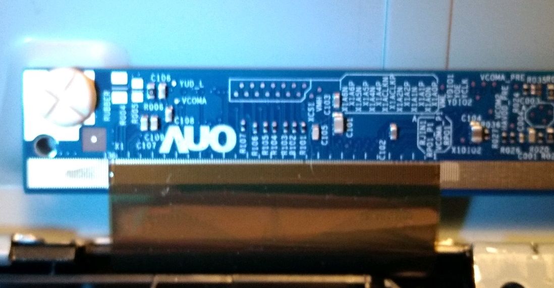

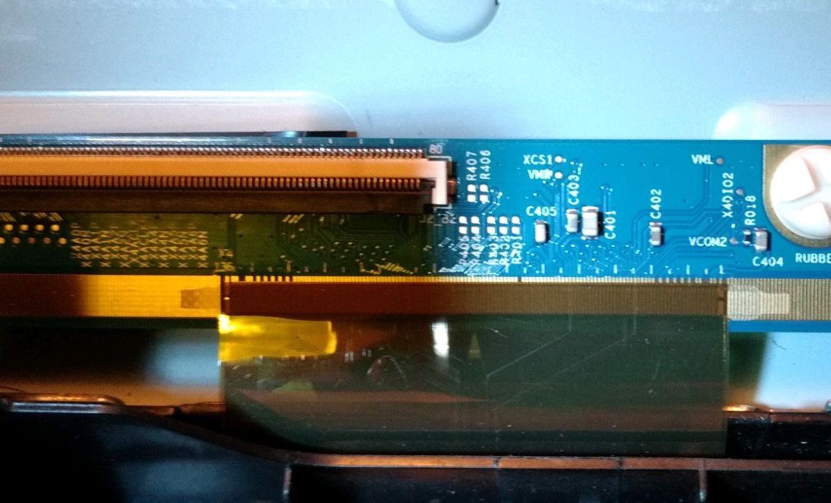

                #47
                Re: Vizio E65x-C2 question about Gamma
                OK the trace associated with VCOM appears to have 2 caps in circuit on the left driver board marked C104 and C304 and 2 caps marked C404 and C604 on the left center driver board. Likewise the VCOM circuit on the right center driver board has caps marked C704 and C904 and C1004 and C1204 on the right driver board.
                All of these caps listed above indicate short. Furthermore it appears none of the other caps on any of the driver boards test short.
                There are long and short hash marks near each of the driver tabs that appear to relate to long and short hash marks at the FFC connector.
                Since this is a common circuit, if one of these caps is shorted it will make them all appear shorted because they all use the same circuit in the panel?
                If so, it looks like I'm removing each of these caps until the short goes away? If I have to remove all of them to clear the short then the panel itself is shorted?

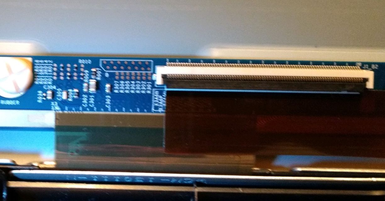

                  before you get "soldery", isolate the bottom driver boards by disconnecting the interconnecting ribbon between them, then check the caps again. Likely you don't have to worry about the outer boards / drivers... hopefully.
                  further, in your first picture, c101 and c104 seem offset possibly... not sure if that would cause any issue but maybe if they aren't making good connection, then it might have "strained" other caps in the "parallel" to take more current than expected.... or something like that ... :-)

                    The testing for shorted caps was done with the interconnecting ribbons detached.

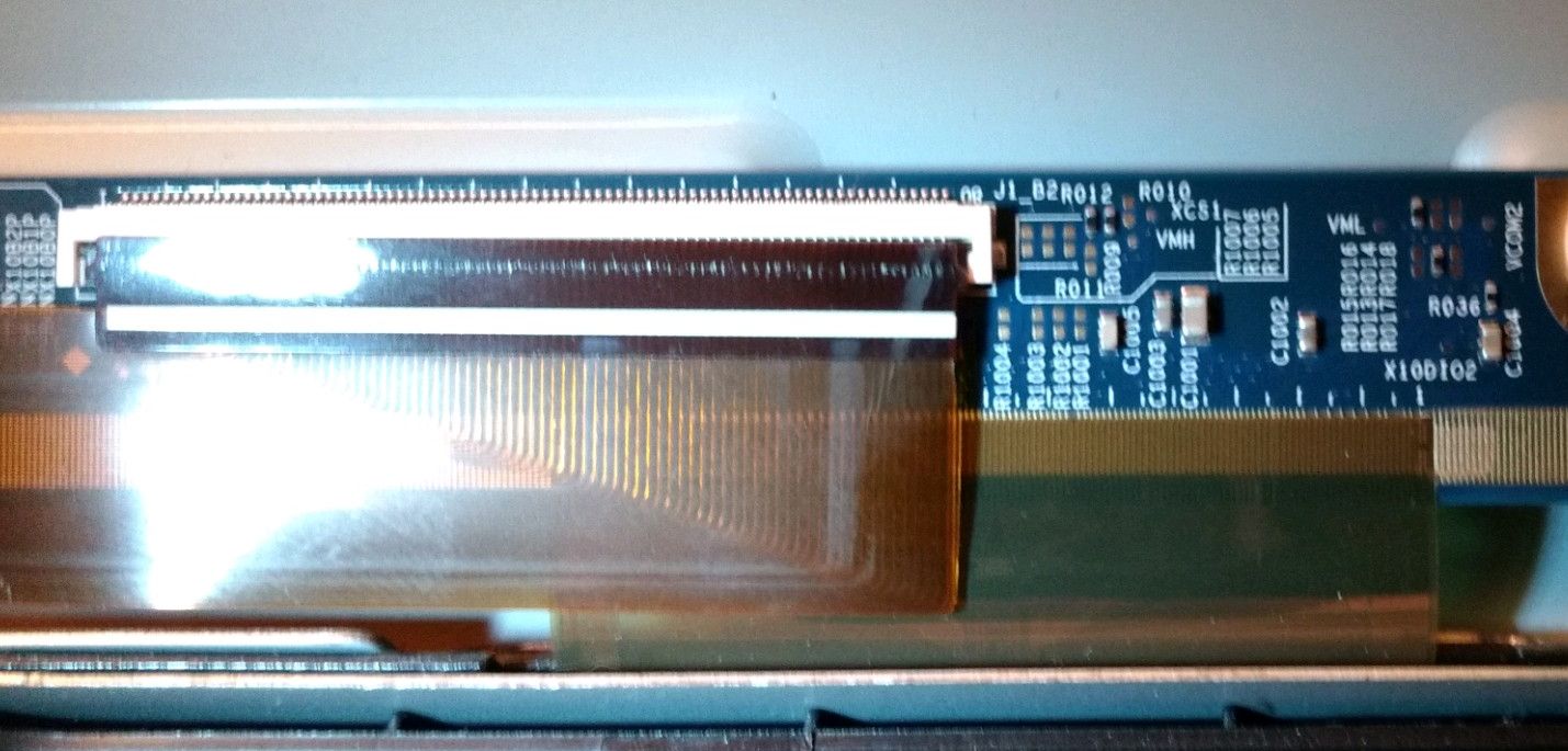

                          #52
                          maybe... but picture 2 shows the cable still installed.

                            #53
                            Good catch, the ribbon cable is detached from the other board.

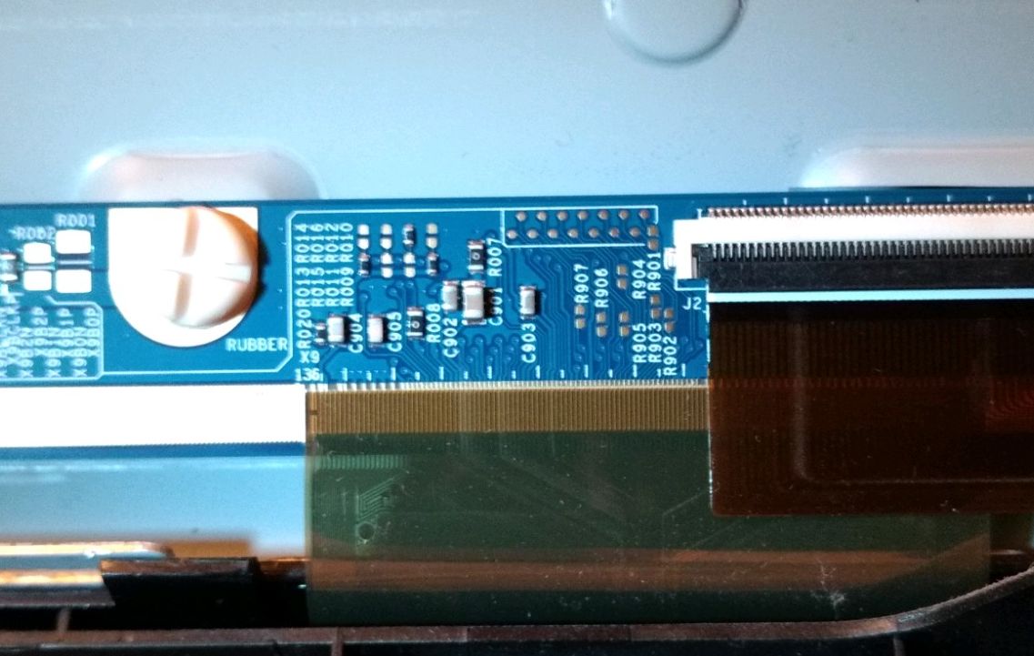

                                  #56
                                  VCOM no longer shorted directly to ground????
                                  After more testing something interesting has happened. VCOM is no longer directly shorted to ground....and neither are those capacitors.
                                  I noticed this change of state while testing a few more things, so I hooked up both FFC's one at a time and tested at the t-con VCOM test point, reference chassis ground as before and the reading is now 586 ohms. Furthermore, when I test the caps referenced earlier one side is direct to ground and the other is also now 586 ohms.
                                  This change of state with good working equipment has to eliminate those caps as suspect since they all changed state and now read the same. The only thing I can think of is by probing those IC's, maybe the low current/voltage caused the IC to change state?
                                  I am 100% sure my test equipment is working right, and I am 100% certain VCOM was once reading direct short to ground. I'm also 100% sure those caps were reading shorted too, and I am clueless as to how this happened!

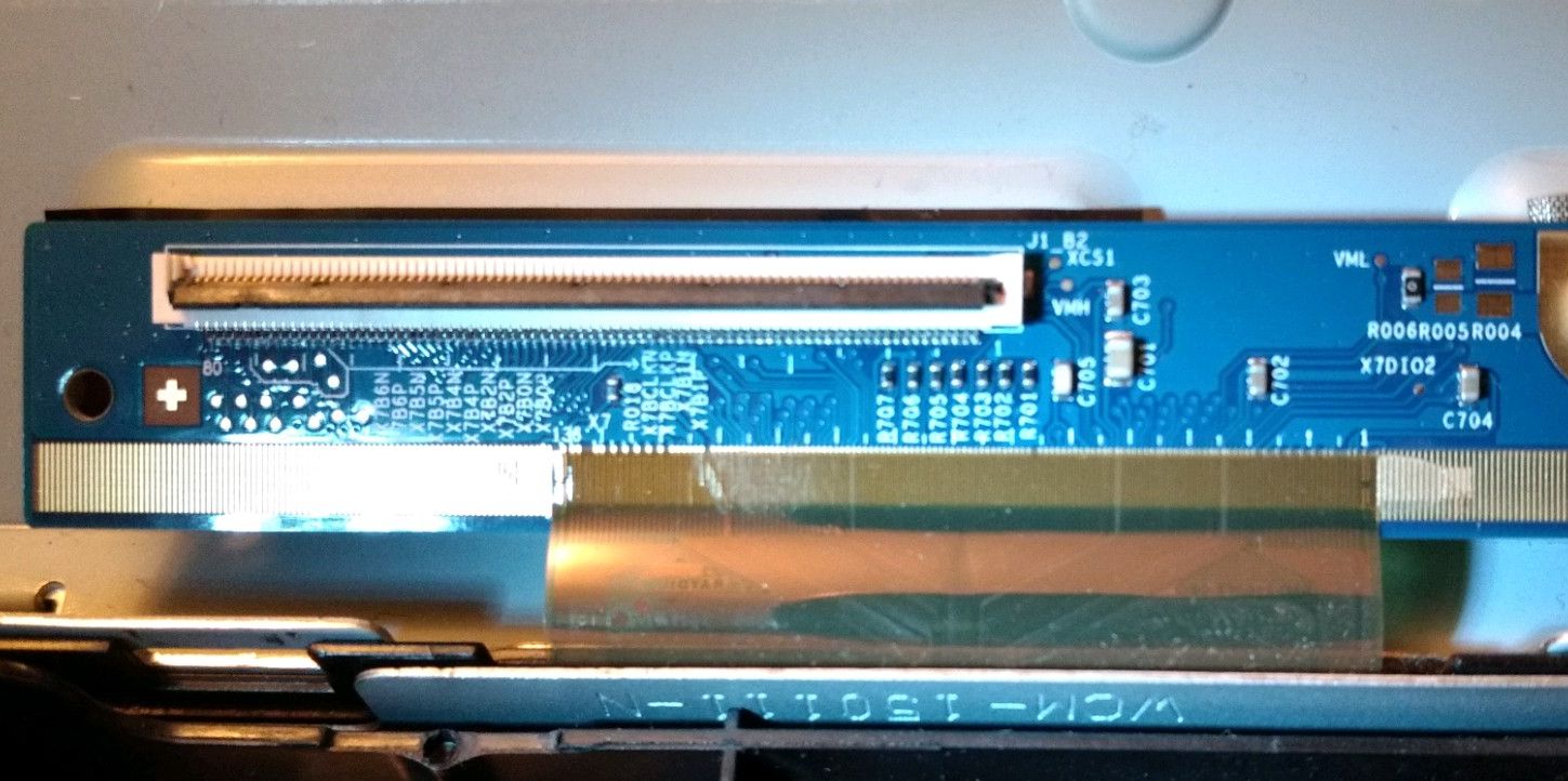

                                    #57
                                    Narrowed down to the right source driver board
                                    I went back to re-check my readings and now something else has come to light. When I press on the right (outer) source driver board the amount of resistance at VCOM changes. When I repeat the test on the other 3 boards the resistance does not change. Any flexing of that board in any place causes fluctuations in the VCOM resistance reading. All of the previously mentioned caps on all boards change resistance as well. That means they are all good, maybe save for the XR2 board.
