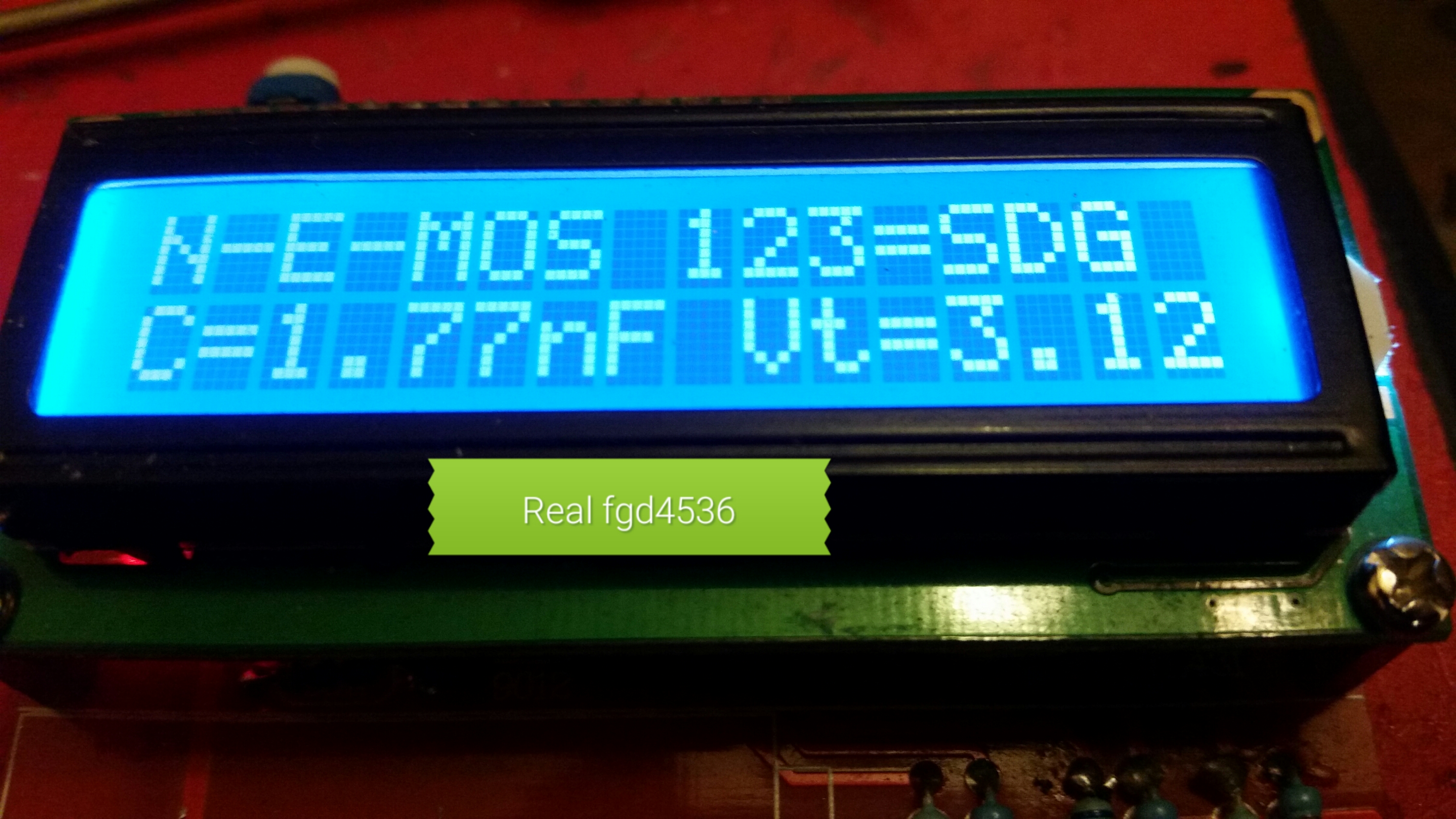

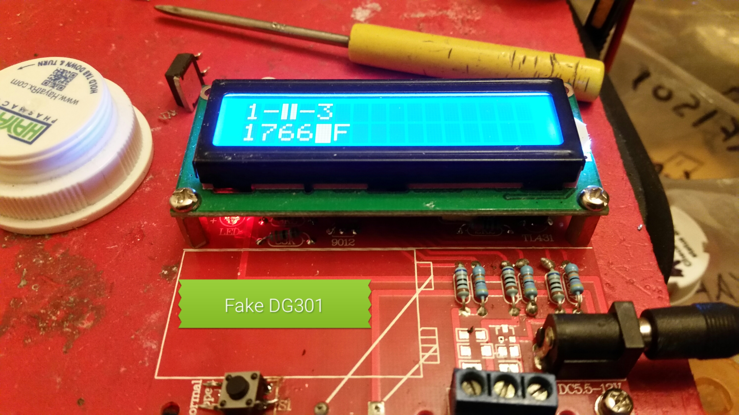

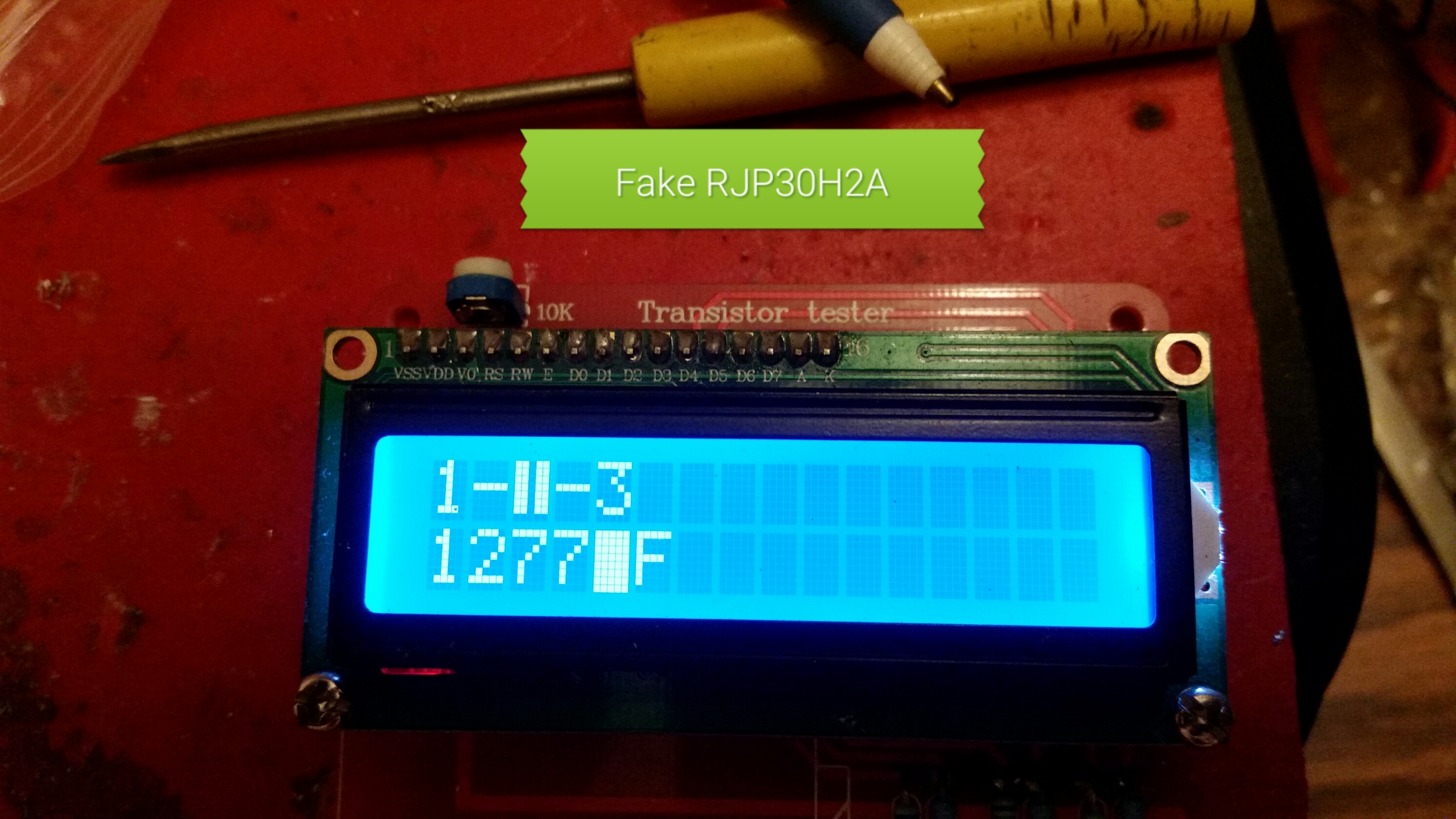

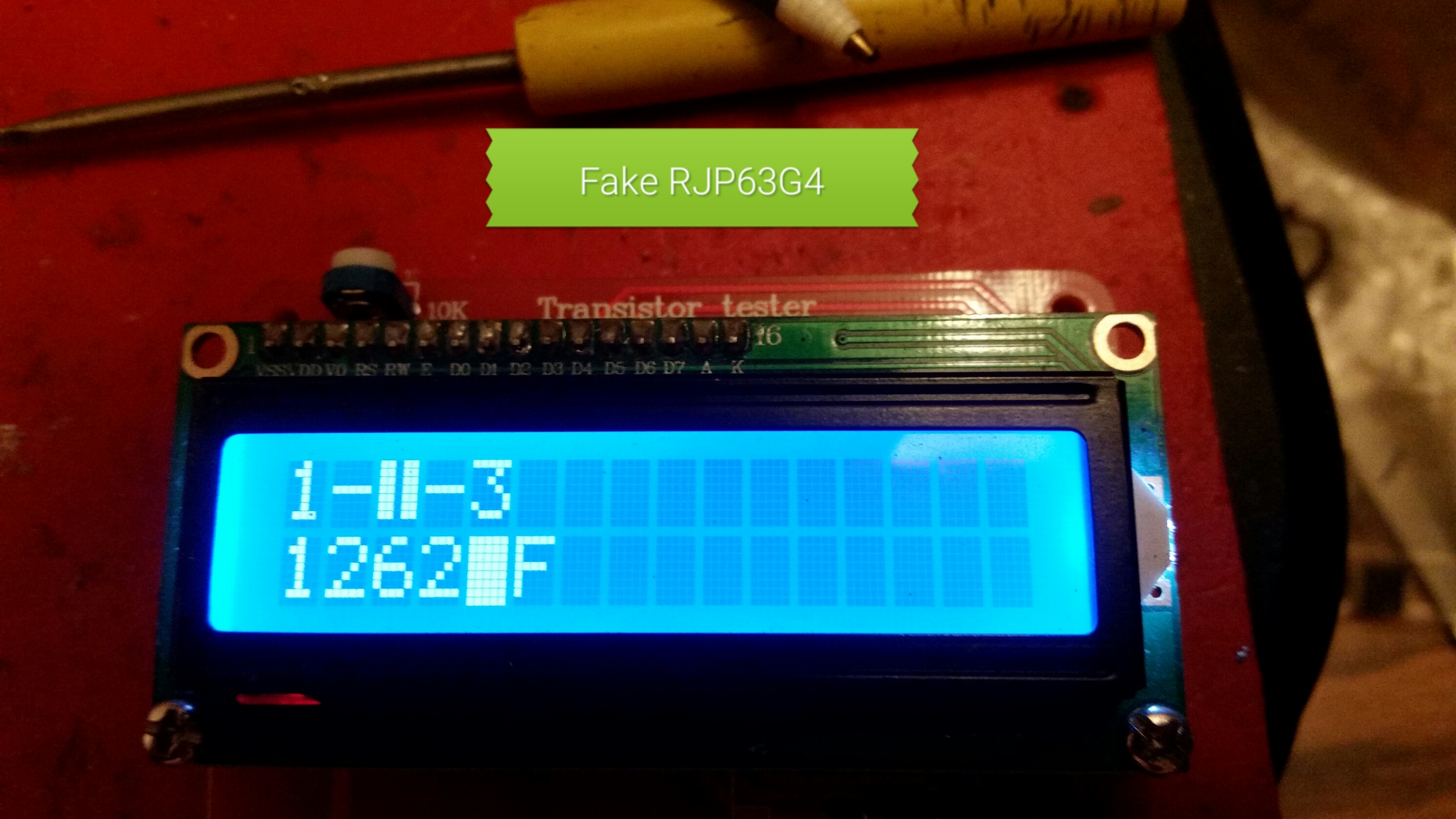

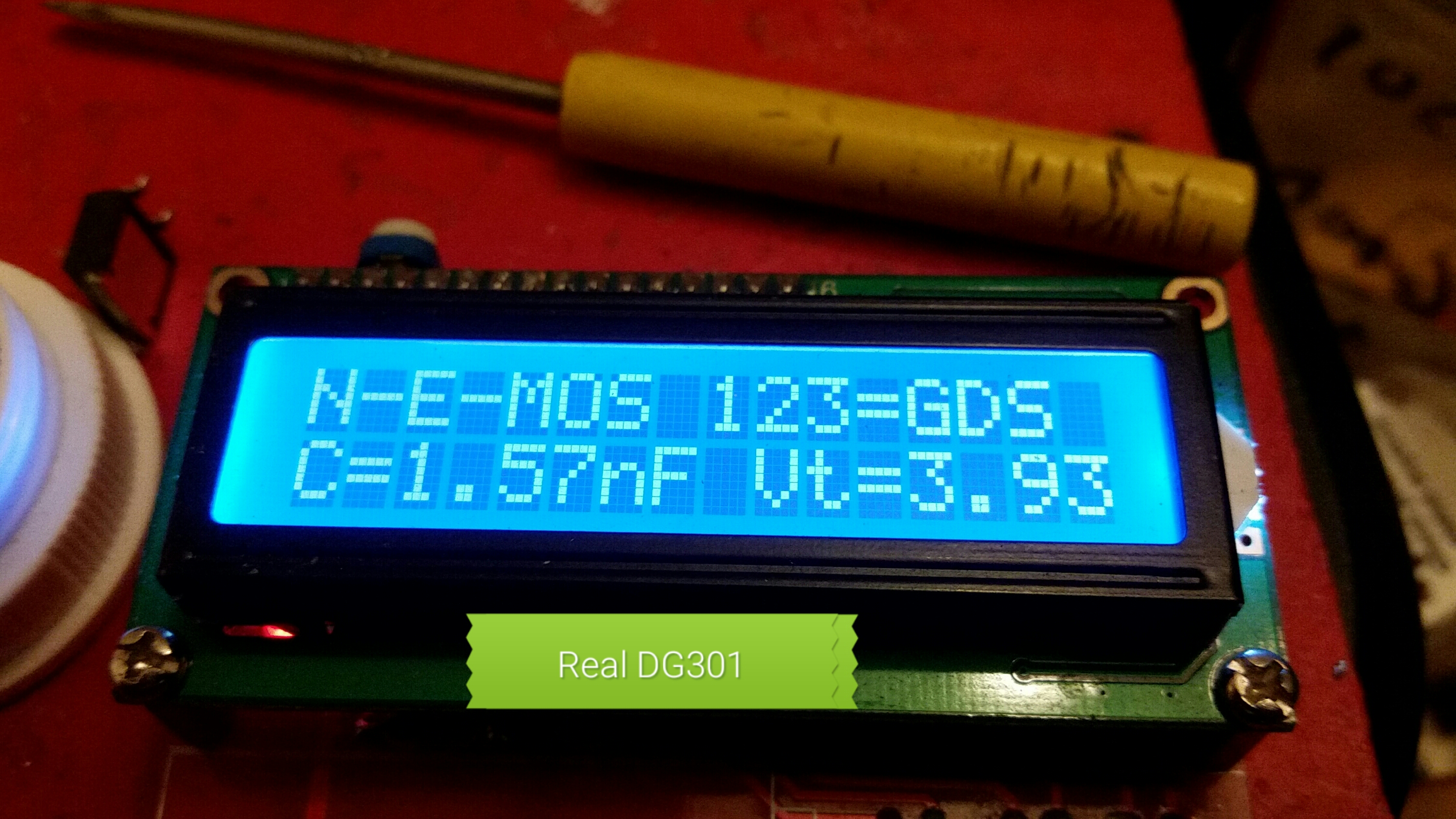

    I have a cheap "put it together yourself " transistor tester. It is an E.S.R. meter also.
    On it a bad igbt will read as a capacitor. I have also had a few that read only as a resistor. Here is a few pics of good and bad parts.
