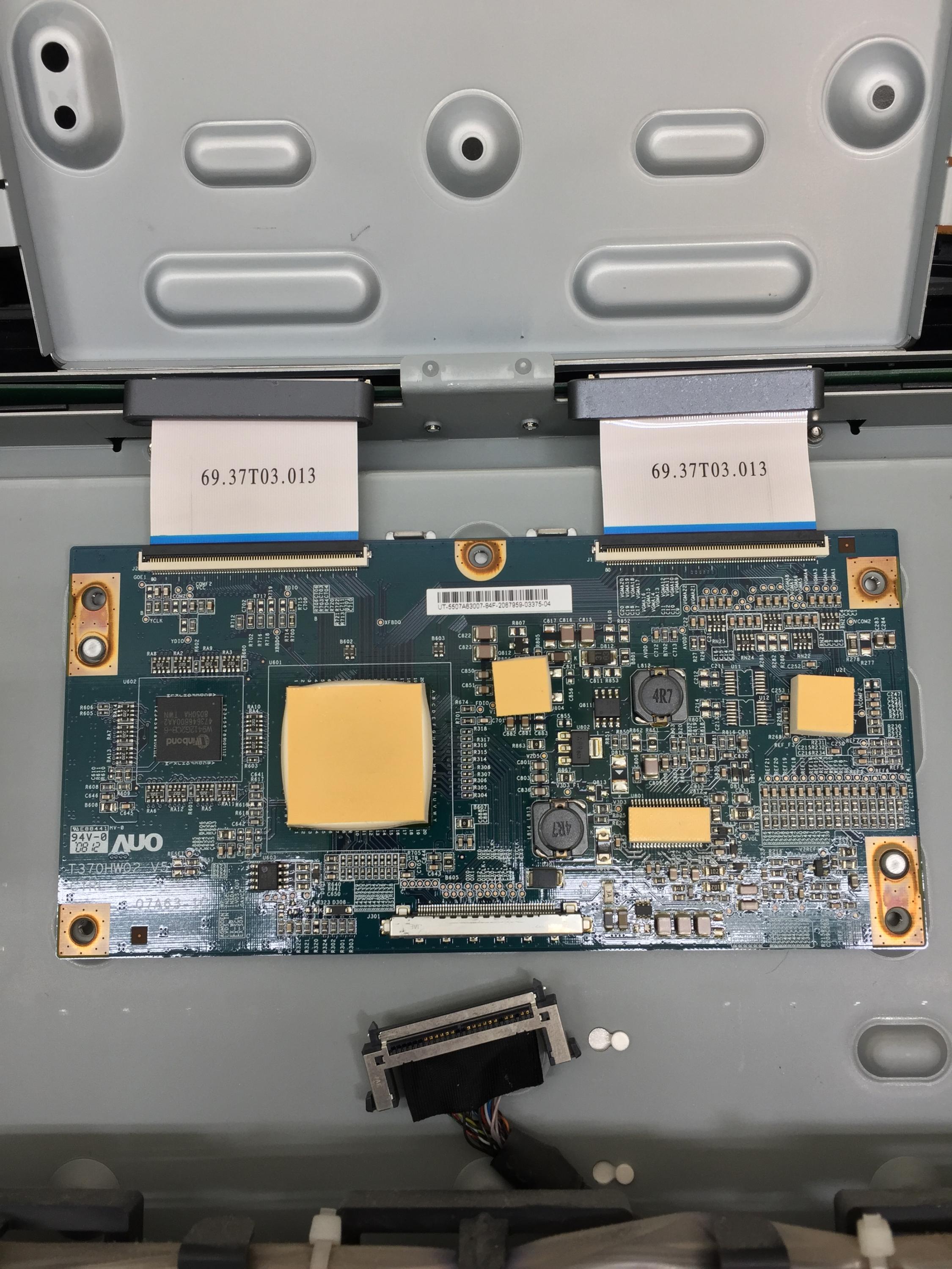

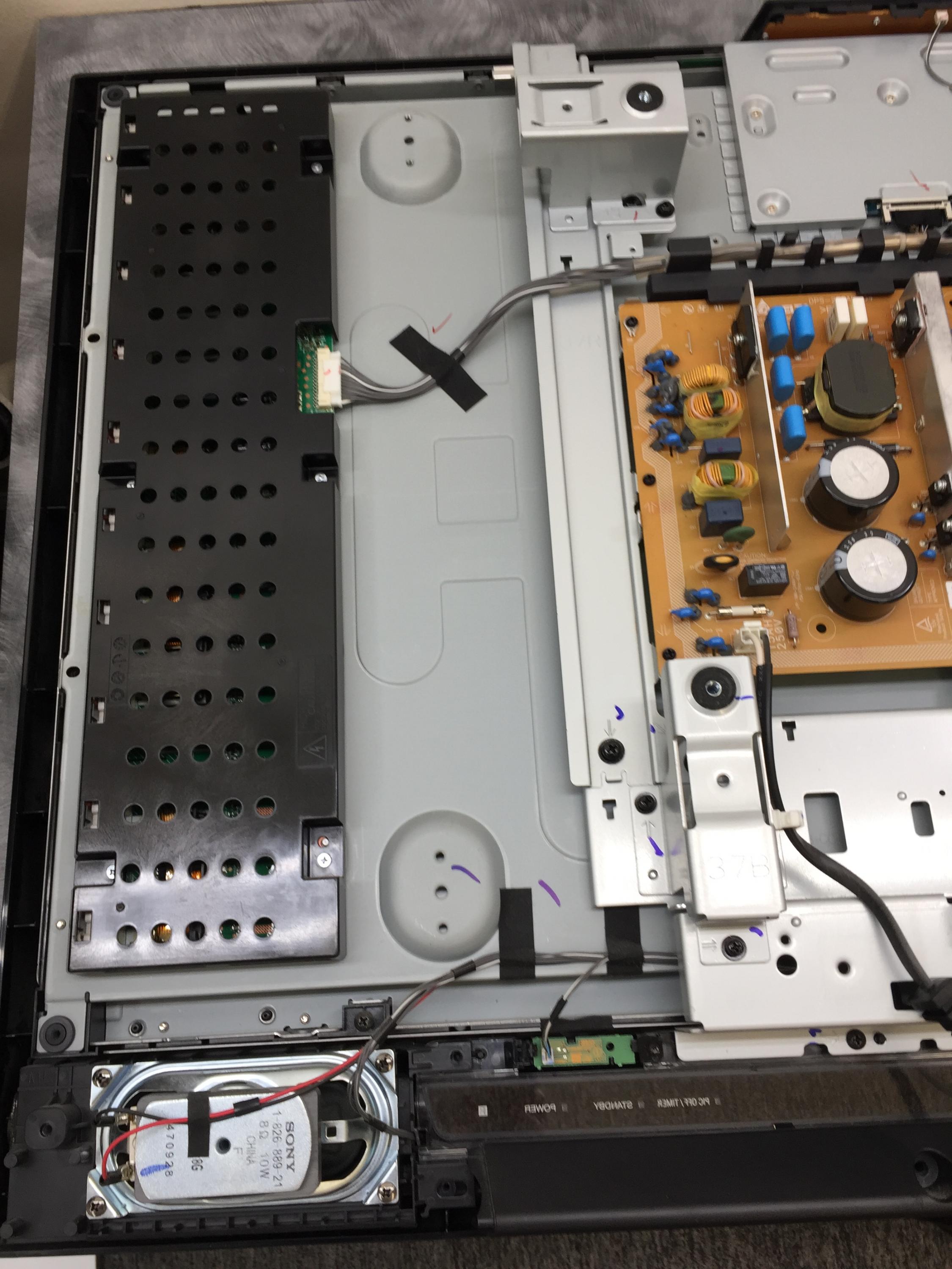

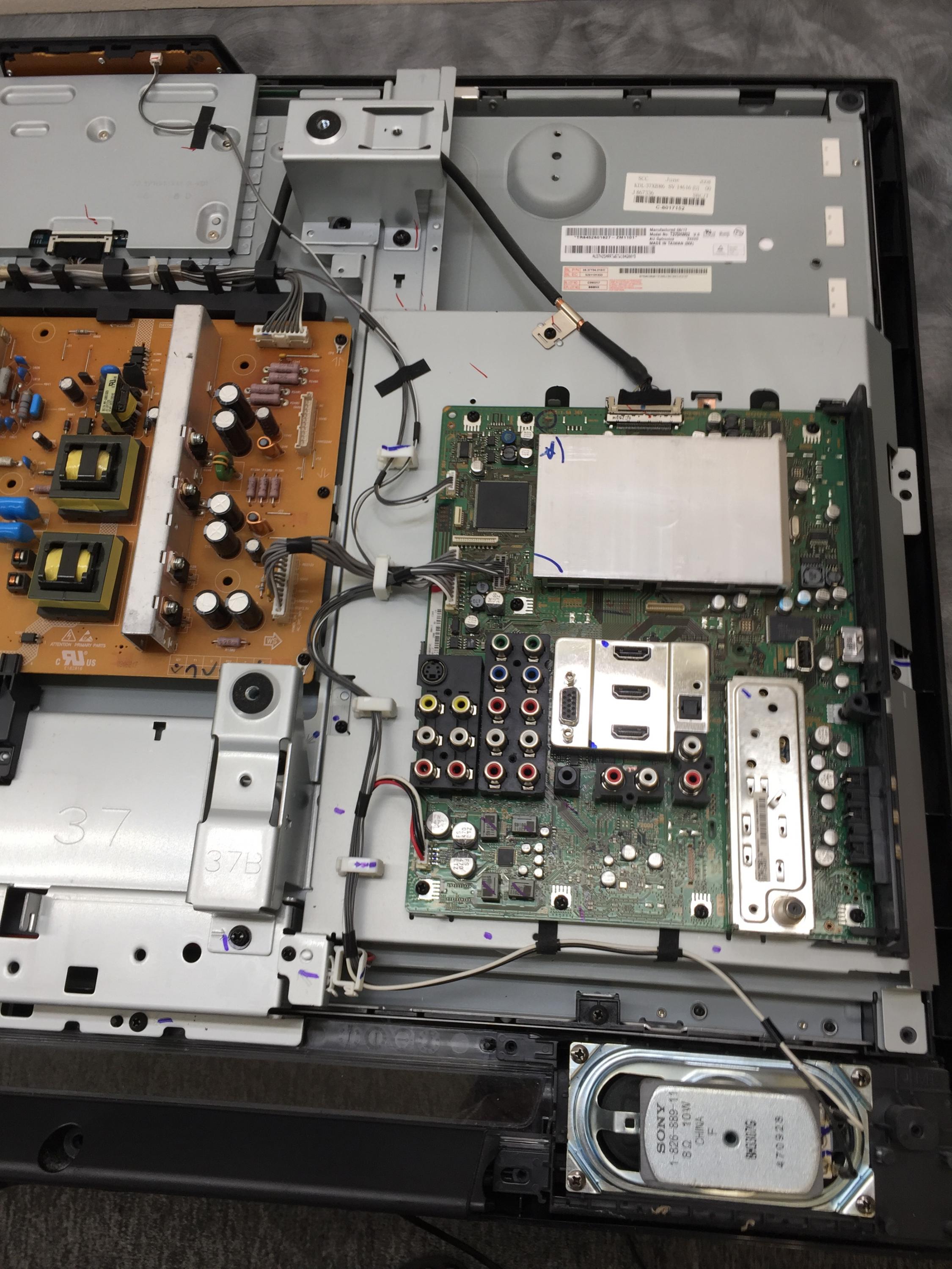

        Re: Sony KDL-37XBR6 Black Screen
        Hello again

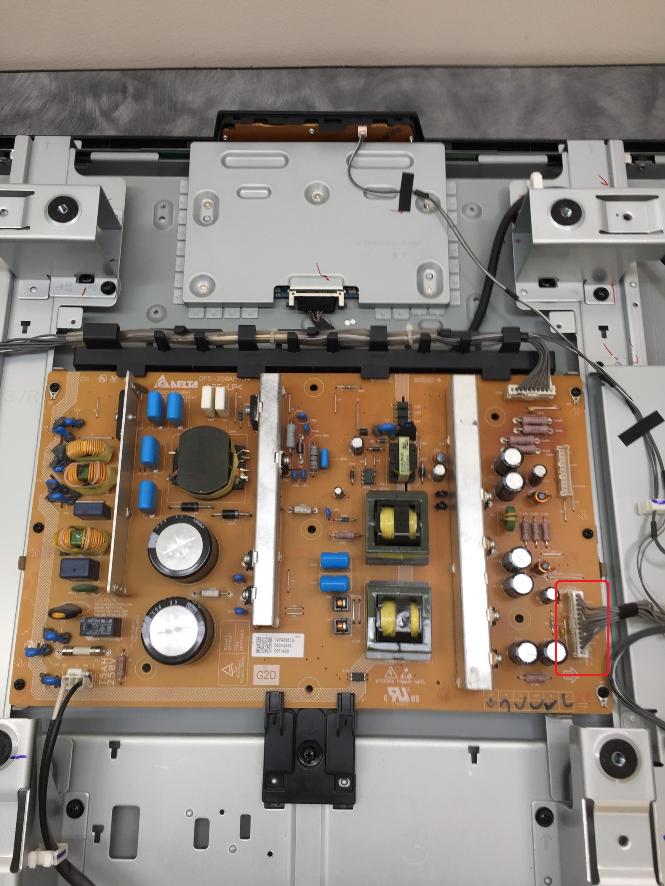

        I finally took the back panel off to get photos of the inside.
        It looks to me like they have 4 pcb's that connects one to the other.
        I had to take 3 separate photos as it's fairly wide for my iPhone.
        The first photo is the back left side, middle, and the right side.
        • Gammaray
          • May 2010
          • 120
          • U.S.A.

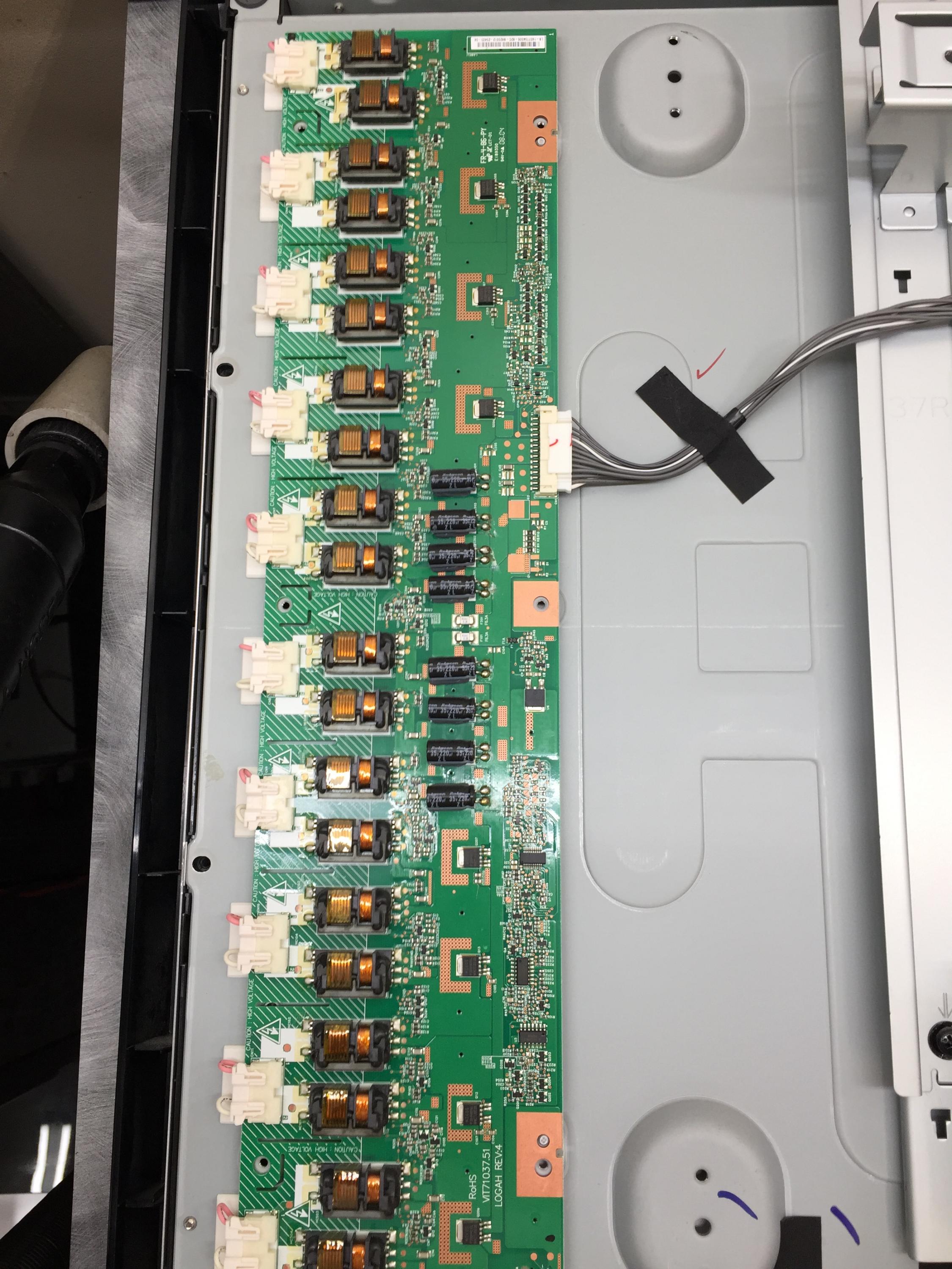

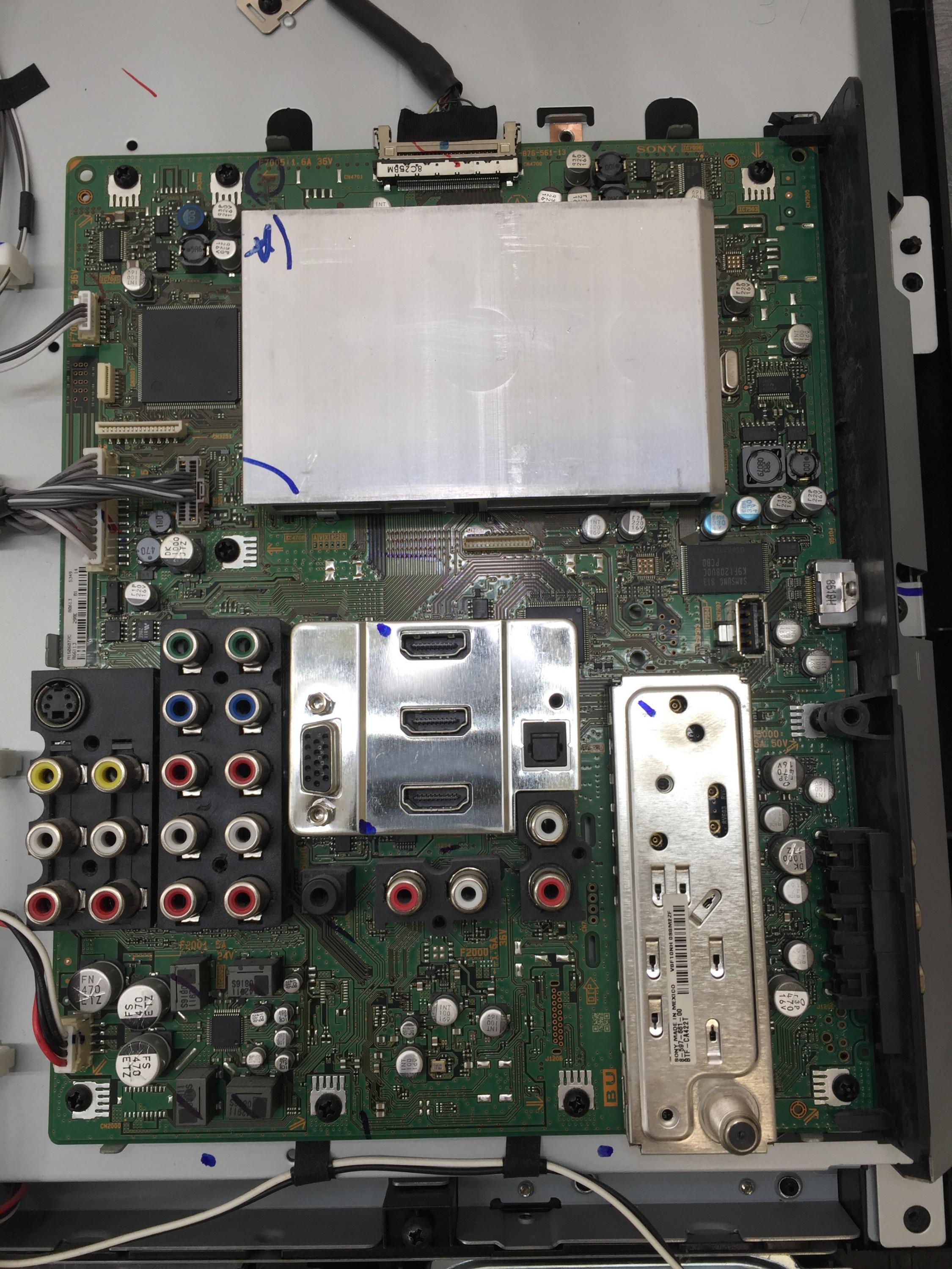

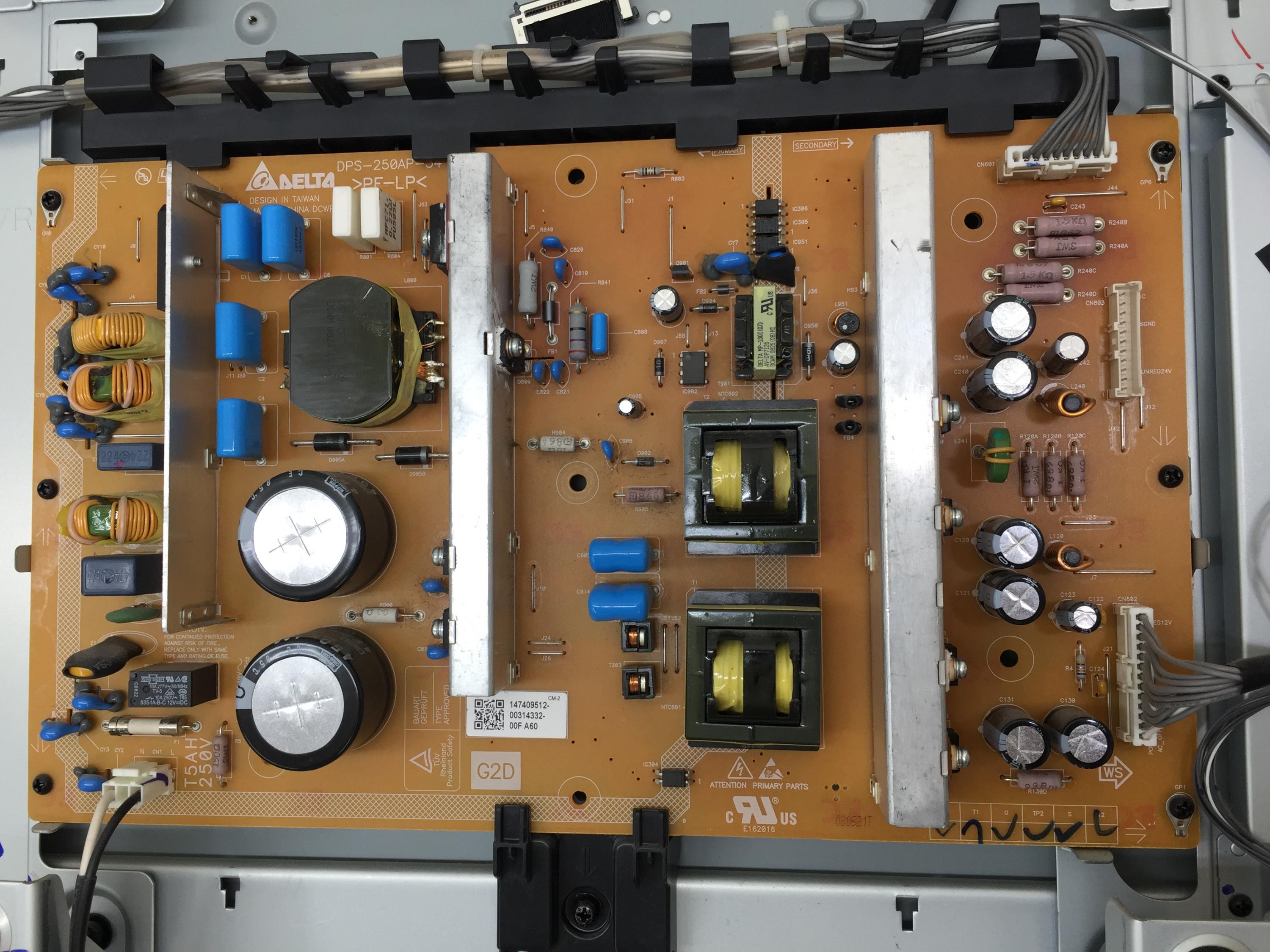

          Here are some more photos of the individual components. Perhaps this will help more!
              Try dis-connecting one at a time the 2 blue ribbon connector from T-CON board to the panel and power-up the TV. Update here the results.
                Hi sidds, I did like you said and removed each ribbon connector one at a time, turned the power button on, but nothing.
                I notice when I plug the cord in the A/C outlet, that the main power supply board makes a click noise, then when unplugged it makes the same click noise. I assume that this is normal?
                Thanks for your help!
                • R_J
                  • Jun 2012
                  • 9535
                  With the lvds cable connected to the T-con board do you have any voltage on both sides of the small fuse on the t-con board? It should be around 12 volts. The fuse is just to the right of the lvds cable and is marked 3A
                      Hi RJ, Thanks for the info. I will try and get a measurement tomorrow, and post it here. Thanks again!
                          I did measure each side of that resistor, but nothing! Using my Fluke DMM, I used the ground on the pcb and checked both sides of the resistor for voltage, but nothing! I can see where they have some small copper circular contacts that I tried to see if they have voltage, and there was voltage on the few I checked. Should I measure everyone and report back what they are?
                          Thanks again!
                              you need to check the voltages associated with the power board ... they should be written near the connectors in question. Note that, some voltages only appear briefly during startup when the set doesn't complete the startup successfully so you have to monitor those right away during power up / on.

                                • Gammaray
                                  • May 2010
                                  • 120
                                  • U.S.A.
                                  It appears that the issue is a high probability of being the main/video board. The one for my TV is a hard to get part! I may just end up trashing it! Or maybe I can list the good parts for sale on ebay! I can promise that I will never buy a SONY again!
                                    Can you give the voltage readings at the connector along with pin number, pin name, Standby ON, Standby Off
                                    Example
                                    Pin No.......Name.........Standby ON..........Standby Off
                                    Pin 1.........12V...............0.0V.................11.9V
                                    Pin 2........
                                    etc.
                                        OK, I unplugged the harness/wires from the power supply board and plugged in the main AC plug. I get no voltage readings on the 13 pins that are there! Am I doing this correctly? Not sure if I have to leave that connector plugged on the PSB? I also noticed that there was no clicking noise when AC is plugged in and also unplugged! It does make this clicking noise when everything is connected.
