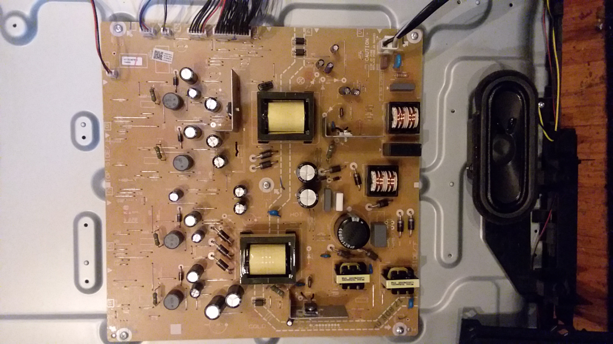

    Got this dumpster TV this morning while taking out the trash, couldn't believe there was a 55" in there with an intact display, ya know I had to haul it home
    What's more amazing is it doesn't seem to be much wrong w/ it.
    Plug it in to AC, get a relay click, hit power button, it all lights up nice....for about 3 seconds, then shuts off, then 5 seconds later the tos-link for optical audio LED light on main board goes out as well. (Telling me not a backlight issue, I at least unplugged back light power, it does the same thing) I'm going to check voltages here shortly (I got to go look at a potential Home Theater Job for a house @ 2pm) But I figured I'd stick this up now with some pics hoping maybe there's a case history issue or if somebody's dealt with this issue before?
    BBL!!!

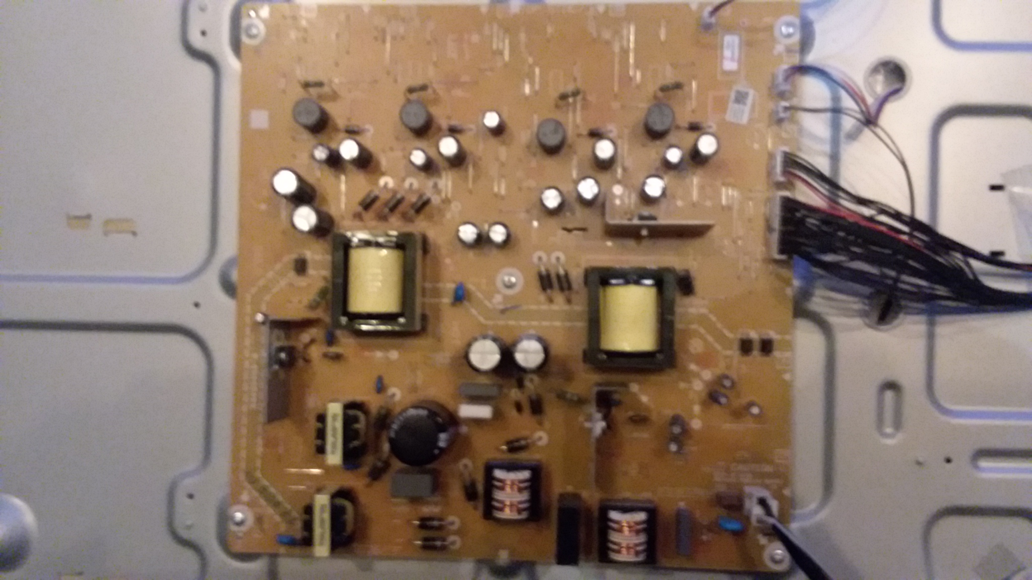

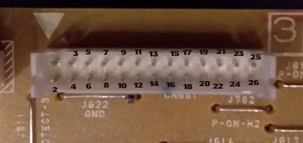

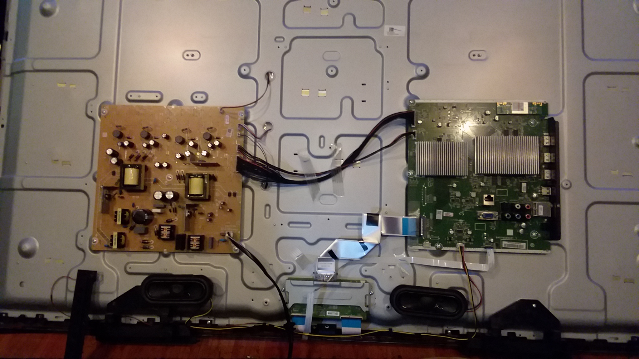

    Re: P&F (Philips) 55PFL6900/F7 Turns on 3seconds then Off
    Here's what I got voltage wise from CN657 off PS board
    see pic for pin out
    pin5=3.3v stby
    pin6=0v stby - 3.3v power On
    Pin8=0v stby - 3.3v power on
    Pin9=3.3v stby
    Pin10=3.3v power on
    Pin15=12.9 stdby - 21v Power On
    pin16=12.9 stdby - 21v Power On
    pin17=12.9 stdby - 21v Power On
    Pin18=12.9 stdby - 21v Power On
    pins 23,24,25,26 all same= 8v stby - 12.8 power on
    PS: All Power-On voltages drop to 0 when SPDIF light goes out

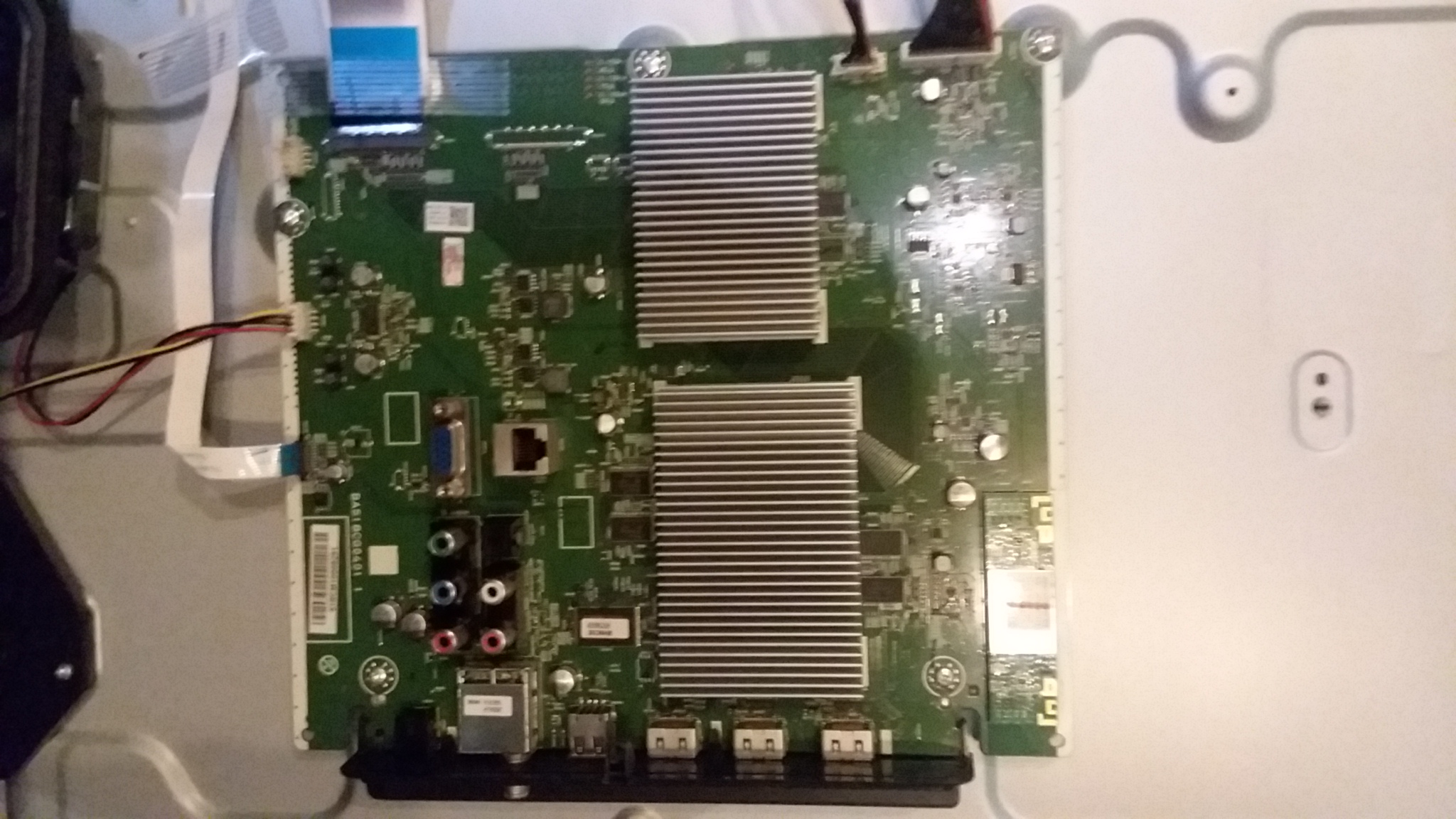

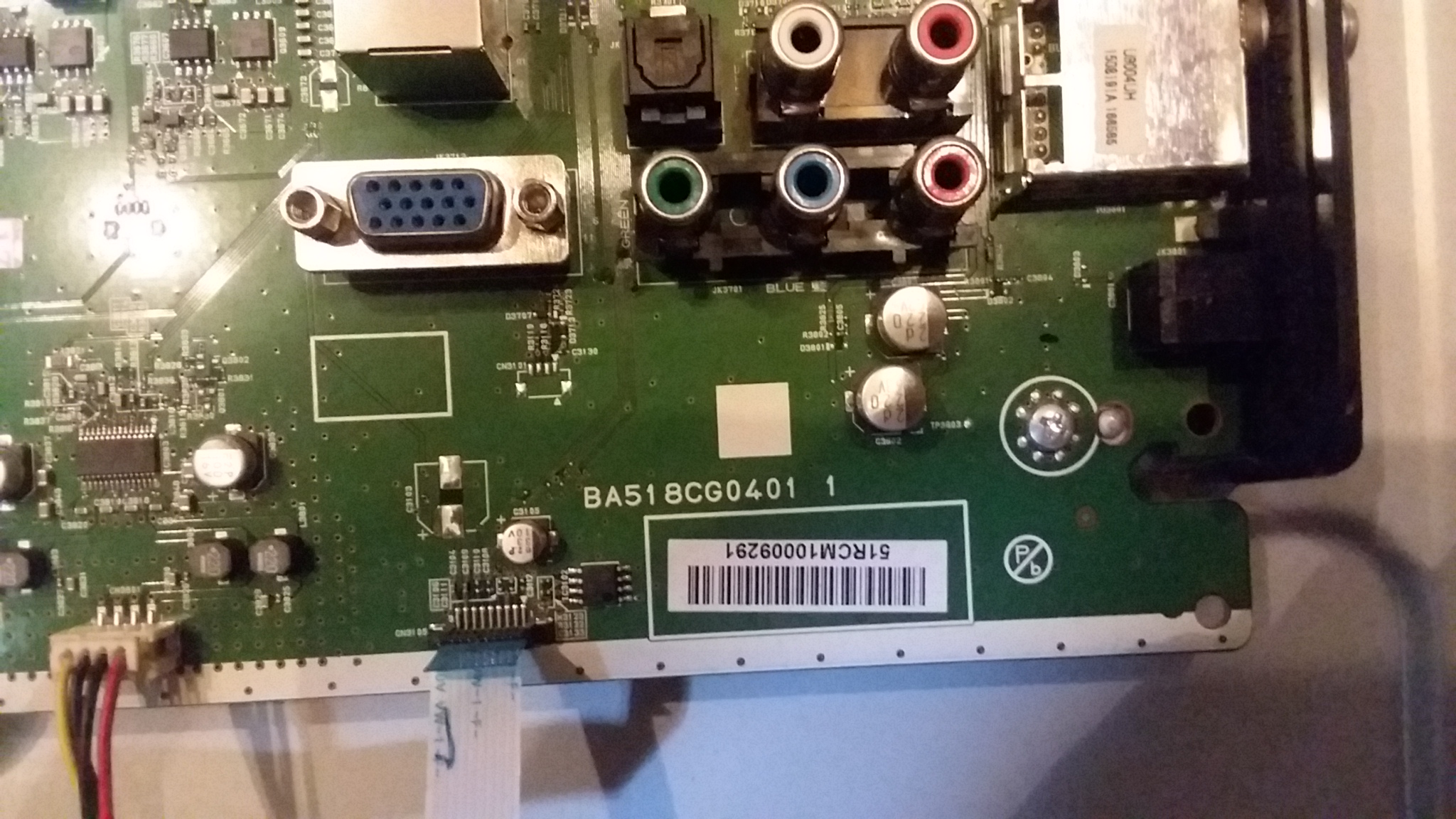

      I'm thinking it's a fakked main board, these huge heatsinks make me think it's a BGA lift failure
      still not sure, don't have pinout voltages labeled nowhere nor a service manual
      "Our technologies have surpassed our humanity" ~Einstein
      • Shock2cure
        Test Subject
        • Jul 2018
        • 140
        may try a BGA re-bake in my Hasbro Easy-bake oven,lolz... Got nothing to lose there...lolz

              Tried the ez bake method today, actually, took off heat sinks and hit them with the heat gun ....to no avail, still does the same thing ;(

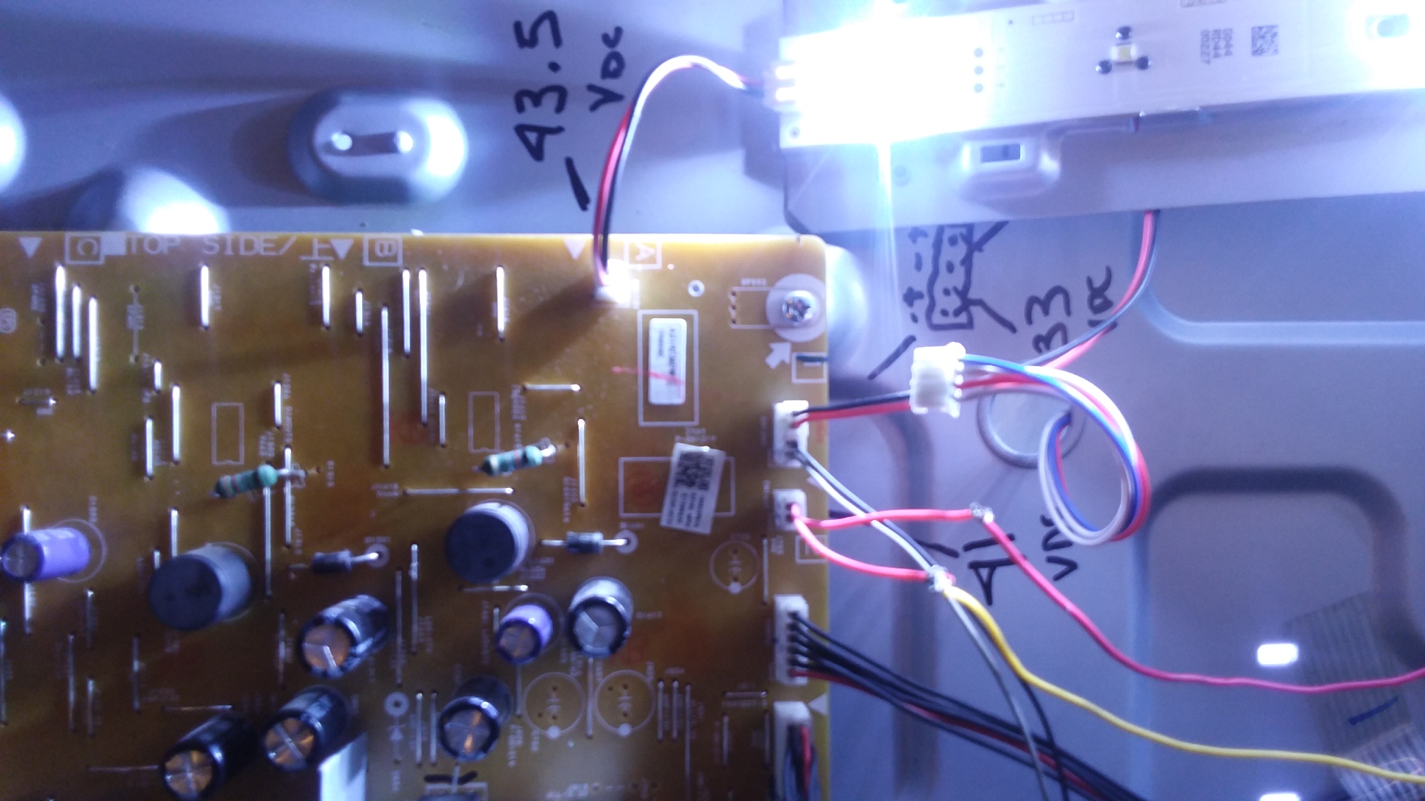

                  Originally posted by R_J
                  I would suggest you have bad backlights, when you said you unpluged them and got the same result, that would indicate an open led string.
                  It looks like there are four seperate led strings in this panel. I would place your meter probes across each string and turn on the tv. the voltage should come up then drop lower, post the voltages of each string

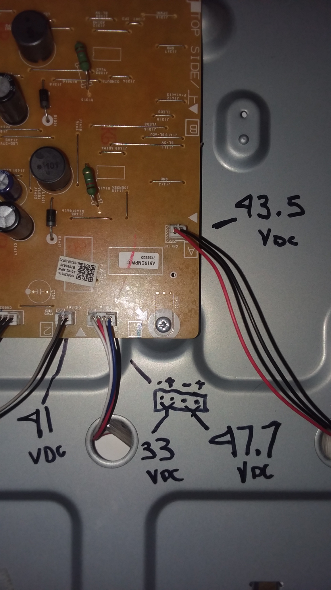

                  CN1101 pins 1&2 43.5v
                  CN1201 pins 1&2 47.7v
                  CN1201 pins 3&4 33v
                  CN1401 pins 1&2 41v
                  You can measure each pin with ground as reference or measure across each pair of led's
                  Thanks,
                  see pic
                  CN1201 pins 3&4 33v
                  CN1401 pins 1&2 41v
                  • R_J
                    • Jun 2012
                    • 9625
                    I would think they should all be close to the same voltage, this seems to indicate a problem with cn1201 3&4 diode string. Being that the voltage is low could indicate shorted leds in the string trigering an error.
                    By chance if you unplug cd1201 only do you get a flash of the backlight?
                      yes, unplugging CN1201 still gets leds lit + gives me 2 more seconds of LED time ..lol

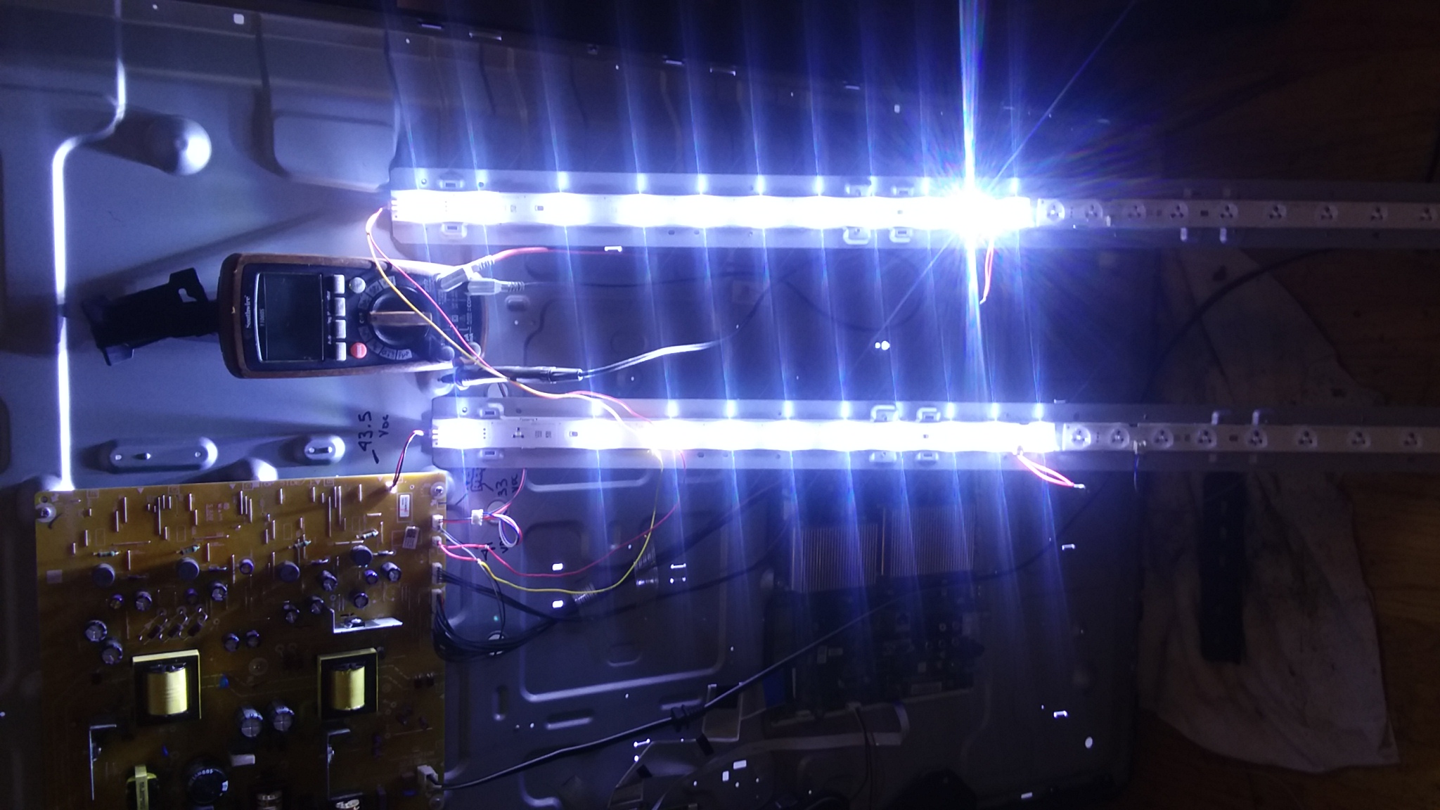

                        well if its LEDS, this TV's still screwed, I have the worst record of removing the displays and breaking the sh*t out of them...bummer. Guess the Boards going on flEbay I reckon
                        • Shock2cure
                          Test Subject
                          • Jul 2018
                          • 140

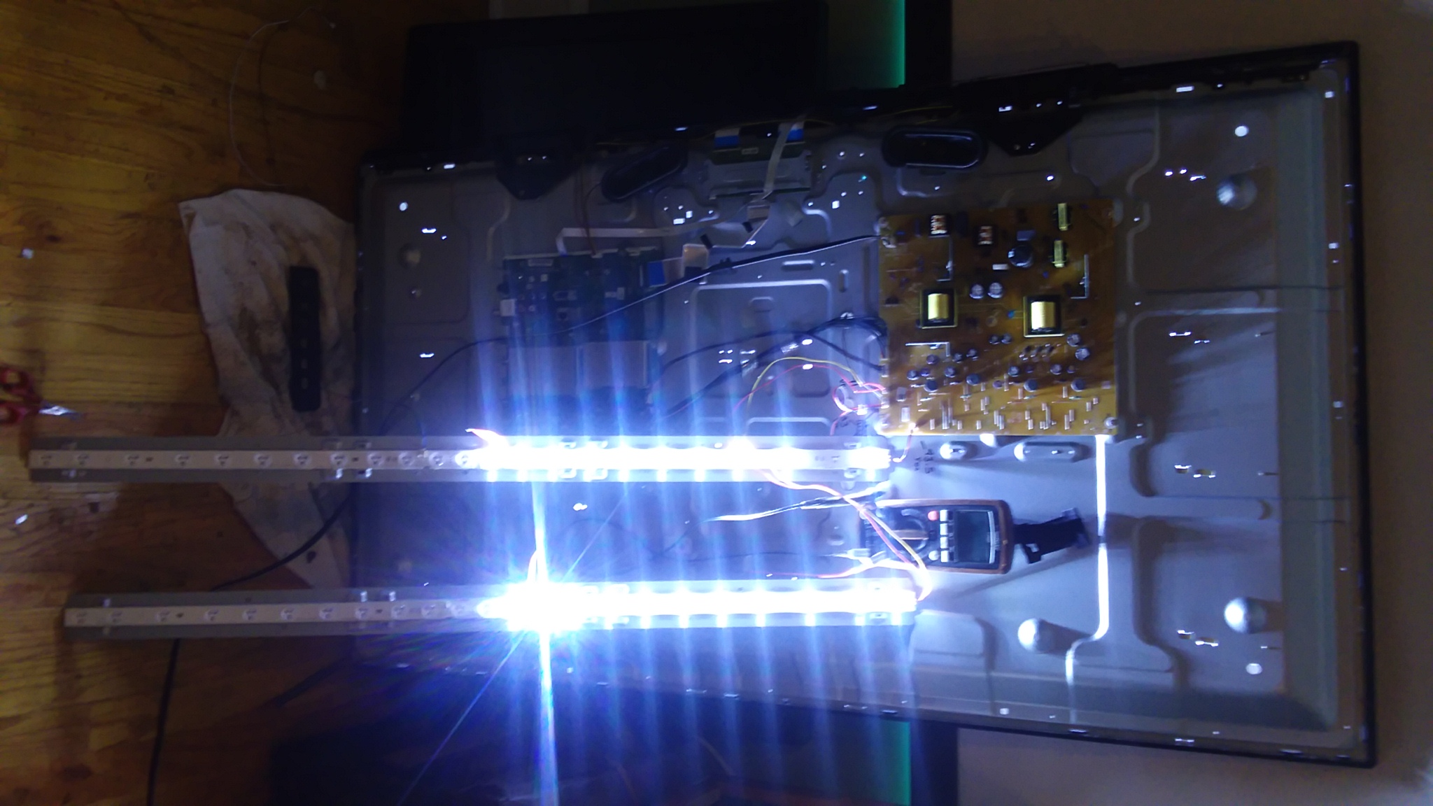

                          well I rigged up a couple outside LED strips from another Set and plugged them into CN1101 & CN1401
                          I then took the end plugs from CN1101 & CN1401 and connected those into CN1201.... Hit power button and....see pics
                          Everything is staying on, R_J, you were spot on sir, bad/burnt LED array within the CN1201section....which normally I would rejoice, but as I stated, I have a 0% recovery when trying to replace LED's, I ALWAYS end up breaking the displays, I dunno if it's because I'm a bull taking these apart or simply cursed. But either way this one is still going to be broken because I'm not ruining my day when I break this 4K display trying to replace LEDS....lolz....
                          ...bummer

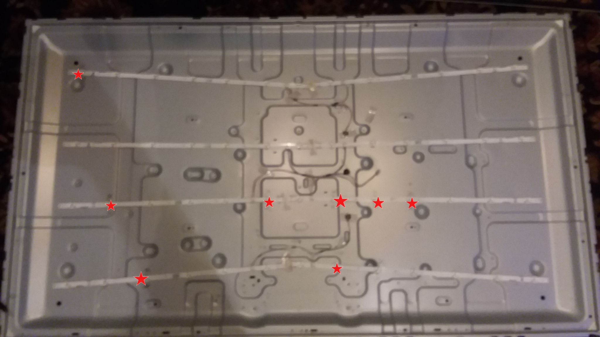

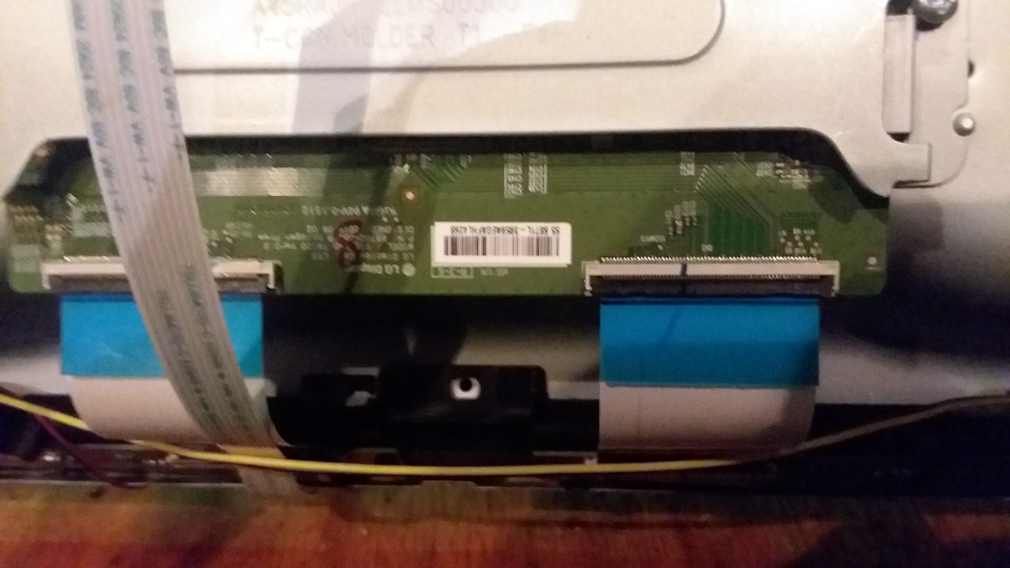

                            Well after sitting here staring at this sipping the morning Joe, I ripped it down...can still sell the working boards after i probably kill this display glass...lolz
                            -First Picture-
                            There's a total of 8 strips, 4 w/ 7 LEDs, 4 w/ 6 LEDs,
                            layed out in 4 pairs of 2, (1 w/ 6 leds. 1 w/ 7 leds)
                            52 LED's total
                            CN1201 drives the middle two rows
                            CN1101 drives top roww
                            CN1401 drives the bottom row
                            -Second Picture-
                            Red stars indicate the burnout LEDs
                            So 8 out of 52 are shot, 5 of them are connected to CN1201, so I see why the voltage was way off
                            I'm going to see if I got these LED's already, good chance I do,
                            still knowing I'm probably going to crack the helloutta this display putting it back...lolz
